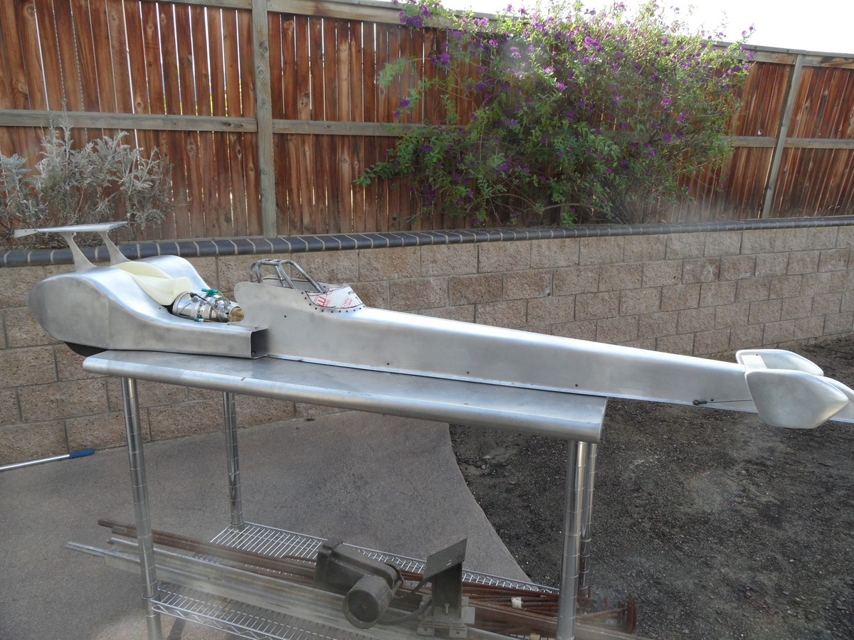

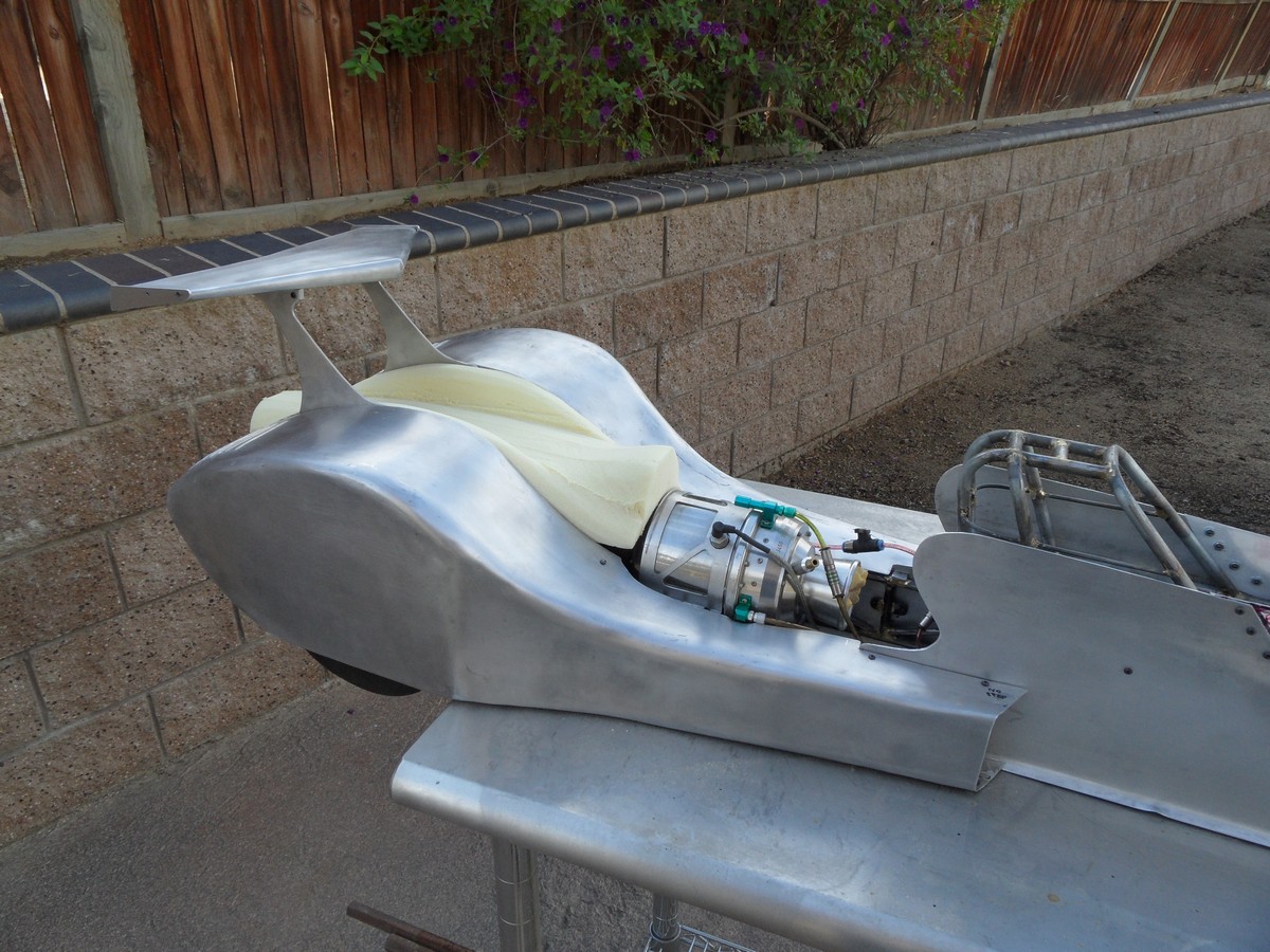

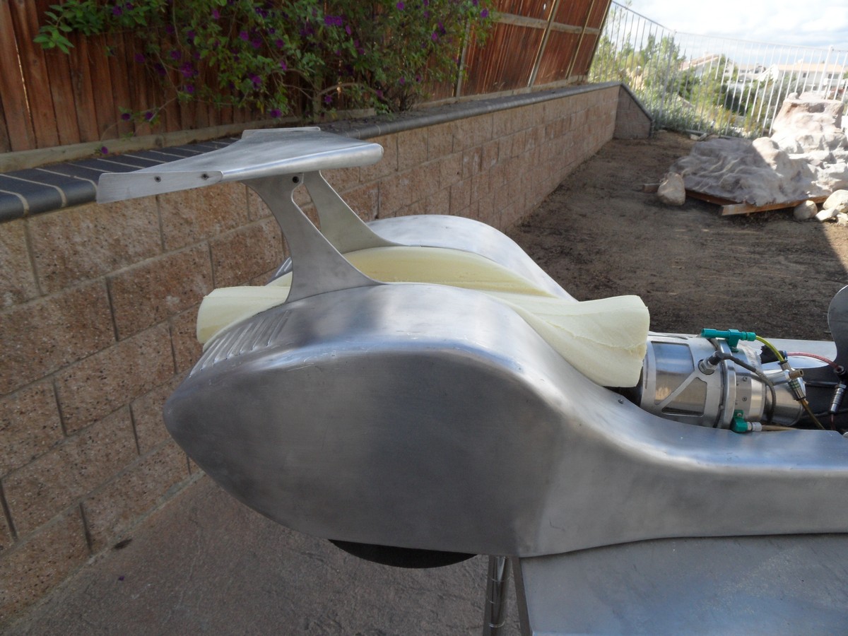

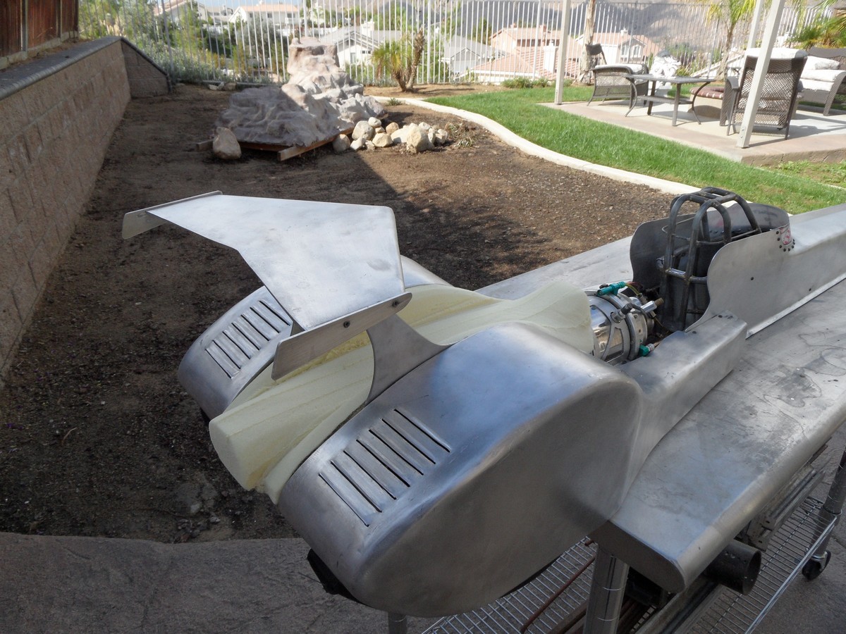

here is a start to the concept. It will be an exhaust shroud made to look like the intake and exhaust of a jet. This is just foam to get the shape, then it gets made into a fiberglass mold. After that, it can be layed up in carbon fiber. Underneath the shroud i will have insulation and two deflectors near the brakes. I think the shape is coming along OK?
Re: John Fosters GREATEST creation yet... hot shot
i think it would hold more heat in as you just stopped all the fresh air flow...
just my 2 cents worth...
that is what the inlet on the front will be for. It will direct the air right over the exhaust...chiefj48 wrote:i think it would hold more heat in as you just stopped all the fresh air flow...

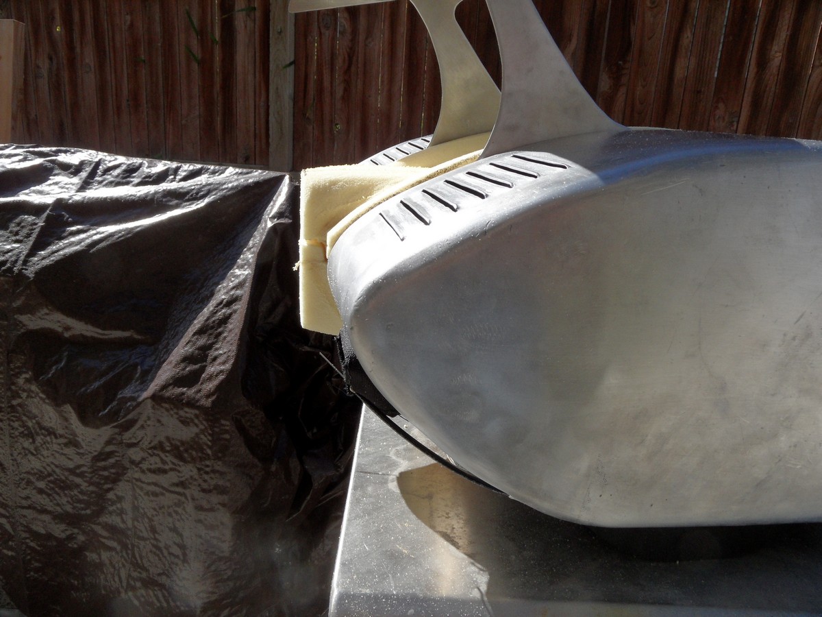

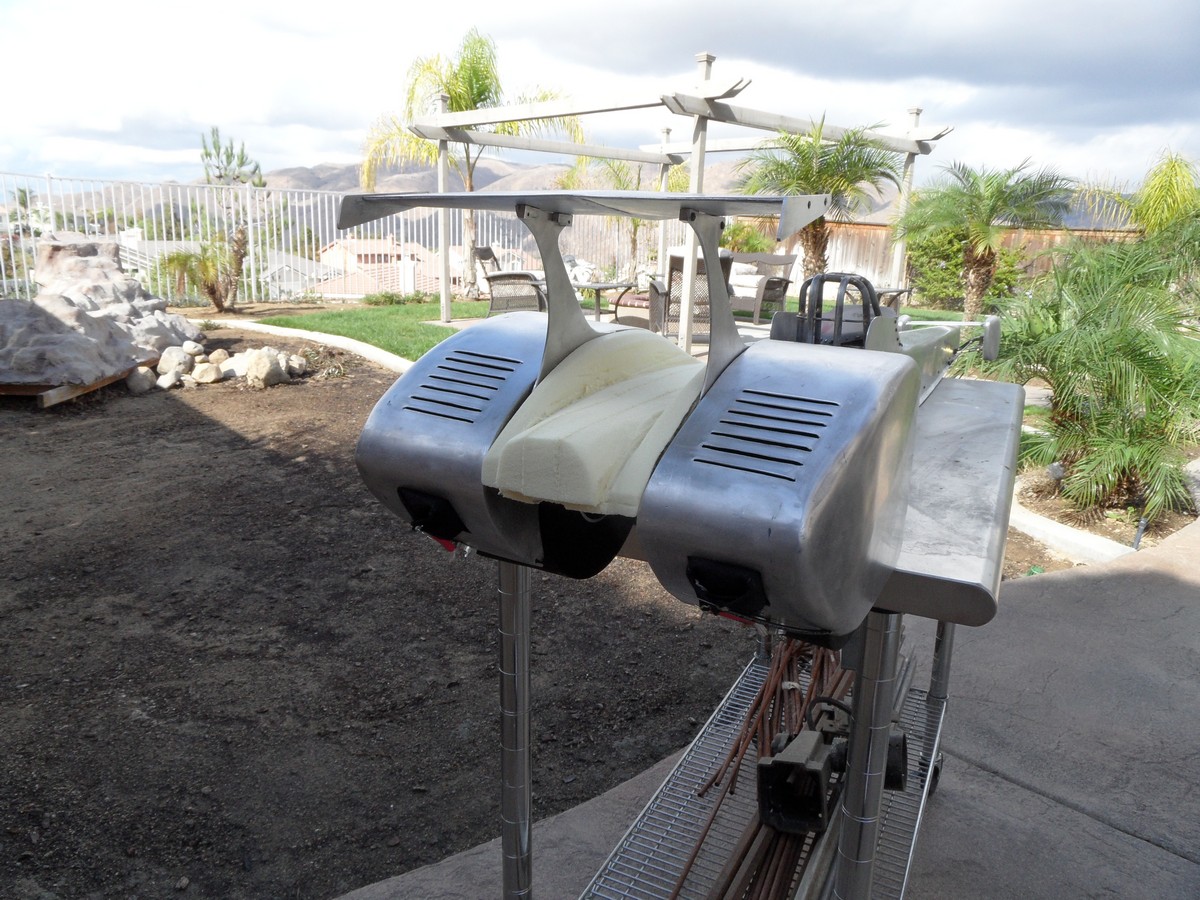

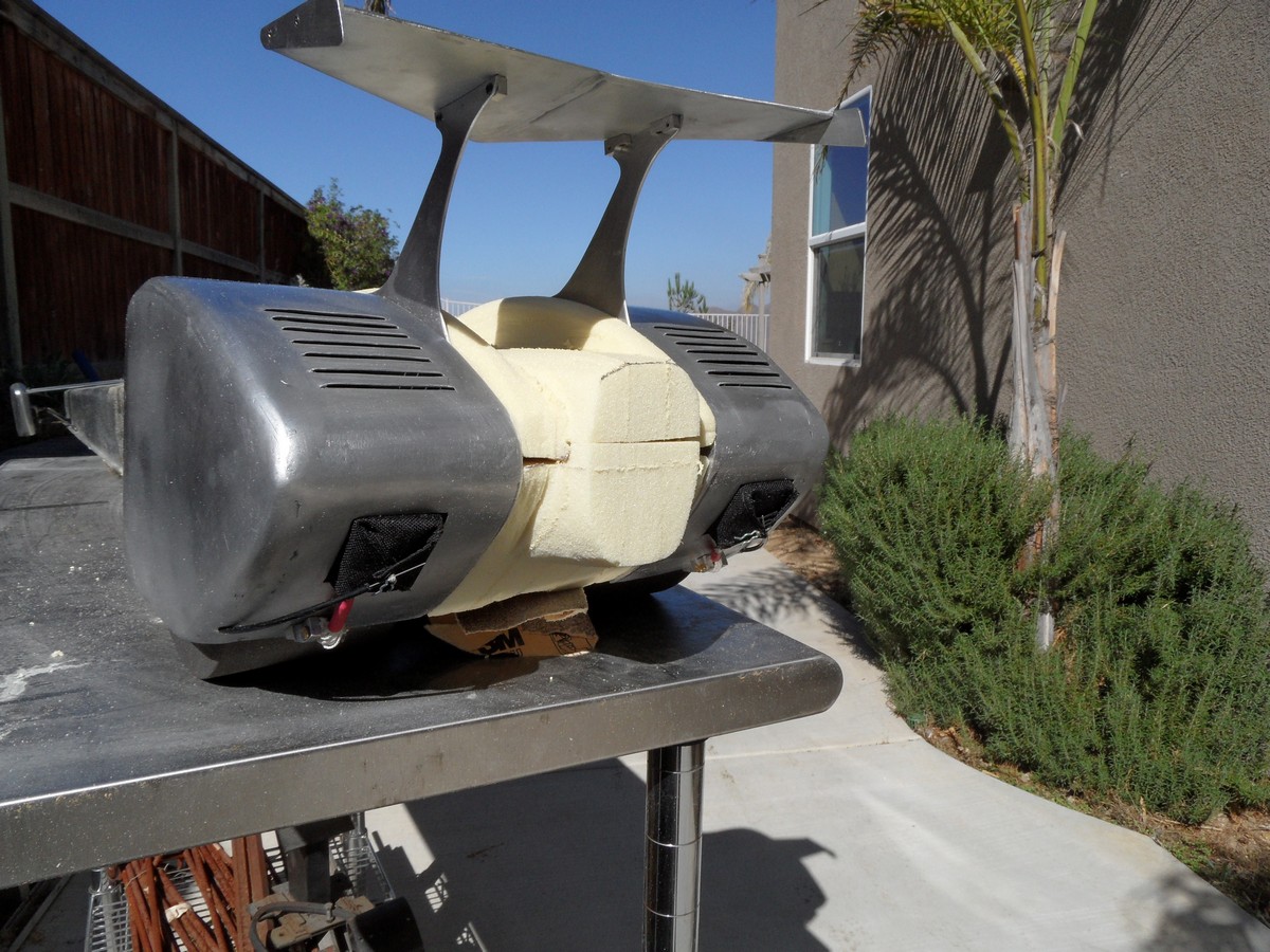

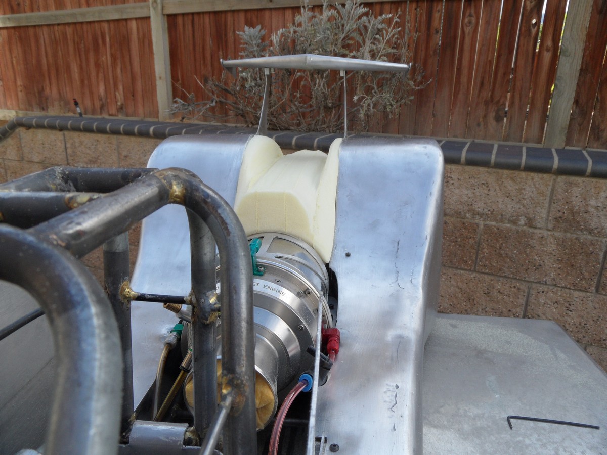

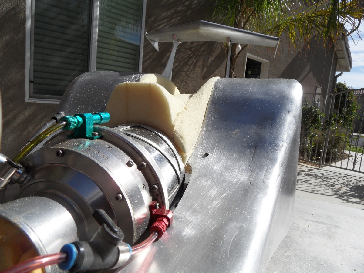

here is some progress... just about ready to cover in fiberglass so i can smooth it out and make a mold off it.
- Posts: 81
Yes is does look good on there. I do think that with the rest of your plans the carbon fiber would add something to the look. If you do the carbon fiber and you dont like it then send me your plug and we will do it out of aluminum.

suggestion i would not cover the exhaust area specially if you have a hot start you want the fire to exit and by covering it that wont happen. You also might want to add a Fod Screen to your turbine so it wont ingest things that can damage the front compressor wheel.

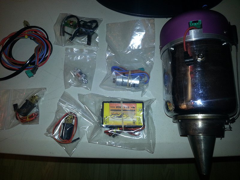

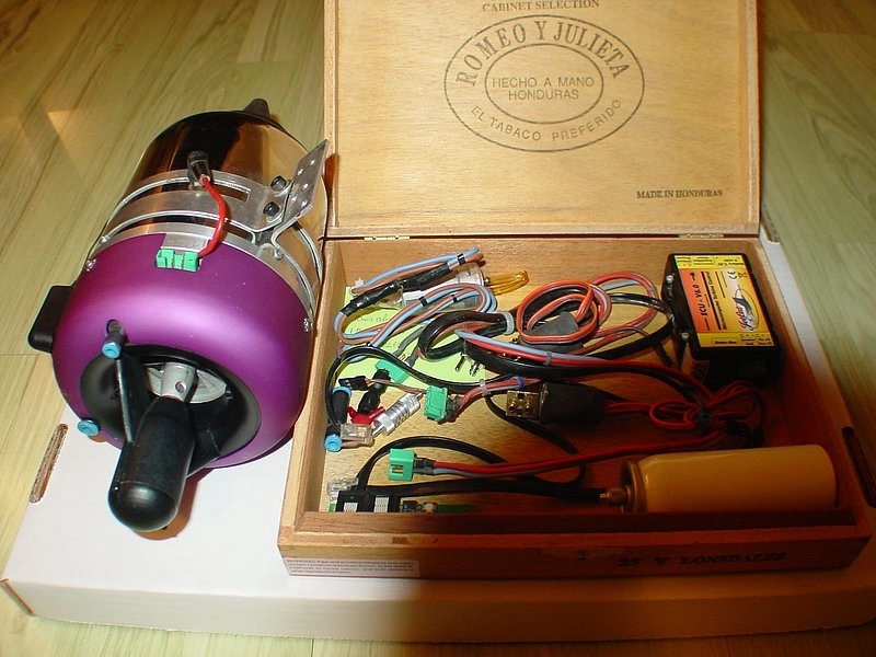

Im going to build a Twin Jet dragster like Steve Cotugno's Bostonian i have a set of Jetcat P-80's that put out 18 LBS of thrust each..
Julian
These are my 2 Turbines
Julian
