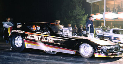

Wow that looks great Mike, John does good work. I really like Nostalgic Drag Cars. AWESOME!!!! Hey that's the same Wheels on Tripp Shumate's 79' Plymouth Arrow.
