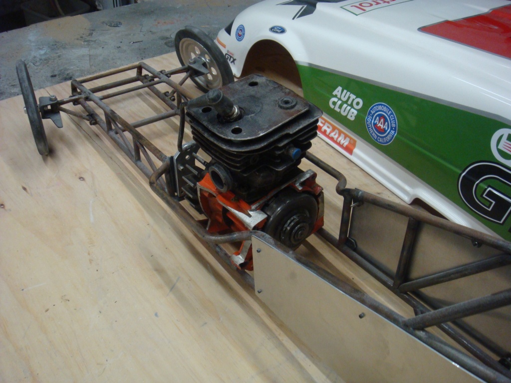

managed to track down a engine for my drag car today,isnt the twin 50cc i wanted but it should go ok with the husqvana 84.7cc and is around 6.5hp stock,i have a few pics,need to finish trimming the casing down and then fit the engine to the chassis,the guy i got it off said it has good torque so hopefully should go ok,
if anyone has used this size motor before i would be keen to hear how it performed,

hi guys,
thanks for the input,yeah might have to stick two layers of cardboard together for that extra traction,lol
trying to decide what wheels and tyres to run on the rear,do you guys think brp drag tyres will handle it or will i have to go to rubber cart tyres and rims???
perhaps someone out there may have a pair of rear tyres and rims they might want to sell so i can get this project completed,
cheers mike

Mike I doubt any type of foam tire or even with rubber bands will be able to lay traction down with that beast your putting in that car.
Your best bet is a pair of Hoosier go kart dirt slicks, D10 compound 10x 4.5 x 5, to keep them light use the BMI van K rims, they are 2 piece and very light.
You will need a set of go kart hubs, american bolt pattern (3) bolts, bob smith makes them or I'm sure some of these lovely collectors might part with a set..(lol yea right!) .
Anyway I have these on my dragster and they handle a 90cc motor on nitrous just fine, so you will be good to go if your making a runner!.

thanks for the info,
it is going to be a runner,what sort of money are you paying for the the cart rim setup,
cheers mike

Mike the Hoosiers are $54ea (2) and the Van K rims are $13ea (4)
Then you will need the valve stem kit $3 .
These are the perfect fit kart tire for your funny car.

thanks for that,where is the best place to buy these from,ive tried to get a small cart tyres along these lines here in nz but can find a supplier that sells them,
cheers mike

thanks for the link,
been on the van k site for the rims,what half rim sizes do you guys use,do you have to products codes as i am unsure of which ones to look at to get the correct offset,do you guys run a 3" off set??
cheers mike,

My funny car is pretty much stock, so I used a set of New era rear tires, which are with rubber bands.
My dragster has the exact tire I recommended to you..10x 4.5 x 5 with a 2 1/2 outside and 2 inch inside off set.

hi guys,
have my drag tyres from brp coming,im also looking at running a 75cc engine in this car,slightly less hp but might be more kind to the tyres,the go cart rims and tyres i think wont look right on this project,the 85cc engine is destined for my other top fuel dragster project,
mike
