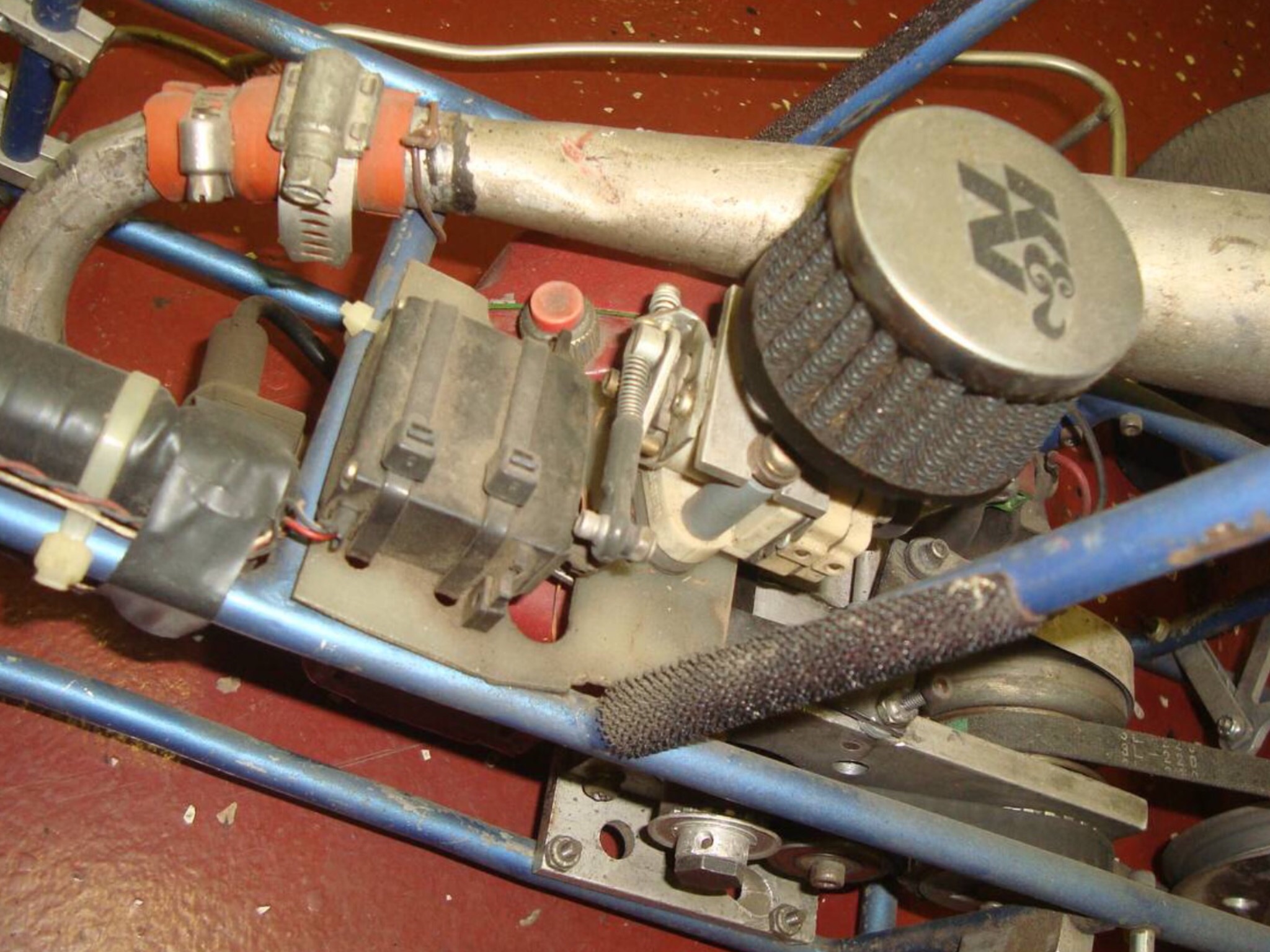

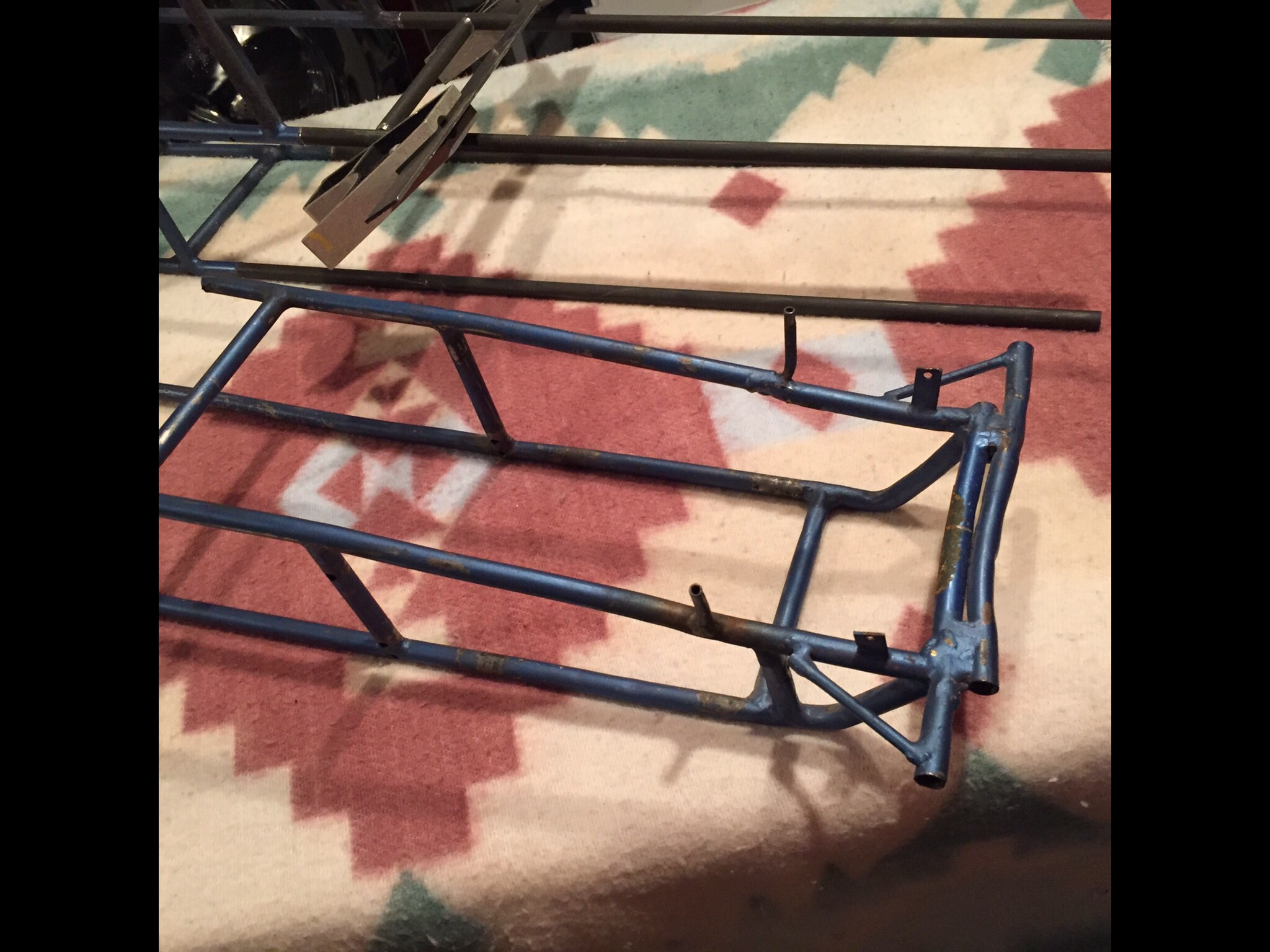

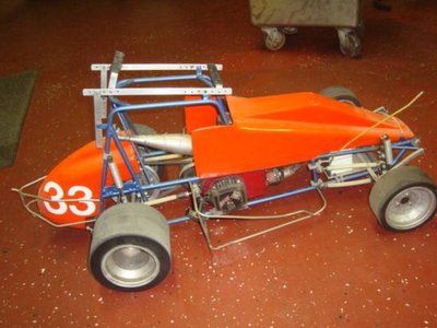

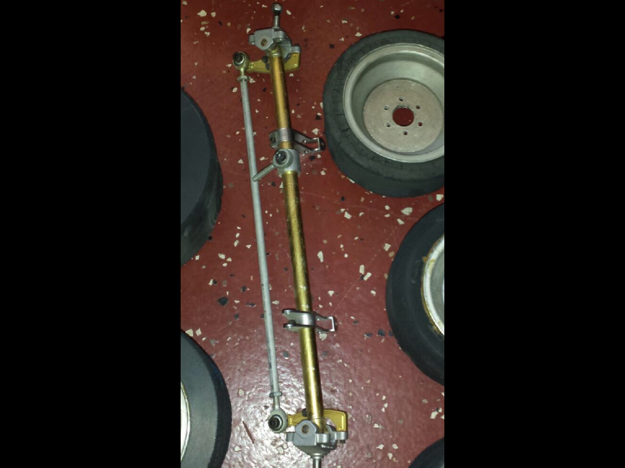

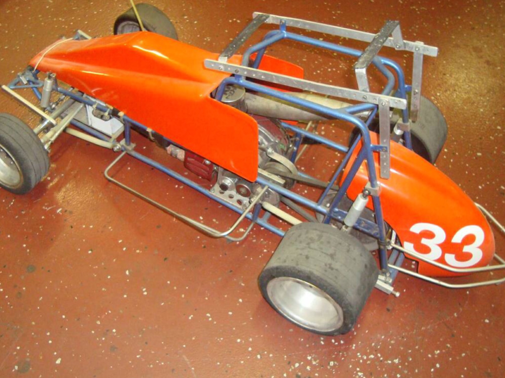

She's in sad shape but. Wait and see

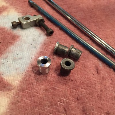

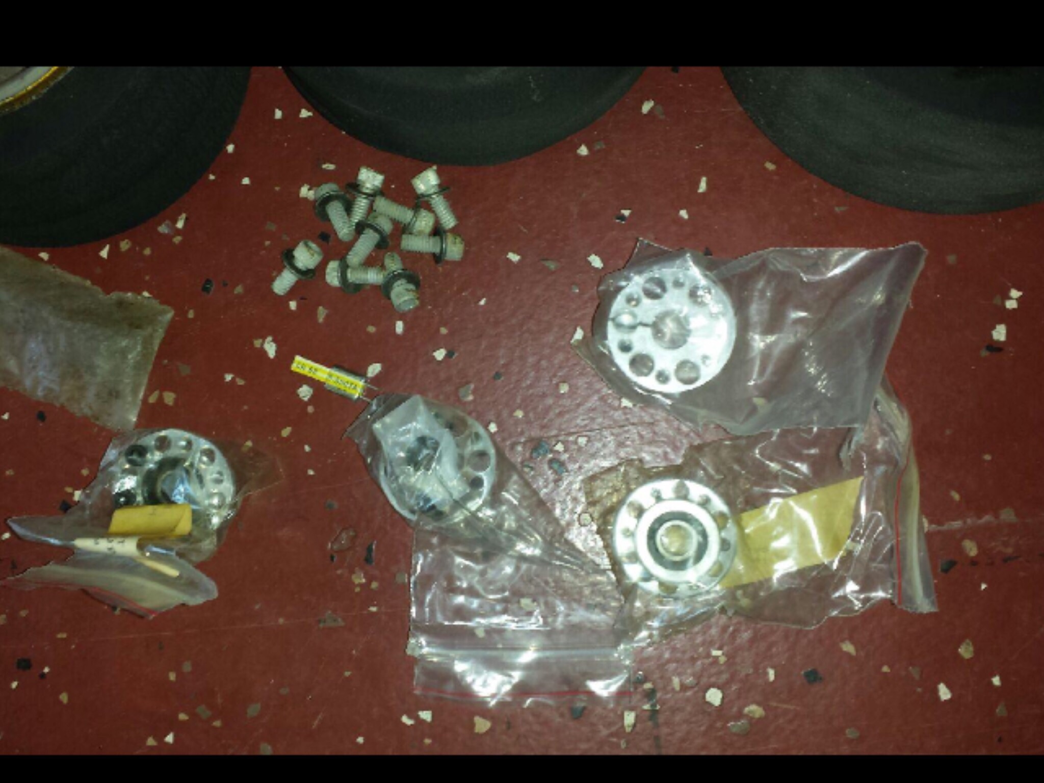

She was kind of bent up. Came with lots of goodies including anthrax front axle with is a skellenger

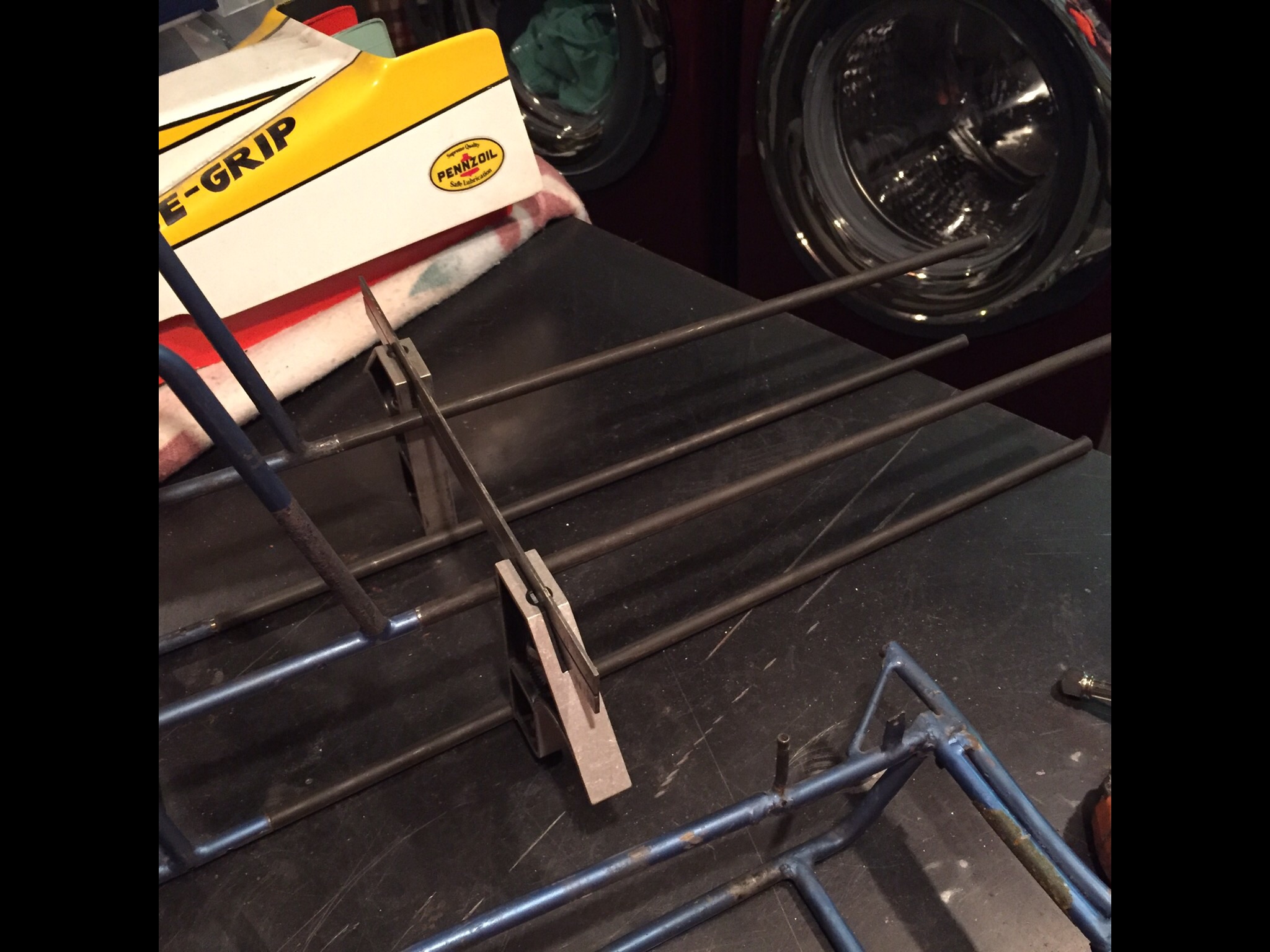

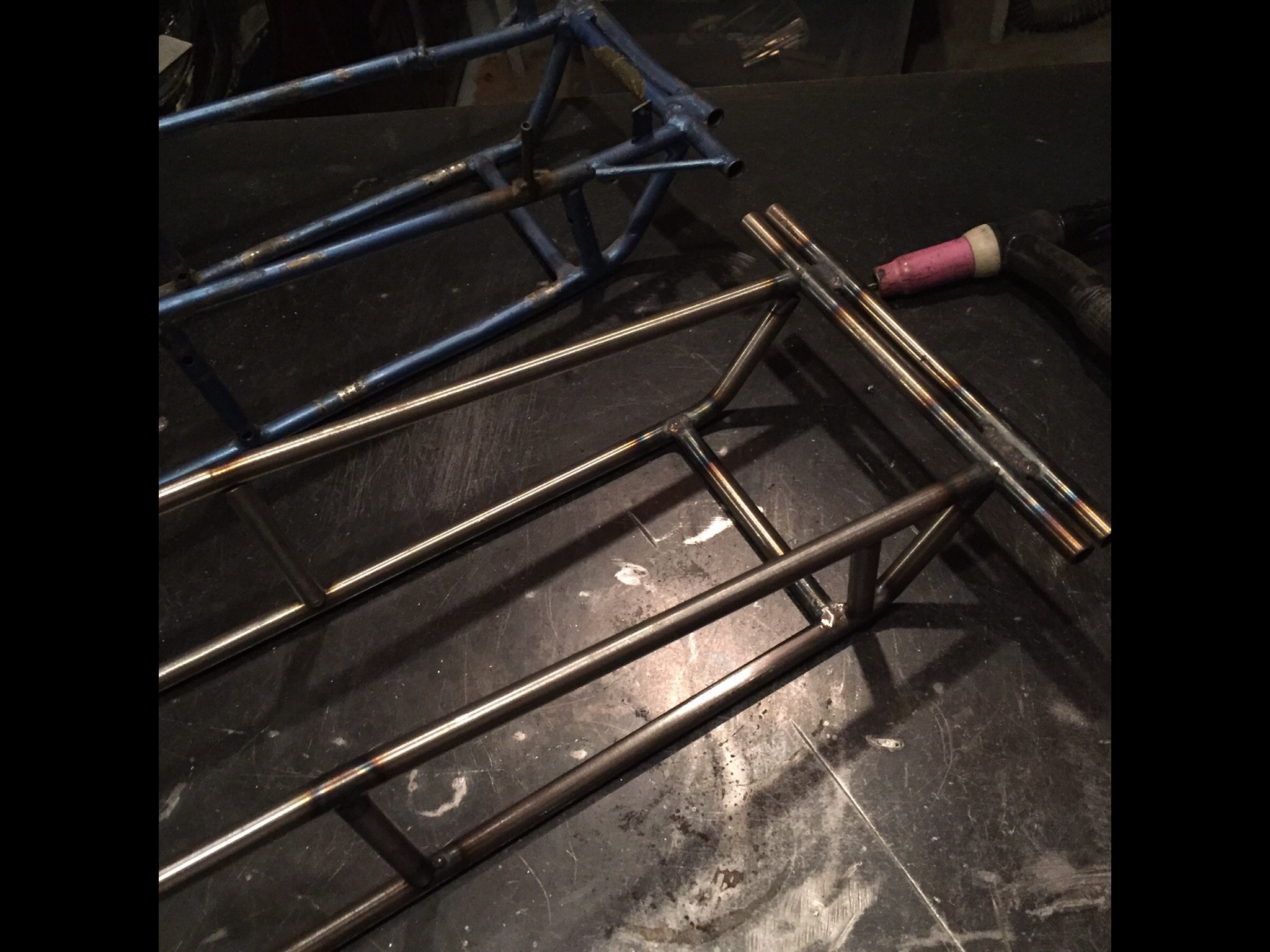

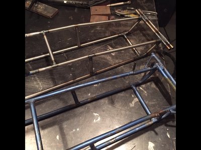

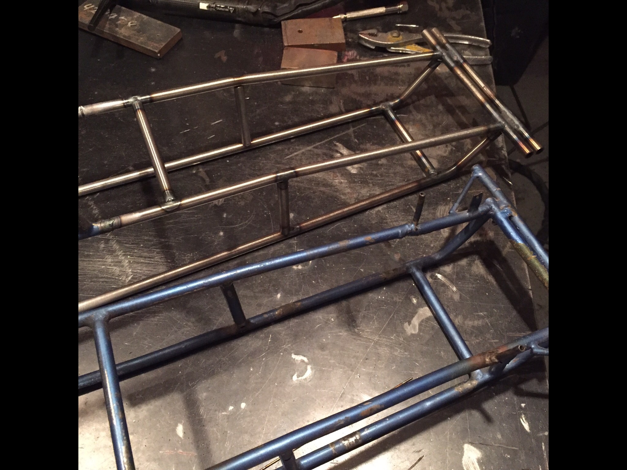

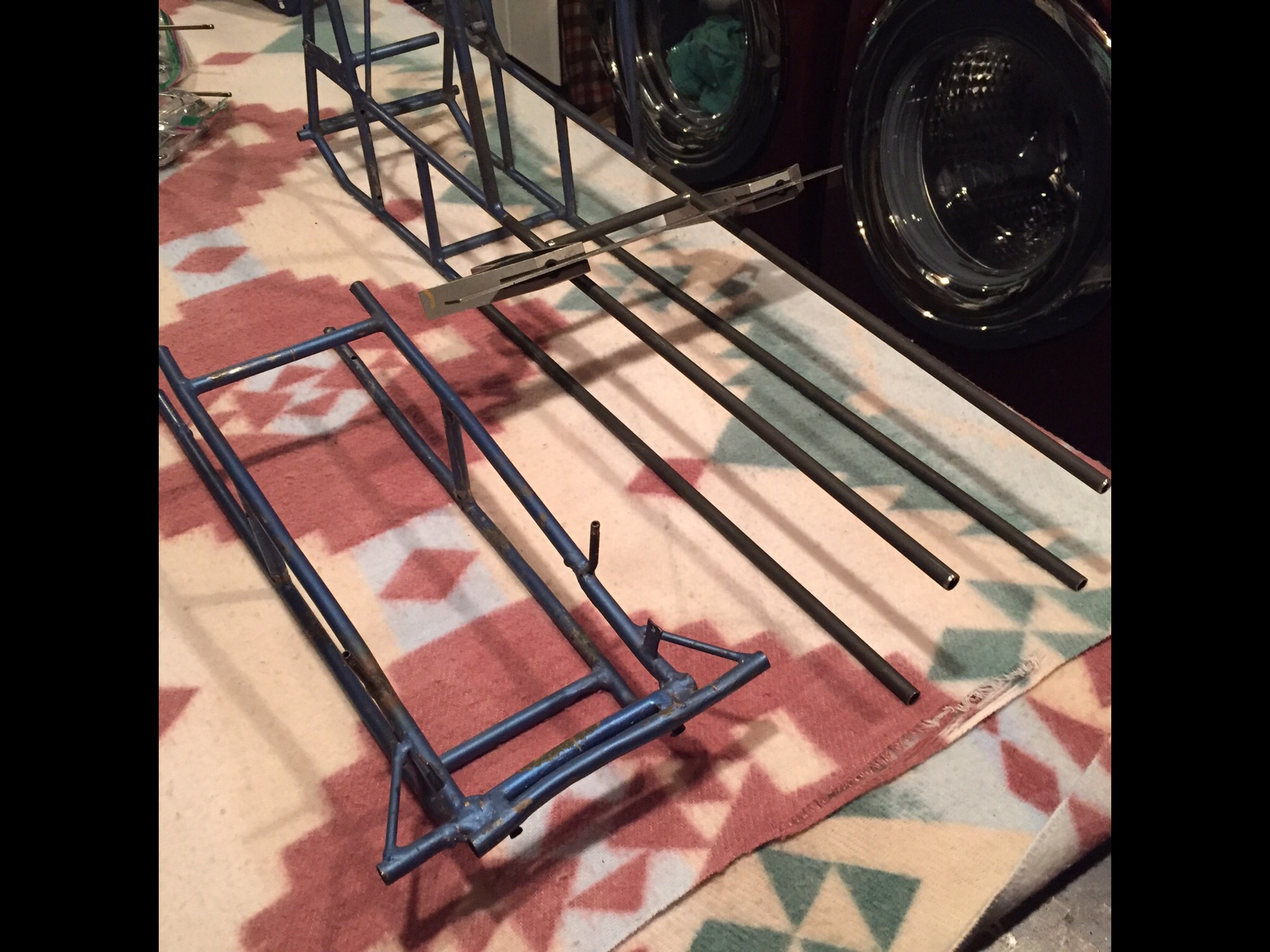

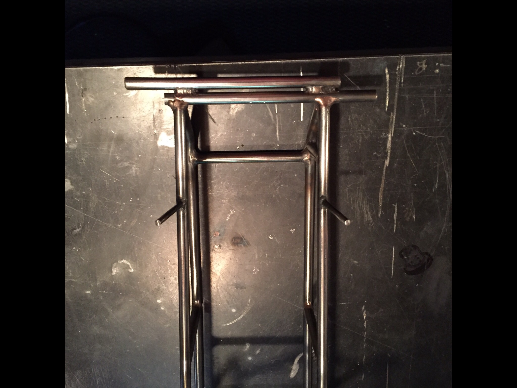

So let's jump into it

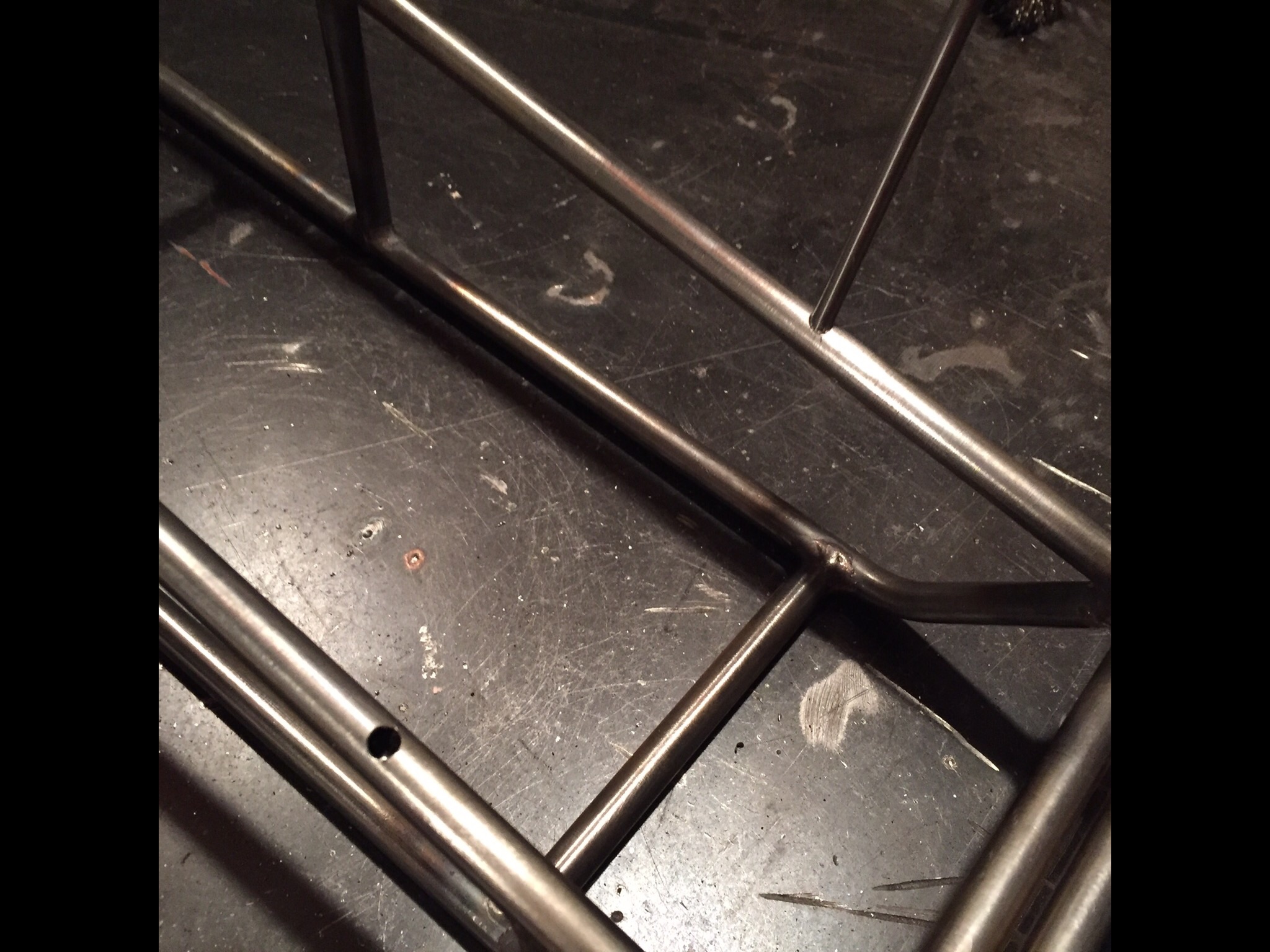

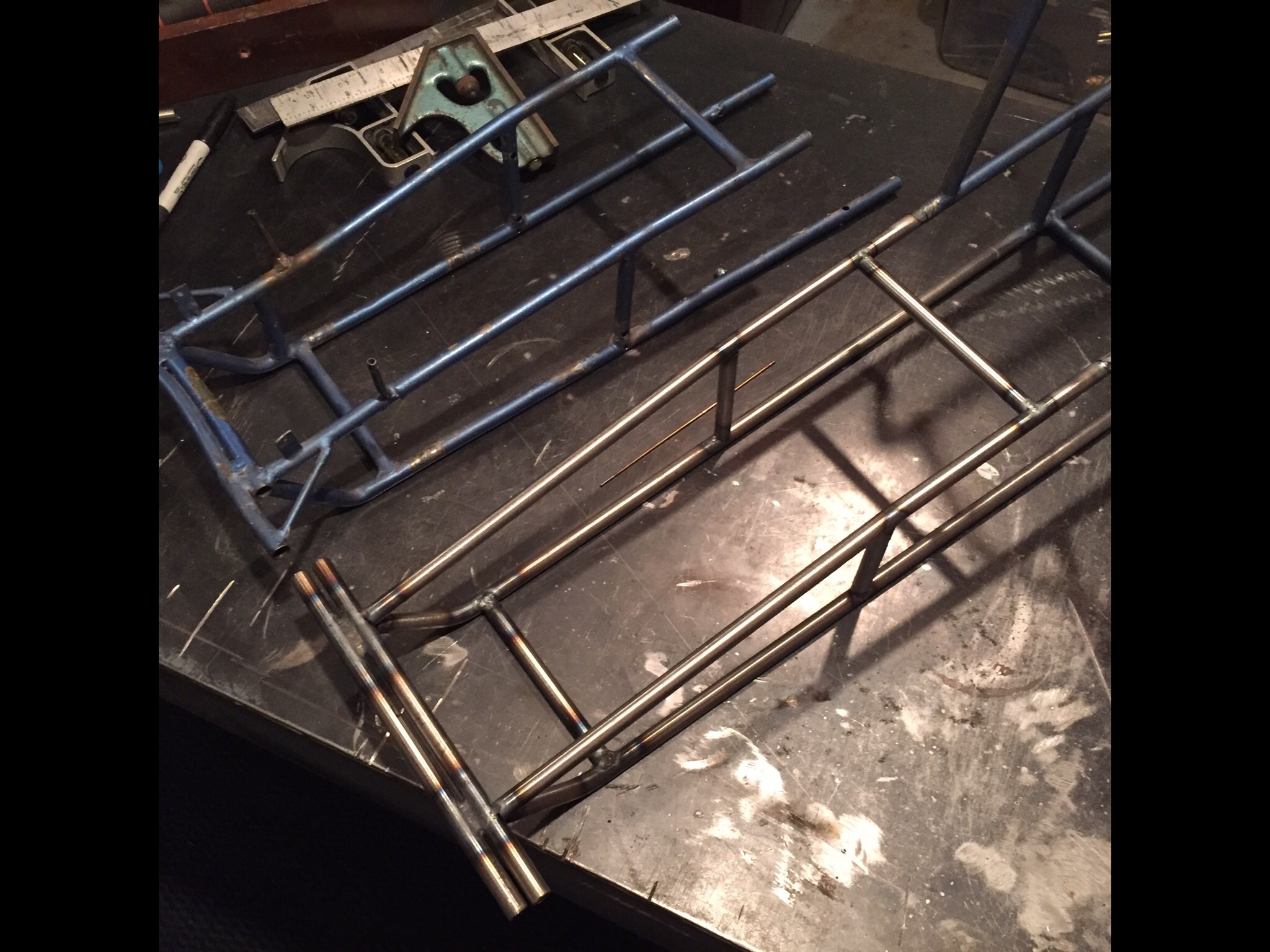

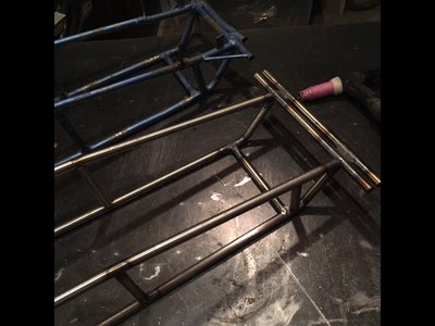

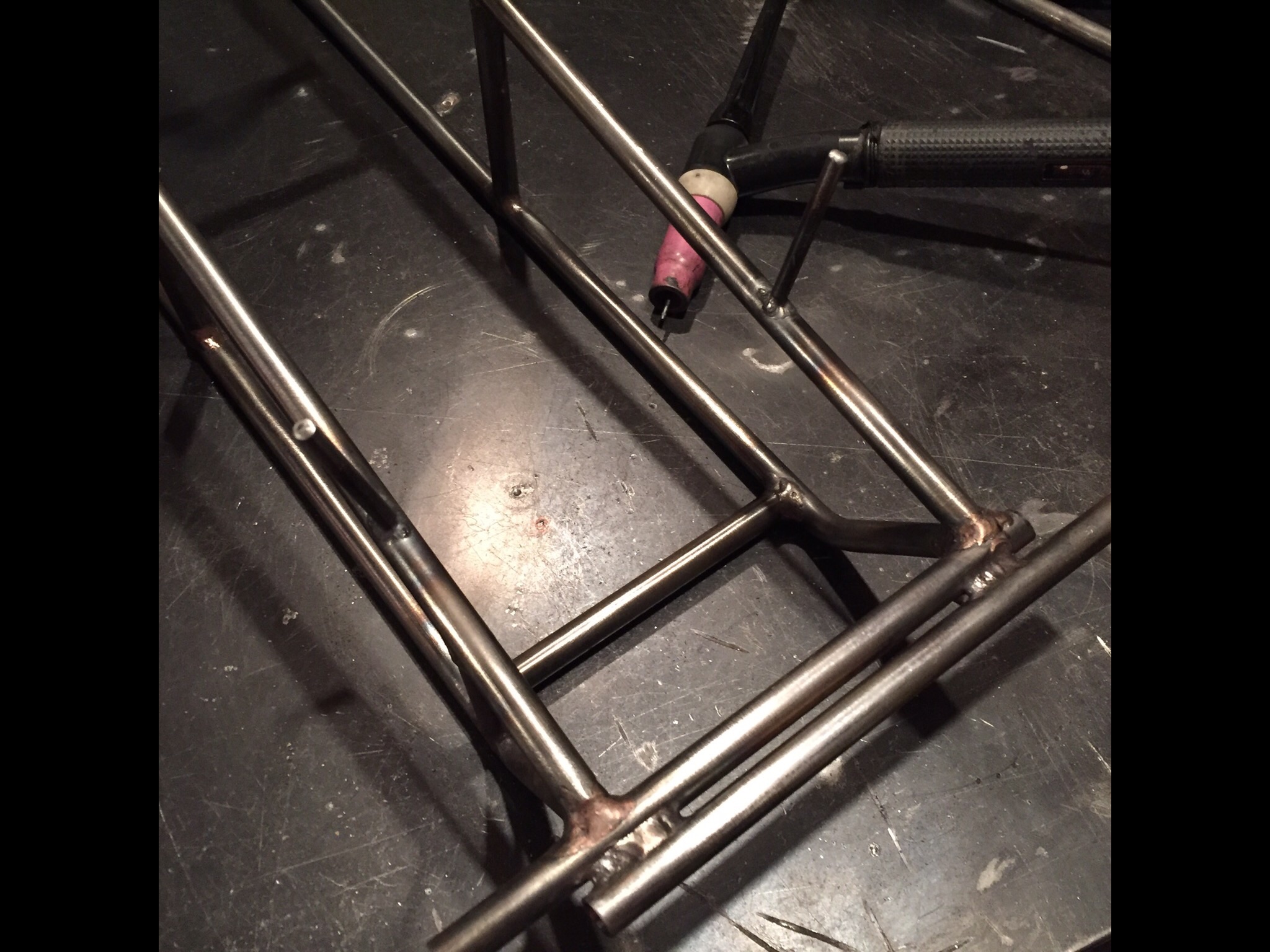

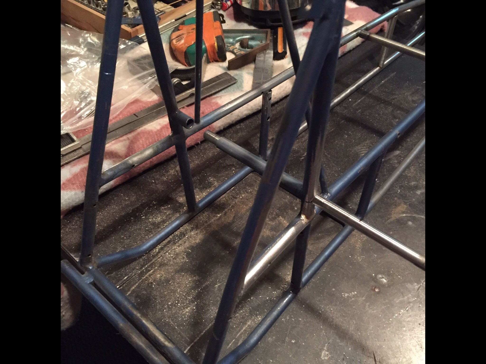

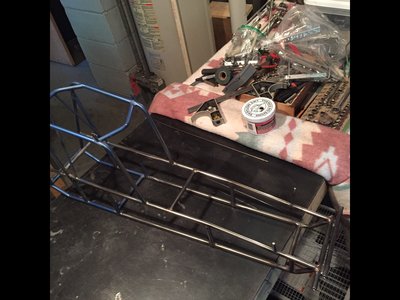

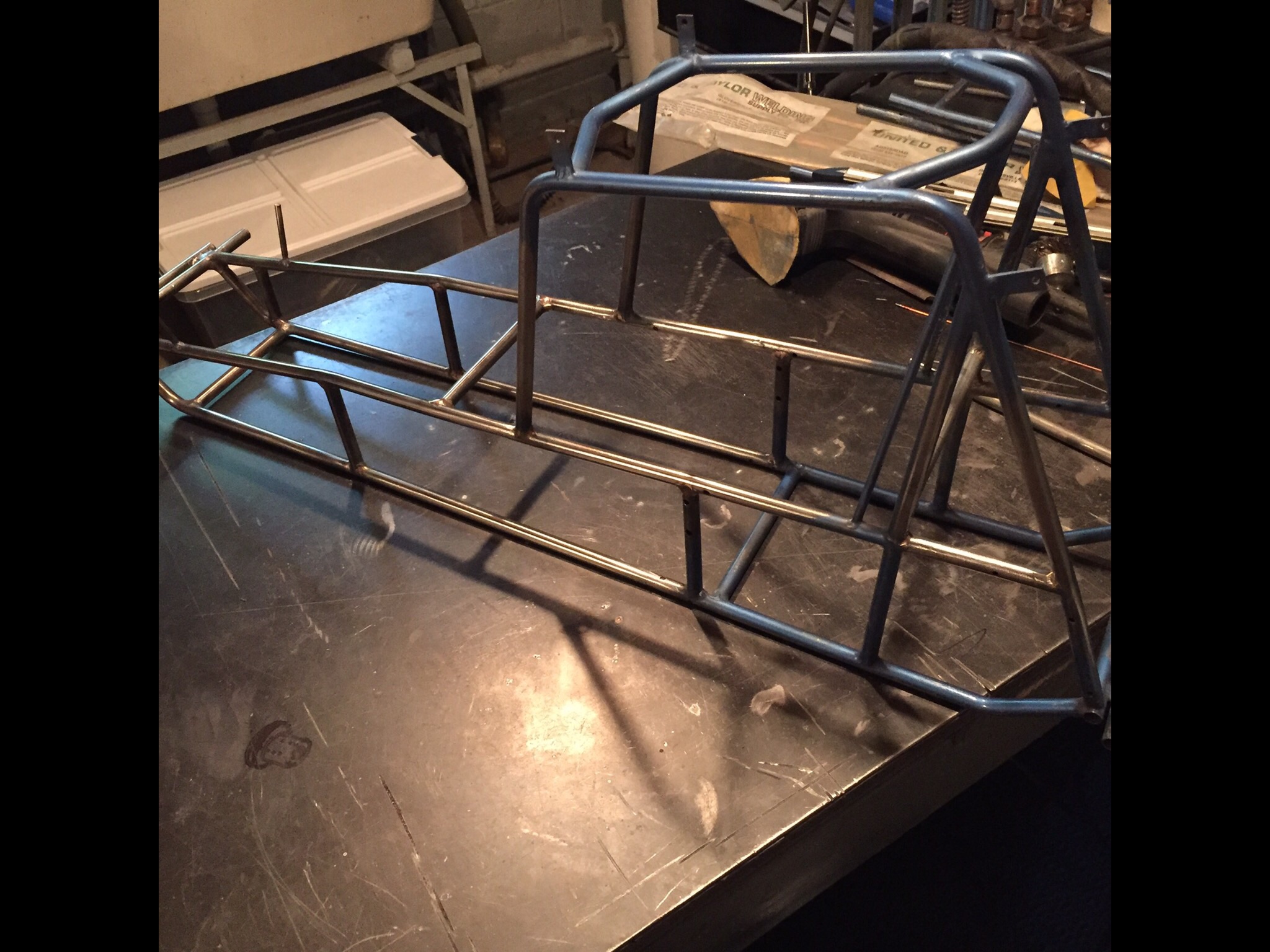

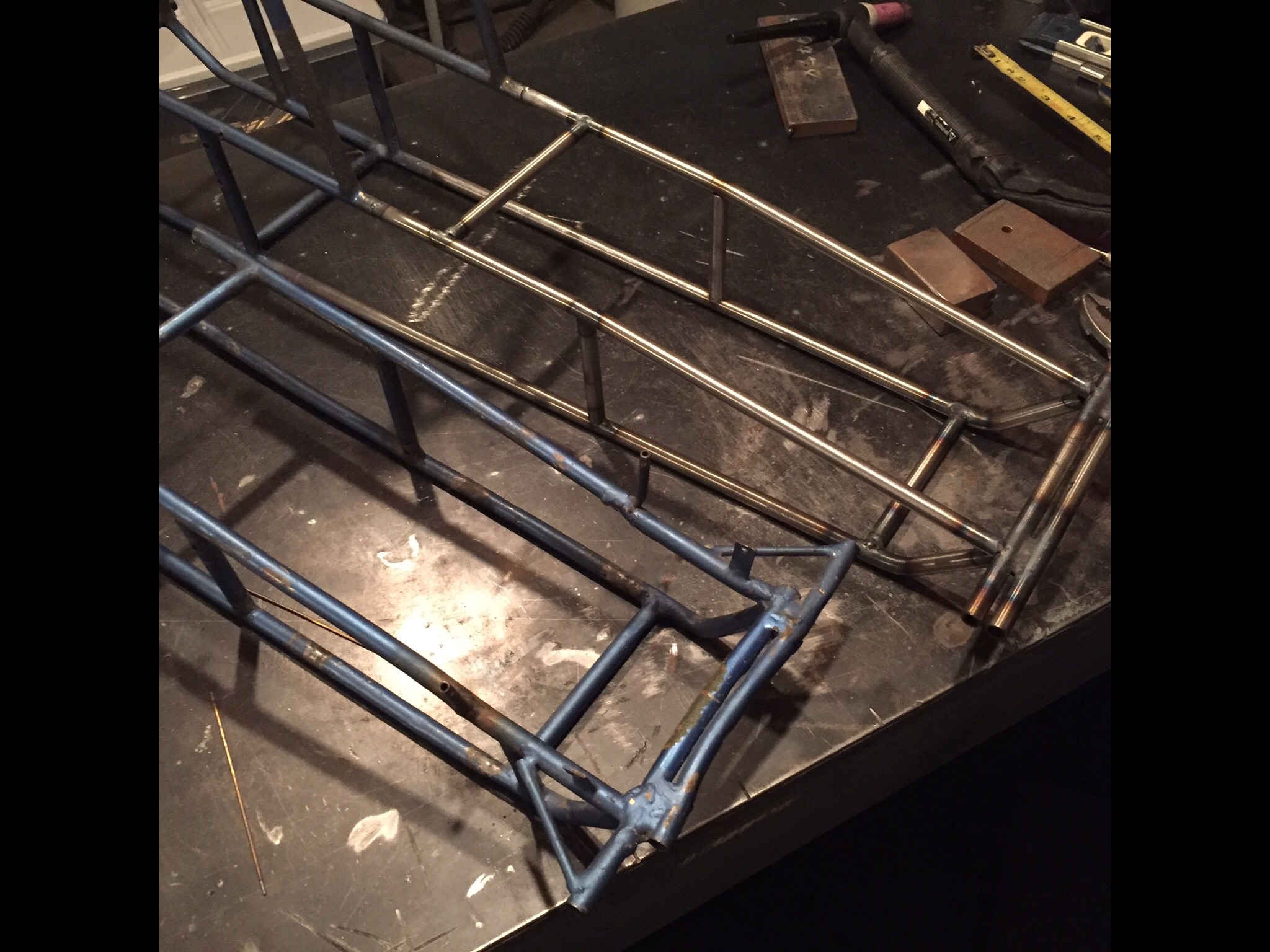

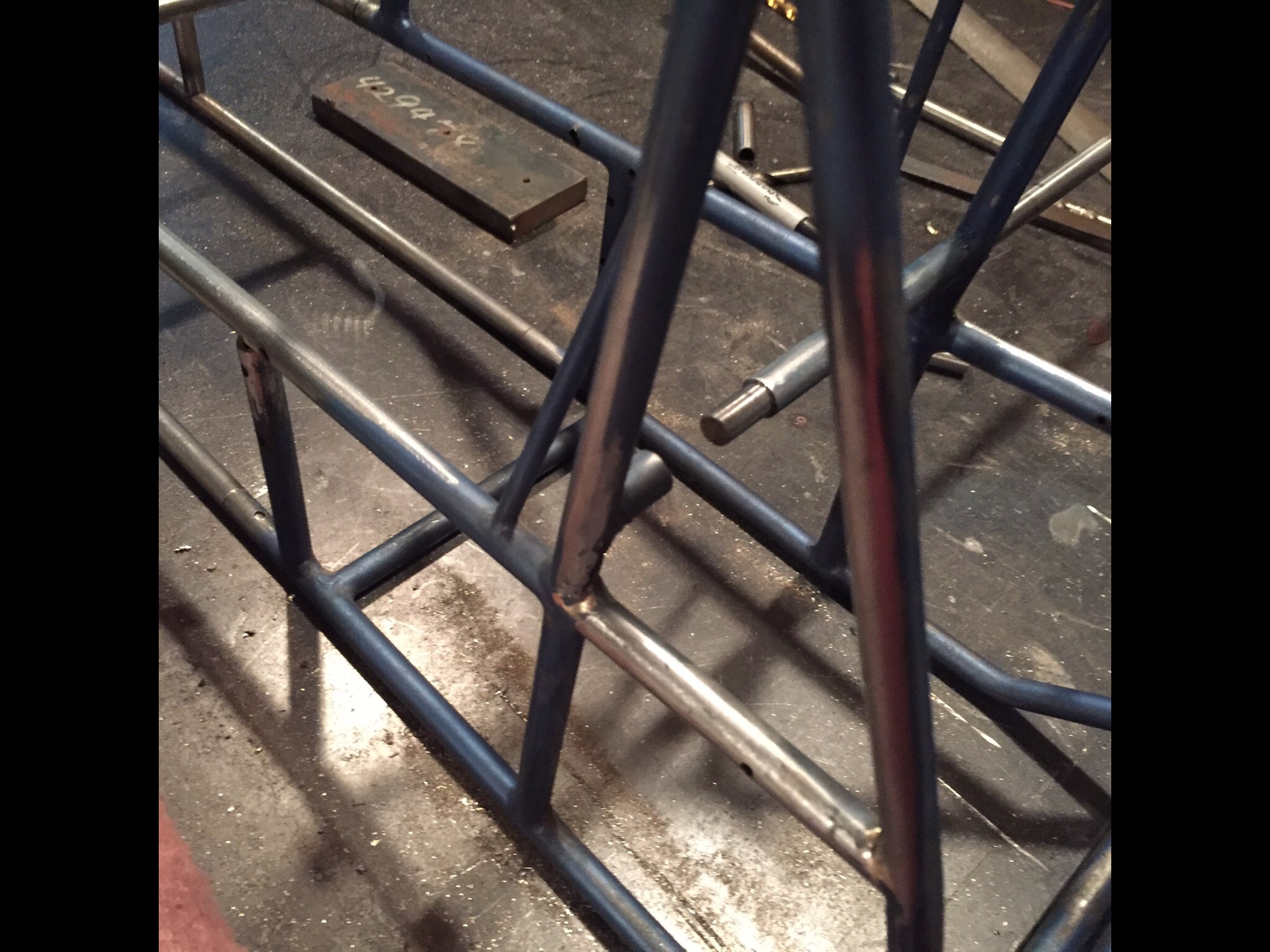

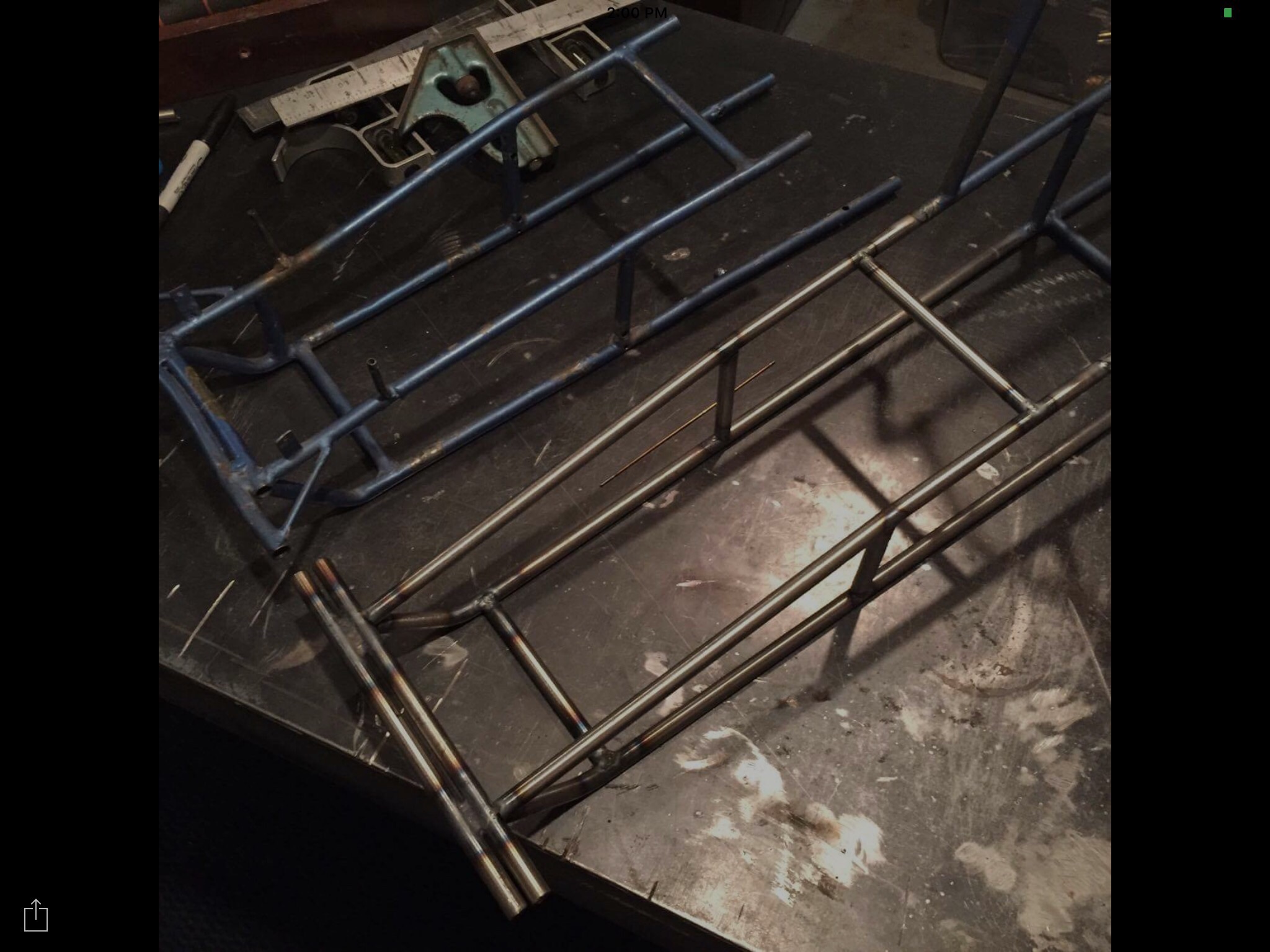

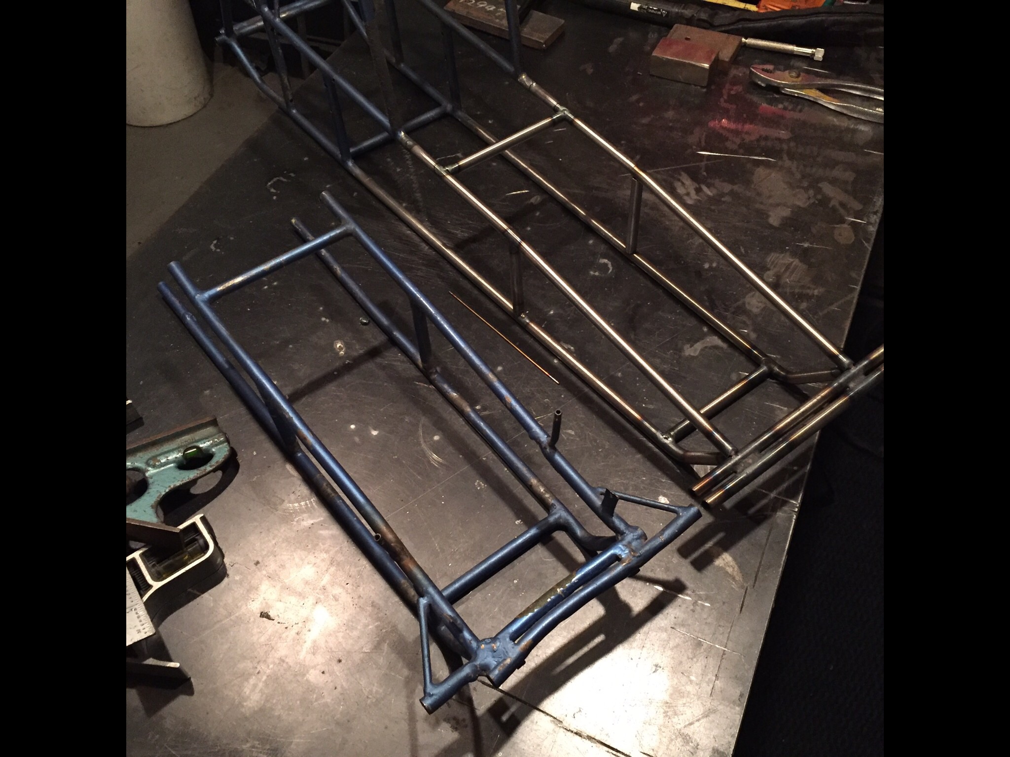

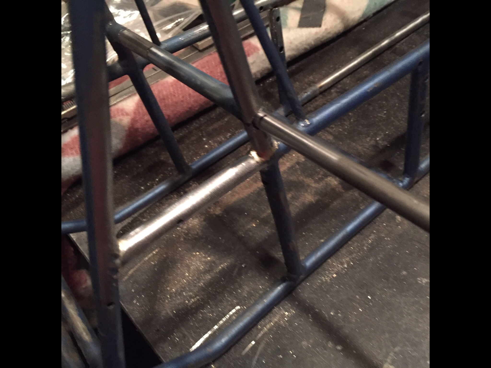

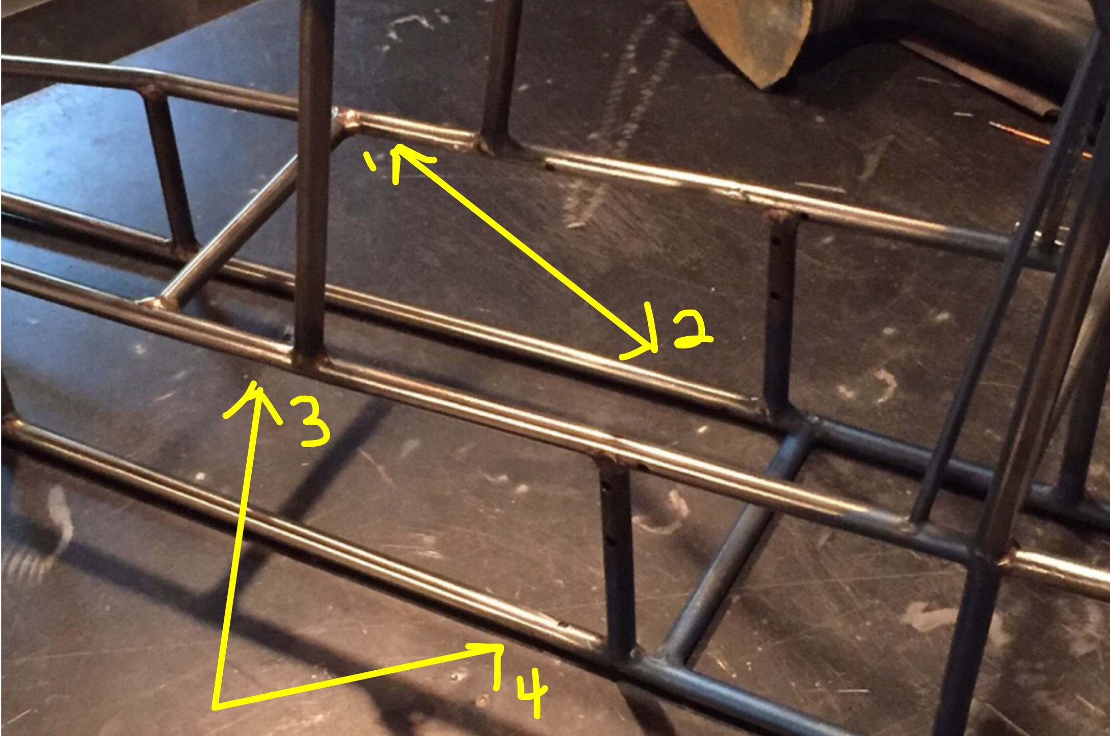

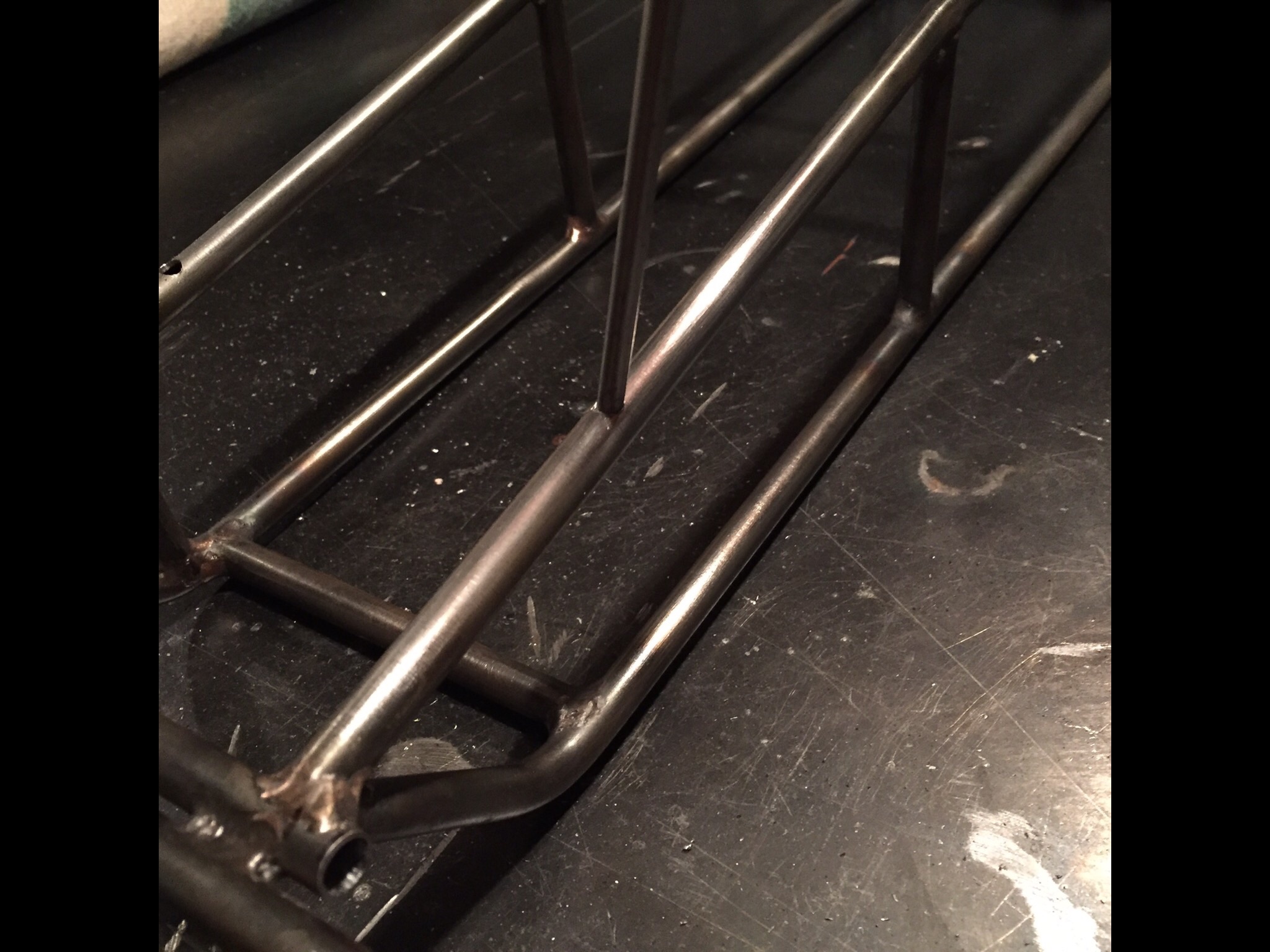

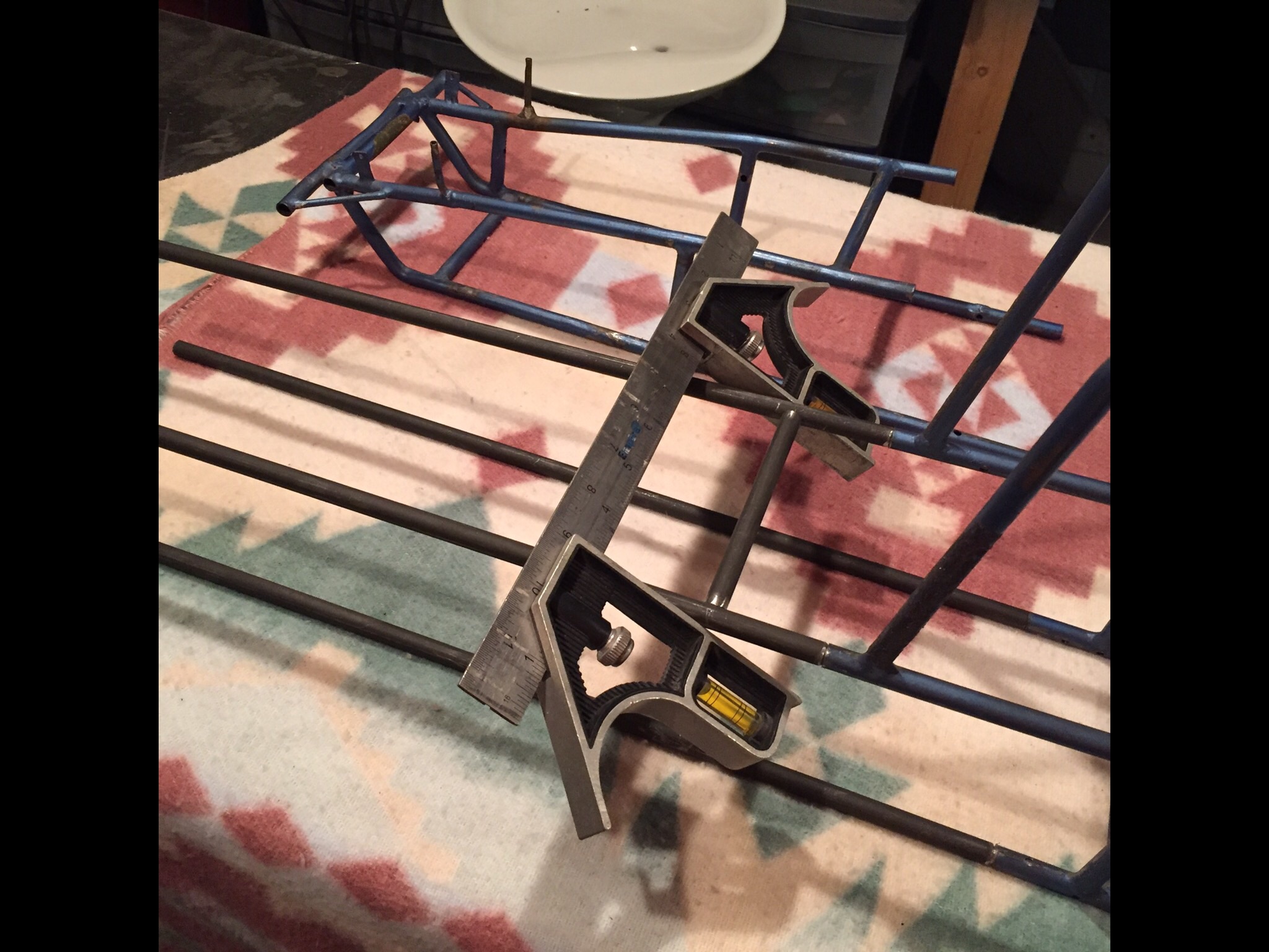

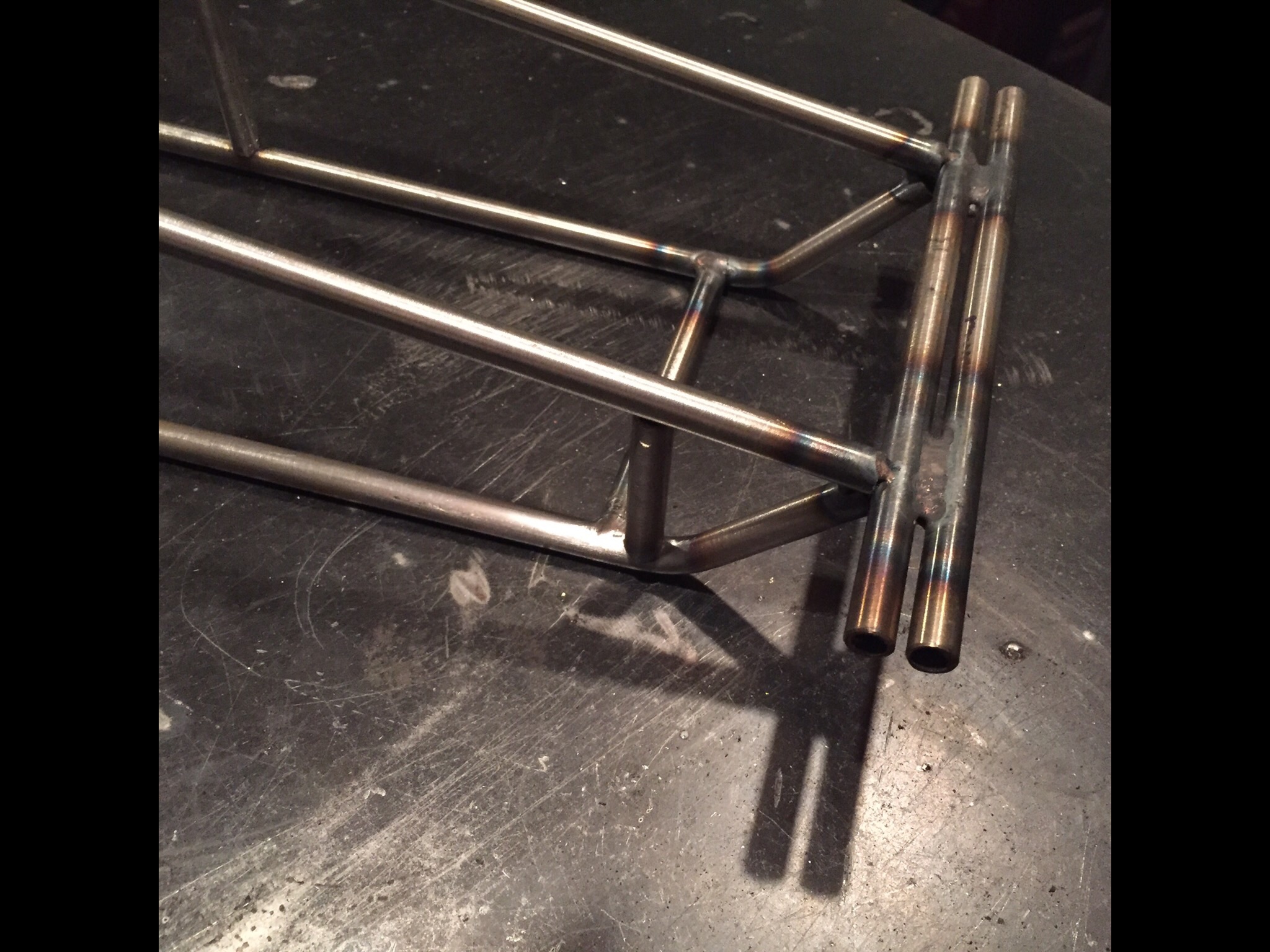

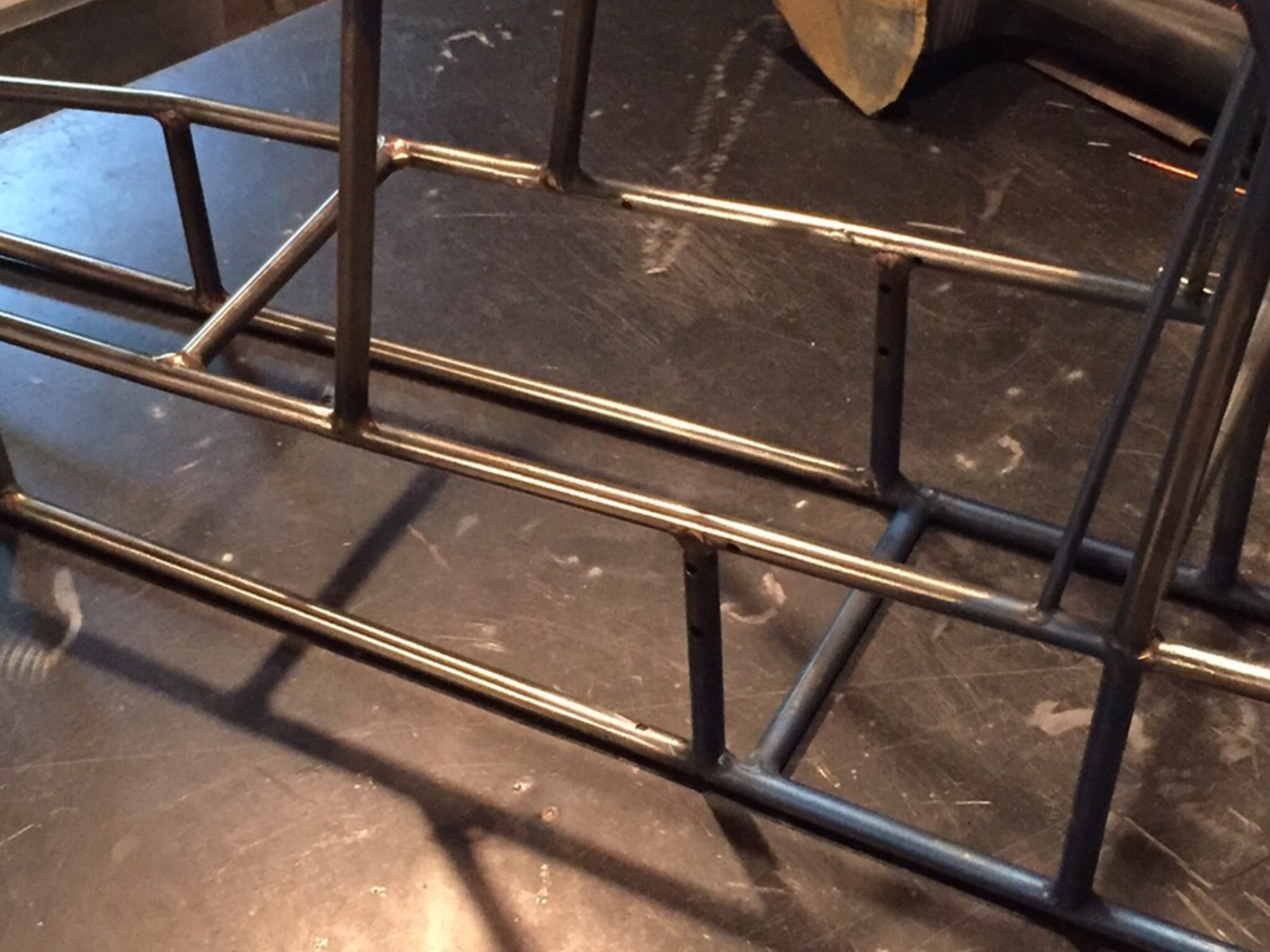

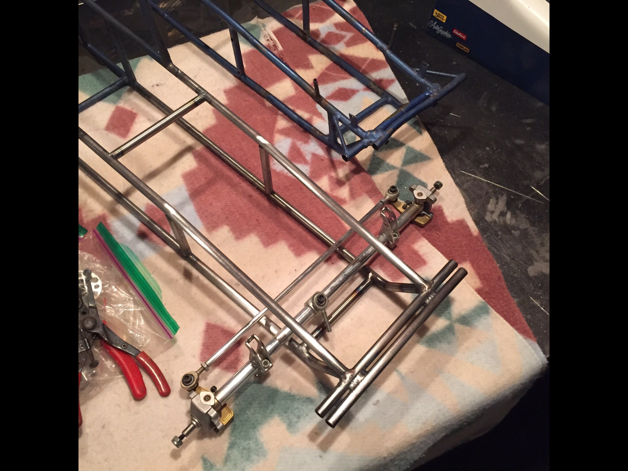

Chopped her up. She needed a complete front end. Wasn't attempting to fix her
All joints have a solid steel doll rod pressed in them to keep the new tube straight and tight
I used silicon bronze to weld the joints up keeping in good faith with the way it was original welded up
Except for the four connecting joints to the original frame

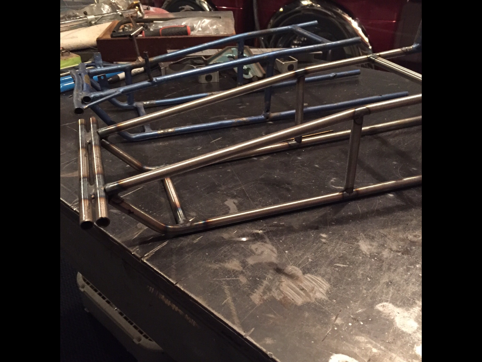

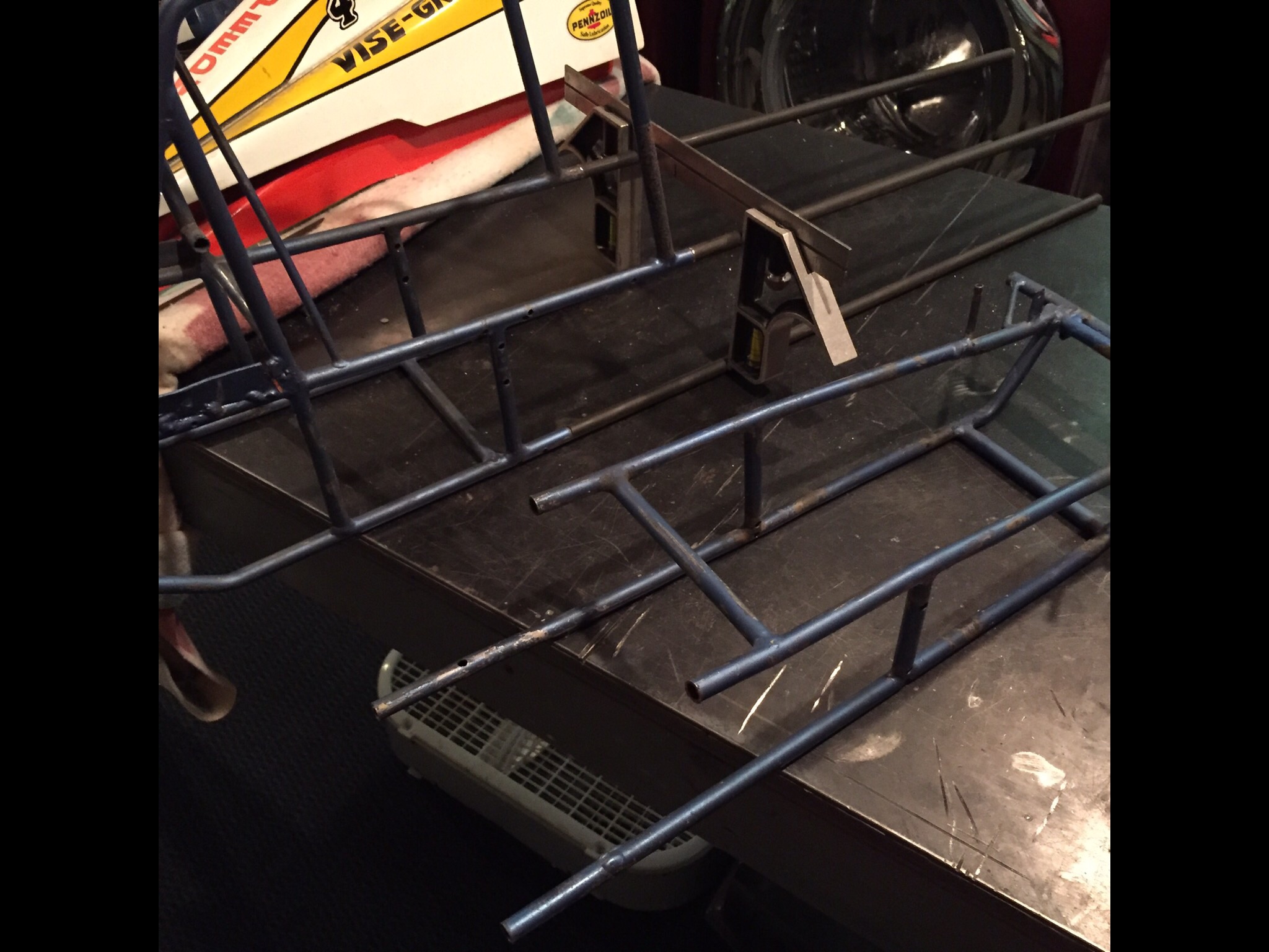

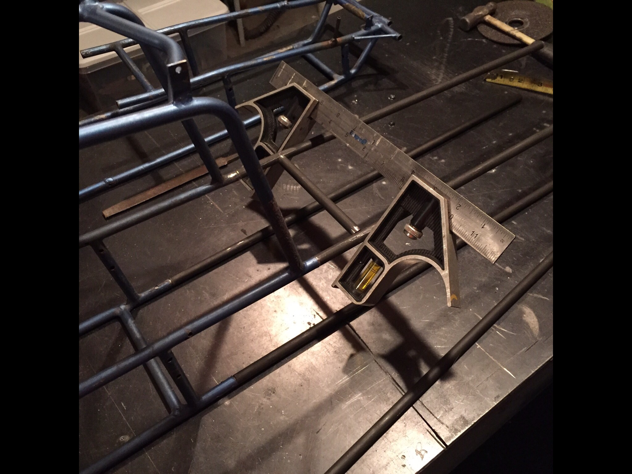

Again. Moving toward

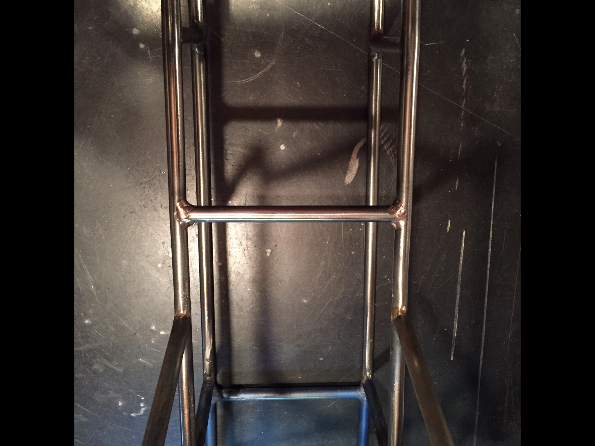

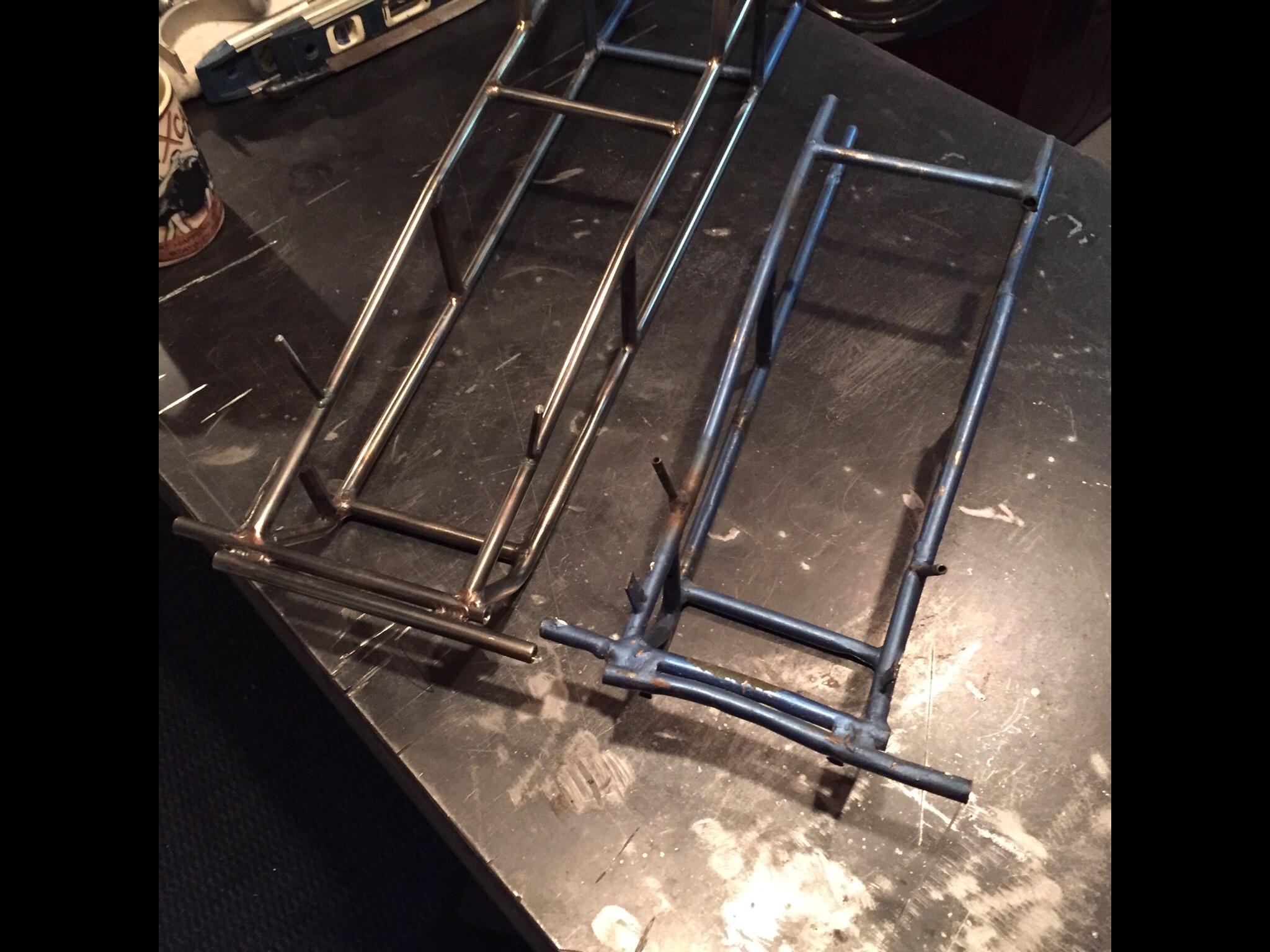

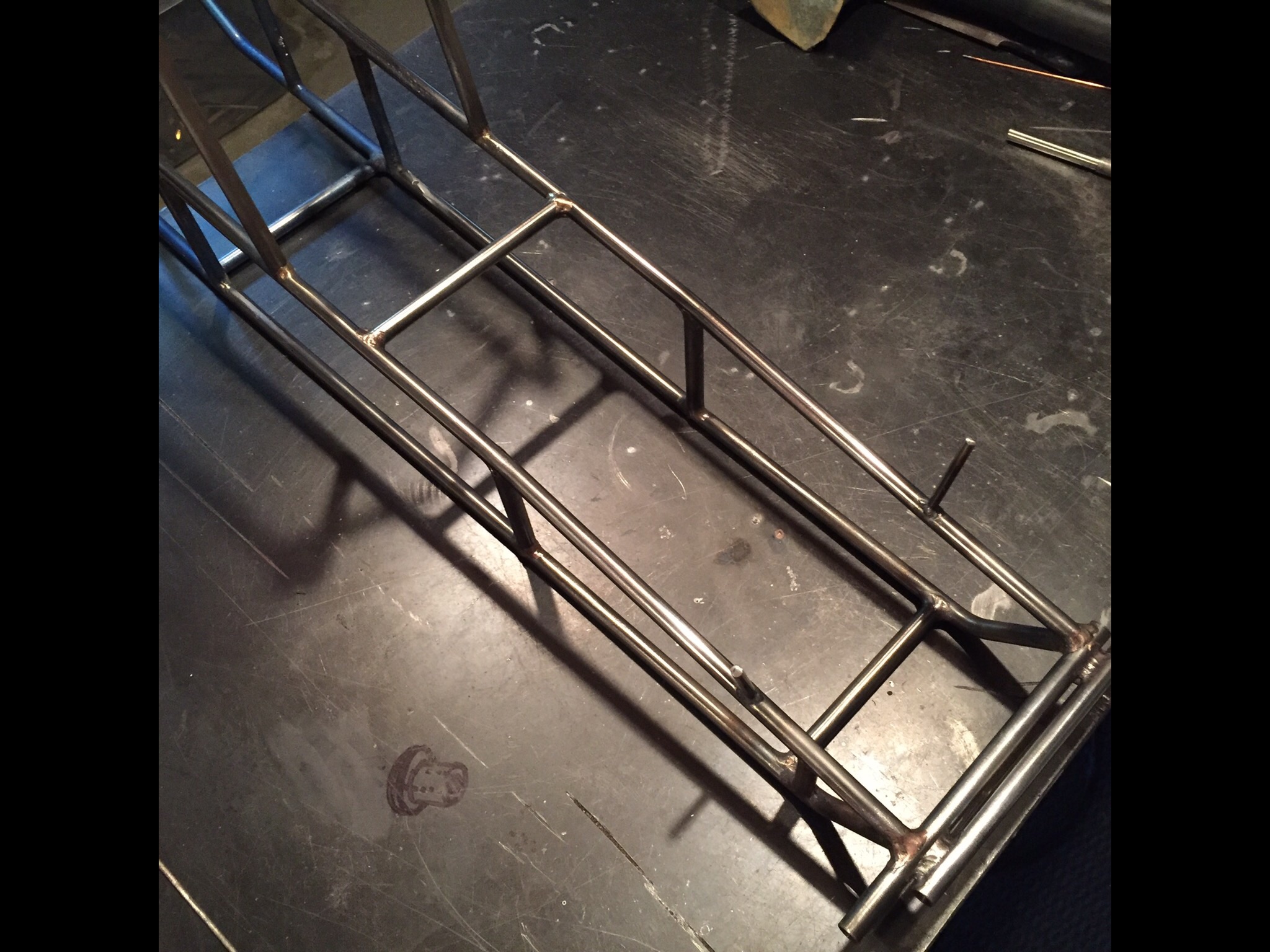

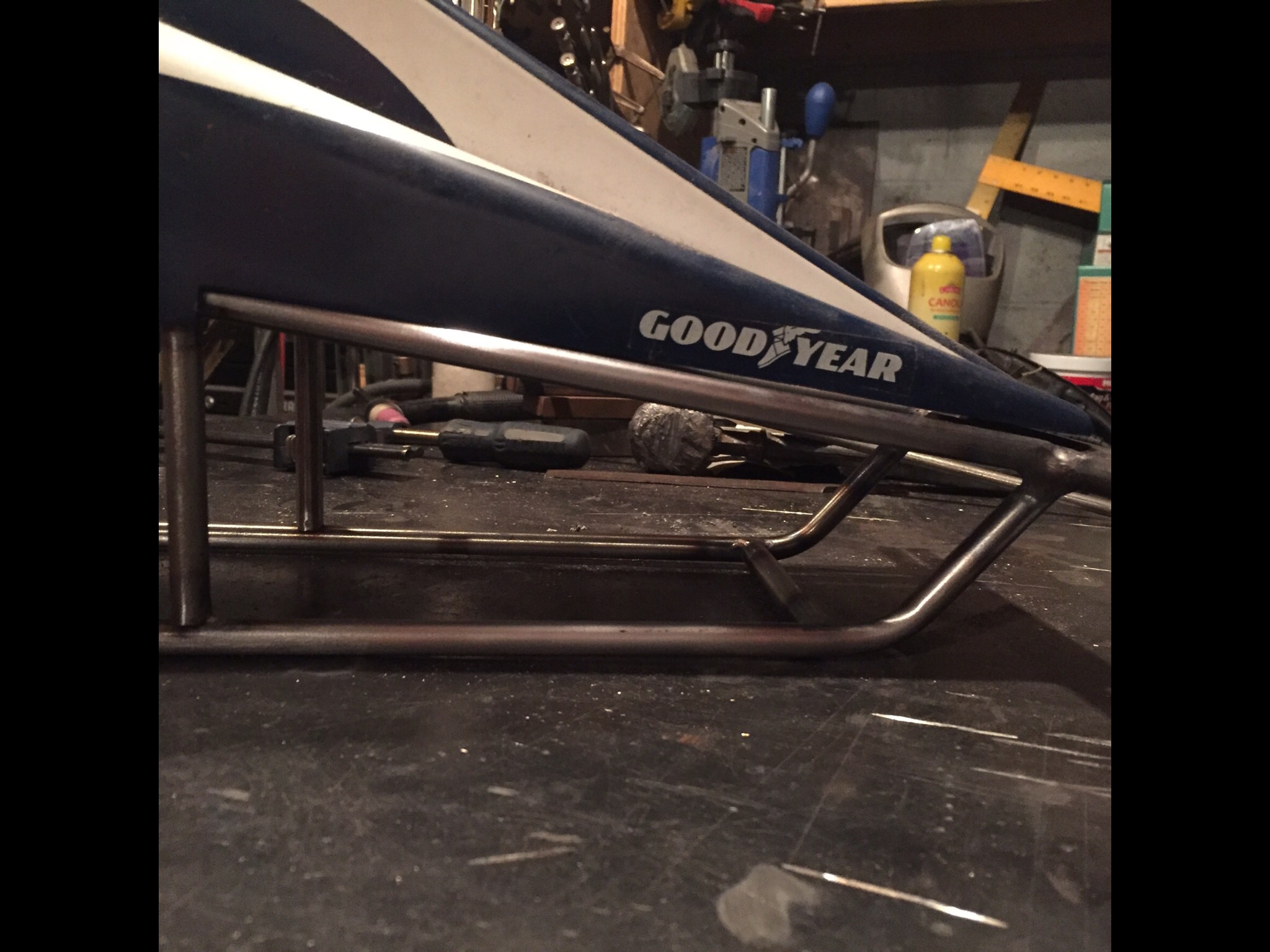

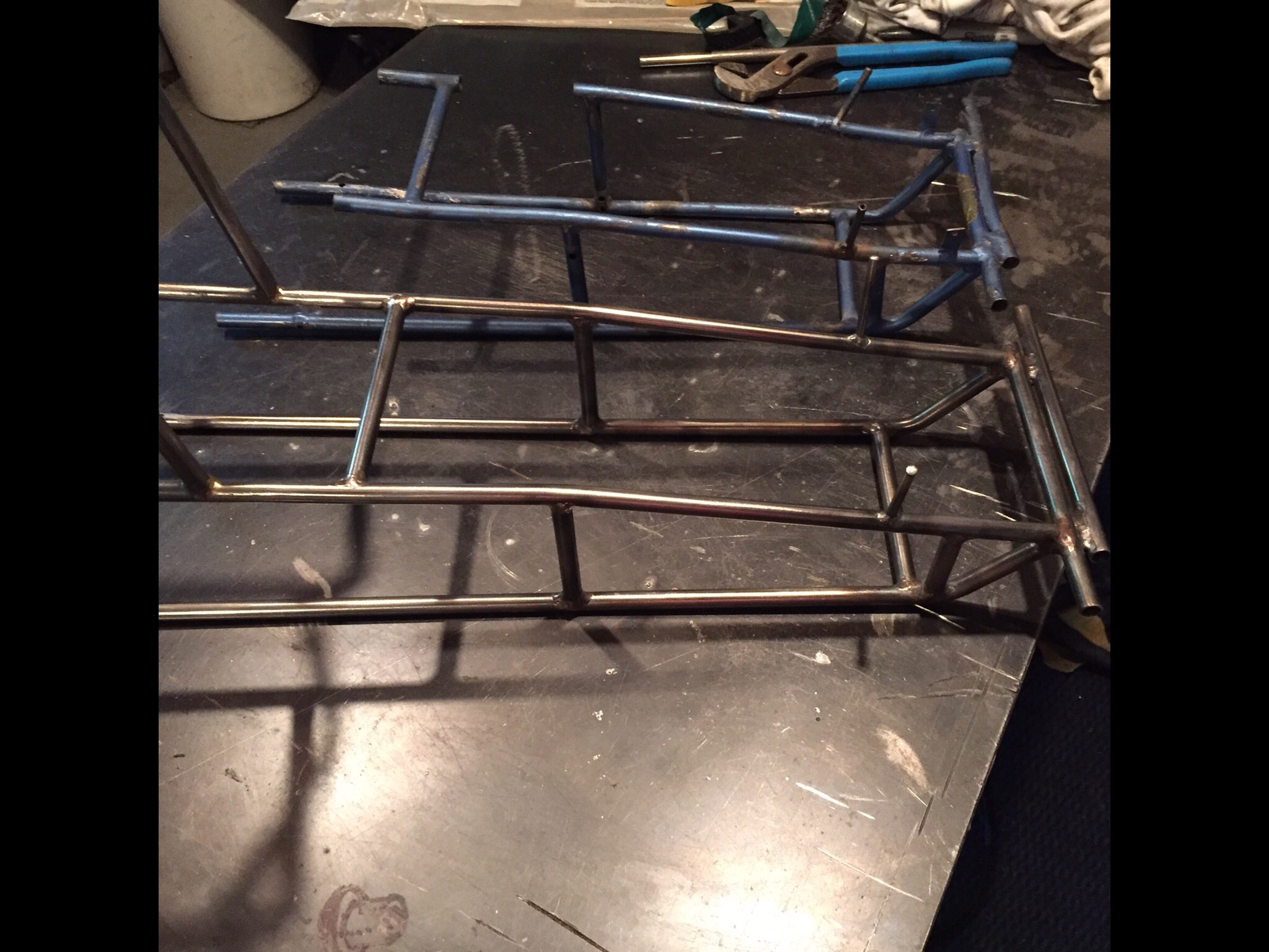

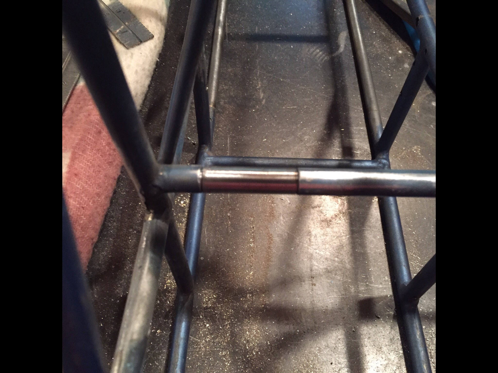

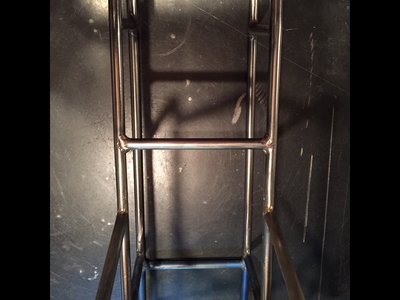

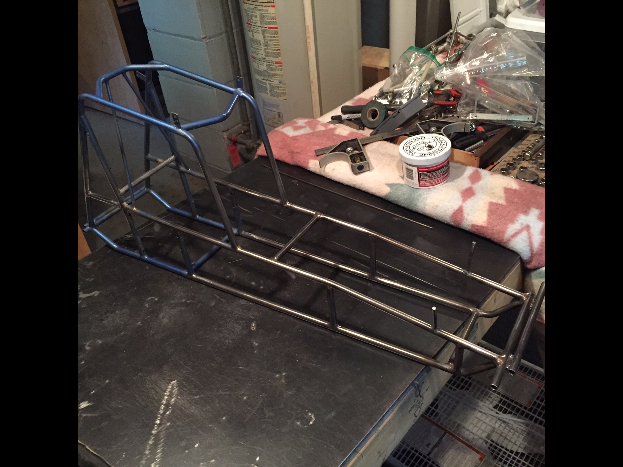

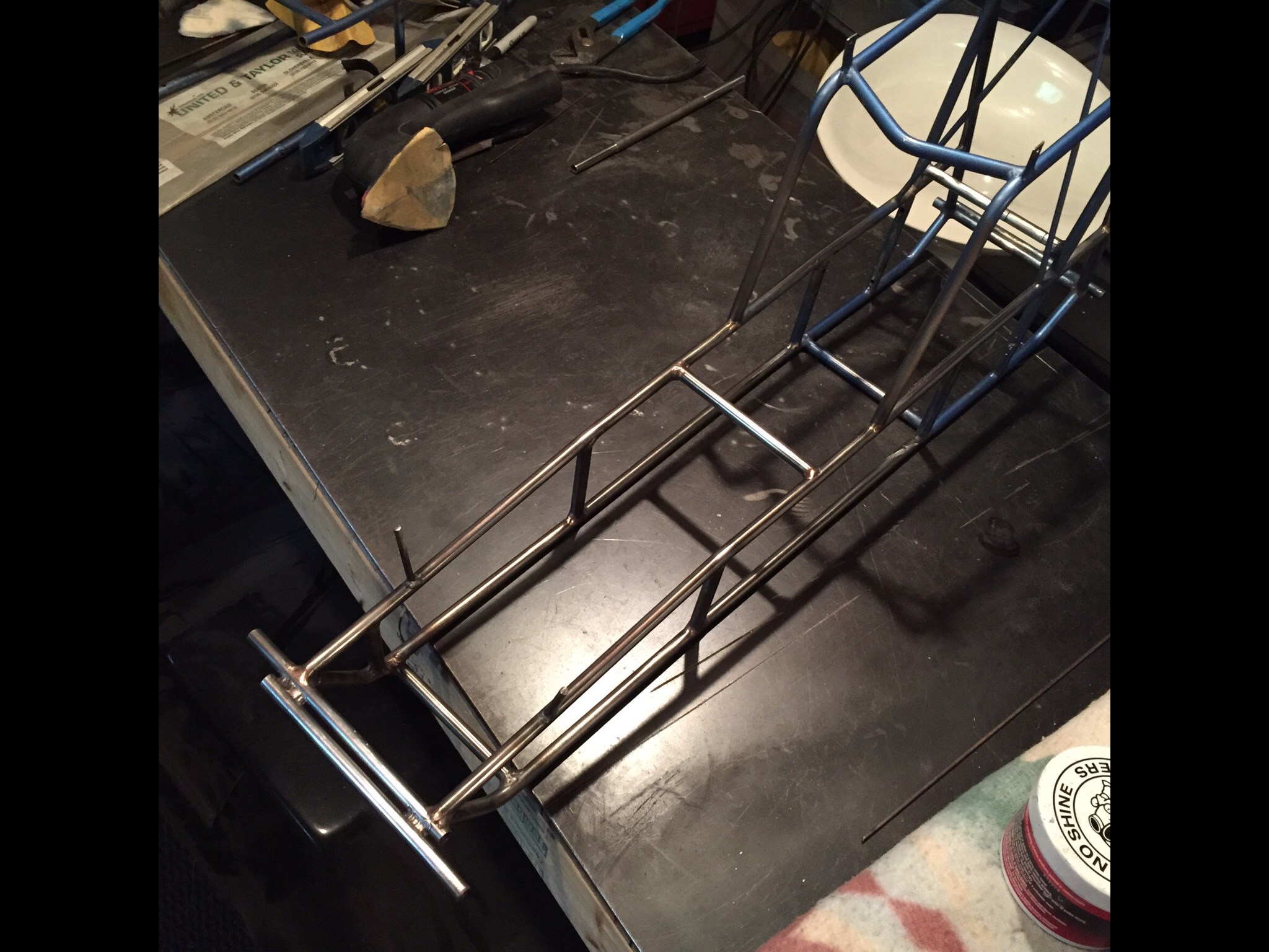

Getting closer. The rear bar was cut that hold the tank up. So I stuffed a solid rod right thru it and cut a piece to suit the space. Still needs welding. The outside where the bar went thru is welded up and filed down. You never can tell I was there

A little more progress

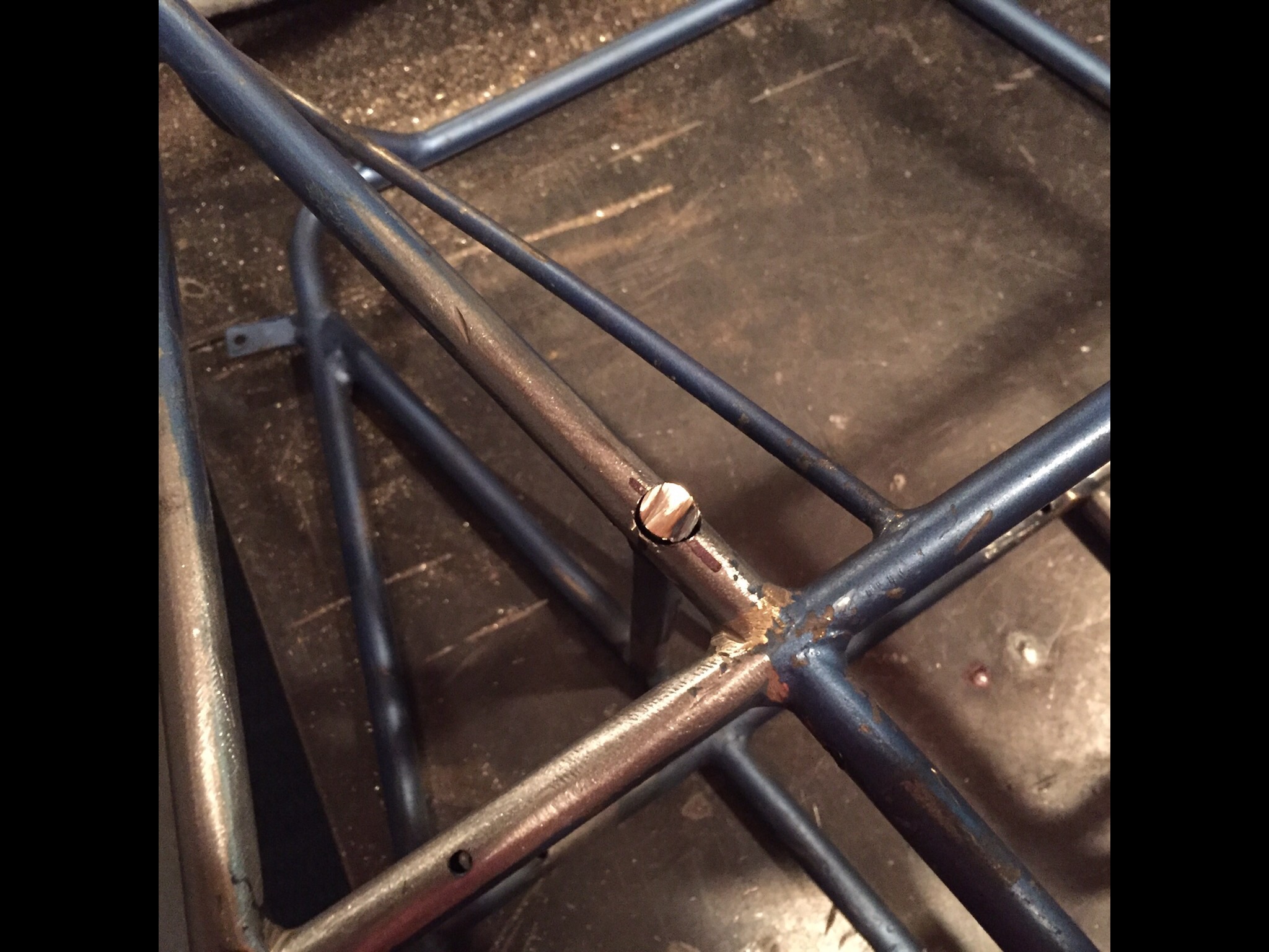

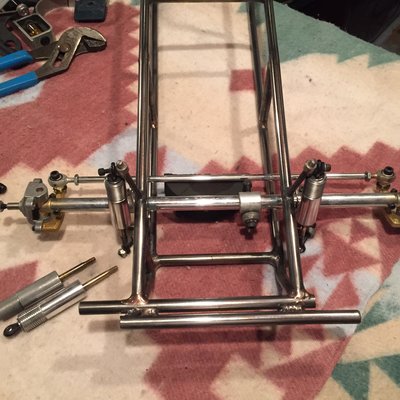

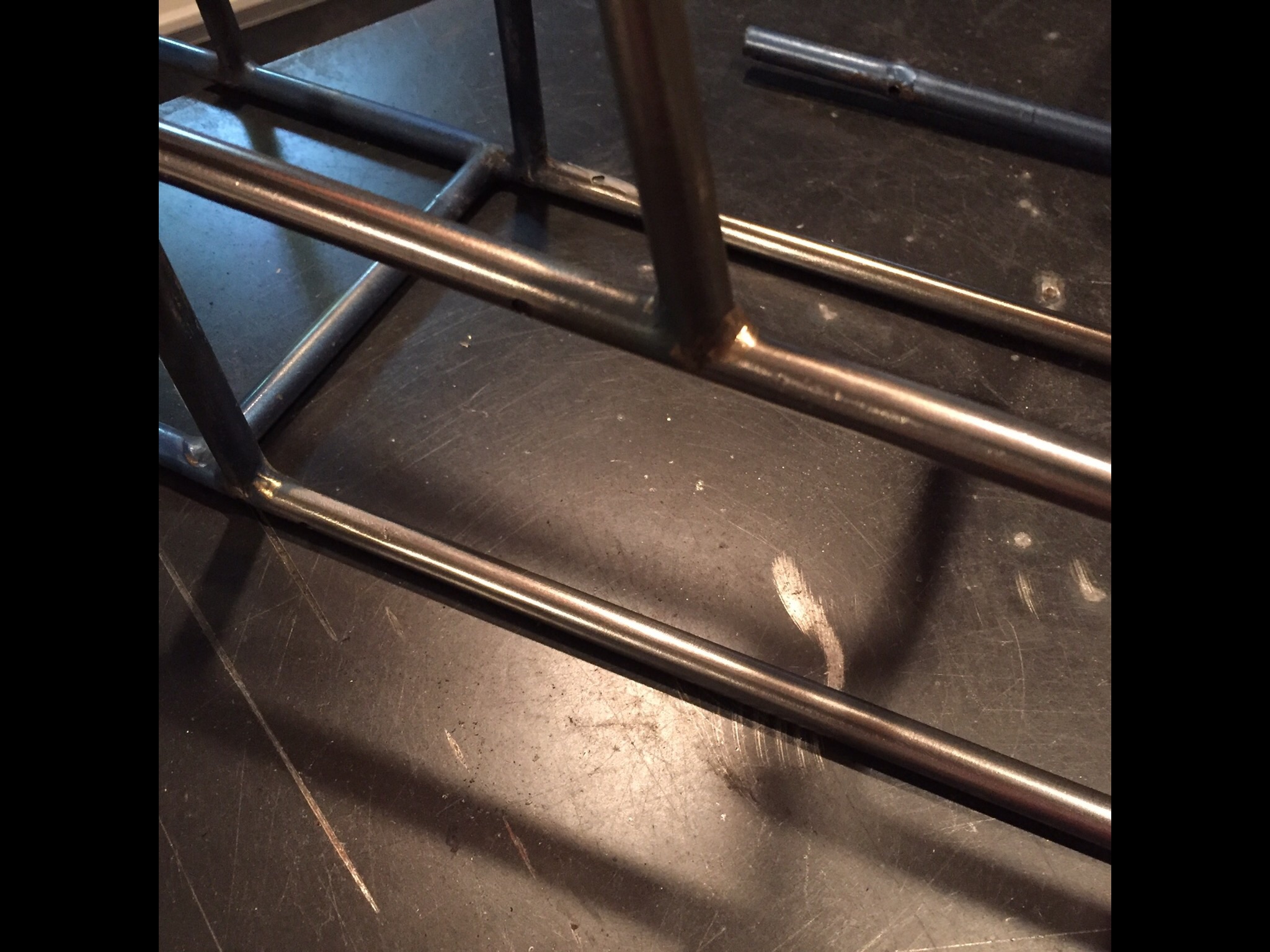

I welded the four joints attaching the new section ( the mid to to front end ) to the original frame with 80S2 for a stronger joint and pain stakenly filed them down so you neve pr know I was there. The solid round stock pressed inside made for a great fir and weld prep

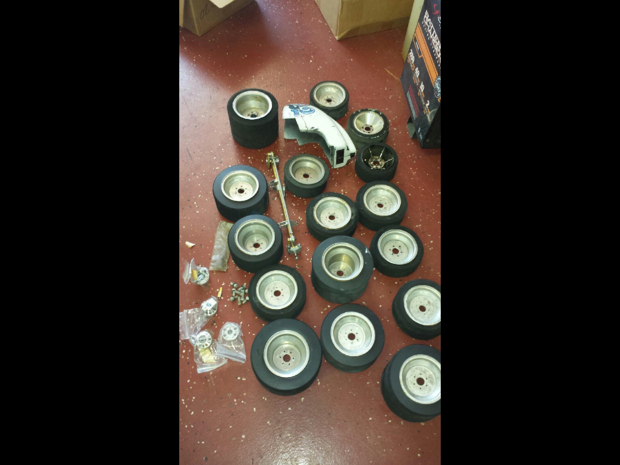

I got this project at such a great deal I refused to let her be disregarded. I think the skellenger axle alone almost paid for the whole thing. Lol. She's alive to race another day. I have a new motor for her and of course she's getting my tires .... The car came with a total of 20 rims and tires. Tires are no good but the rims are in great shape. So. I'm making yet more tires. Lol.

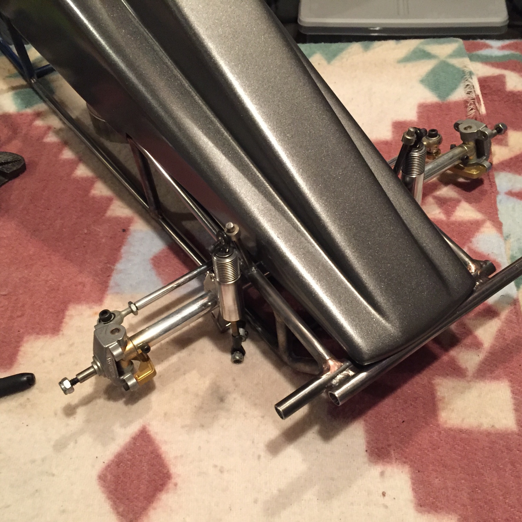

Some positioning and paint choices. I love this color. Dry sprayed Not on purpose. Soooo. Tomorrow I'll wet sand it and try again

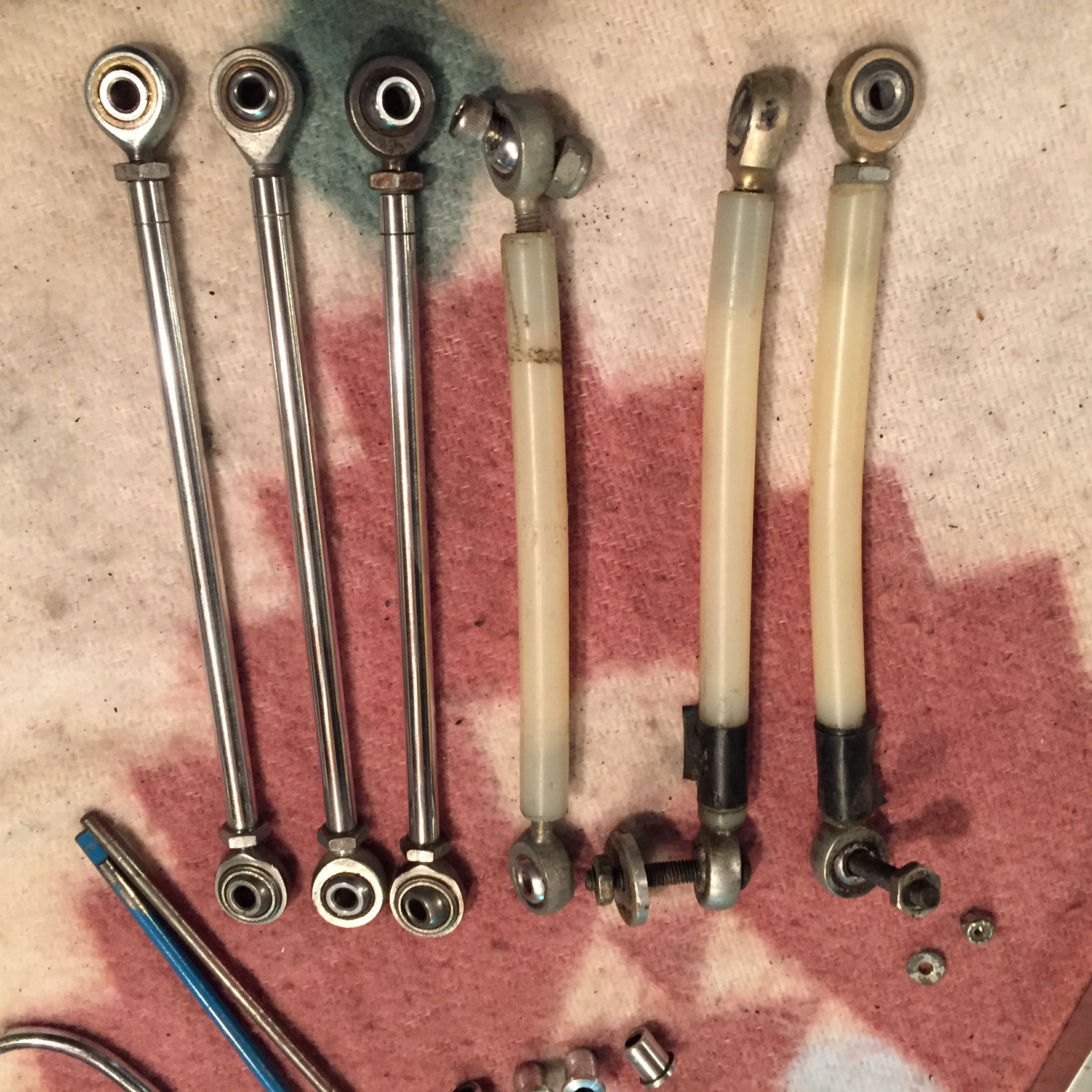

Posts: 397

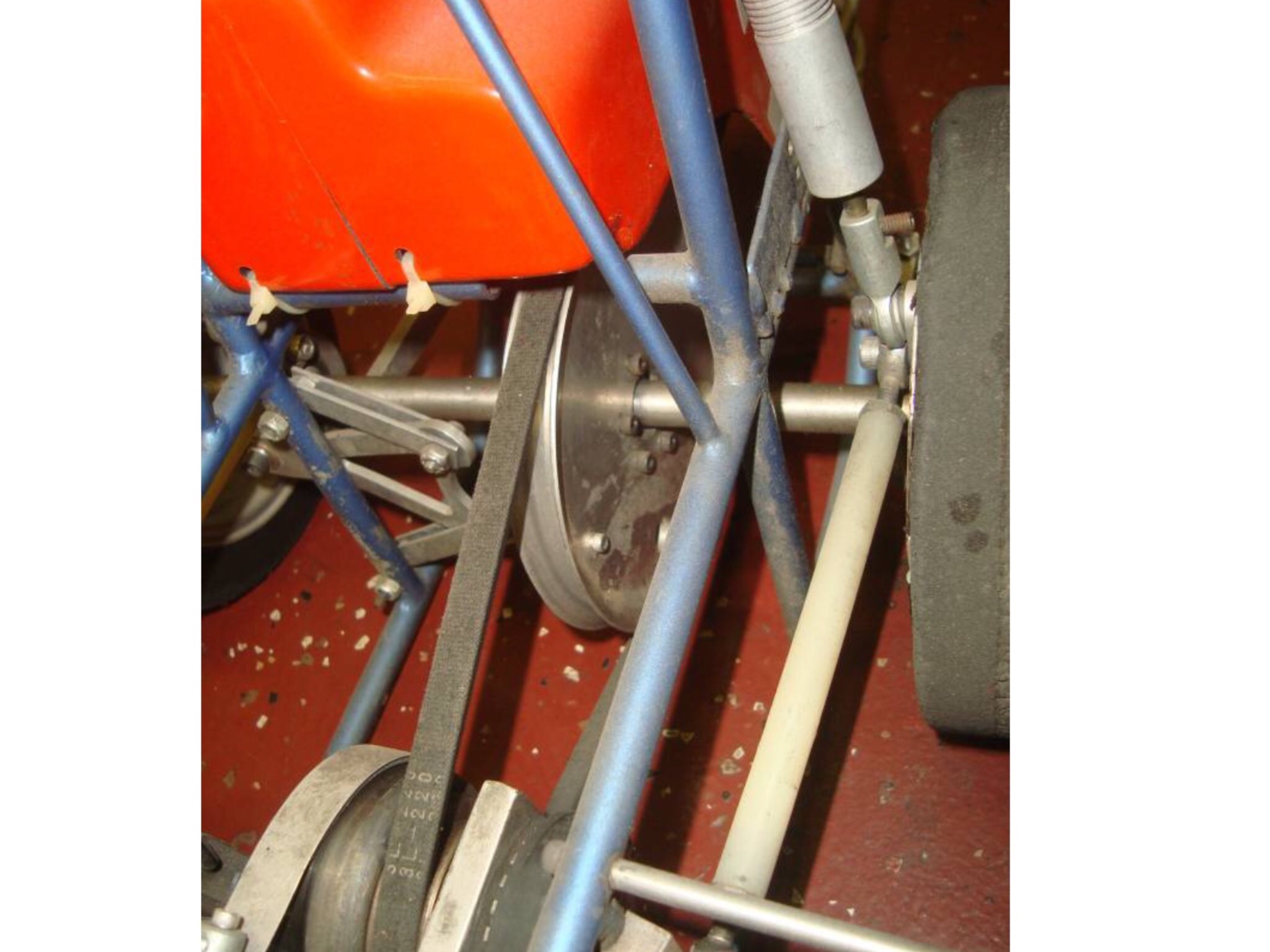

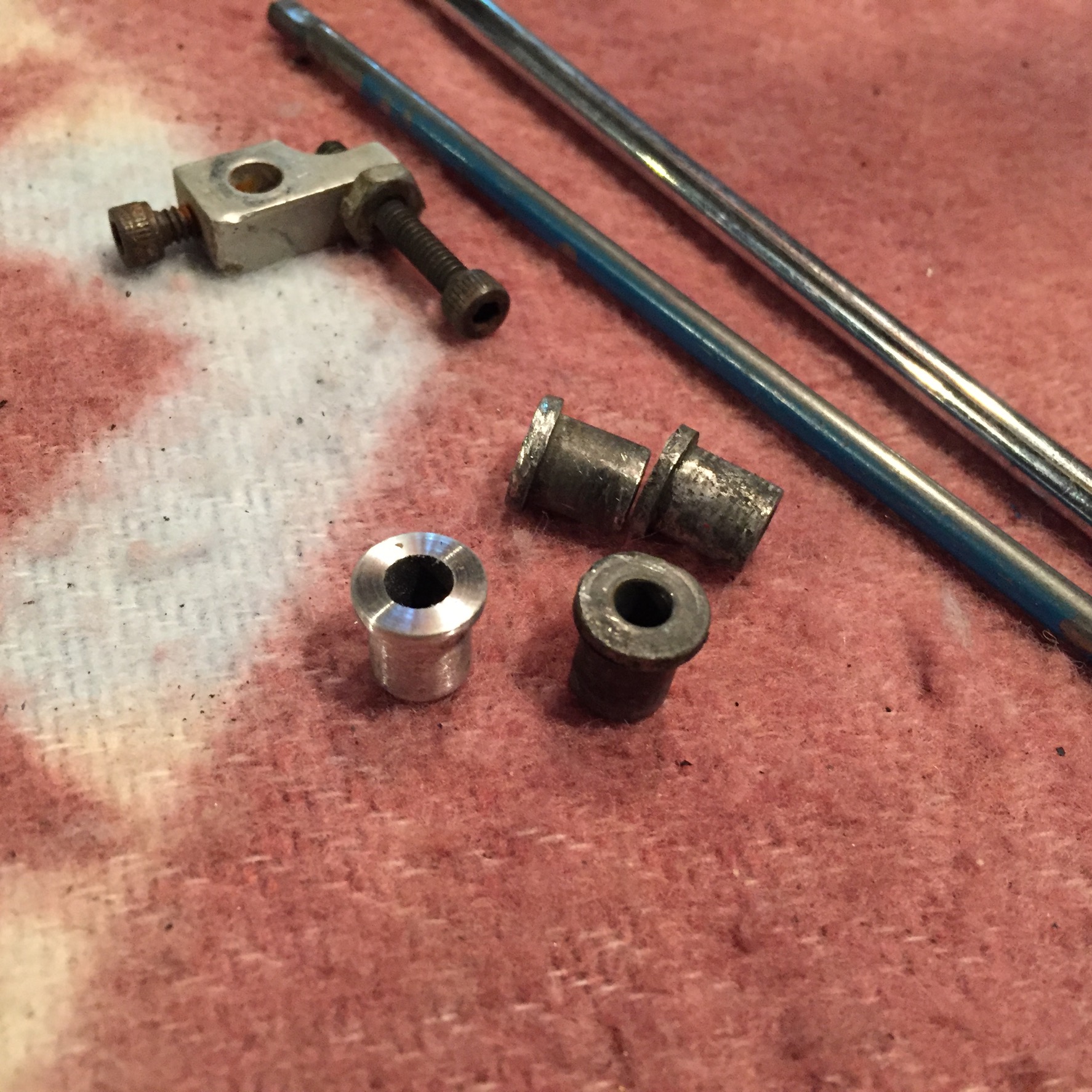

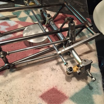

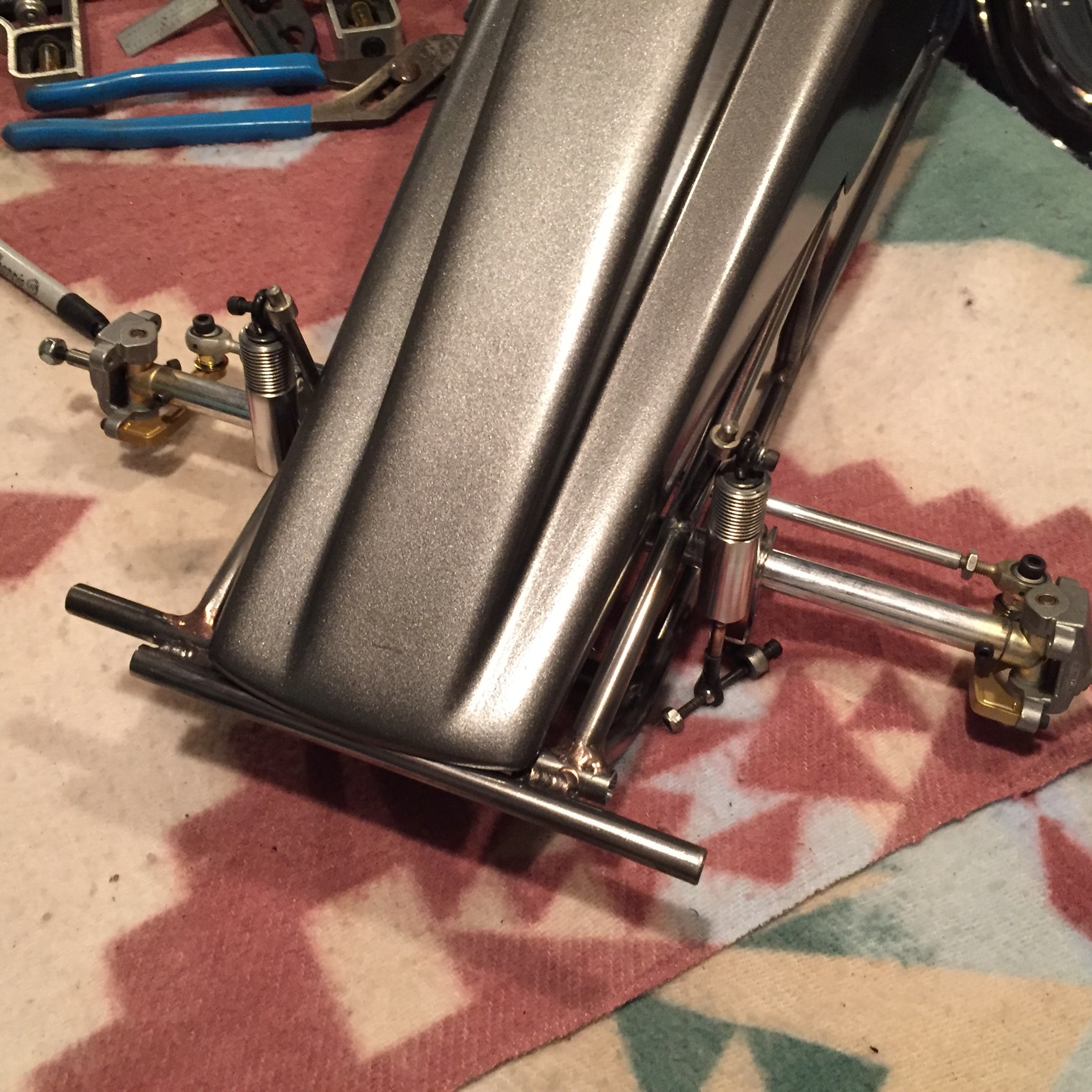

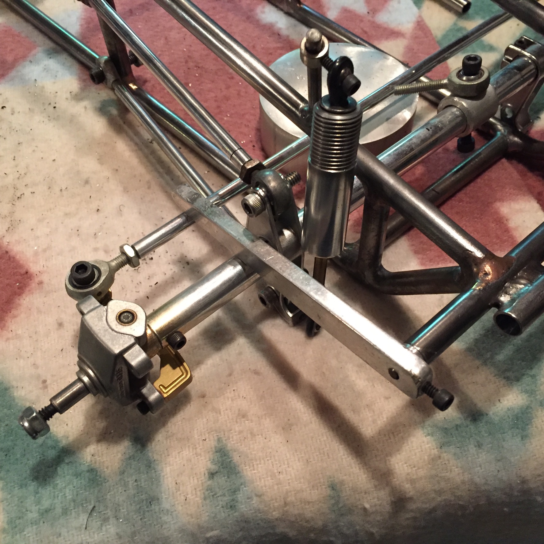

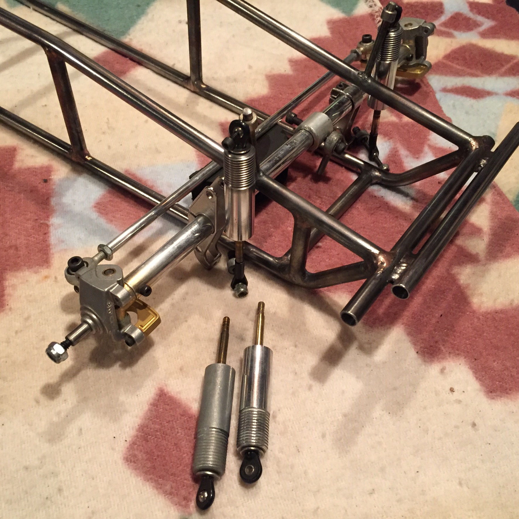

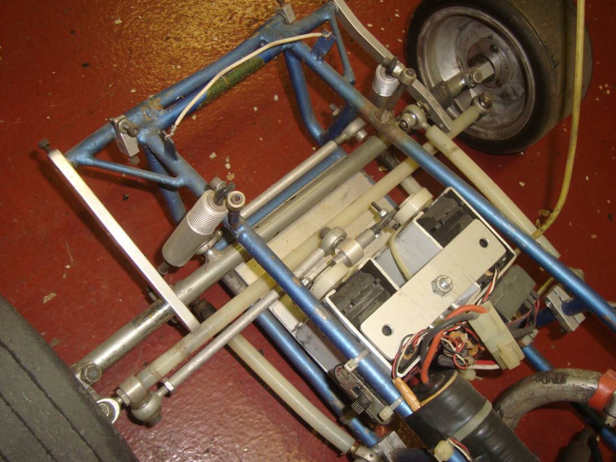

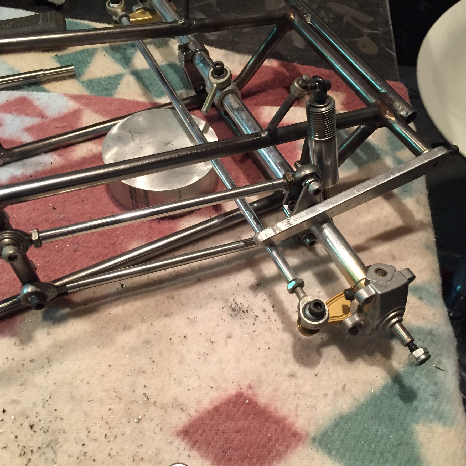

Moving along.... Had to replace the front arms on it. Never seen any one use plastic rods but I guess they worked. Drilled some holes in the new section of the frame for the front arms
