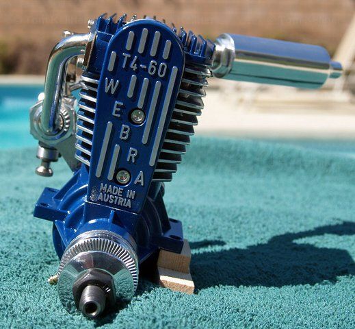

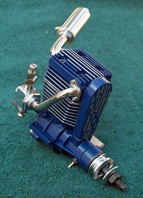

I purchased the webra T4 60 nitro off eBay and will see how this fits the Gilmer. It seems to be plenty powerful for the car and almost looks like it will fit perfect without any cuts but a few drilled holes in the chassis for the engine and gearbox.
If all goes well I will paint the engine as the one I saw on the internet, I think it will look great under the hood. Here's a photo of the painted Webra T 4.
Also if this engine works out I might be selling the Abitar. Thanks for looking :D

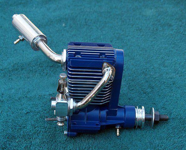

Offline
Posts: 192

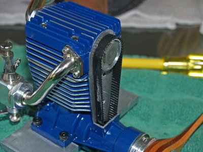

I've long admired this blue painted engine nicely restored by Tom Kelliher.

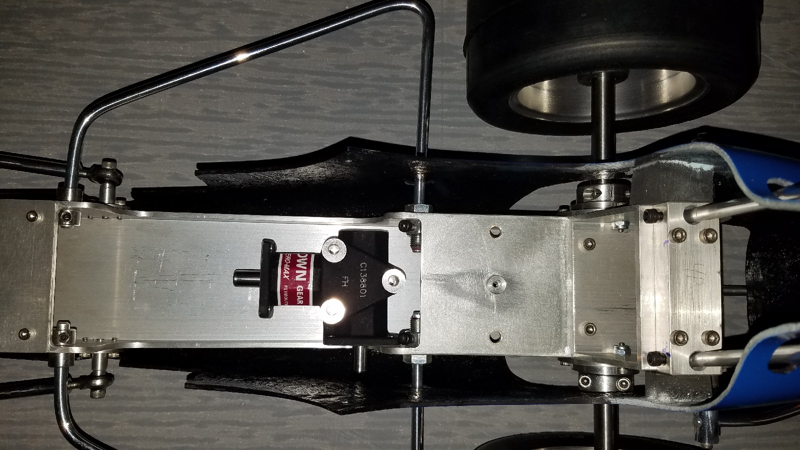

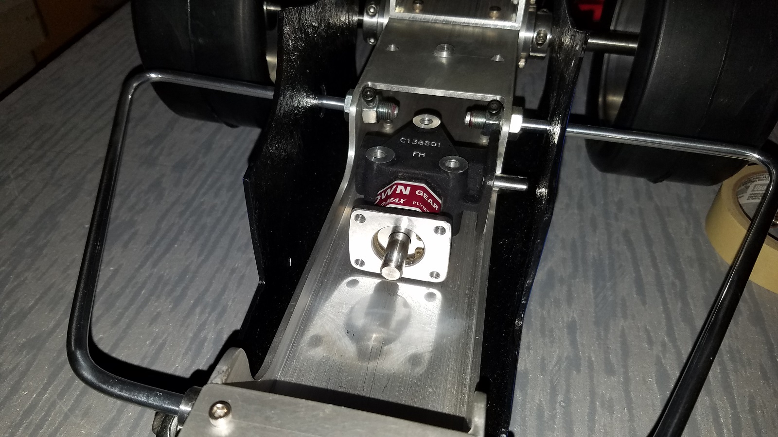

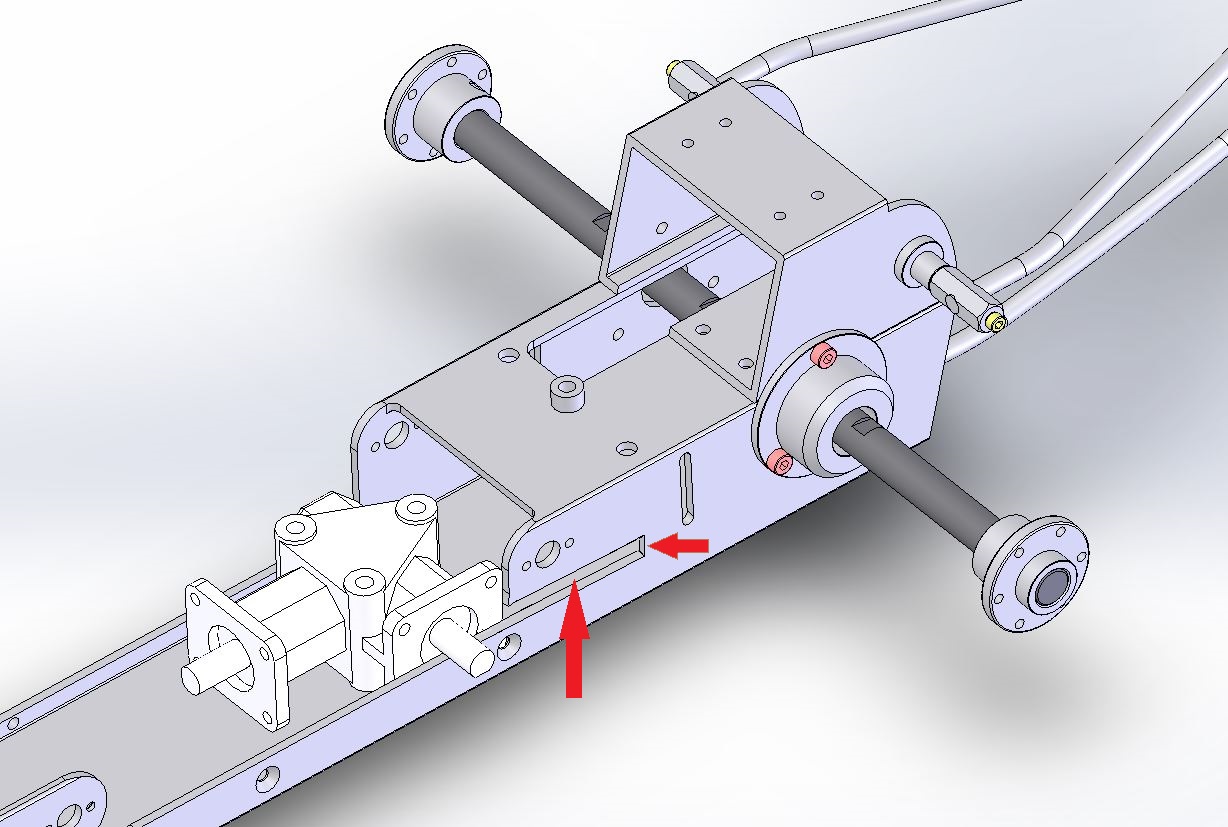

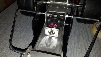

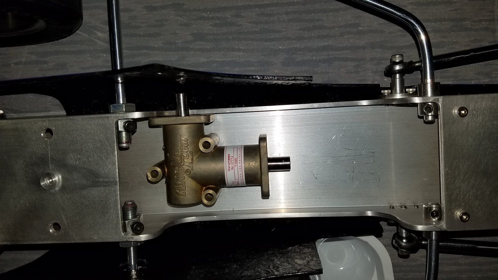

I got the gearbox today and there is no doubt in my mind that Jan Gilmer used this exact Zero-Max gearbox in his prototype. I mocked up the position as to where it should be, I will then cut one slot in the chassis long enough to slide the rear shaft for the axle chain or belt, the gearbox will sit under the seat housing (I modified Rcgarage's CAD photo to show the slot that's needed) and then drill three holes to secure the gearbox, also slotted for chain or belt adjustment/tension.
Next I will need to get a bell clutch and coupeler to tie it all together. Depending on the size of the webra T4 engine, I will not sacrifice one bit of the body. Hope you enjoy and can use this info.

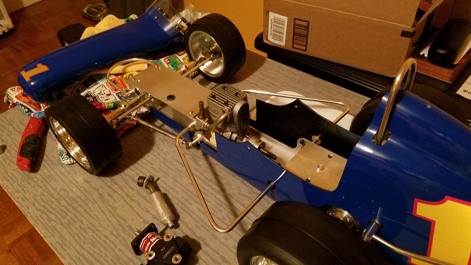

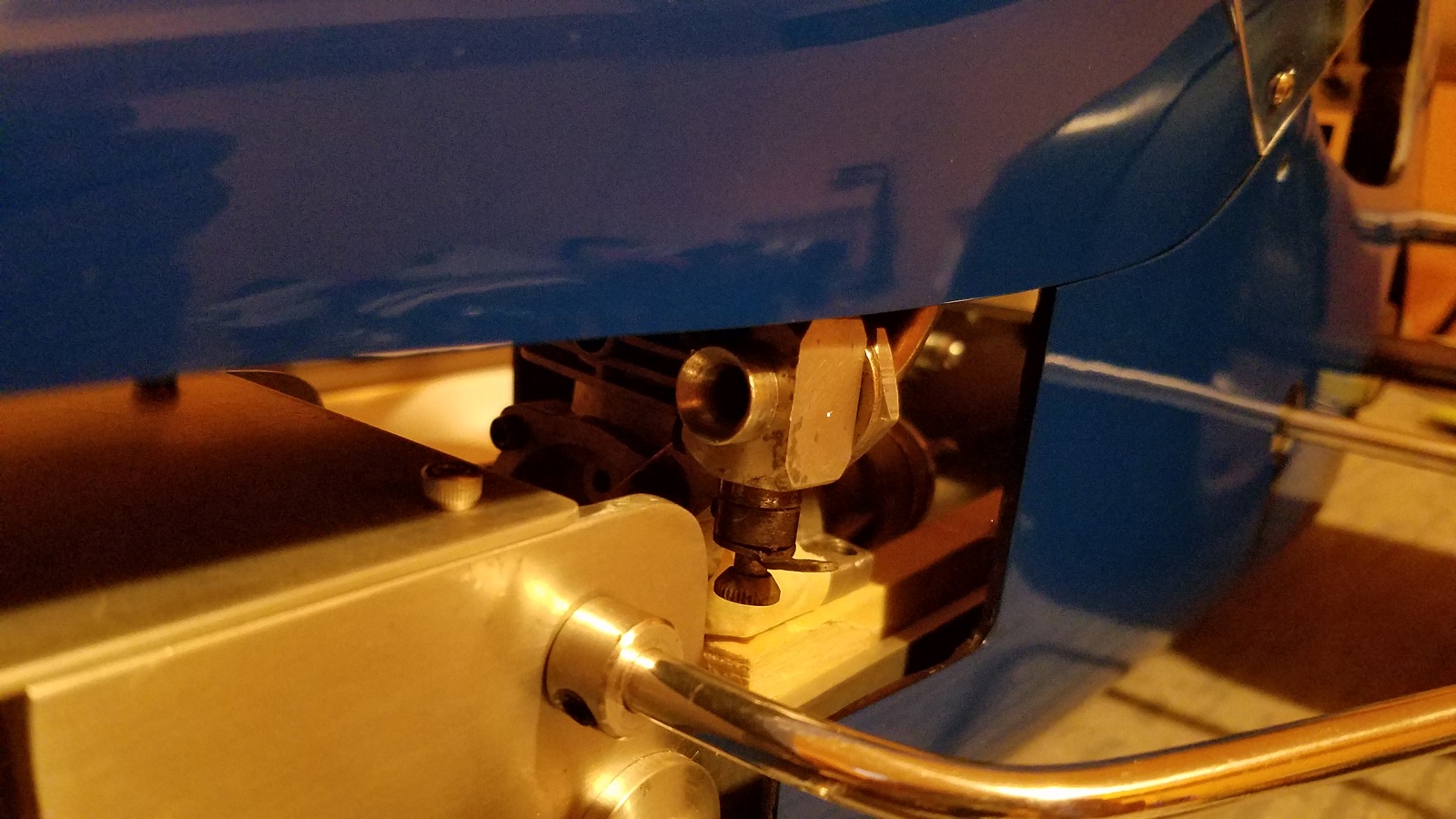

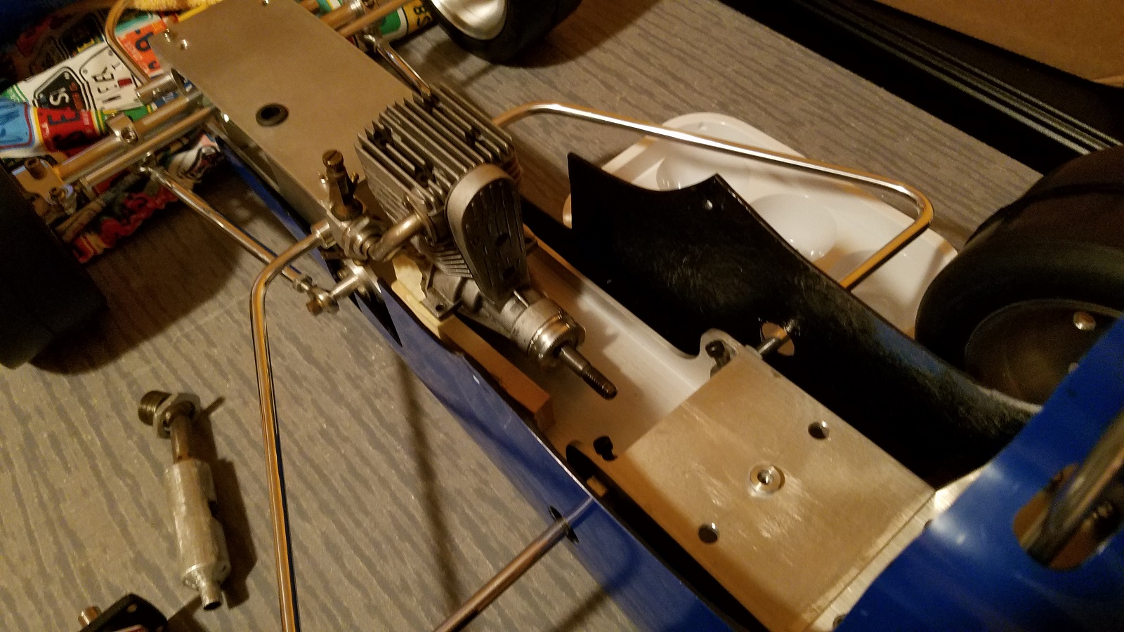

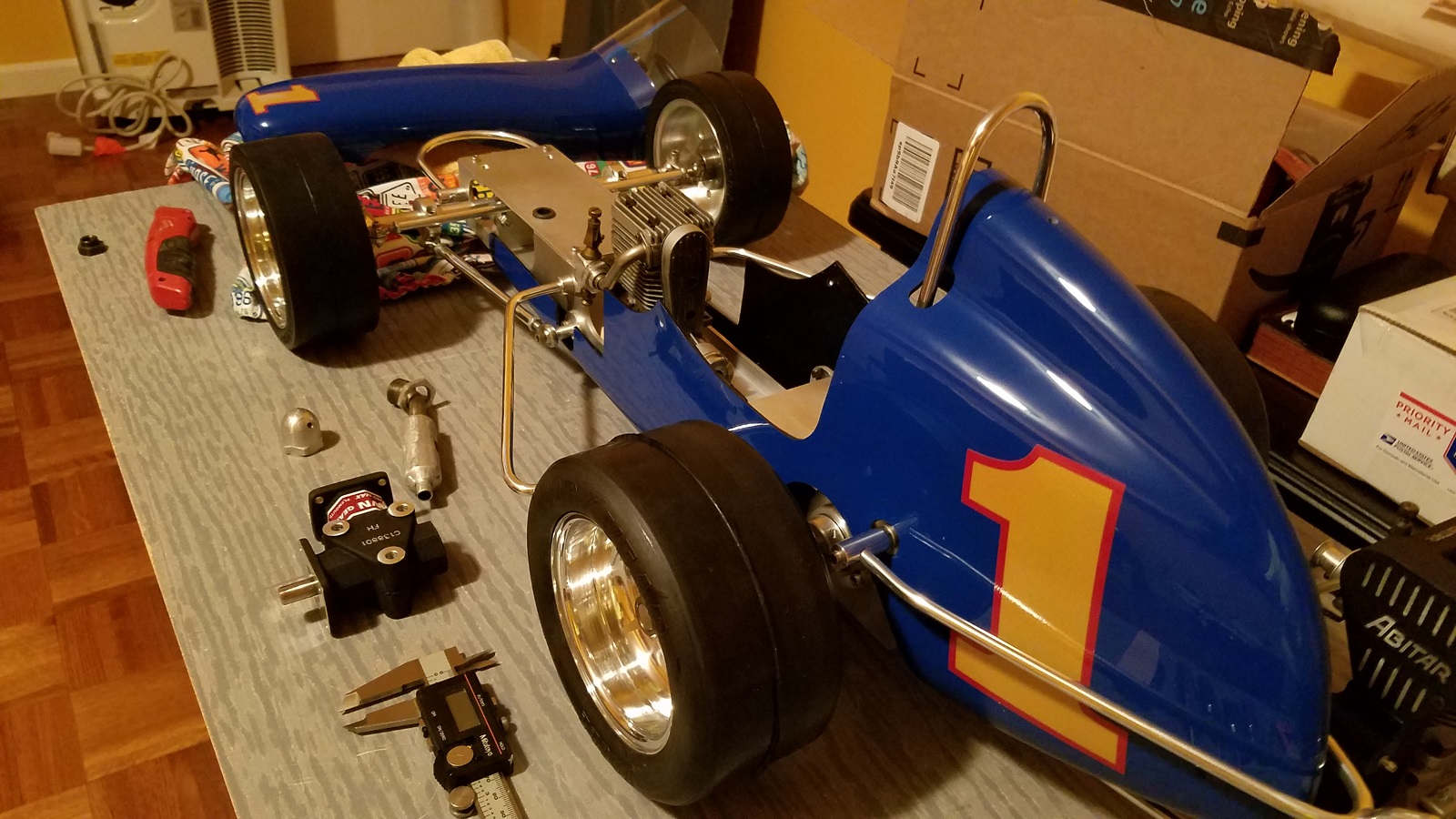

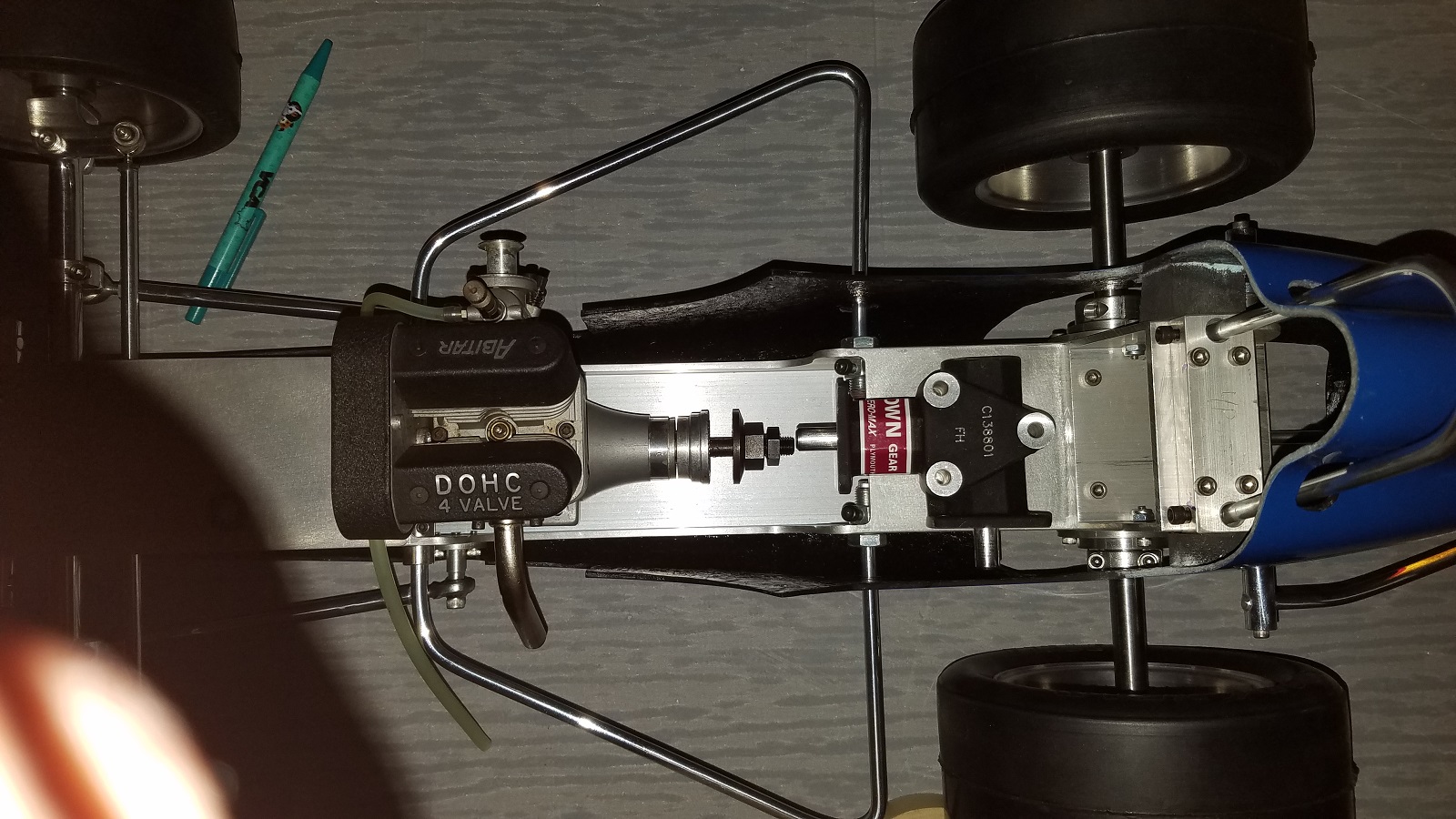

I received the webra engine today (Thank you Kaye for recommending the webra engine) for anyone who has the U-finish model and are at a dead end, I highly recommend going with my configuration, but that's entirely up to you.
If it's flat out beastly power you need or want, you will have no choice but to go with zenoha or Kawasaki engines which will require heavy fabrication to the chassis and body and to acquirer all the parts.

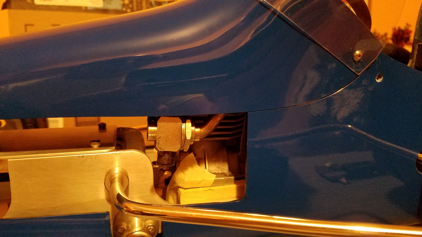

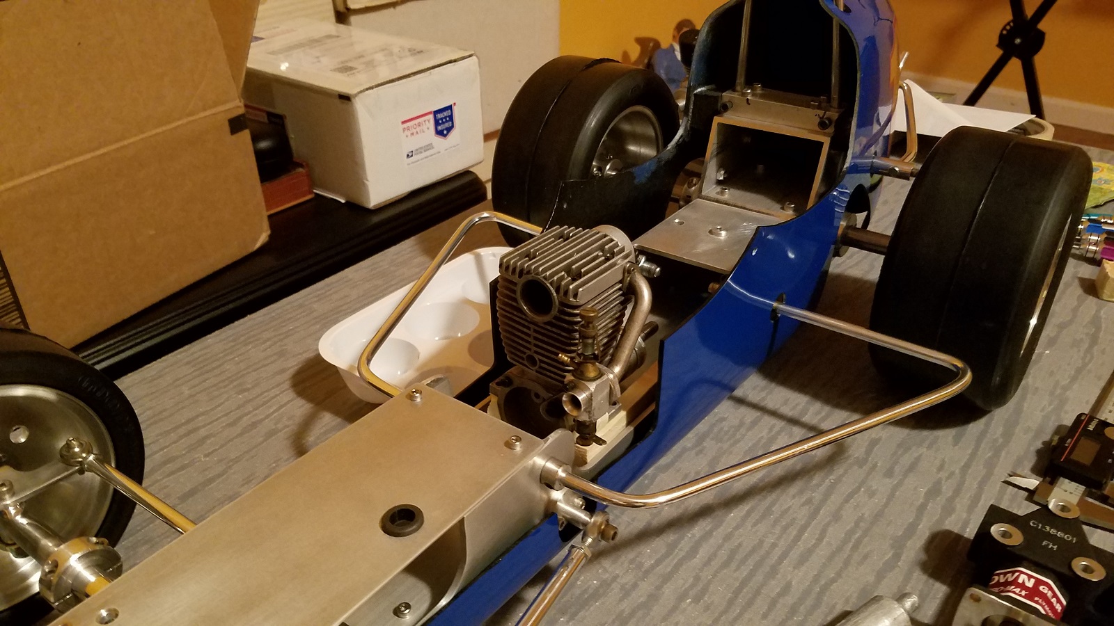

I chose to stay on a more scaled look, and I think the webra T4 60 engine will be enough power to enjoy a Sunday drive. Anyway, here is the webra T4 mocked up, the engine fits perfect and no cuts to the body at all and has plenty of head room under the hood. I will only have to fabricate an exhaust pipe and engine mounts. All in all I'm very happy with this configuration and will post my progress and parts as I go along. Hope you enjoy :)

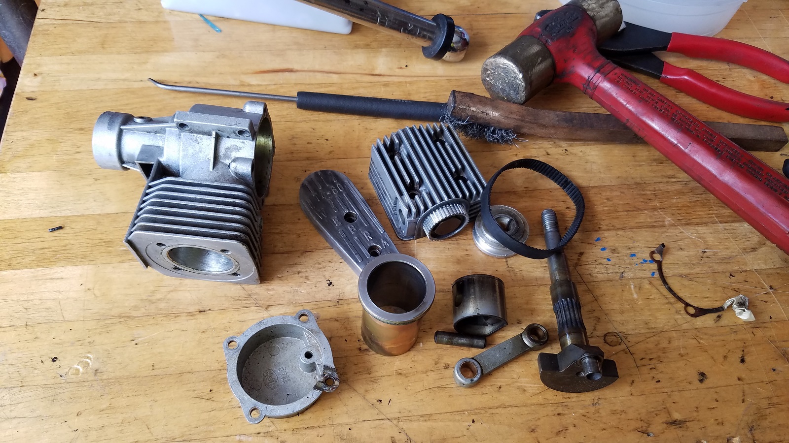

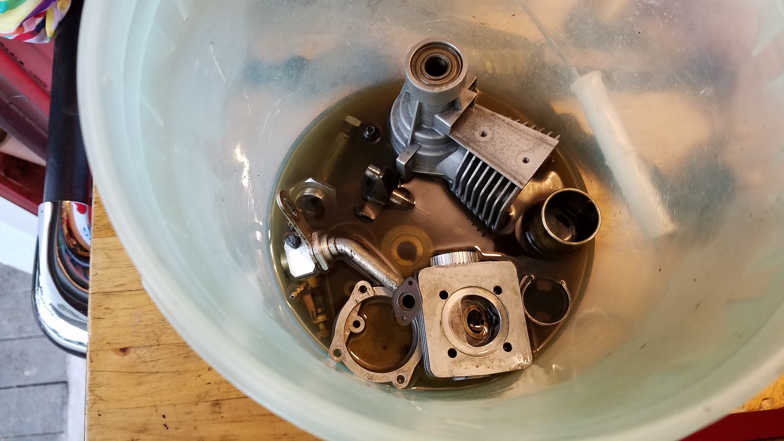

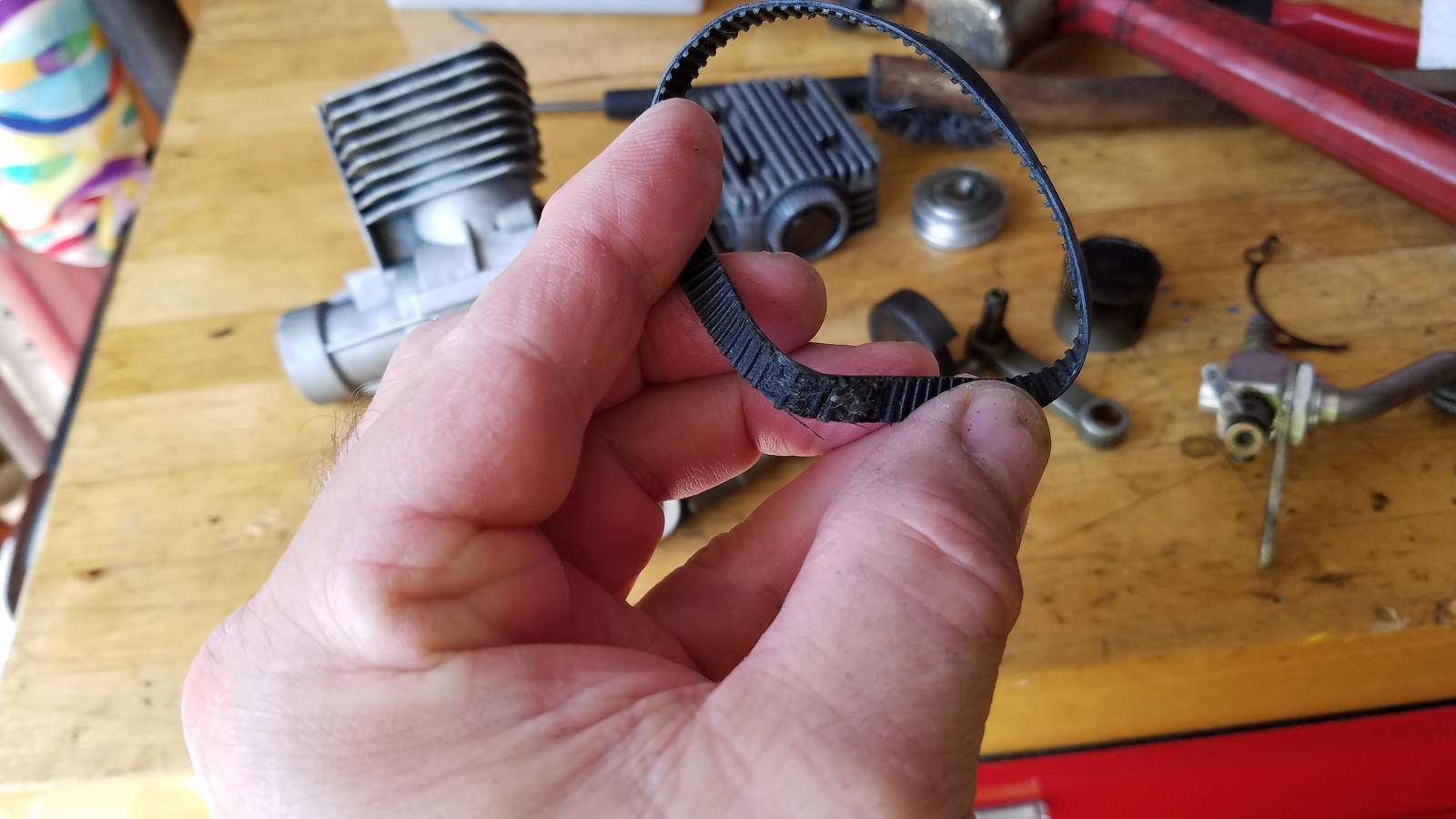

Hey folks, upon inspecting the engine and removing the timing cover I found the belt needs to be replaced, fortunately I found 3 packs of belts on ebay and continued with the tear down of the engine and cleaning.
When all is said and done, I will paint the engine same color as the one I found on the
internet which is royal blue the color of my Gilmer. Hope you're enjoying the project :)

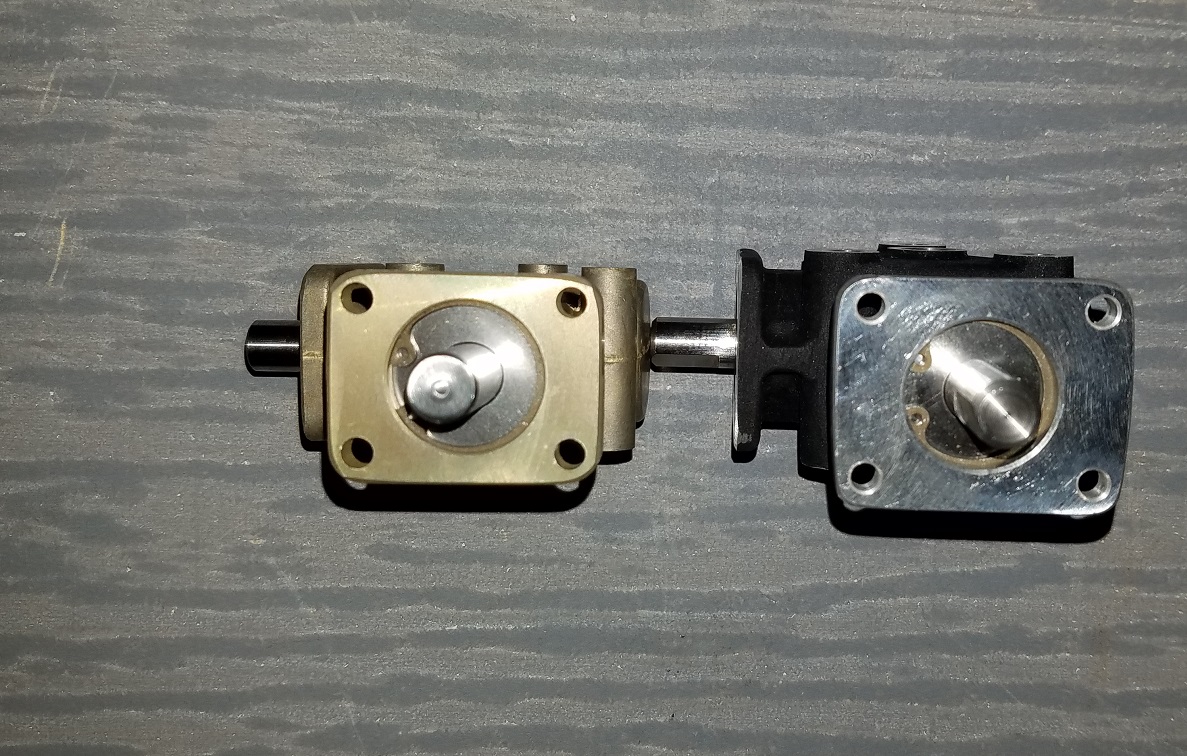

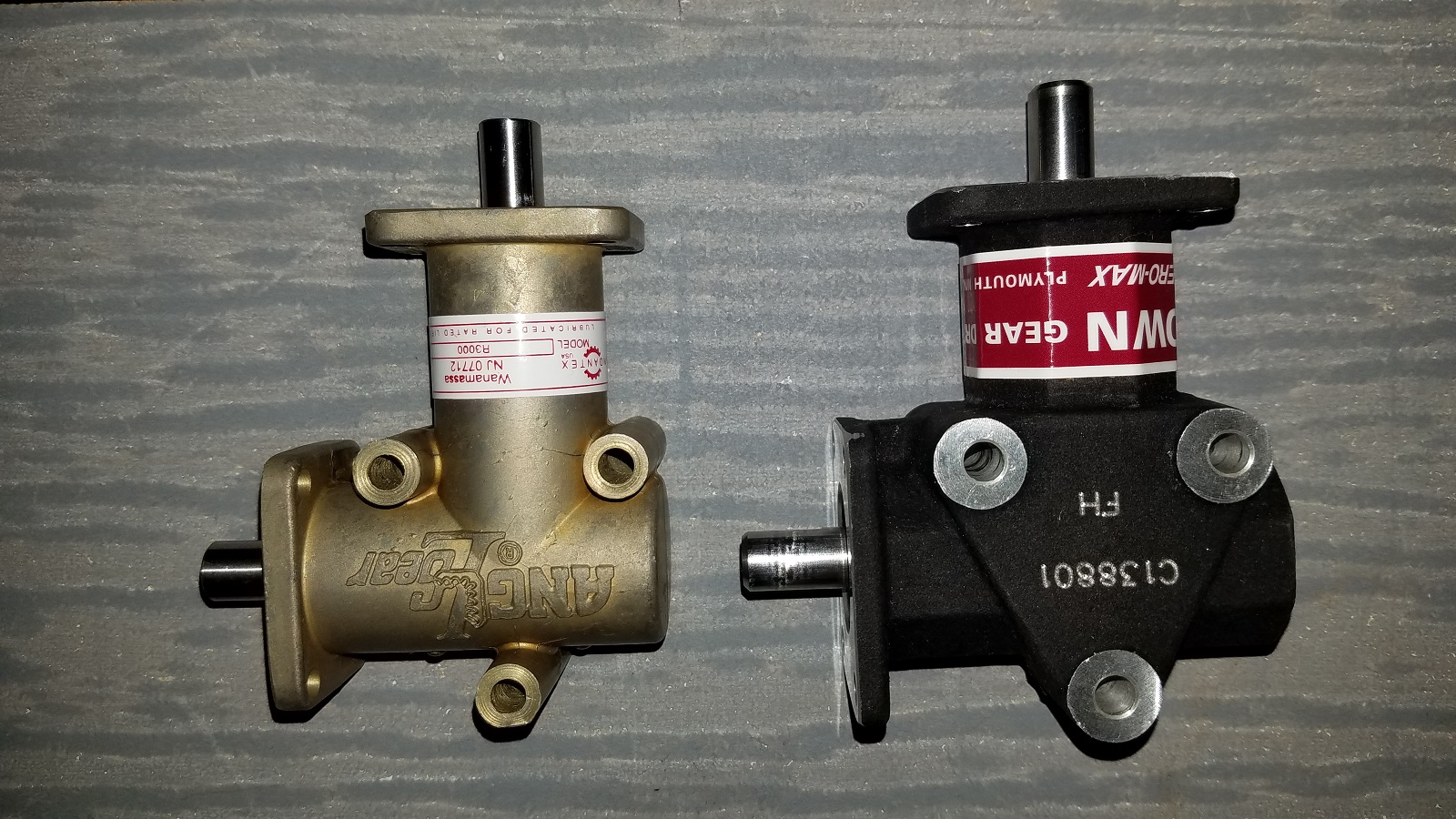

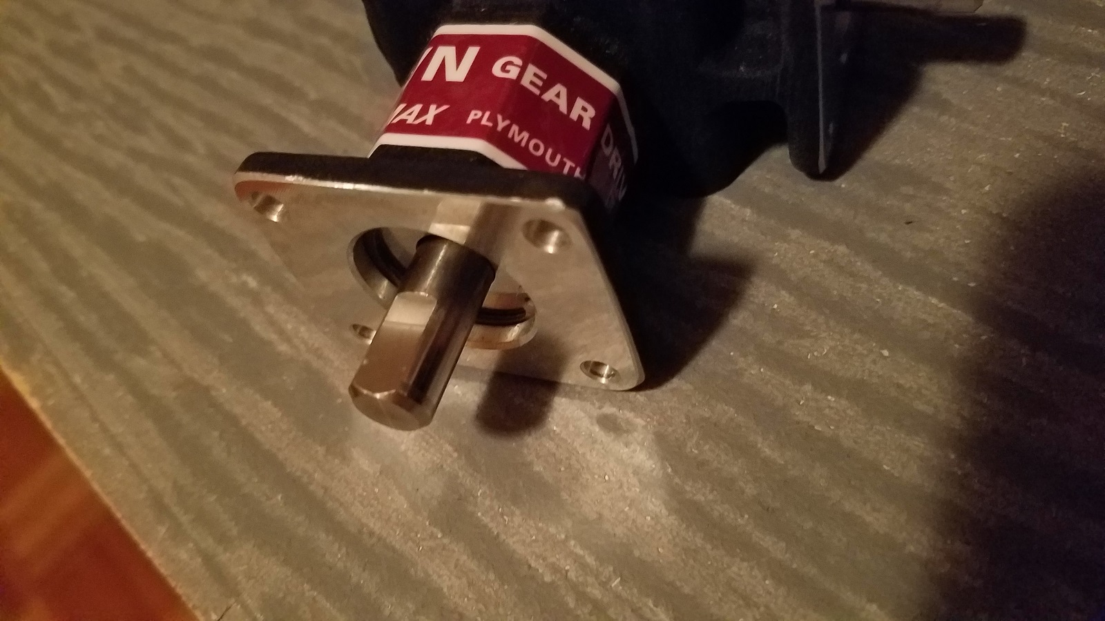

For anyone going this route with the Gilmer, I want to point out that there are two types of right angle gearbox and both will work, the one from Zero-max which is a much better quality, smoother and easy feel when turning the shaft and is larger of the two, the other is from Mcmaster carr and seems cheaply made,stiff when turning the shaft but a much smaller footprint, also the Zero-Max has the flat notch on the shat where the other is completely round, again both will do the job in case you're wondering, I'm going with the Zero-Max.
Zero-Max item# C138801 $254.00
MCmaster carr item# 6456K11 $184.00
