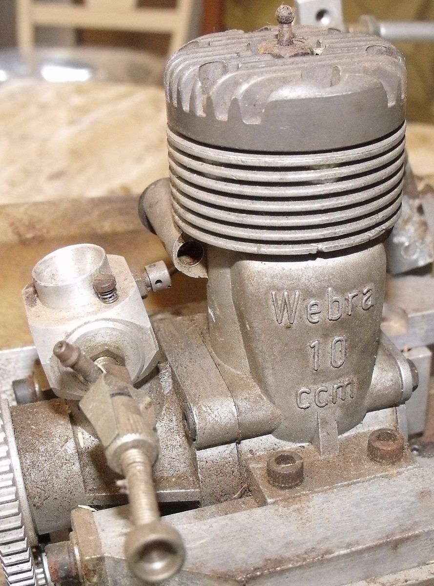

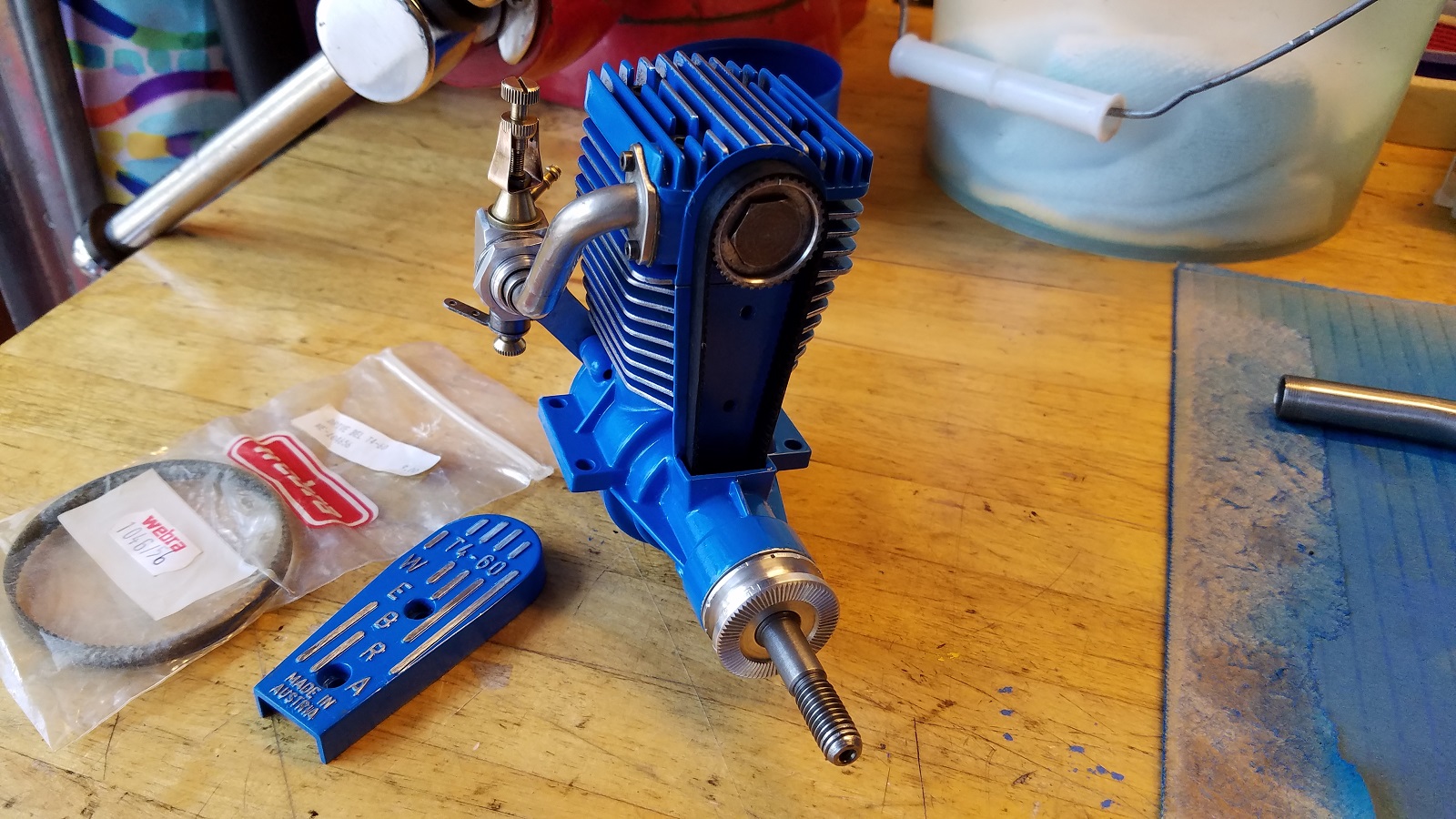

Emilio: I think painting the engine blue adds to the vintage look. It's the sort of finish I could imagine Webra offering back in the day as a special enhancement. Webra AMG?

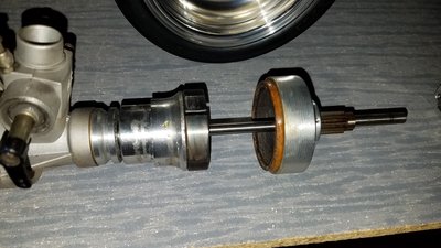

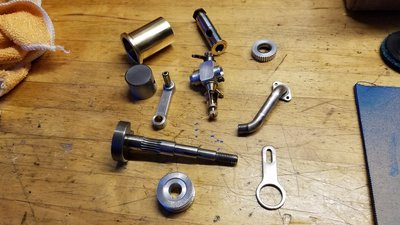

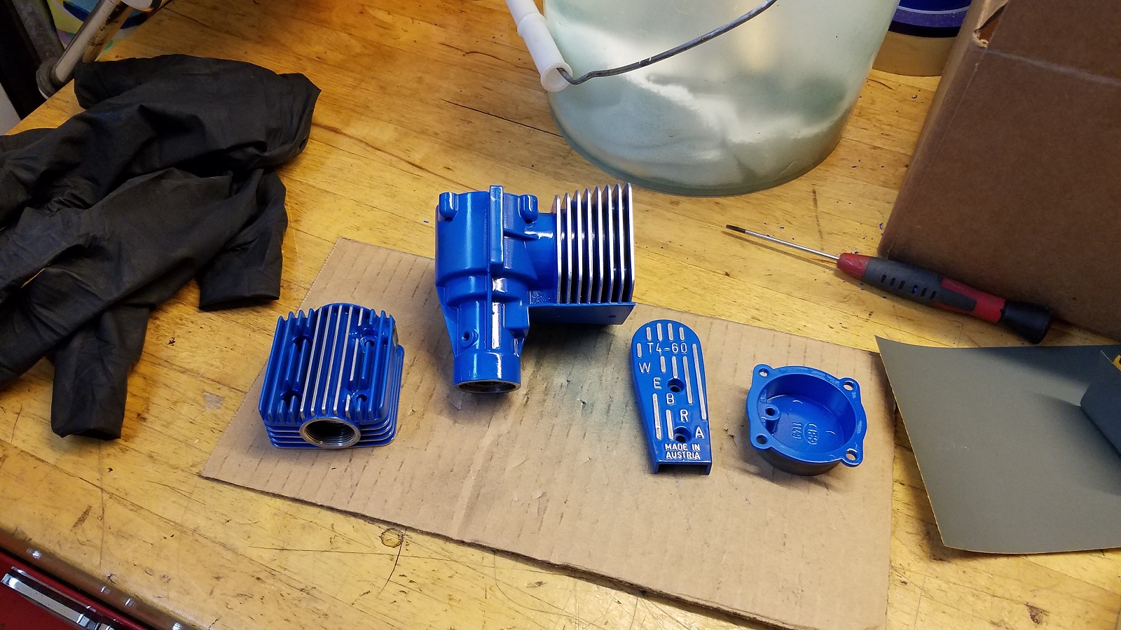

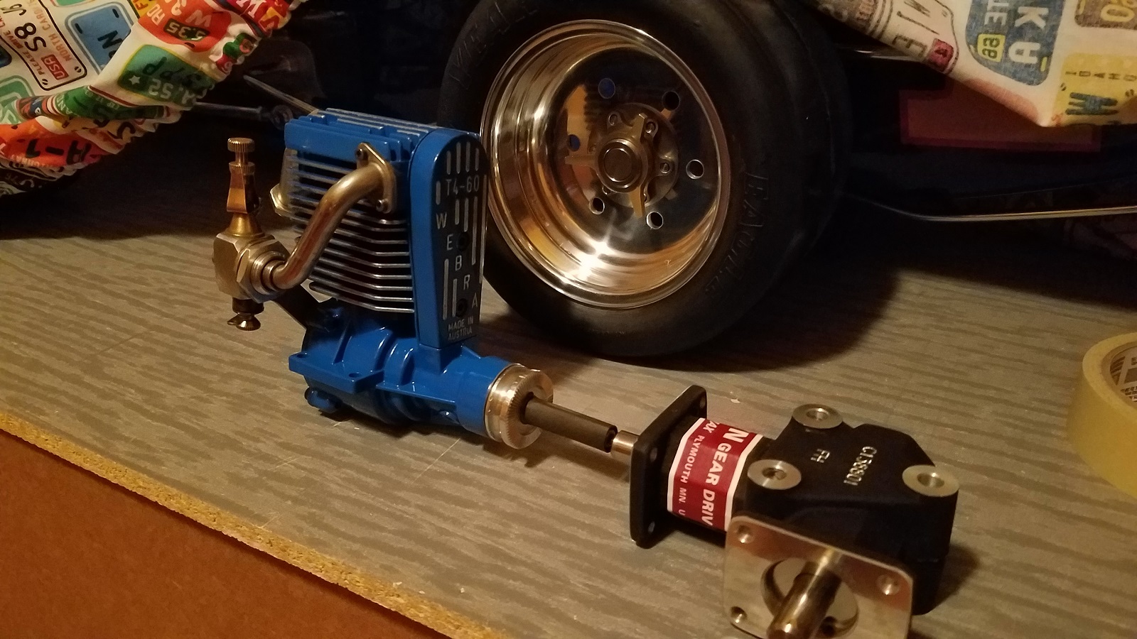

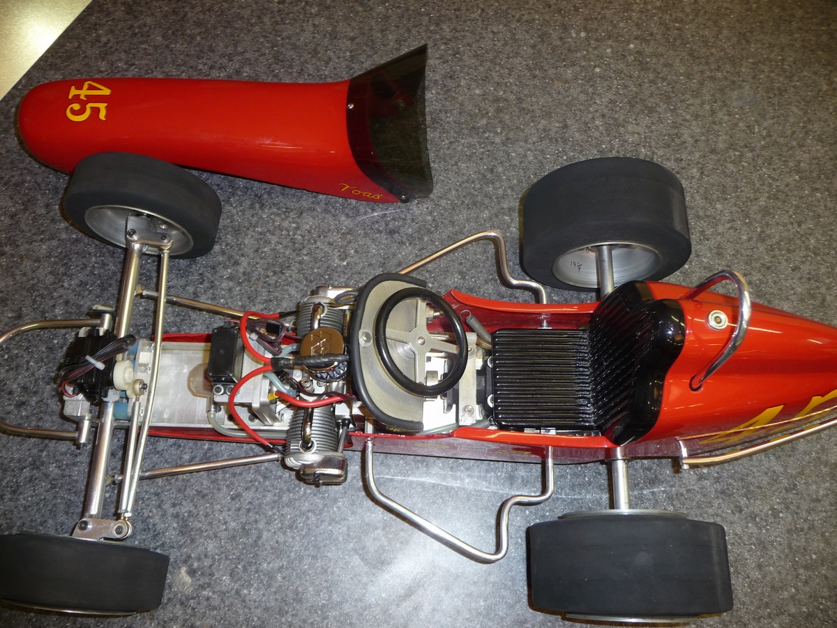

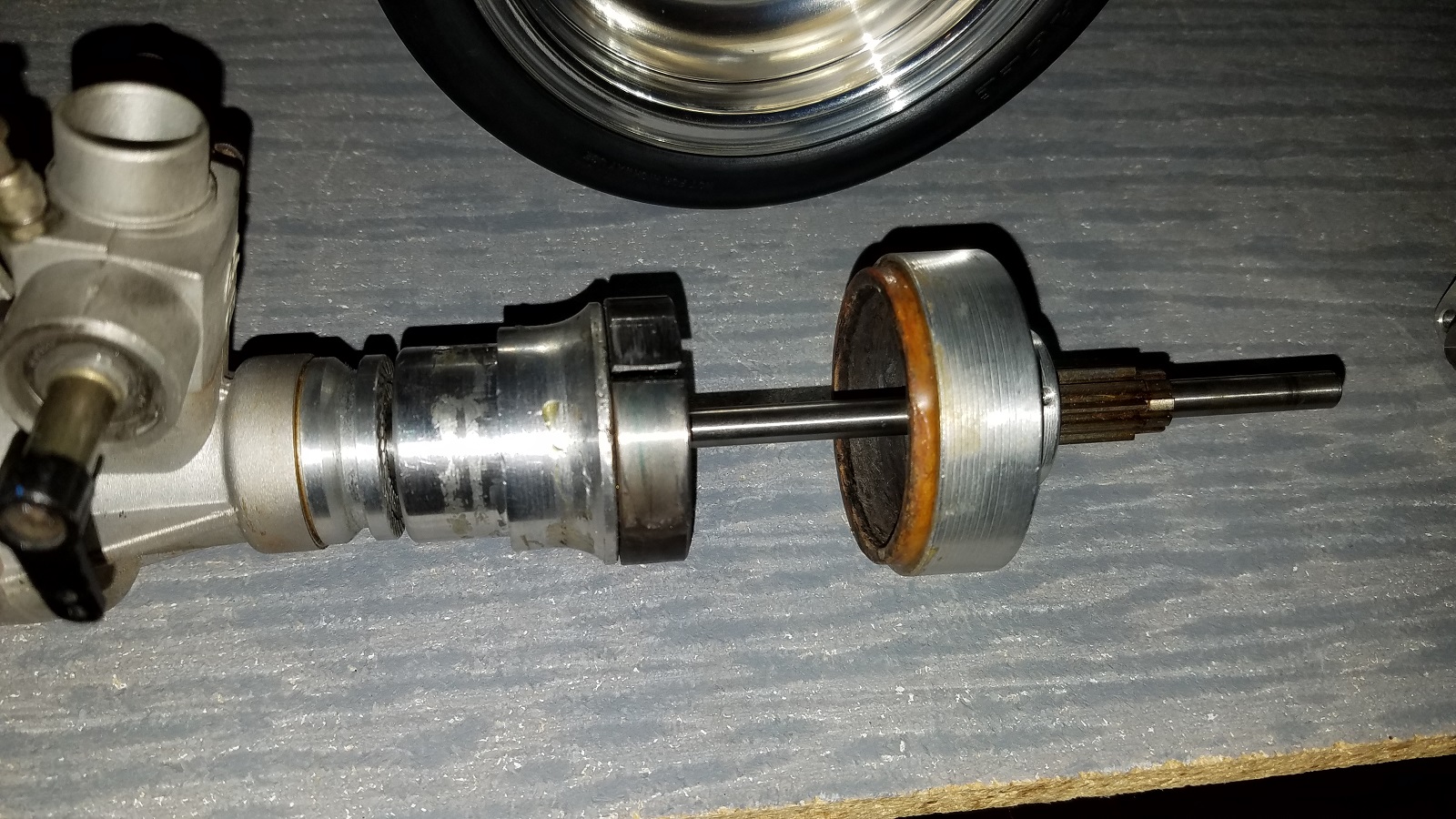

Everything cleaned as best I could and engine painted, waiting for new timing belt before I could assemble.

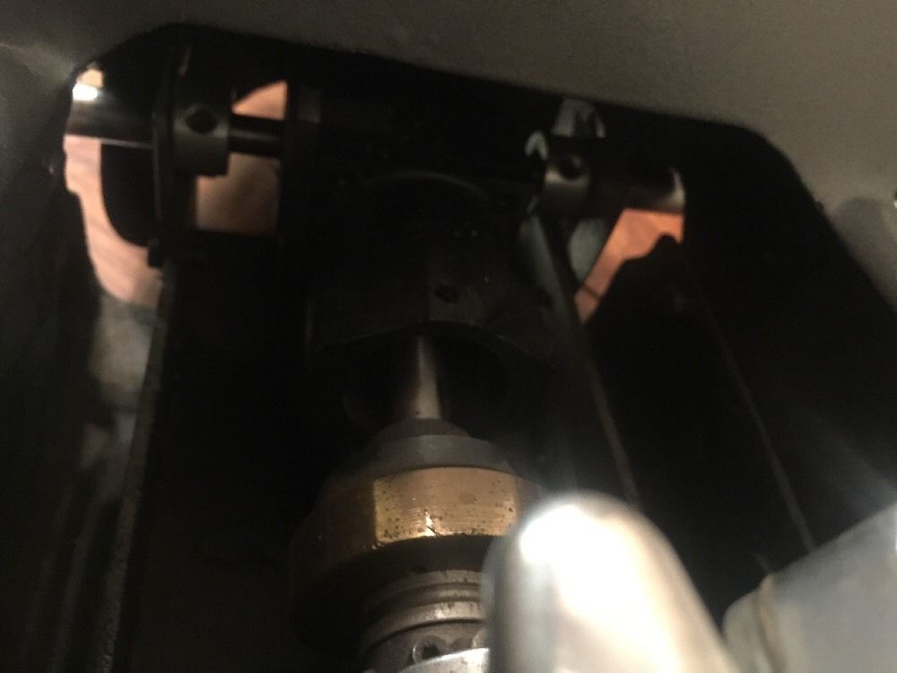

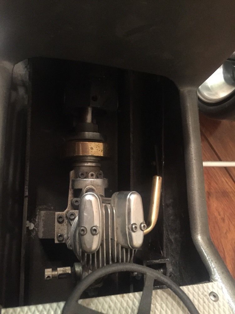

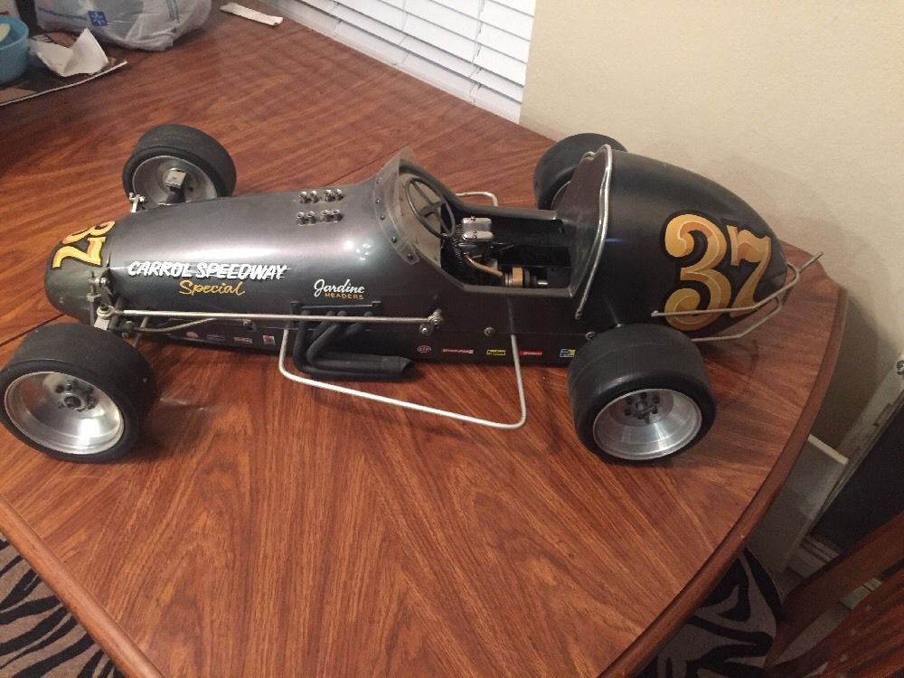

My problem with this build is going to be a clutch system, I could go direct drive and be done with it but won't be able to stay idle.

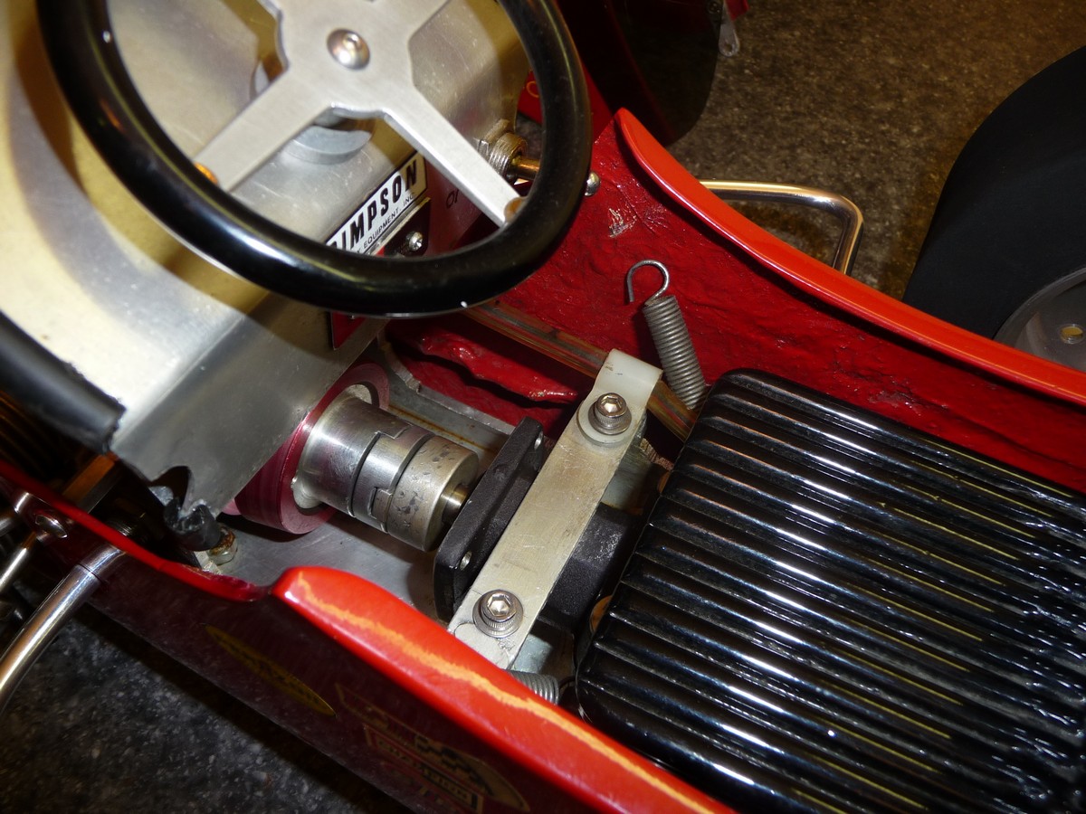

If anyone could please post a photo of Jeff's Pacsetter sprint with the nitro, I'm sure he had a clutch on his nitro? I could use a better shot of Gilmers twin saito clutch system also. and as always if you have a solution or idea it would be great! 8) Thanks all.

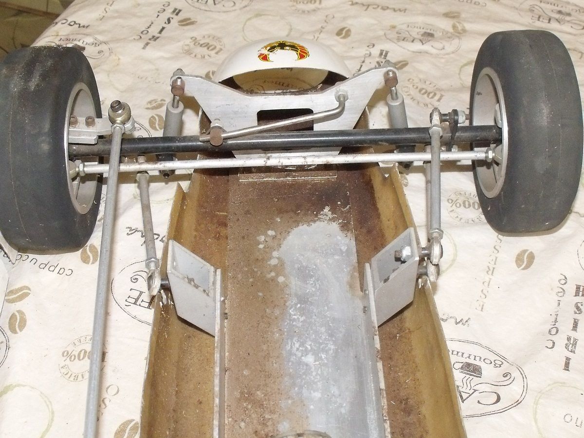

Saito here you go .....

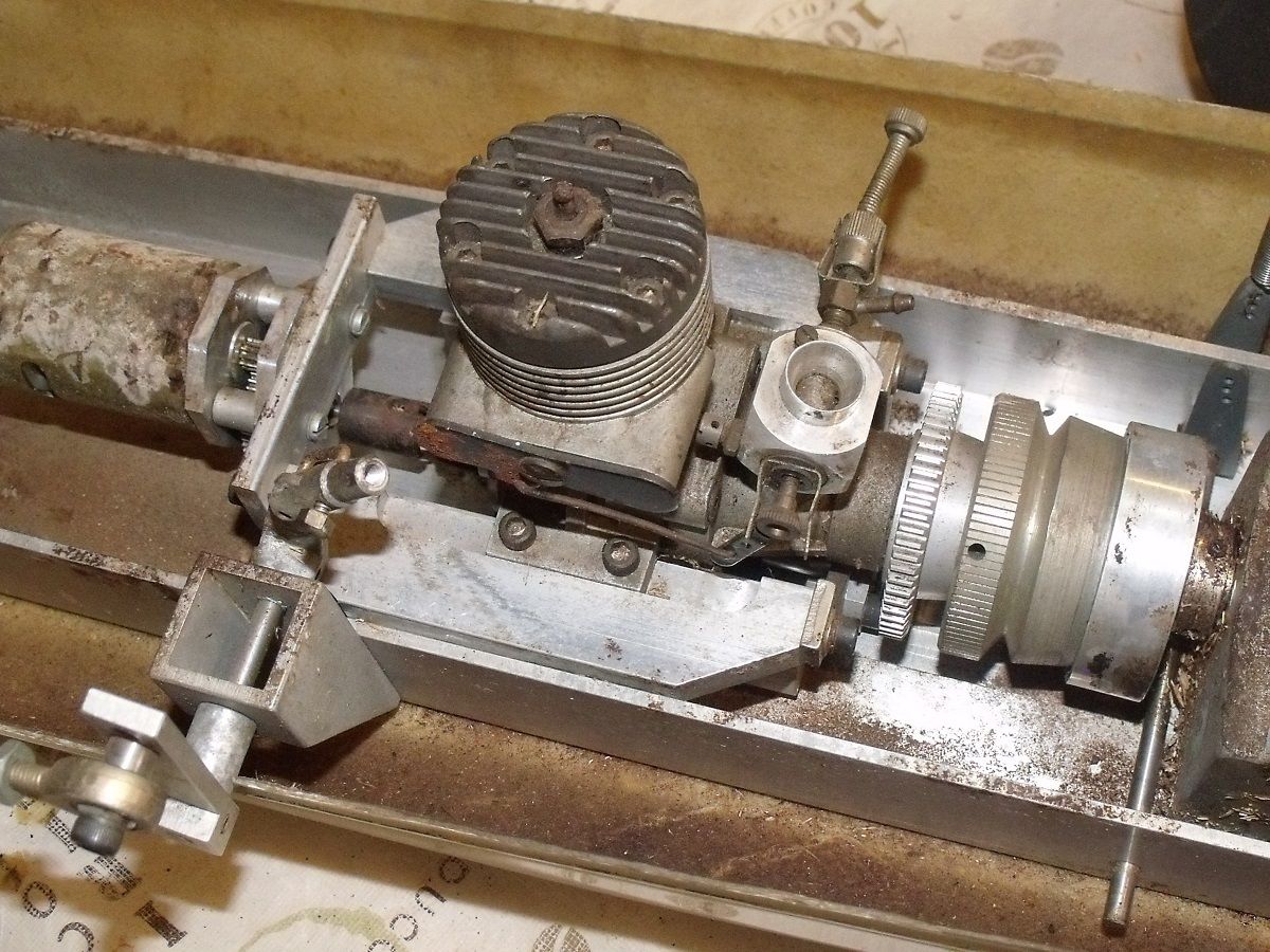

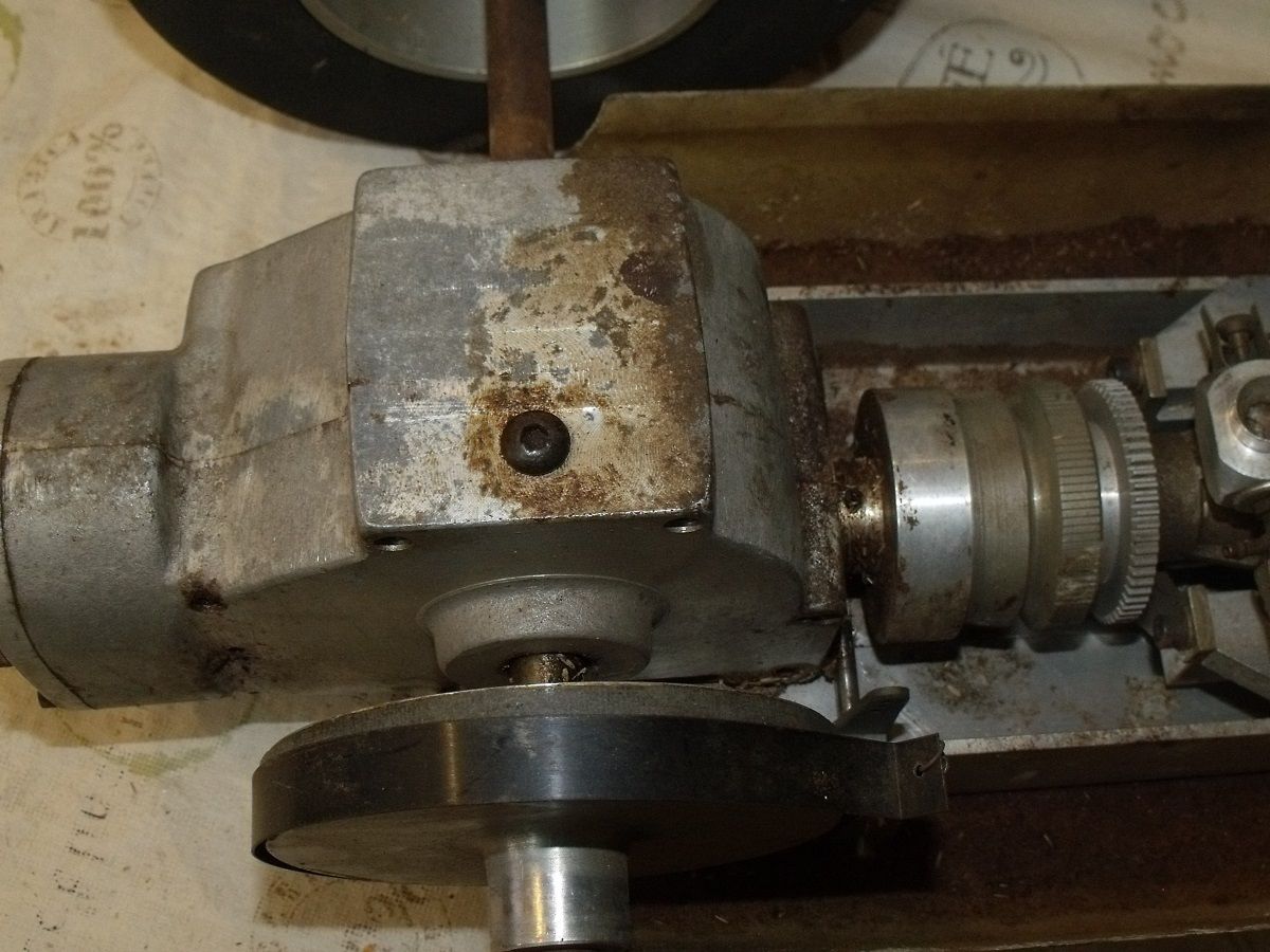

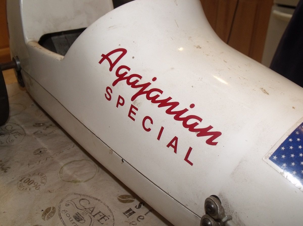

Pacesetter ....

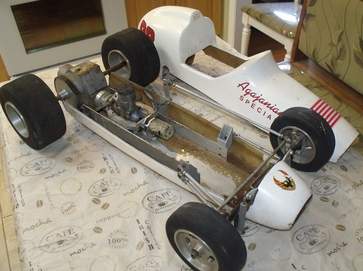

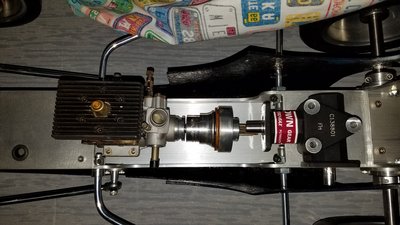

Kaye perfect photos of the pacesetter that I have never seen! Looking at one setup of the multiple pacesetter drive-line, I think I know what Jeff meant by "2 stage clutch system" I believe he had the modified clutch bell secured to the QC rear, in my case Gearbox, and the Centrifugal clutch shoes secured to the crankshaft, then line them up? This might work or correct me if I'm wrong all together? Either way I think this system isn't far fetched?
 Profile
 Post subject: Re: Gilmer gearbox and engine project
 Post Posted: September 5th, 2017, 4:13 pm
Offline
Posts: 192
[quote=I believe he had the modified clutch bell secured to the QC rear, in my case Gearbox, and the Centrifugal clutch shoes secured to the crankshaft, then line them up? This might work or correct me if I'm wrong all together? Either way I think this system isn't far fetched?[/quote]
Emilio:
Yes, this set-up should work well enough.

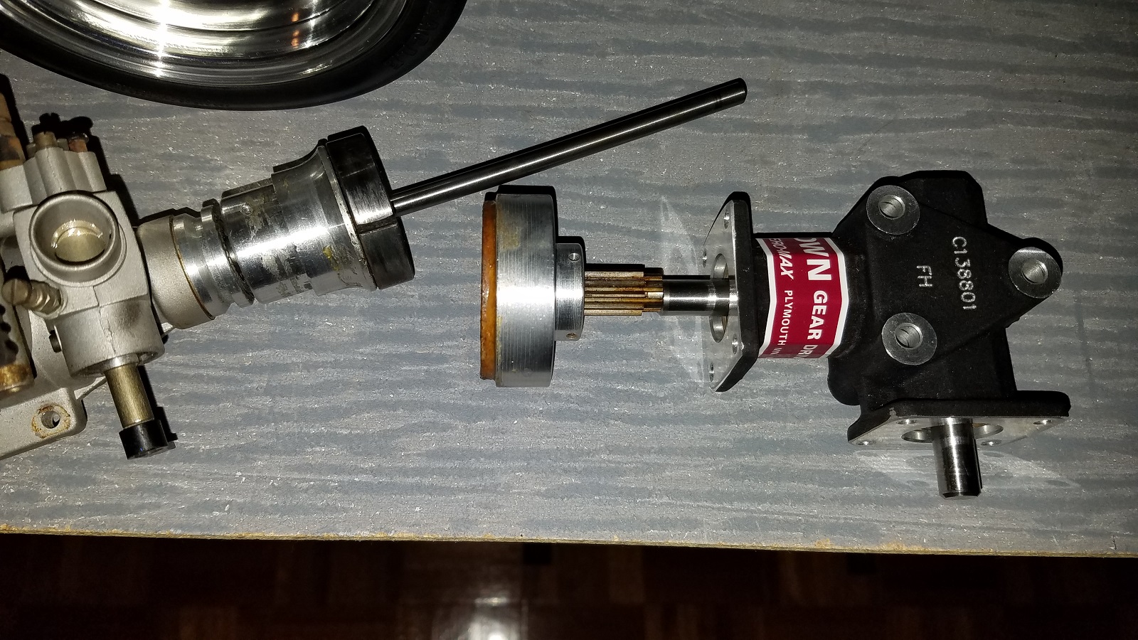

What I think I can do is get a steel clutch bell, cut the collar as I can't find one at 9.55 mm and weld a 9.55mm collar to fit the gearbox shaft? Anyway, here is the engine with new timing belt ready to go!

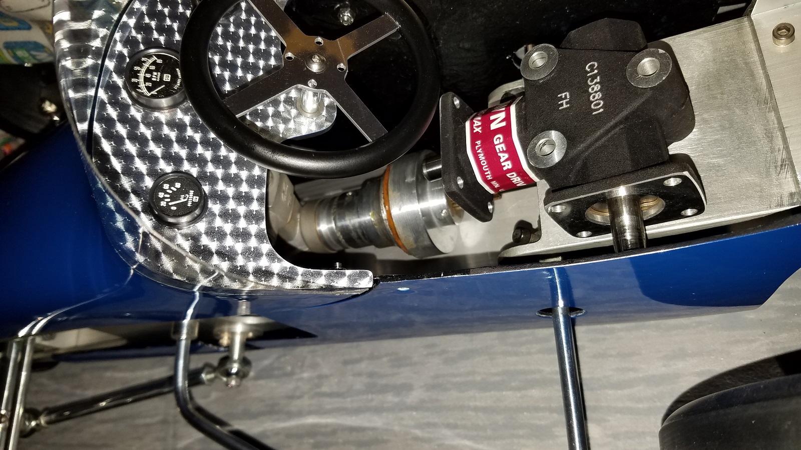

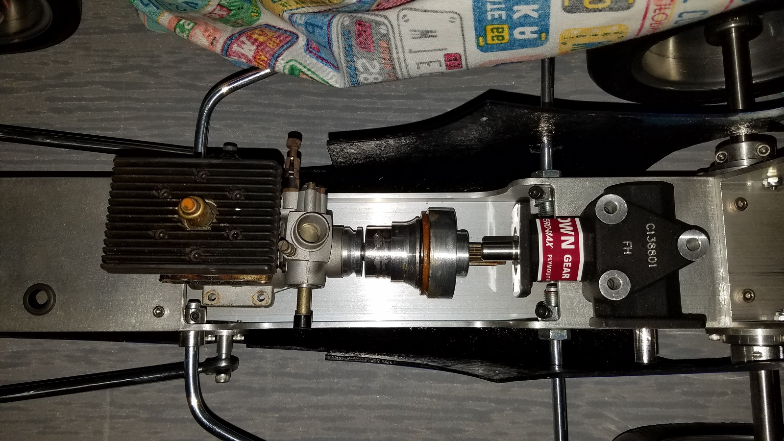

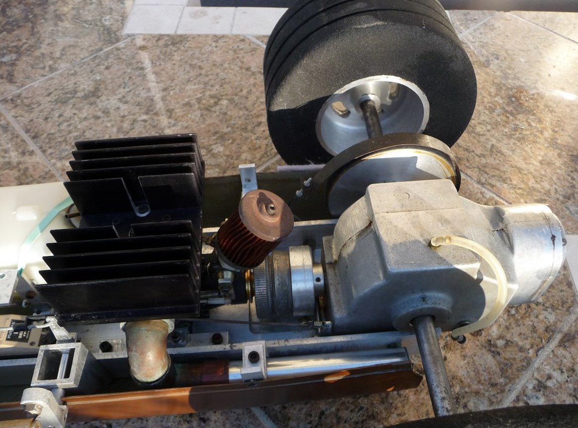

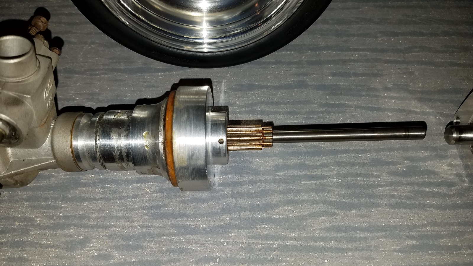

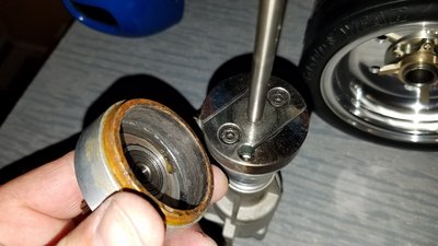

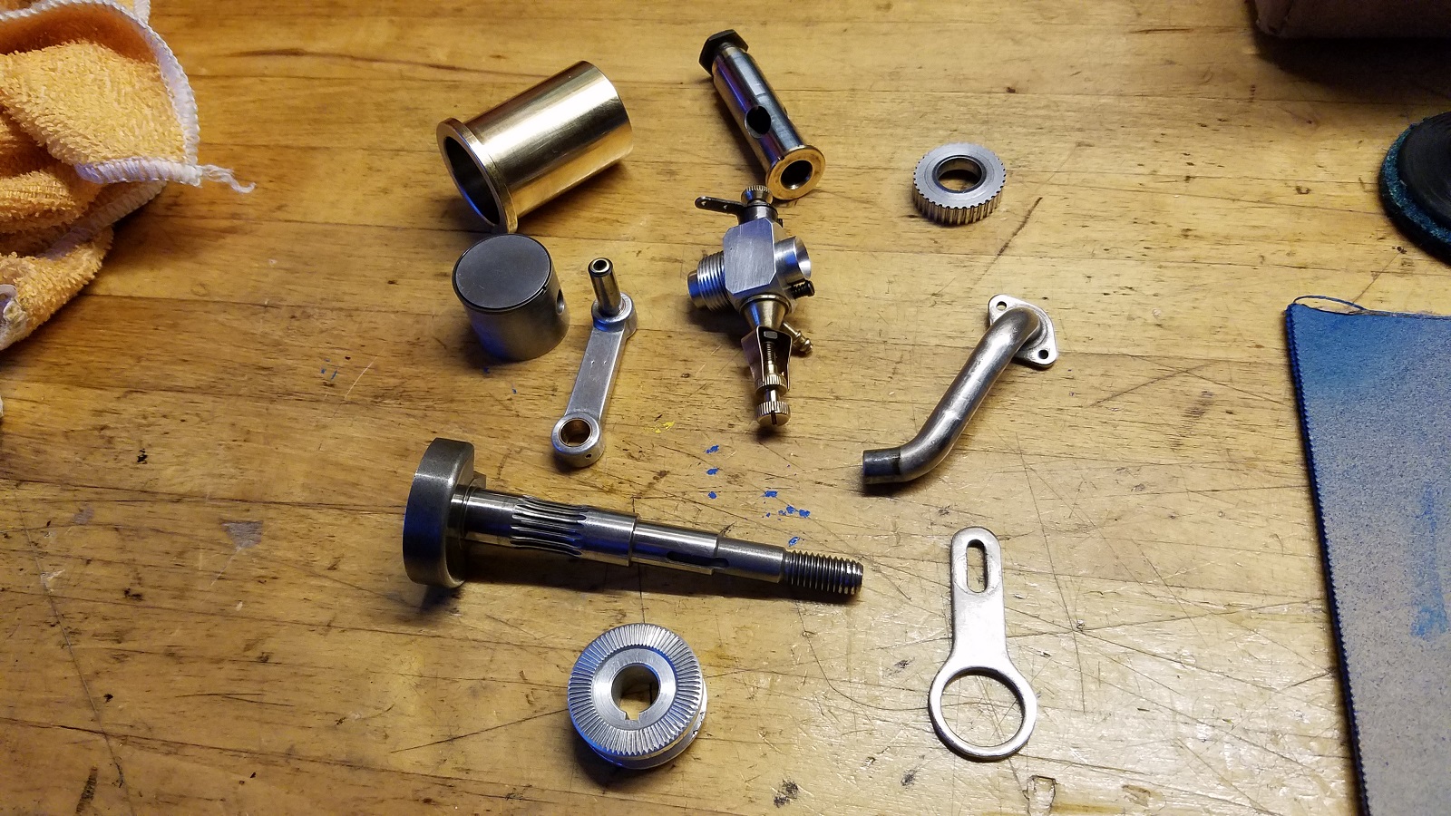

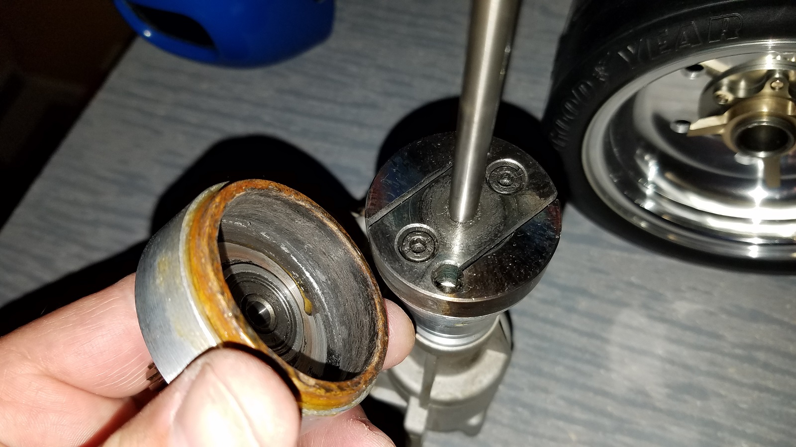

Hey folks I finally figured something out. After looking at the Pacesetter clutch setup a few times, it struck me that this might be a setup in relation to the RC helicopters.
I had this old schulter helicopter that I was going to restore but I knew that I would never get around to it or fly it. So this evening I tore it down and was very pleased at what I found, an O.S 61 engine with a heat sink and a robust clutch system.
The engine and clutch systems fits perfect under the hood and I won't have to touch the body or chop up the chassis! I will only need to drill a few holes, fabricate an exhaust and engine mounts. Gearbox will sit under the seat housing.
My plan is to cut down the long shaft shown in the photos only up to the clutch bell gear as this is needed to ride on the inner bearing, once evrything is in place I will then locate a coupler to join the clutch bell and gearbox. The rest will be a breeze as I will only need to locate the sprockets and chain for the final puzzle and then take apart the engine, clean, lube and polish. Hope you enjoy the project :)

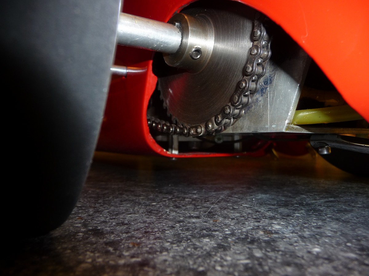

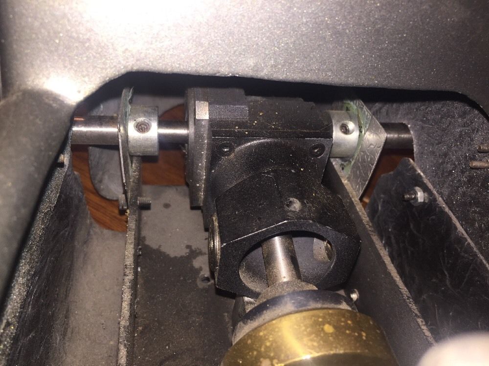

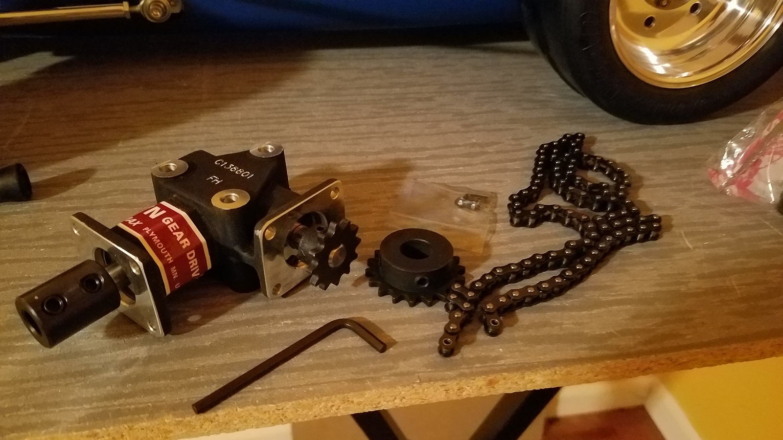

Getting closer to the finish line! received the shaft couple to join the gearbox and clutch bell together, small sprocket for the gearbox, large sprocket for the rear axle and 1/4" pinch chain. Everything fits like a glove. Next I will dissemble the car and start placing all components. Lastly I want to install a hydraulic brake system. At the end of the project I will list all parts numbers and price and hope this will help others. Hope you enjoy :)
