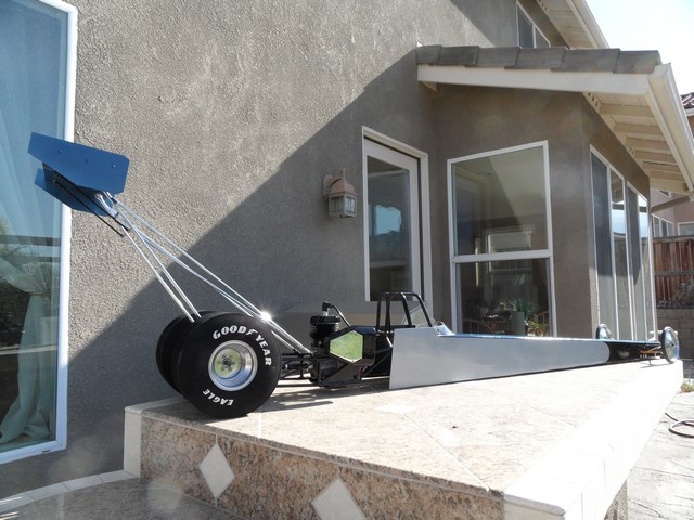

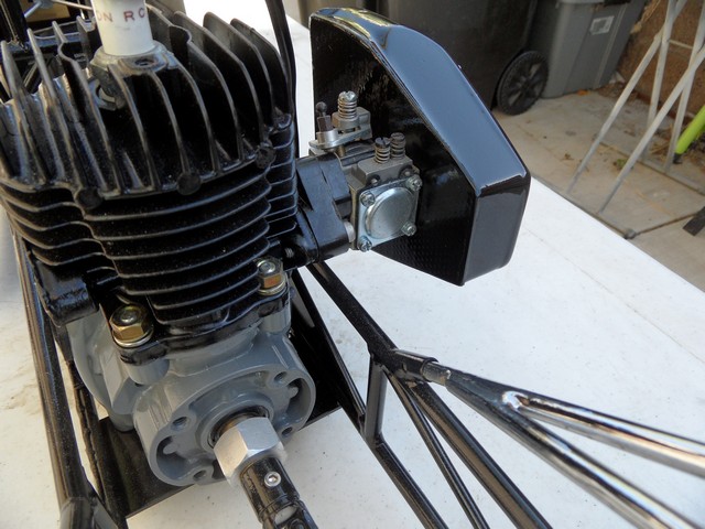

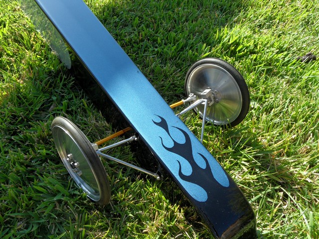

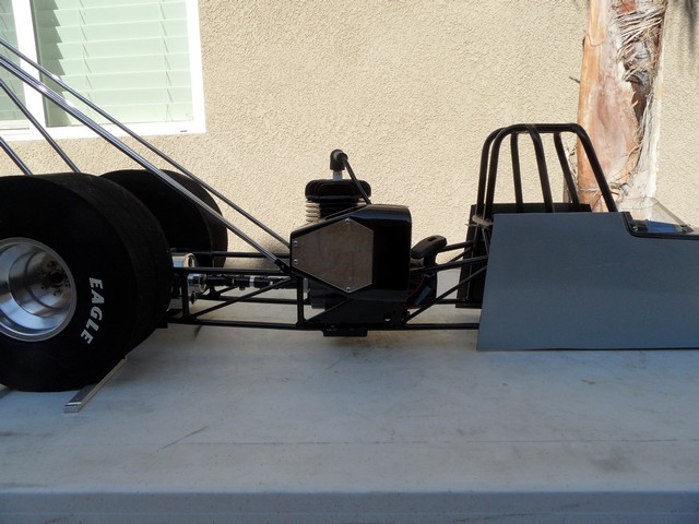

Thank god this weekend was not scorching hot!! I was able to spend a lot of time on the car. I built the air cleaner using my vacuum forming machine to make the basic shape. Bonded the top and bottom together and then I cut aluminum and polished it. Really happy with how it came out!!!
Re: Performance Drag Products
Dang nice!!!
Probably the cleanest surviving example of that brand!

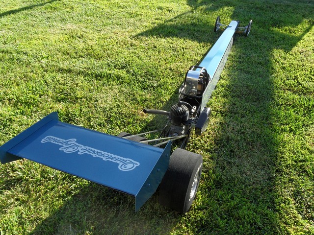

yea, i guess. I have not really seen any more of these. Just pauls and some other guy on the net. That makes 3... oh yea, saw one on ebay listed wrong about 1-2 years ago. so 4. I am just having fun with this one. I am cutting some vinyl for it right now. so i hope to get the name down the side tonight! Then the next big project for it is the pipe.

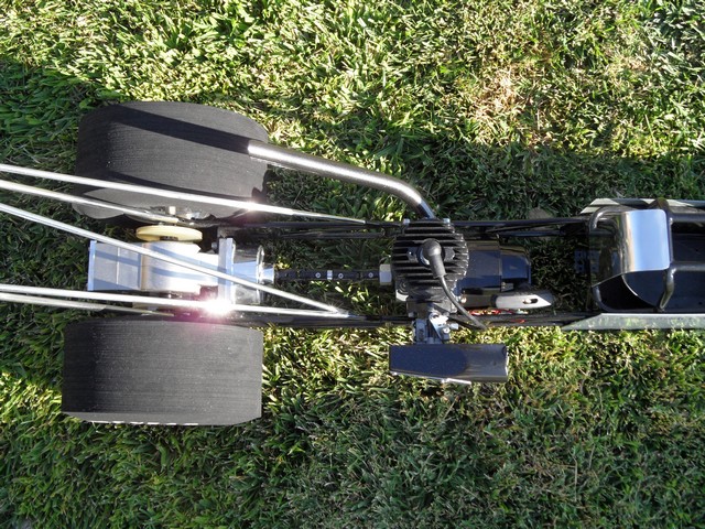

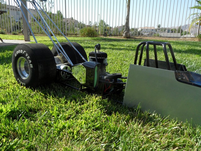

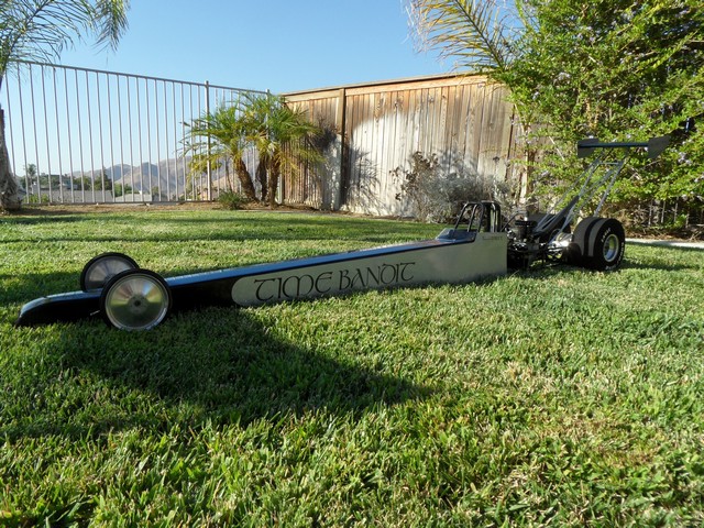

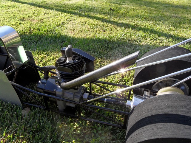

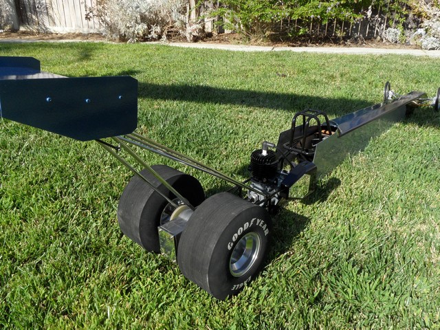

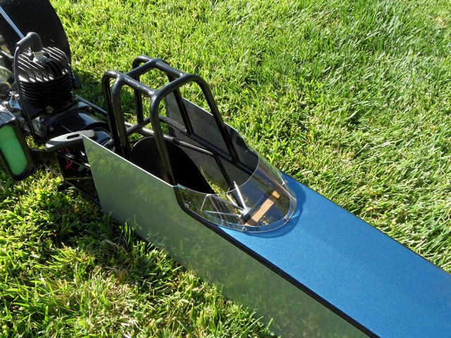

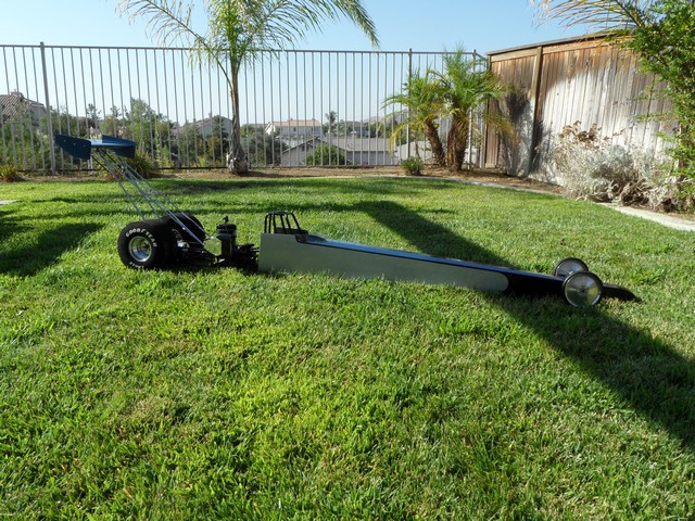

Here are some shots of this weekends progress. Custom made the exhaust, cut some vinyl for it and made the gaurd that goes behind the cage. The car is coming to completion. Kinda sad to see it just about done... :(

Hi Mike, I'am looking at the pic with the Raco gearbox. How is axle assembled it the gearbox? I see the outdrives are there.Is the solid Raco gear assembly being used .Or is the outer axle welded to the outdrives? (which I doubt) .Thanks.

its a straight axle. 1/2" stock. Only thing you need to do to convert a raco rear is the 1/2" axle, larger bearings and a ring gear with hub from a skellenger.

Thanks for the replies.I figured it would be straight axle but why keep the outdrives in place. Oh forget that question .....for the brake disks right.Thanks.
