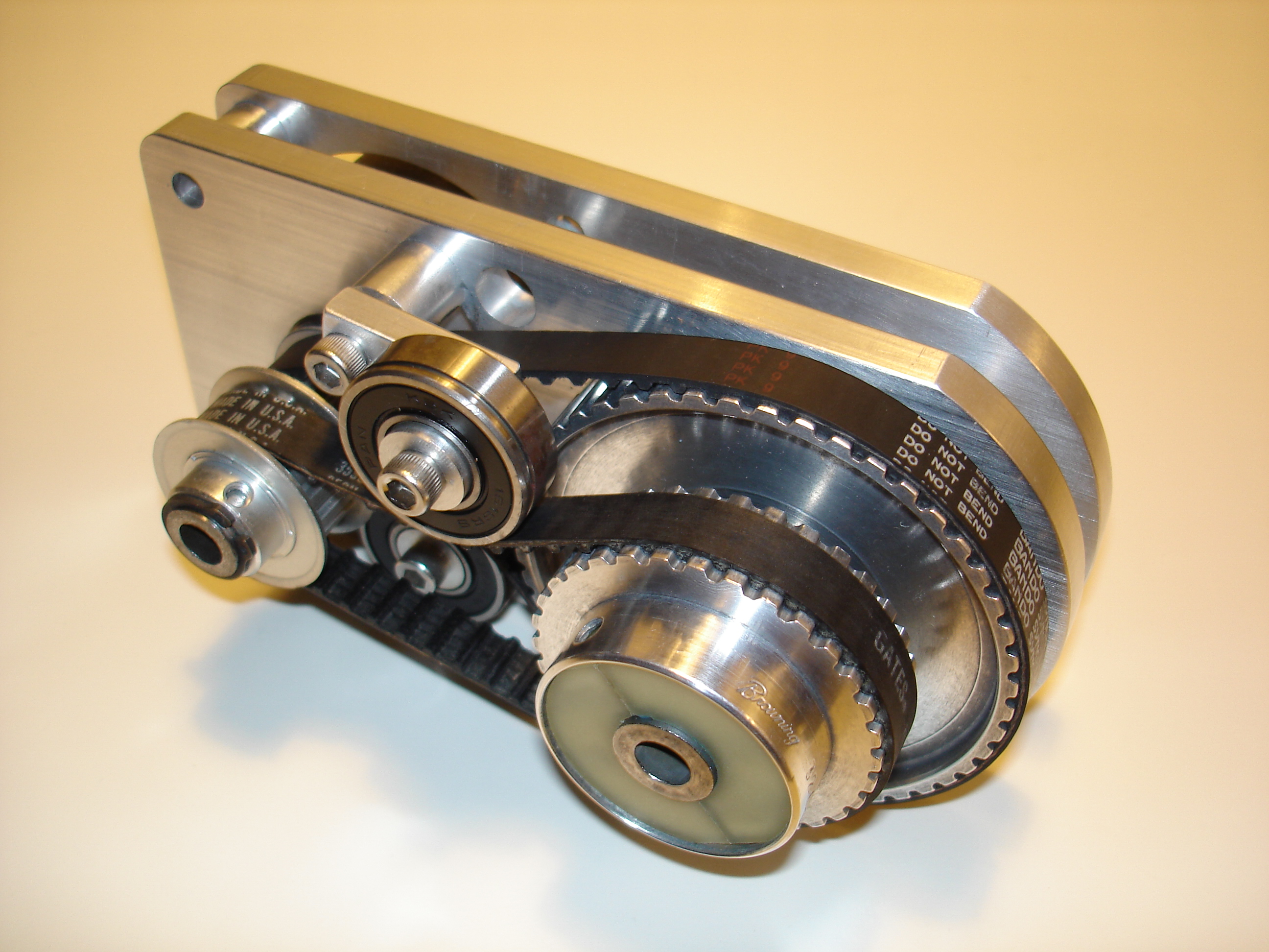

I just bought (on line, I haven't received it yet,) a WCM Dragster with the 2 Speed Belt Driven Transmission.
Can anyone send me a link for literature (parts breakdown, adjustment...) on the car and the transmission?
Also, the engine is not a Zenoah, I can't see the Mfg from the pictures, but the Model# is: P-354.
I wanted to replace the stock exhaust manifold with a matched tuned pipe for this engine but have no clue as to which pipe will fit and also be compatable with this engine.
Any help that you can provide would be deeply appreciated!!!

Your engine is a 35cc petco/us engines/quadra type engine.
As far as the trans info....I believe someone, perhaps Mike , had posted a mamual for the two speed some time ago on here.

Here is the best way I have found to set up the WCM 2 Speed:
There is an access hole on the 2 speed hub, to access the adjustment screw for each Teflon clutch shoe. These 2 screws pass through springs that keep the shoes compressed to each other and the clutch shaft. Turn the adjustment screws all the way in...the clutch shoes will be "locked" and can't expand to engage. It's best to run the car to set up the 2 speed with a load on it. Setting it up on the bench doesn't work well...you need to have a load on the car to set proper shift points. Turn each screw out a couple turns for your initial run...making sure you back each screw off equally. If the tranny doesn't shift, back the screws out equally another turn...if it shifts early...screw them in equally. Play around with the adjustments 'til ya find the "sweet spot" :)

Hi,
How the 2nd speed work?
