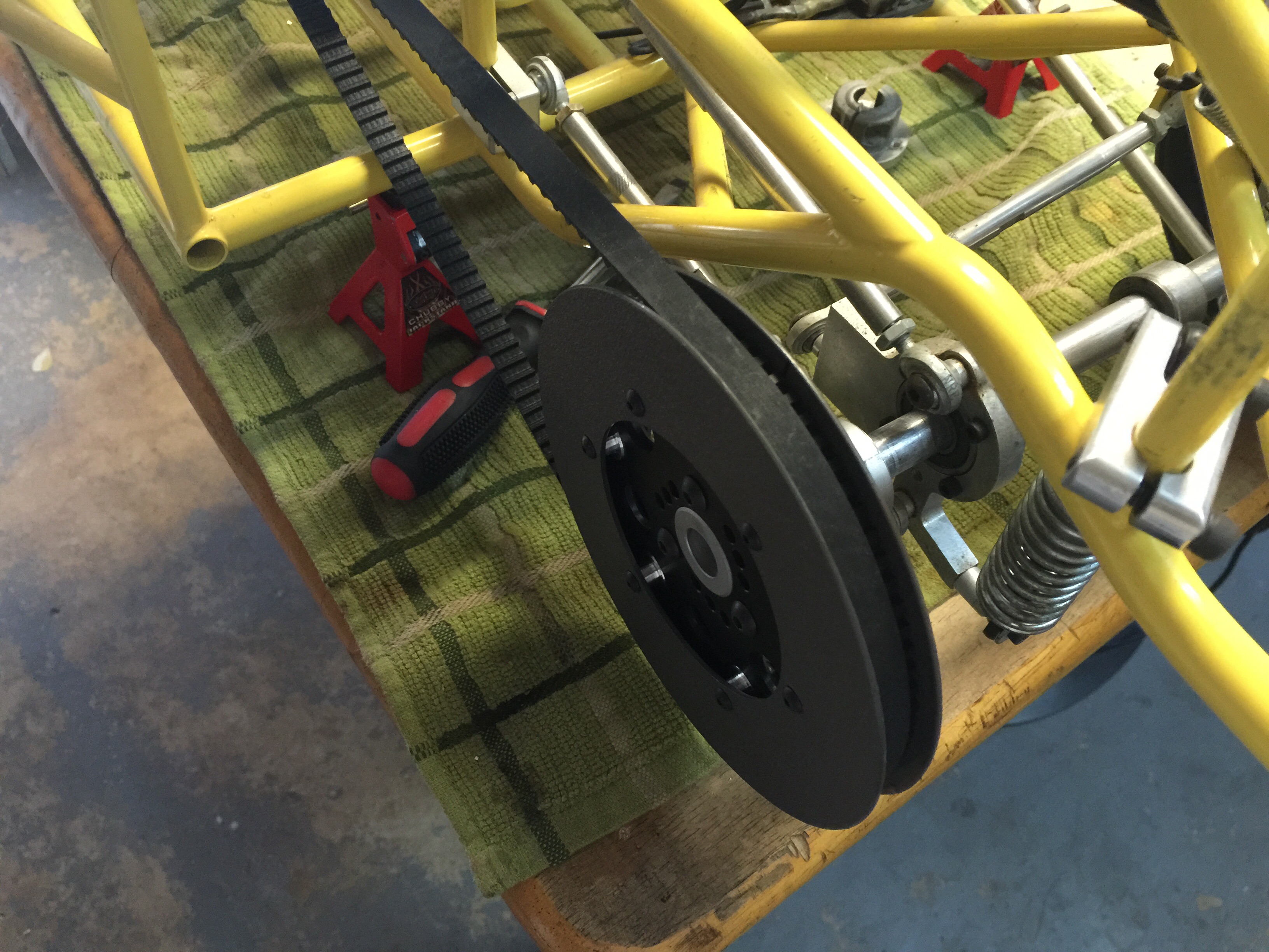

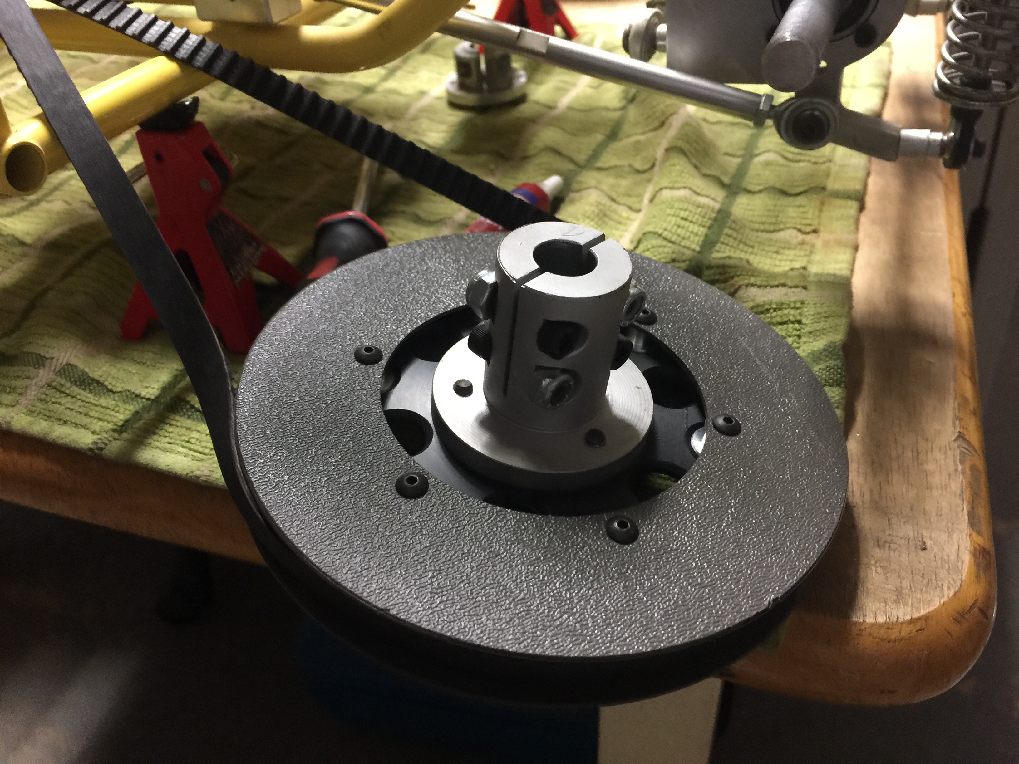

I got these 2 GN cars and one is a belt drive. They are very well built one says GM Motorsports. They are extremely well built and may even be better than my Delora GN. Very impressed. The one with the belt drive the rear axle seems way too short to put the belt sprocket and hub. Please see the pic. Are these suppose to have 2 axles, one short and one long and the belt sprocket clamping both axles? Any help is greatly appreciated.

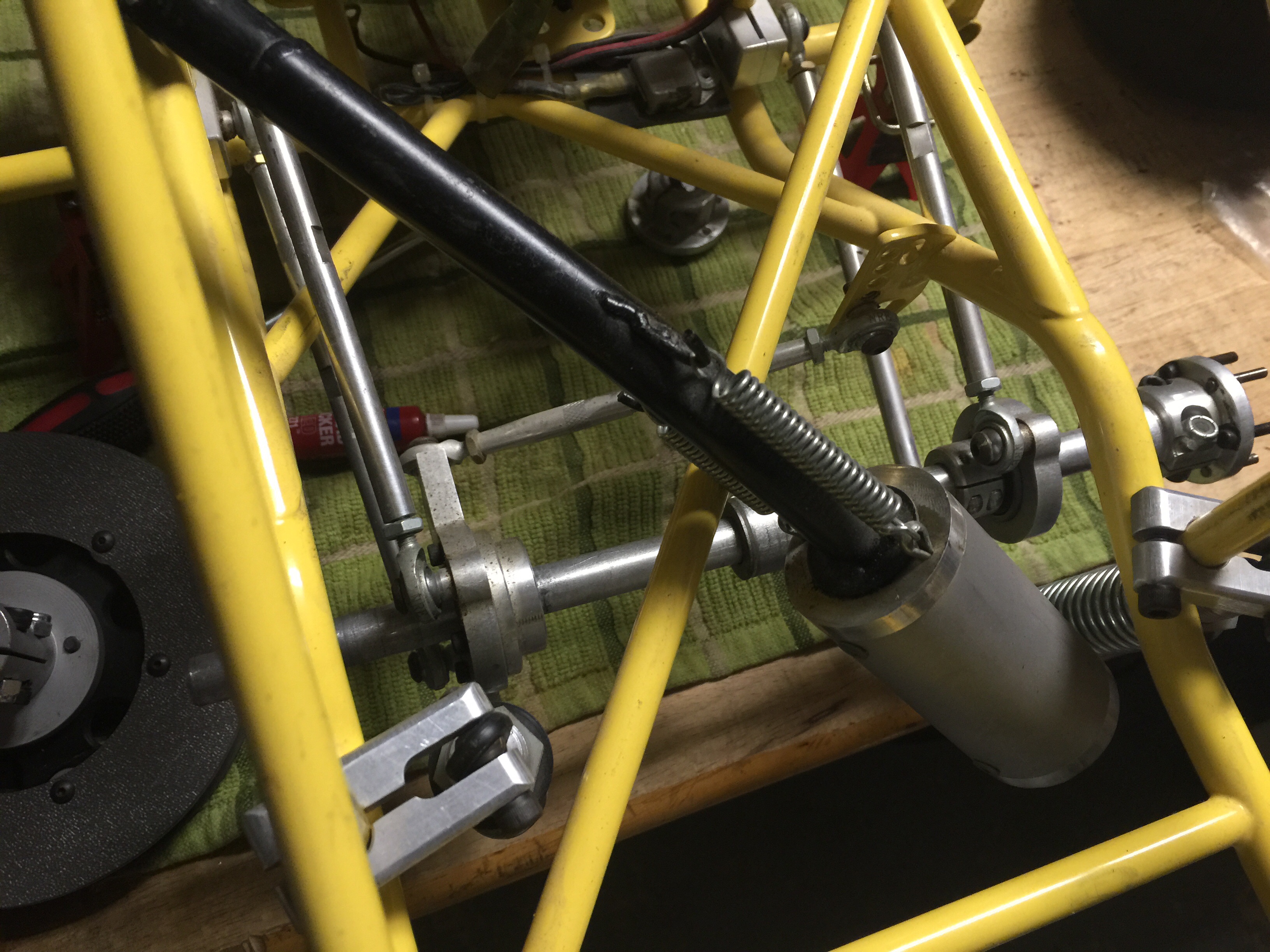

Yes mike, it's a solid axle with NO dog bones. The axle shaft seems to be about 2 to 3 inches short. I'll take more pics and post them.

The axle length is 11 3/4 imches. Is it normal to have 2 axles one long and one short coupled together with the big drive pully? It makes no sense.here are some more pics and thanks for the help

It should be a solid axle 1 piece but someone use 2 pieces to make the axle long enough to work.
