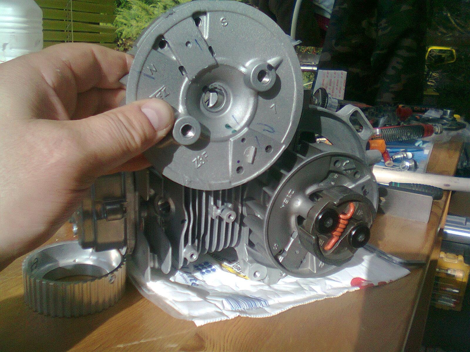

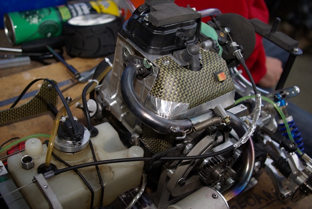

Bonjours,
We in Europe, we work for 2 years on the GX35, it has more torque!
Work ignition (CDI), the original is not good to use RC.
Jean Phi

 Post subject: Re: How to make a 4 stroke more HP
 Post Posted: September 21st, 2011, 9:07 am
Offline
Posts: 217
GX35 BigBlocRacing

Posts: 217
We modified the wheel of ignition, a Honda Gx 25 wheel mounting.
Much easier to use, because we can now use a 54 mm and standard Bell clutch.
Jean Phi
