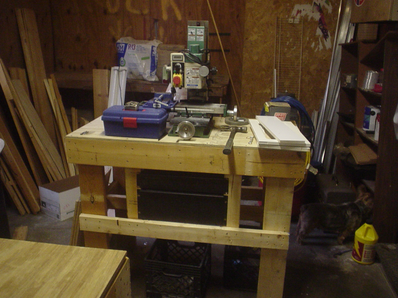

Getting settled into the new-to-me house & finally some time to start setting up the shop.
8' of new bench space, a build table in the center with access from four sides & a table for my benchtop mill.
And, my buddy & administrative assistant, Lou thu DAWG.
Posts: 643
Re: home brew quarter sprint
Wonderful work space.
