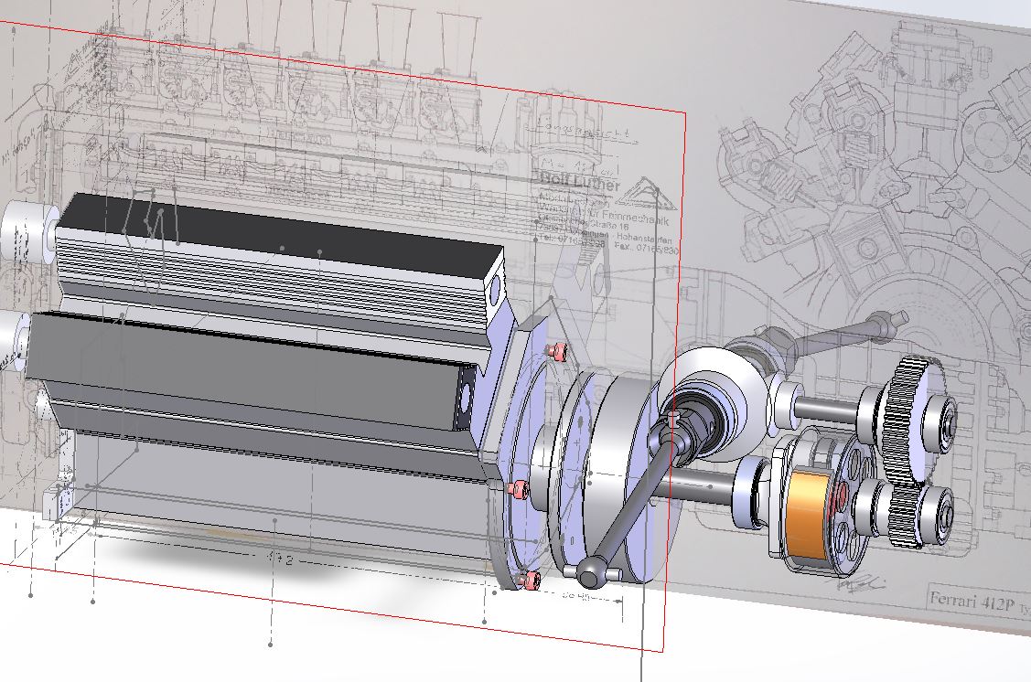

Re: Ferrari 330 P4
The complete design will be made in CAD so it is easy to see where the roll center and the center of mass will be. I will show it later in this post if somebody is interested but in the end this car will be a shelf queen.

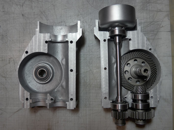

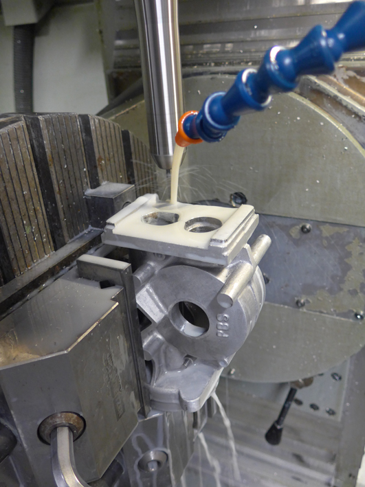

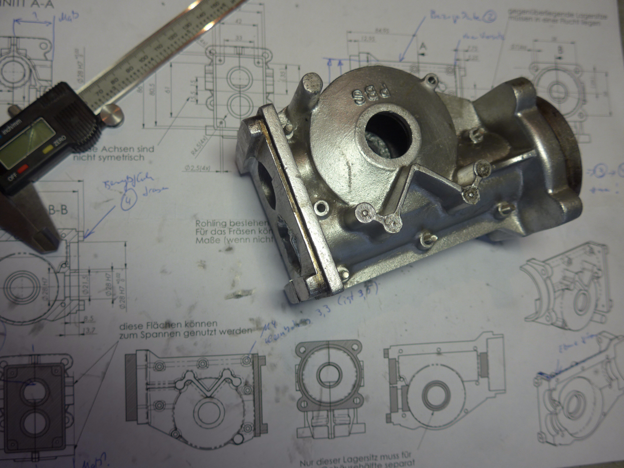

Re: Ferrari 330 P4

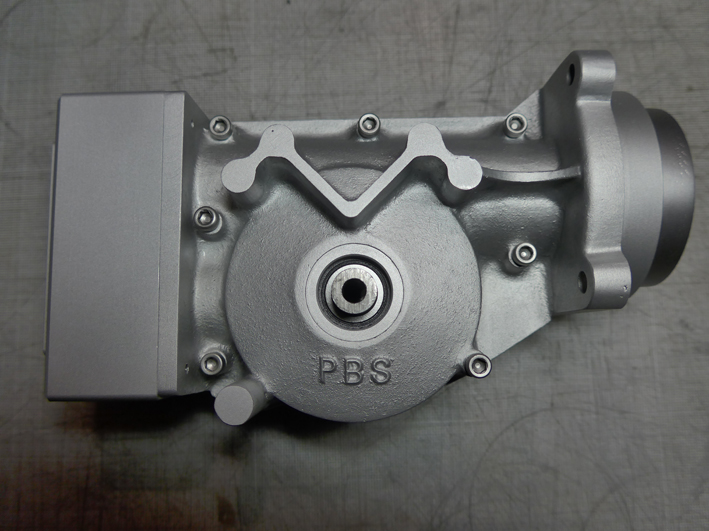

I milled the PBS gearbox. I also made a new steel axle. The aluminum axle was always a weak point at the RACO...
- rc garage berlin

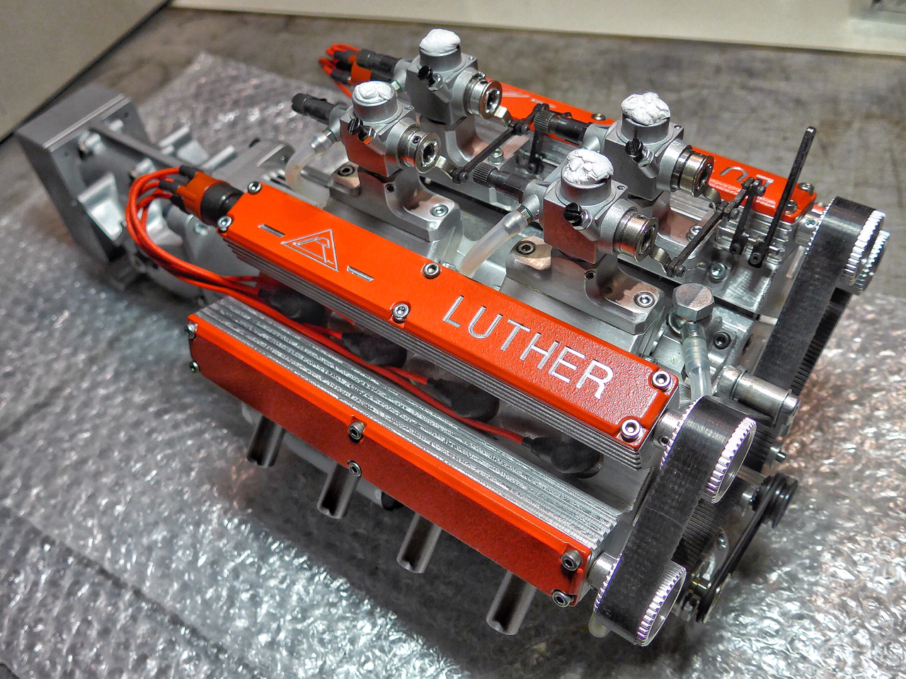

Re: Ferrari 330 P4

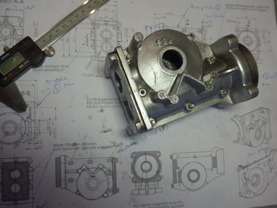

The Luther V8 engine and the PBS gearbox just arrived.
Looks good but over all it is 40mm too long...Luther said he
made some changes in the last years. That really causes problems...
Re: Ferrari 330 P4
That's got to be really frustrating...it's a beautiful piece!!
What's your solution?

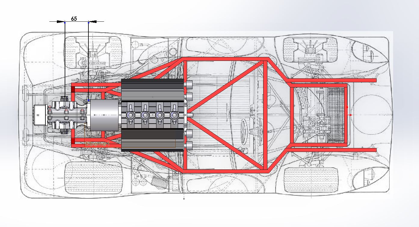

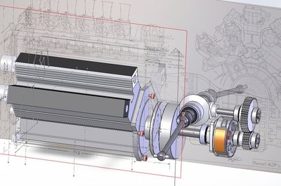

Hallo guys,
sorry for my late reply. This concept shows what the Problem is. I am 65mm behind the perfect Position of the rear Axle. That means that I have to engineer my own gearbox that brings my axle in the right Position. This might be possible if I place the clutch on the outer side of the gearbox...
this project will take much longer as I expected and much more expensive too.
Re: Ferrari 330 P4
When looking at a full screen blow-up of your diagram, the bellhousing/clutch can/scattershield between the engine & trans (what ever the proper Ferrari term may be) seems quite long. I assume that there's no way to shorten it to help correct the alignment of the axle?
- rc garage berlin
- Posts: 304
- Location: Berlin
Re: Ferrari 330 P4
Clutch behind rear axle = very good thinking / proper engineering!
