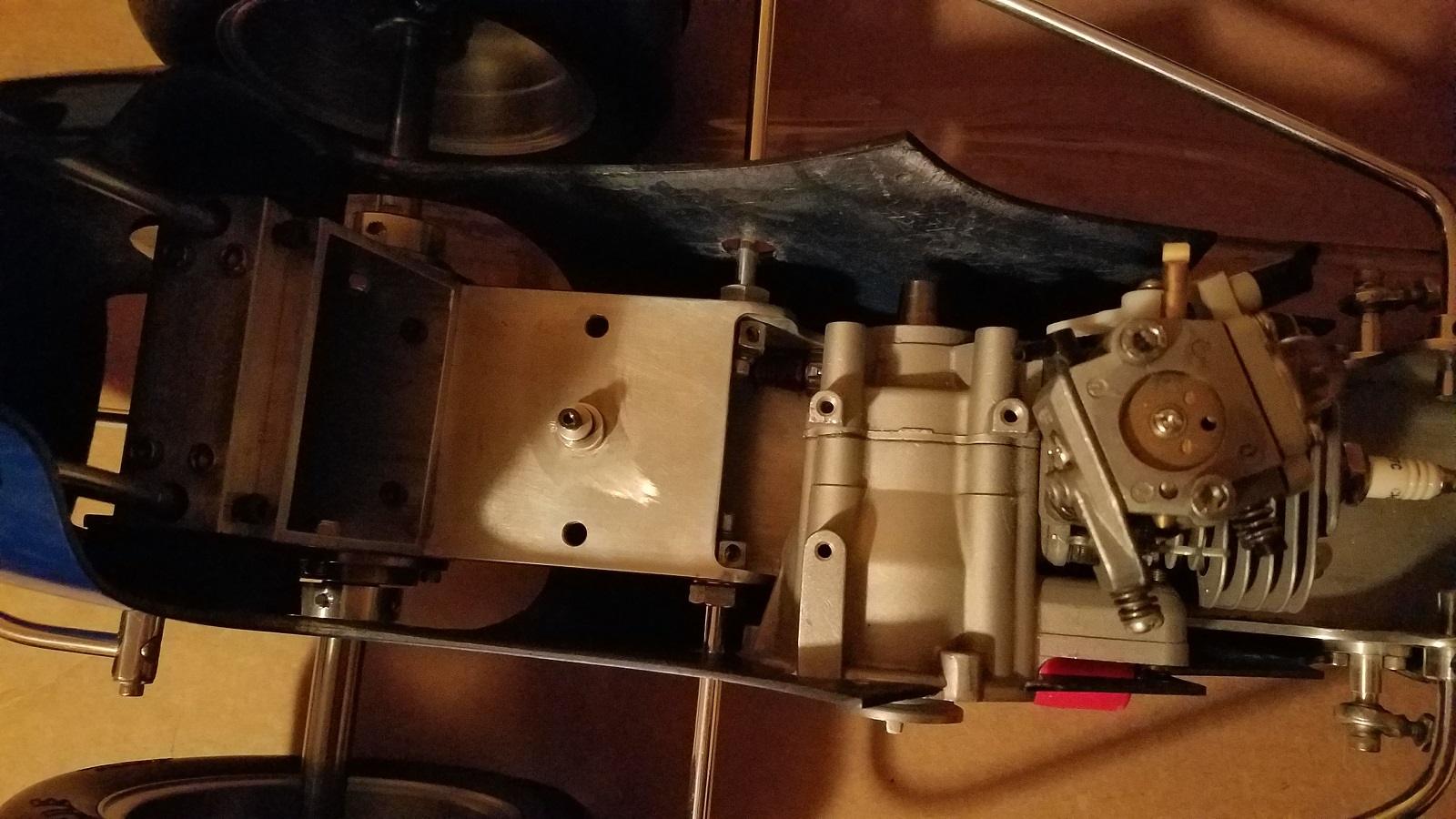

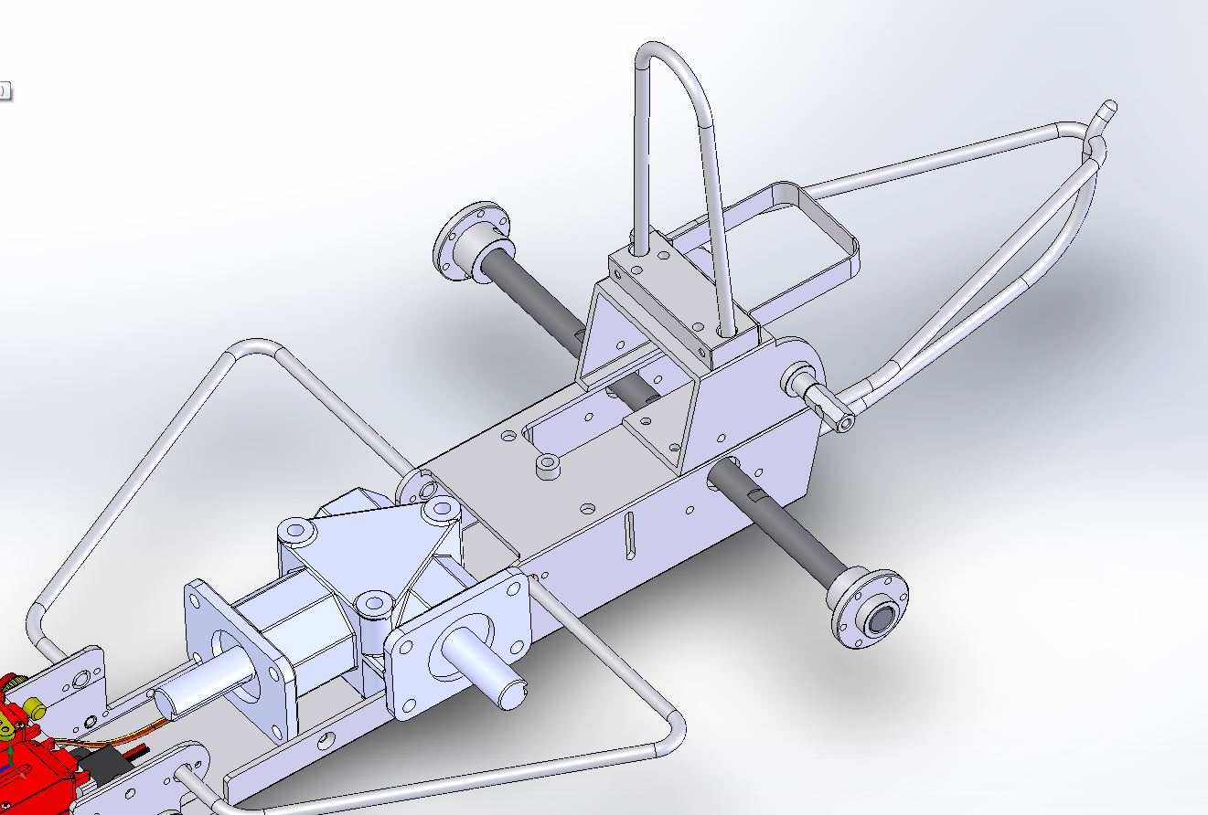

I Need more Details. There is not much space. I think that is the reason that Mr. Gilmer made the SideWinder. Without CAD Engineering I would never be able to finish it.

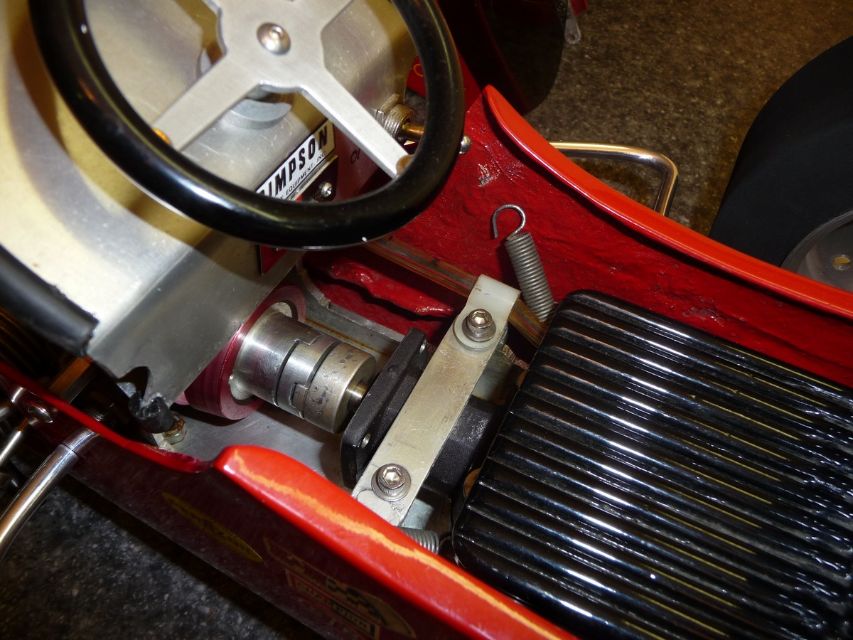

Hi Rc,
Is that clutch and cogs custom made? Can anyone purchase something similar? Thanks

Hi Emilio,
I buy some of the parts at
http://www.maedler.de/product/1643/1616 ... htd-profil
The clutch is custom made...
- rc garage berlin
- Posts: 302
- Location: Berlin
Some parts were taken from a Lauterbacher clutch. You need one with no spring in the middle.

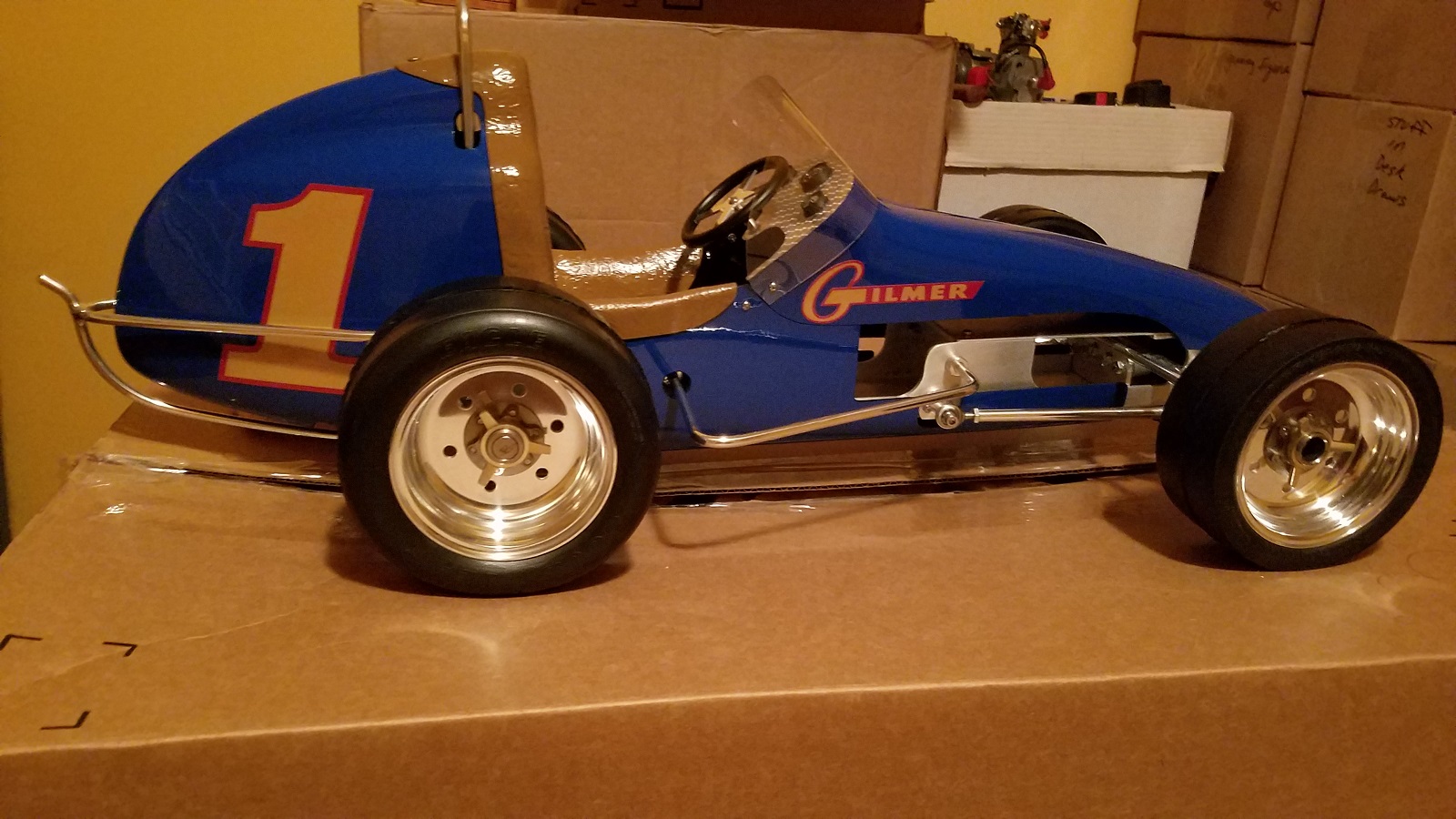

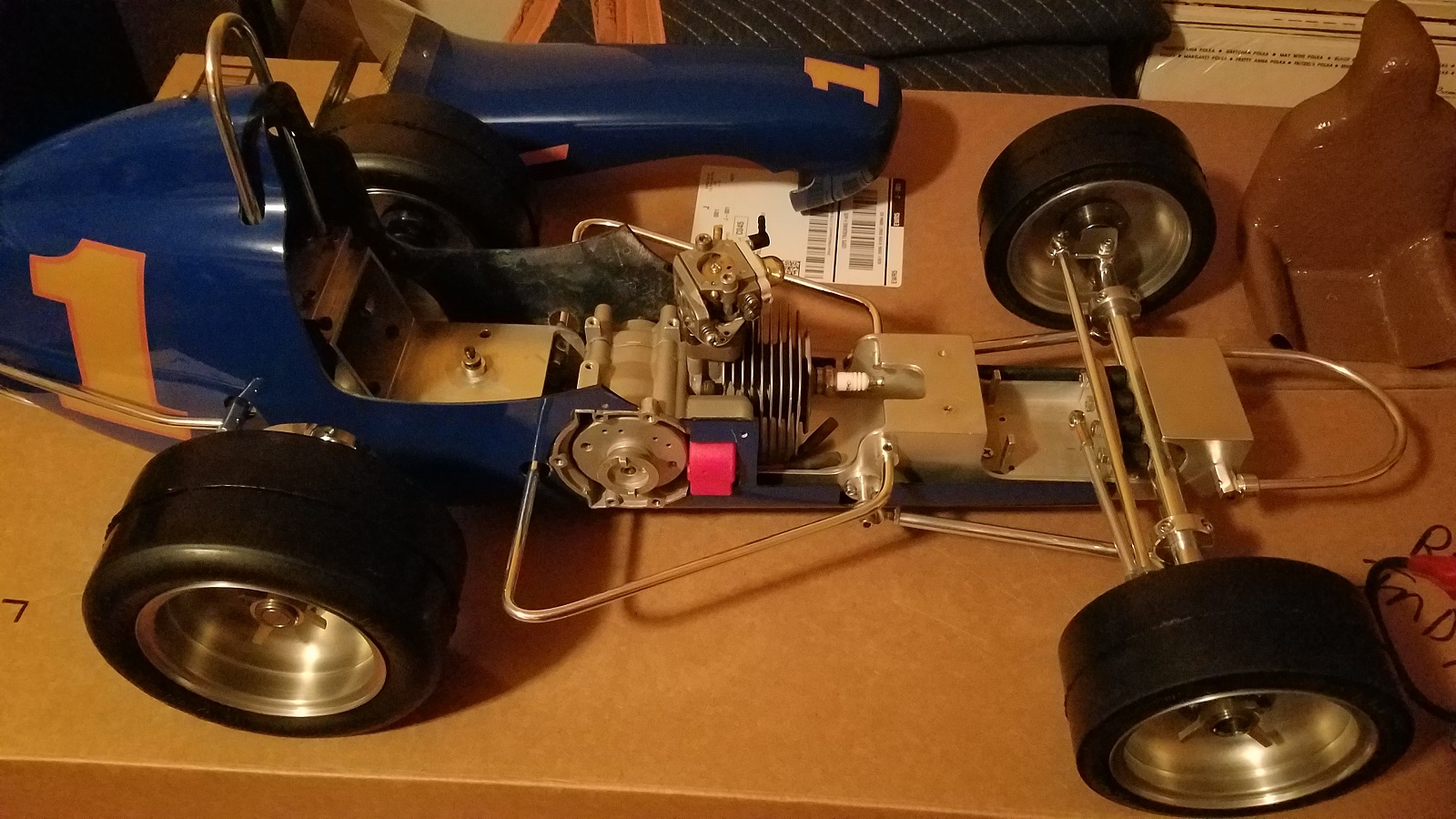

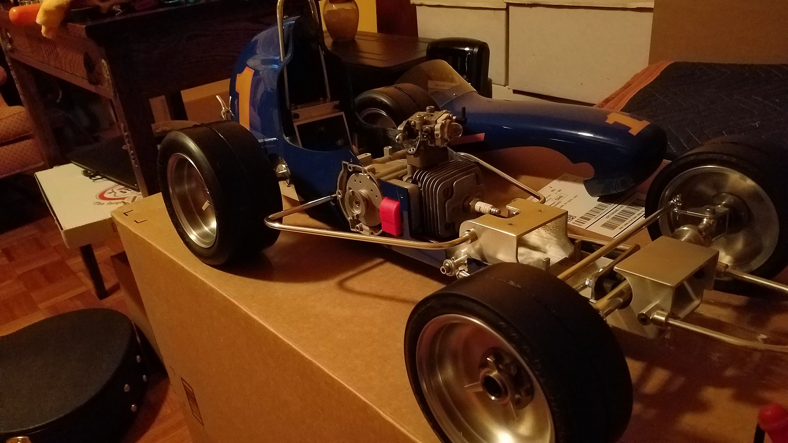

We need photos of the actual lay out of the drivetrain that Gilmer used with the saito twin 90 and Kawasaki TG 20. I want to avoid cutting into the chassis. I don't know what to look for as far as sizes and hardware go?
Anyone have photos of Gilmers lay out?
Anyway, there's a company that does custom CNC work in New Jersey that is going to look at making hubs and rear shaft adapters for my quarter mortar Raco Indy BBS rims, most likely I would like to show them the Gilmer for a possible solution on a drivetrain?

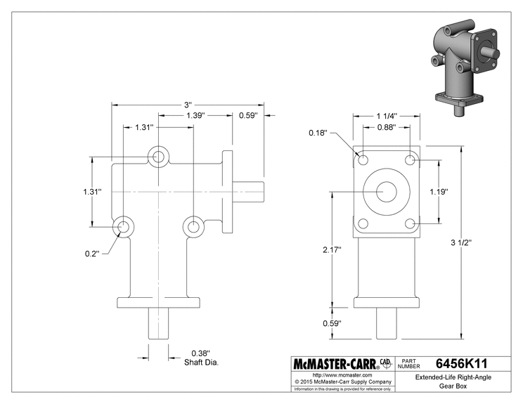

Hope you don't mind continuing the conversation Rc? I have a brand new Gilmer untouched U-finish model and sold my other Gilmer on ebay. I dug into the QSL archives and found a thread Mike.C and Bobby dogger talking about how to get a saito engine and driveline in Bobbys Gilmer.
Turns out that Gilmer contacted Bobby and gave the website that carries the two-way right angle gear box. Problem is I wouldn't know what size to get? Rc maybe if you click the link and check out the dimensions you could figure it out?
As for the adapters to fit the shaft on the gearbox and crank shaft on the saito, I could always find something or have it made. Thanks Rc
https://www.zero-max.com/cbb-two-way-ri ... le-gearbox
Rc you could see the two-way right angle gearbox in this photo, seems to fit without cutting into the body?

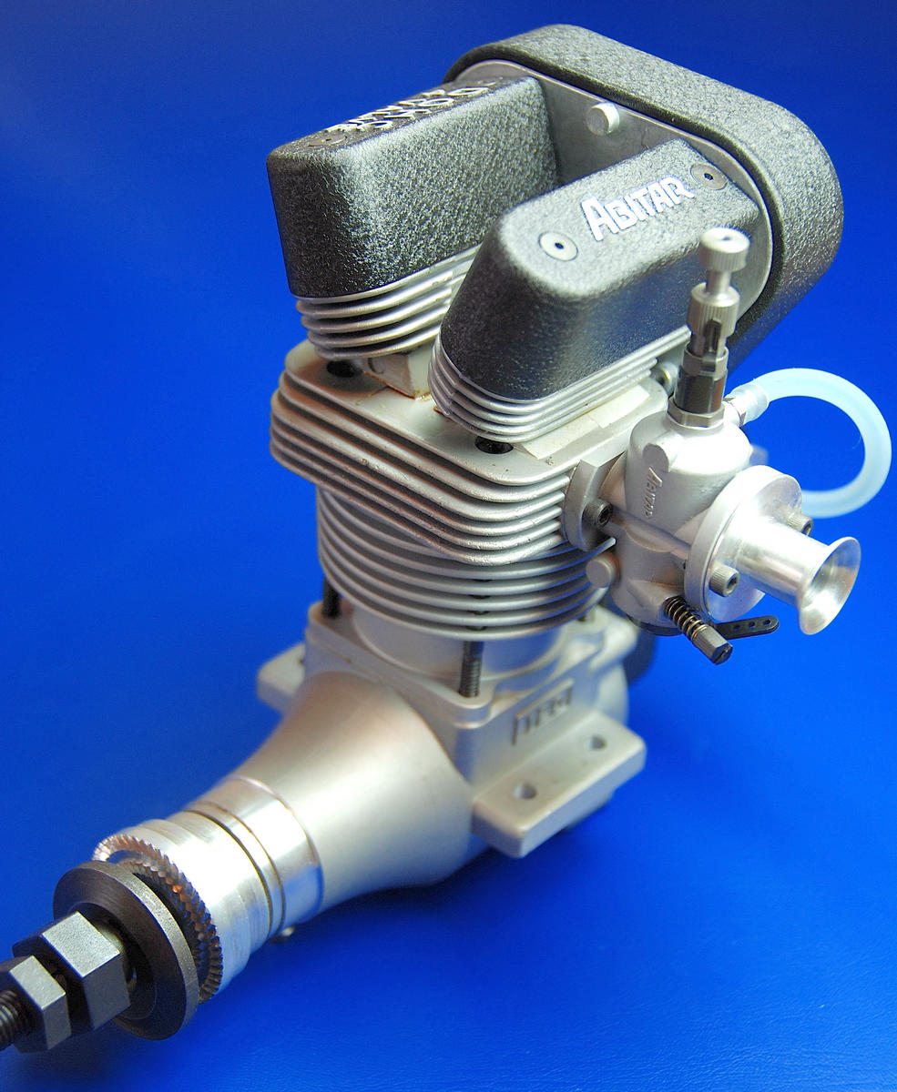

I think this overall size gearbox will work? I think I'm going to go with an Abitar overhead cam engine, both this gearbox and engine looks to fit the gilmer without cutting the body or chassis, but a few drilled holes, and run a chain and sprocket on the gearboxx and axle.

Hallo Emilio,
they have CAD Files for that gearbox so it would be easy for me to place it in my assembly. Then we know if it fits, but you need a Login to download. Could you please download the file of the gearbox you want to use and send it to my Mailadress?

So Gearbox ZERO MAX-C104806 seemes to be too large ...
