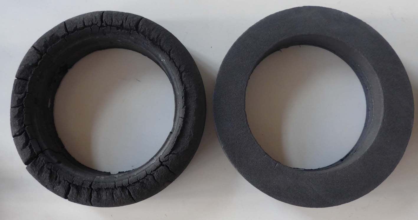

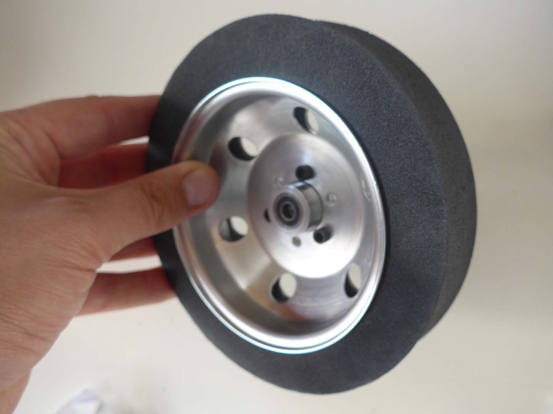

I made front tires for my old Pacesetter Funnycar. I use closed cell, cross-linked polyamide-6 foam. It is called Plastazote. It should have 52kg/qm or more.
Here is a link to a datasheet:
http://www.zotefoams.com/wp-content/upl ... 6.14-1.pdf
Michael
