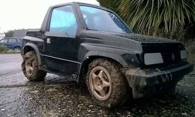

I got this 1/4 scale Yankee Suzuki Vitara and then realised it may be rare and need preserving, but I decided its time to have some fun and go off road. Absolutely love the model. It has very much got me into 1/4 scale. When I am not running it off-road I love tinkering and fixing it. The exhaust kept popping off. Now sorted. The old M15 engine has been tweaked and runs pretty well. I love the idea of using regular unleaded (plus oil), rather than nitro. This Yankee concept 92 must about 20 years old but I recon its low mileage. I'm having so much fun with it that I rather have loads of fun that preserve it. I now want to make a scratch built 4WD. I have seen on this site some awesome differentials. I plan to have a 1/4 scale off-road 4WD pick-up truck and think a Strimmer (Weed whacker) 30CC engine would be good. Love to know your views on a good engine size and a good gear box for a scratch built off-road pickup truck. 1/4 scale I'm loving it!

Enjoy the car, if you damage the body you can get a new one (green ABS plastic) for 190 Euro from Yankee.
Re: Preserve or have some fun?
Enjoying it for sure. I will strengthen the body with some fiber glass. Would like one day to mould my own car body using PETG. Think I will mould the bumpers first and see how I get on.
Don't use fiber glass. Buy some sheet ABS and special adhesive (such as 'SCI GRIP / Smarter Adhesive Solutions, 4707 Fast Curing, Milky, heavy bodied solvent cement; IPS Corporation, Box 379, Gardenia, CA, 90248. www.ipscorp.com ) and strengthen the body shell by cementing in ABS filler pieces that you'll cut from the sheet ABS plastic. I bought this adhesive from a local plastics fabricator in Toronto; talk to one near you! For the bumpers, build a mould and pour the bumpers from cold cure urethane or something similar that's flexible when cured. Just some ideas. PETG isn't idea for rc bodies.
