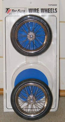

got my front wheels today, nice set of 4 inch spoked model plane wheels
gonna have a good time in the shed this weekend, got the material for the chassis but i still need the go kart wheels to finalise the chassis design

And heres the results so far, the chassis is done pretty as much as i can till i get the go kart wheels for the back. The front wheels are 100 mm diameter and they look bloody tiny on the old girl, dont know if i can get bigger wheels that look good for it though

Maybe for the front wheels you can find some scooter wheels of some sort.... Actually there was a link on the forum years ago to a place that custom made wire wheels in many sizes. I think its gone though now...
Re: T anyone?
Thanks QSL, i`m looking at a dolls pram or something similar, should be able to find one with about the right sized wheels fairly cheaply, just a tad annoyed that those wheels are too small, they cost as much as the damned pocket bike engine lol
Re: T anyone?
Very interesting link Dan, but kinda out of my price range, almost $400 US assembled for 6 inch wheels? I think i`ll pass, but thanks for the link all the same.......
Re: T anyone?
yea, those were the guys. That is expensive. I am sure you will find something close. The ones you have do look way too small.
Re: T anyone?
Global hobby had some that where 5.5" but I'm having a problem with the web site.$40.
Re: T anyone?
Just a thought try some baby stroller wheels or some garden carts have wire spokes in the 6 to 7 inch range they maybe more affordable hope you find something if i run acrossed anything ill PM you
