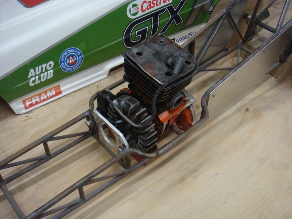

hi guys,
managed to track down a engine for my drag car today,isnt the twin 50cc i wanted but it should go ok with the husqvana 84.7cc and is around 6.5hp stock,i have a few pics,need to finish trimming the casing down and then fit the engine to the chassis,the guy i got it off said it has good torque so hopefully should go ok,
if anyone has used this size motor before i would be keen to hear how it performed,

hi guys,
have my drag tyres from brp coming,im also looking at running a 75cc engine in this car,slightly less hp but might be more kind to the tyres,the go cart rims and tyres i think wont look right on this project,the 85cc engine is destined for my other top fuel dragster project,
