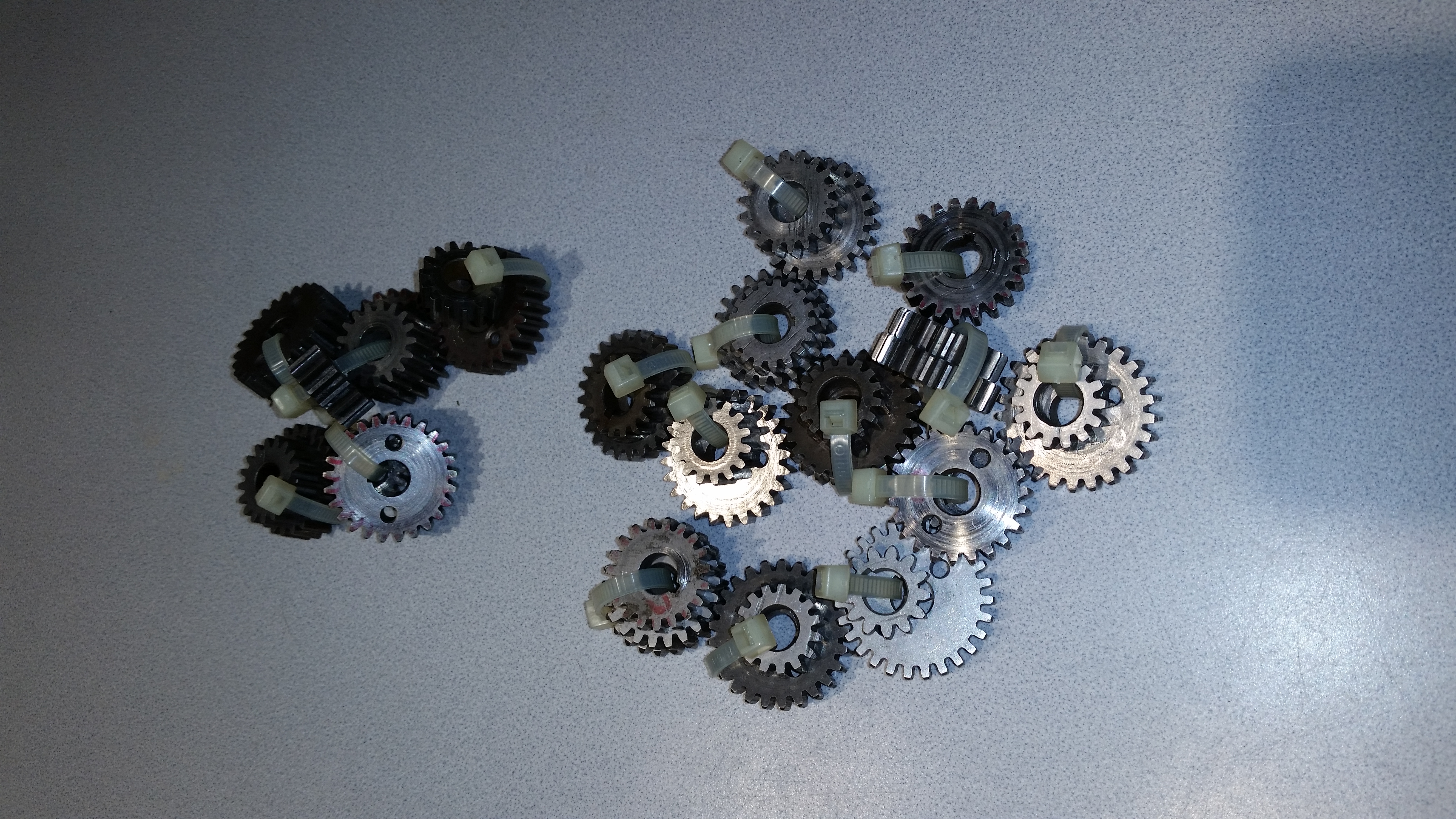

Attached is the Skellenger gear chart. There are several gear ratio apps for your phone that can help. You need to know the terminal engine RPM and tire circumference for starters. I have a bunch of gear ratios for the Skellenger rear, just let me know what ratio that you need. There are a lot on people here on QSL that I am sure will provide you with more information.
