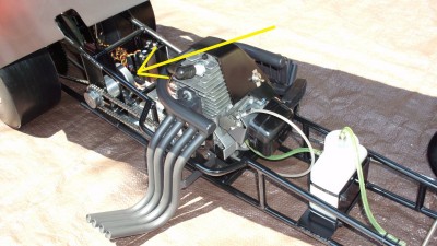

Someone has or knows where I can get the center hub for this clutch (Pacesetter Funny Car) or the complete system, its cost does not matter because I have already bought two, one from a chainsaw and the other from a trimmer and neither worked for me.
1/4 Scale Pacesetter Funny Car

All should that matter is the thread hole and clutch diameter. I found this?https://www.ebay.com/itm/265411143346?h ... Swb1RhLhvD
https://www.ebay.com/itm/224536791306?h ... Sw9OBg8ZY8

That is the problem I have, that when I buy them the thread does not match.I have a collection to open a hardware store.It is the only thing that has held me to finish it.Thank you for your help.

The Poulan looked the same. You may have to replace the jackshaft to what is more current now?

You know where I can get a trans. shaft for this model?

Looks like 3/8" or 1/2" jackshaft. Cut to length add a couple flat spots for the setscrews and thread the end for a new clutch kit. Without really looking at it may require more work? But it would be well worth it.

I already found it. Thanks
