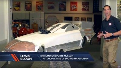

Amazing...whish I could visit the museum one day.
https://www.youtube.com/watch?v=IGkatE3zvmk
Re: Another funny car project...
Thanks for posting the link to the museum!

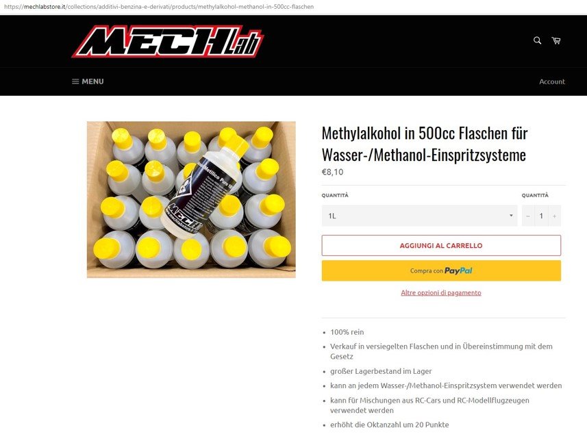

I think now is the time to start the engine for the first time. Today I ordered 1 liter of coolant "Ready-to-use" for aluminum engines. Rolf Luther wrote that this is important. Let's see if the entire system is tight.
Luther also wrote that you have to use methanol with 8% oil. In Germany it is no longer allowed to ship methanol, so one way is to order it in France, but it would be better to find a store in Berlin that sells methanol... not many people run these engines today.

Just ordered Methanol in Italy. No way to get it in Germany anymore...
