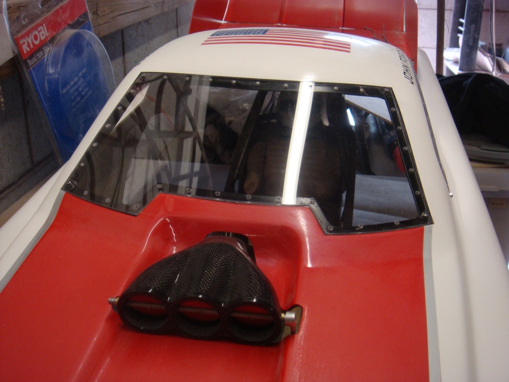

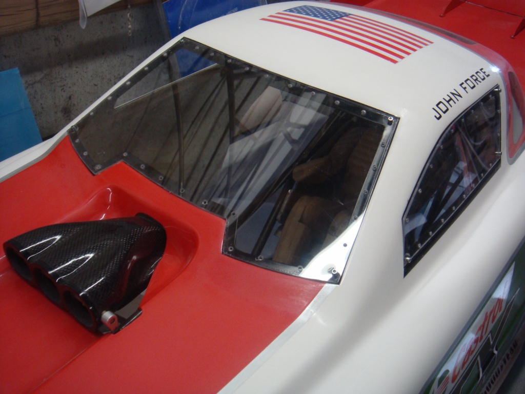

hi guys,
heres the windows ive started to get sorted for the car,going to use a slightly thinner lexan for the side windows as it will shape into the body better,alot of screws holding the windows in place ,just about 80 ,once work quietens down a bit i can get the car finished,usually like to get my projects together quicker than this,but there is only so many hours in the day,
