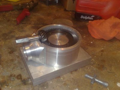

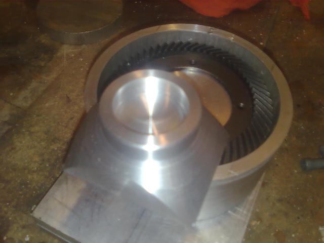

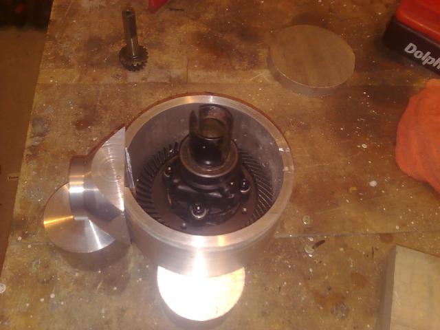

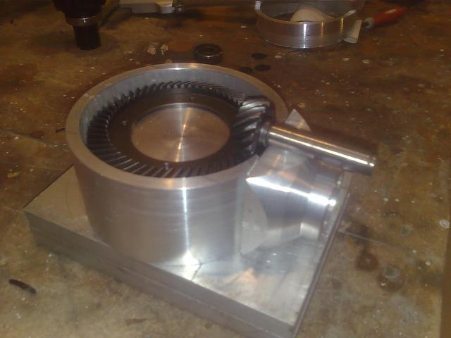

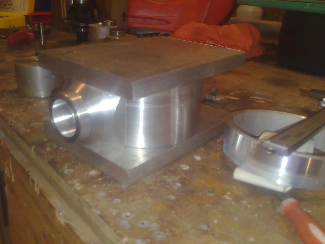

im making this diff to go under the 1/4 scale truck im building
im using a smartech center diff crownwheel and pinion
a baja alloy diff
im going to use baja dog bones and outer axles and bearing holders
the rest i will be making myself
will allso be fitting ESE hydro brakes
heres some pic's of what ive done so far
a baja alloy diff

Wow Bentley - looks great. i used those same gears and did a Quickchange diff..however it was made from steel and welded so pretty ugly compared to yours..Hopefully the 1/4 stockie will fire soon...Building another 1/4 scale stockie but going brushless on that one..Gasman has started building his 1/4 sprintcar so hopefully getting a few more here in NZ! Cheers Dwayne

cheers dwayne its a lot of work in making a diff isnt it

Yeah Brian tried to convince me to do the reduction off the motor, but I wanted the look of the QC. The ring gear is quite big so my housing ended up big as well...I'm not overly worried cos extra weight over the rear wheels will be fine, as the front end with all the bar work is heavy. I'm just trying to fit some oil breathers, sealed bearings etc in the QC so i can run proper diff oil..Thats proving a challenge and i should have just stuck with grease..Once Ive got it sorted i'll email you some pics. Trying to get Bruce Clarke to get my chassis jig back so i can knock up a new chassis. If you decide to make one then you can borrow the jig...decided on the Castle creations 1/5th brushless system - something like 10hp with 8s2p lipos..Sounds like it will wheelstand! lol. catch ya Dwayne
