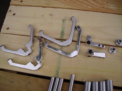

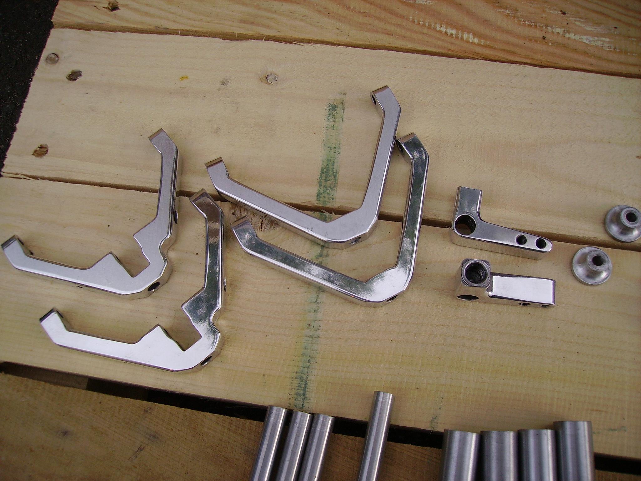

Thanks Funky Monk , Well just about got all the rear of the car polished out still got a few pieces to go but should have it done by this week-end. It is very labor intensive but the finished results are AMAZING !!! The flash on my camara dulls the parts but I assure you they are nice and shiney
I have ran into some curve balls, If your gonna use oven cleaner to get of anodizing dont forget about it. I put my shock jam nuts in a bowl and forgot about them overnight and the next day the cleaner ate away at the aluminum they were wasted!!! So took a trip over to FASTENALL and they are ording me new Jam Nuts as well as all new Aluminum screws and nuts and washers as well as all new bearings.
I have to pick up my parts from the powder coating shop tomorrow (will be dropping off the rear trailing arms ) and I plan on swinging by the wifes work and seeing what it will coast to have the rear transmission cases done in aluminum, I was talking to my wife's boss last night and he said he would take care of me since I have decided to go nuts on this car LOL LOL So hopefully I will be selling these as well. I even have him interested in a side biz my company will be RESURECTED RC. The rear shock mount and the cases can be used on any Raco so should do well on those to start. Then I am going to have the side rails did Anyway back to the build.
I used a number of tools on the polishing I purchased a buffer/polisher ,extra wheels, brown and white polish, sand paper, and to get in the cracks and crannys I had to buy some polishing wheels for my dremel (that sucks) I am looking for a adapter for my buffer so I can attach a CONE buffing wheel would make things alot faster and easier. I followed the instructions on YOUTUBE (there is a ton of videos on how to polish) I Am new to this polishing thing but I have to say it is labor intensive but can be done with a minimal investment (I am invested about ($200.00 bucks in tools and supplies) but I can use these on future builds.

It’s looking good. Don’t be afraid to take a file and sandpaper to your parts to round out the sharp edges. The front A arms can really benefit from a little or a lot of rounding of the corners. Here are the ones I did. I got a little carried away with these.

Those parts you did look AWSOME !!! Did you use a belt sander to round your edges or grinder? how did you get em even? they look great. I am almost ready to move to the front of the car I have like once piece to finish up on the back of the car Then I will be going after the a-arms,front hubs,etc...
Thank for the tip on the steel I polished out my dog bones (see pic) can I still add Oil over the shiny finish? I also polished out the drive cups and axles as well. I am polishing everything I can and if I can polish it then its getting powder coated.
