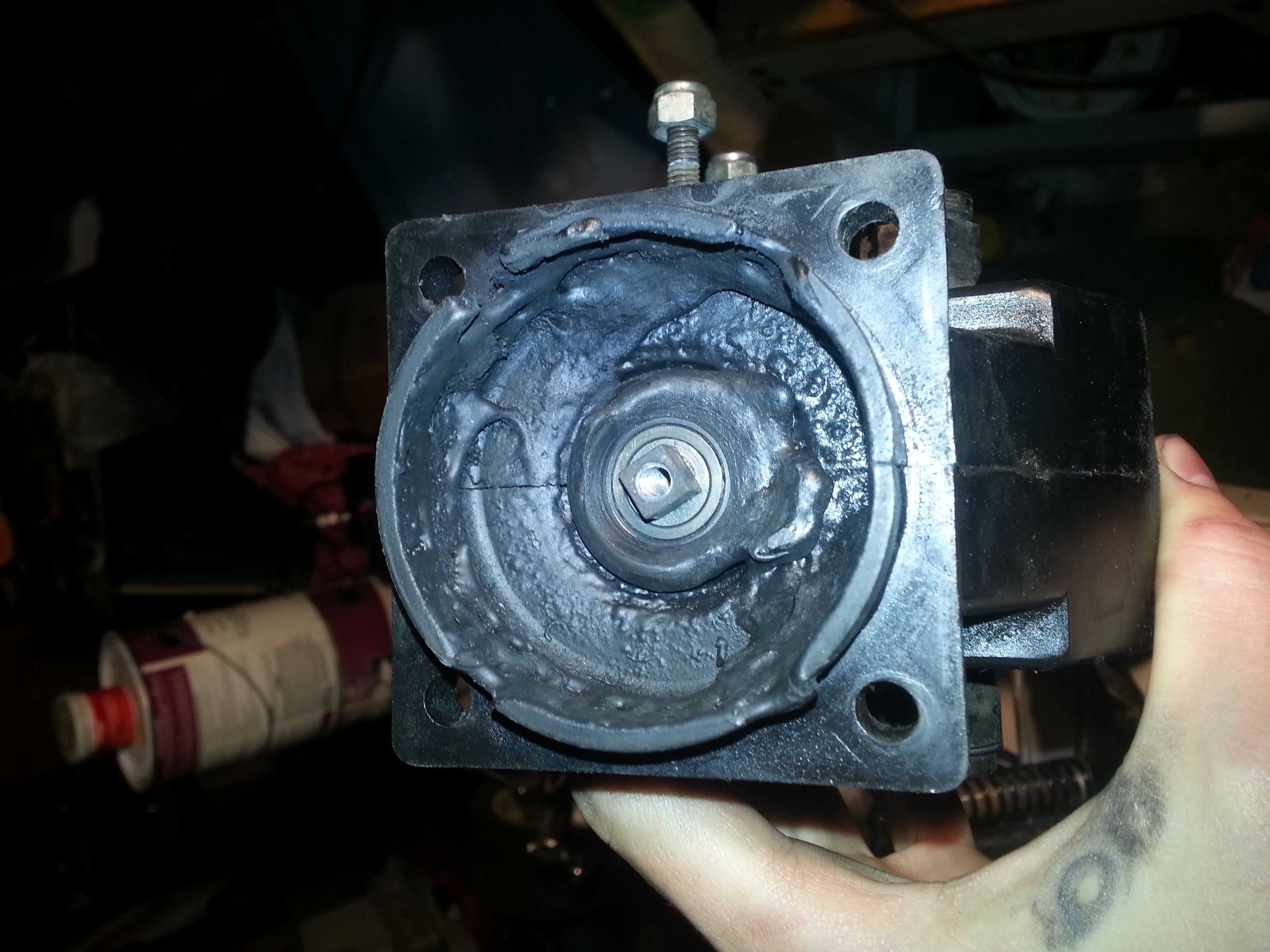

Just took off the clutch bell... I think we've found part of the problem. The entire plastic casing behind the clutch bell is badly melted. If tightened completely down, the bell actually scrapes the deformed plastic. I'll assume it's time for a new clutch and plastics when the site offers them. For now, I guess I'll try to shave the plastic away into a natural shape using a file.

Granted I don't have the parts in front of me........but I think this is what happened:
Clutch spring got worn. Shoes began dragging. Dragging shoes create excessive heat into drum. Heat travels through drum and into input shaft of trans. This heats the inner bearing. Bearing overheats, cooks all it's grease and melts housing it's sitting in.
Hopefully you can get some trans housing halves if the one's you have are wasted. Check the bearing behind the clutch drum to make sure it turns smoothly. You should be able to get a bearing pretty cheap. You may be able to pick up an entire trans if you keep an eye out.

vwguru75- awesome explanation, your hypothesis was correct. The input shaft is moving fine, but I'll look into the bearing and add that to the shopping list.

Some pics of the carnage:
Re: New guy- RACO Jack Rabbit Restoration and Issues
That's a mess.
There's normal.......and there's that. That is not normal and will not buff out.
