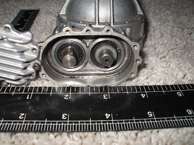

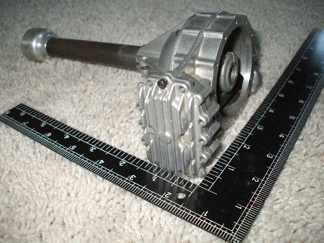

I don't have any prints and the original ones don't exist. Here are a couple pics that may or may not help. I do have a few unmachined center housings, rear covers and ring and pinion gears available.

Hi Mike
Thank you so much, i think i will be a big help
Just if i end up digging some money out of the garden, then whats the price for a
center house ?
After all to me it looks like the hardest part to make.
Best Regards
Martin

Re: Skellenger Rear plans, posible to find ?
PM sent. I need to sell these as complete kits.

Thank you so much, that and the pics from mike i think would be perfect for a go.
as soon as i am done renovating my workshop, i will start making a wooden model, so i will(hopefuly) be able
to cast the parts
Best Regards
Martin
