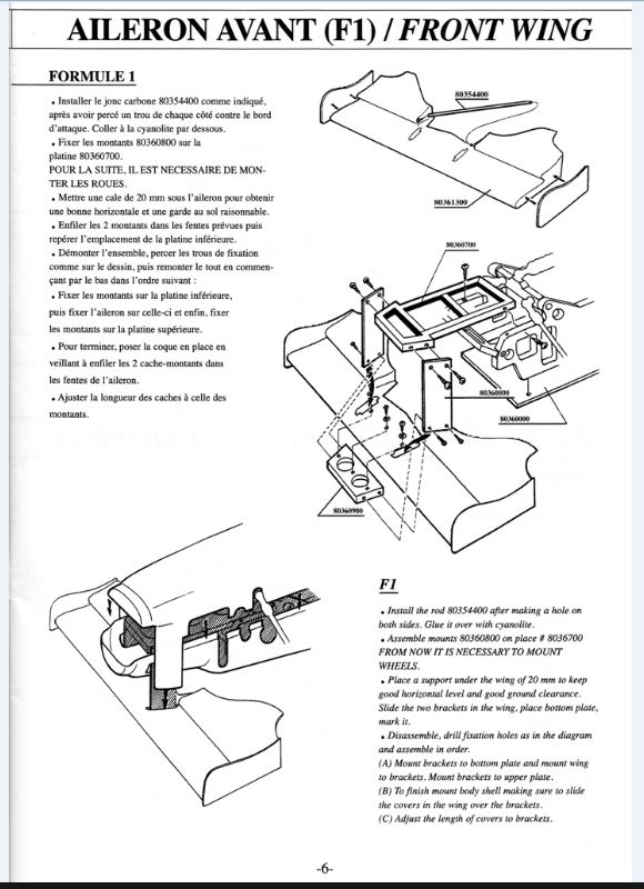

Thank you Al . Lovedr can you please post a photo of your front wing area and also your chain tensioner? Thanks

Thanks Love, I wasn't sure what chain tension you had, there are 2 kinds, I have the one with the spring but got this photo after I posted here so that's figured out. The wing is where I'm a little confused, do the outer wing legs (red) go into the slots with the inner black parts, and is the red part trimmed to fit into the slot? because it doesn't seem possible without trimming it? Thanks for your help Love.

Yes, the red legs go into the black wing. i hope this helps

Love one more question, does your F1 have the diffuser, if so can you post a photo where it's mounted? Btw the front wing worked out great thanks
