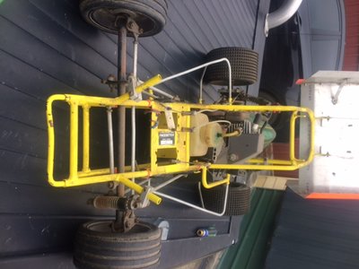

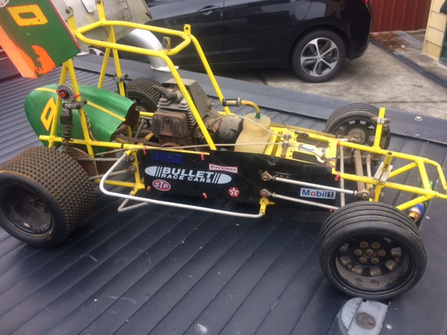

I just picked this up and wanted to show it off.
it has been sitting for awhile but with some tender loving care I will bring it back to its glory.

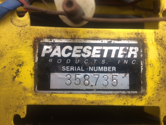

it has this frame number 358.735 is there somewhere I can find some info on it?

She's a beauty! If she was mine I would try to preserve the patina, in other words do a sympathetic restoration. I'd also stay with the current color scheme.
Re: my pacesetter
yes that's exactly what I'm going to do, just go through it and tidy it up.
the only parts that are missing is 1 front shock and the back nudge bar, I don't know how much luck I will have finding these 2 parts.

That's a High tech sprinter, nice chassis design on this car, I had one and personally think it looks better without the body parts. When I got this car it was such in bad shape anybody would of walked away from it, but the ebay photos were a bit deceiving and didn't look that bad also the description was stretched to entice, but all in all yours looks a hell of a lot better than mine did. I think the one I had turned out great imho. Looking forward to seeing yours cleaned up. Btw around where I live now folks will mistaken your car for a John Deer

very nice job Emilio, your car came out very clean and tidy, doesn't look like your running front shocks?Emilio wrote:That's a High tech sprinter, nice chassis design on this car, I had one and personally think it looks better without the body parts. When I got this car it was such in bad shape anybody would of walked away from it, but the ebay photos were a bit deceiving and didn't look that bad also the description was stretched to entice, but all in all yours looks a hell of a lot better than mine did. I think the one I had turned out great imho. Looking forward to seeing yours cleaned up. Btw around where I live now folks will mistaken your car for a John Deer

Sure it has front shocks, do you see that little wooden block? J/K, I had everything but the front shocks, I had the original wing set also when I sold it. I think the Pacesetter High tech is one of the nicest sprint cars out there and a skelenger rear will kick it up to a new level.

can someone tell me some info about this motor, make and size and can you still get parts for it, does anyone make a header for it.
Re: my pacesetter
Robin NB211 ???
Re: my pacesetter
I think that is a pito or peto engine, something like this? also might be anywhere from a 23 or 30cc engine?
Re: my pacesetter
Engine was called US Engines as well. There were two names it was manufactured. Basically no parts, but strong running engine.
Re: my pacesetter
thanks for the info, from measuring the bore and stroke it looks to be about 35cc?

I am nearly shure it is an canadian engine named Quadra 35cc.
I got a few of them and parts for sale if you like.
Difficult to find spare parts because they made many small changes over the years (for example 2, 3 or 4 bolts for the exhaus). Always one thread broken.
The Quality in my oppinion is realy bad. Got some with missing ribs on the cylinderhead. Not broken,
just missing...
Google "Quadra engine spare parts"
