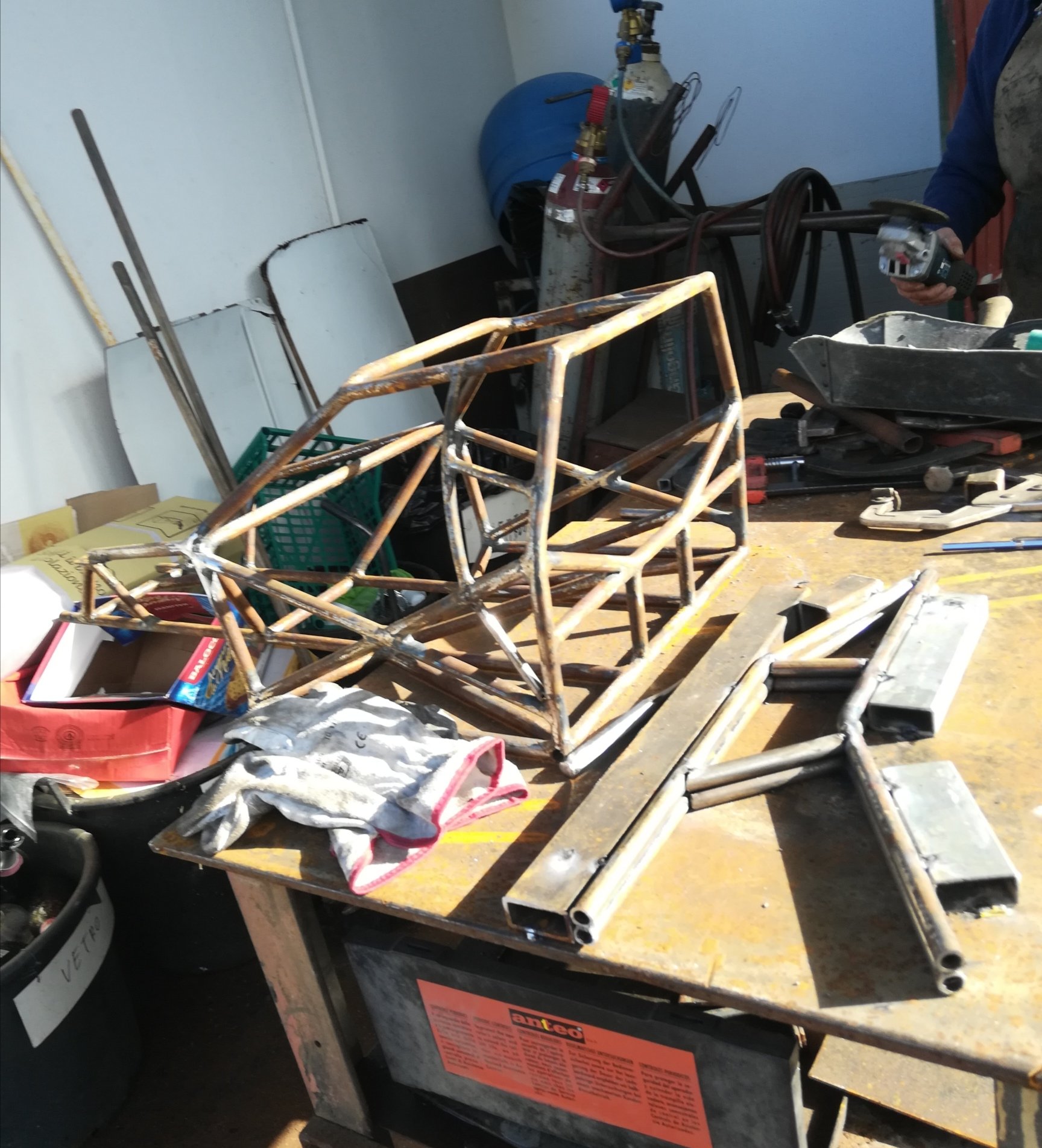

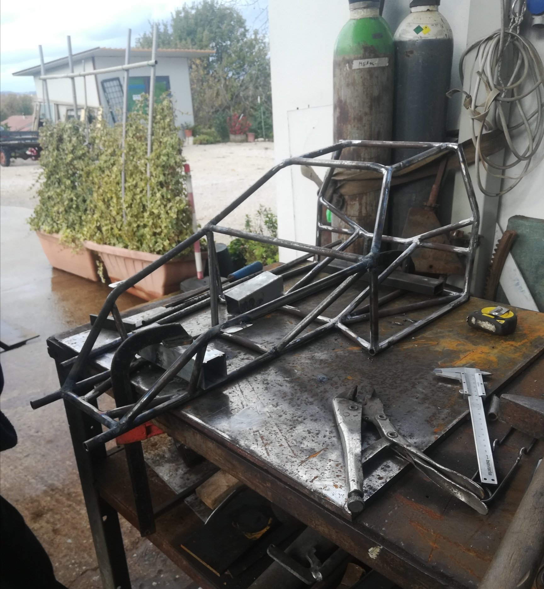

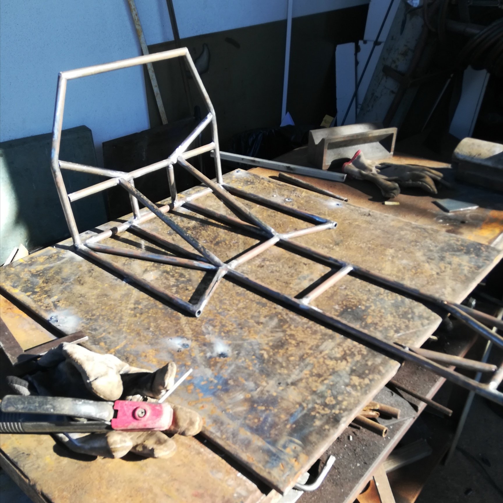

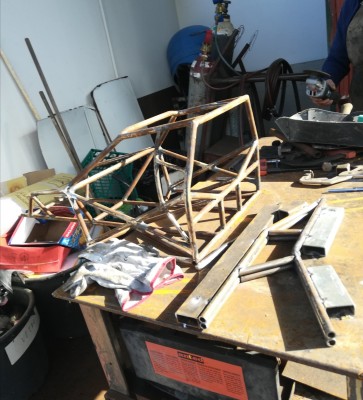

I'm building a 1/4 pro mod car from stratch, starting from the full tubular frame, axle, electronics, ecc..
It's planned to weight around 35-40 lb, 4 link sistem, torsion bar, rear go kart slick wheels, Wheelie Bar and not sure about the engine location, maybe it will be in the front.
The Shell will be a Pro Mod Challenger in aluminium, it will be very thin (around 0.04 inch) maybe fixed on the chassis with rivets.
The Chassis is planned to be 47 inch (without Wheelie Bar) length and 14.2 inch wide, made by lightweight iron tubes (0.4 inch depth).
All updates will be sent.

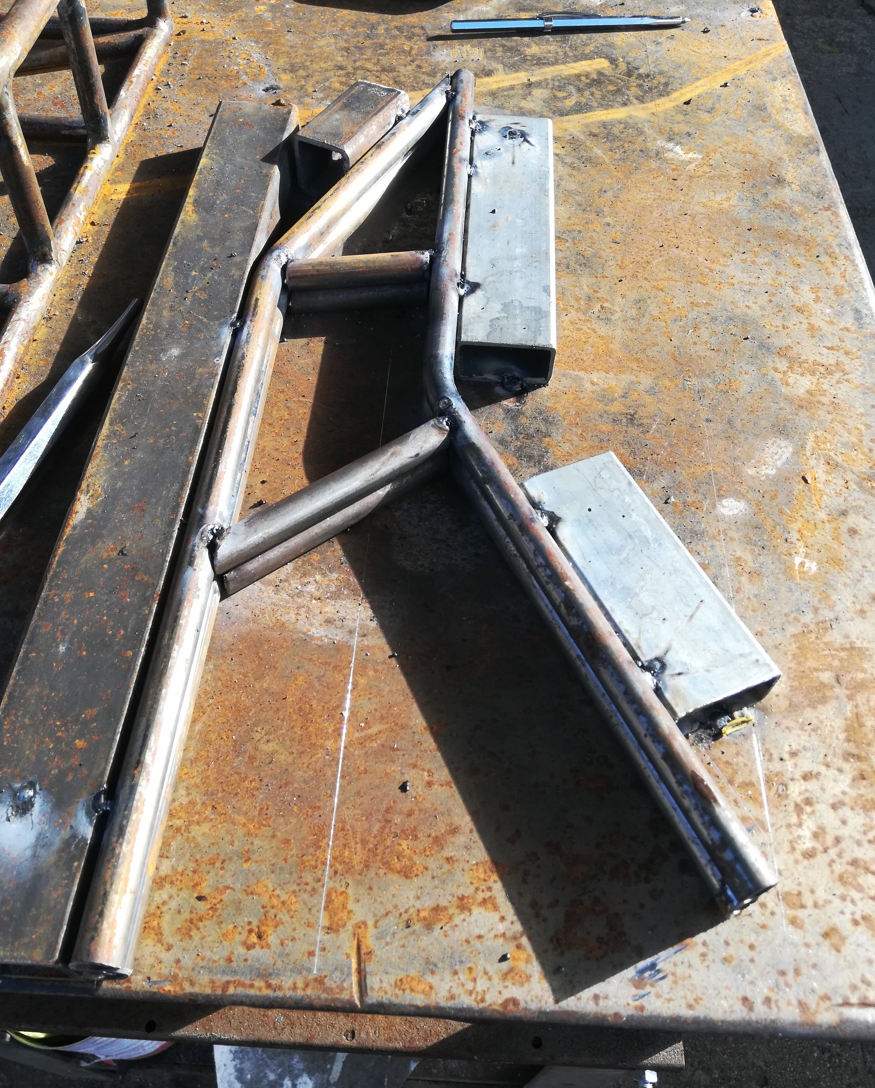

Re: Quarter Scale Pro Mod challenger
Just finished front end
Now it's time for door bars and rear end

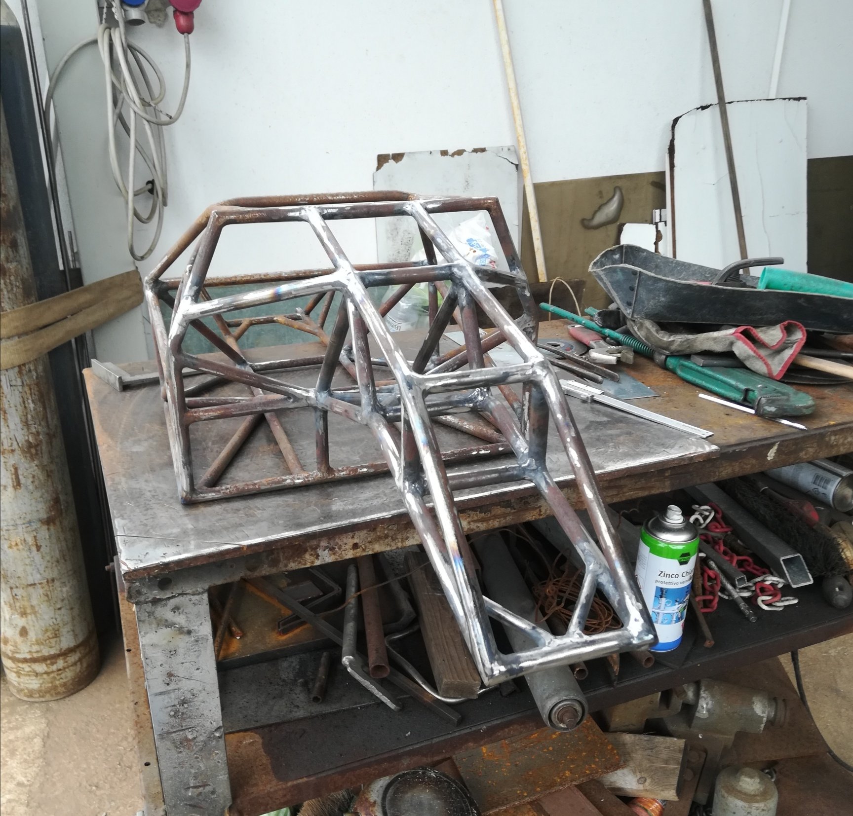

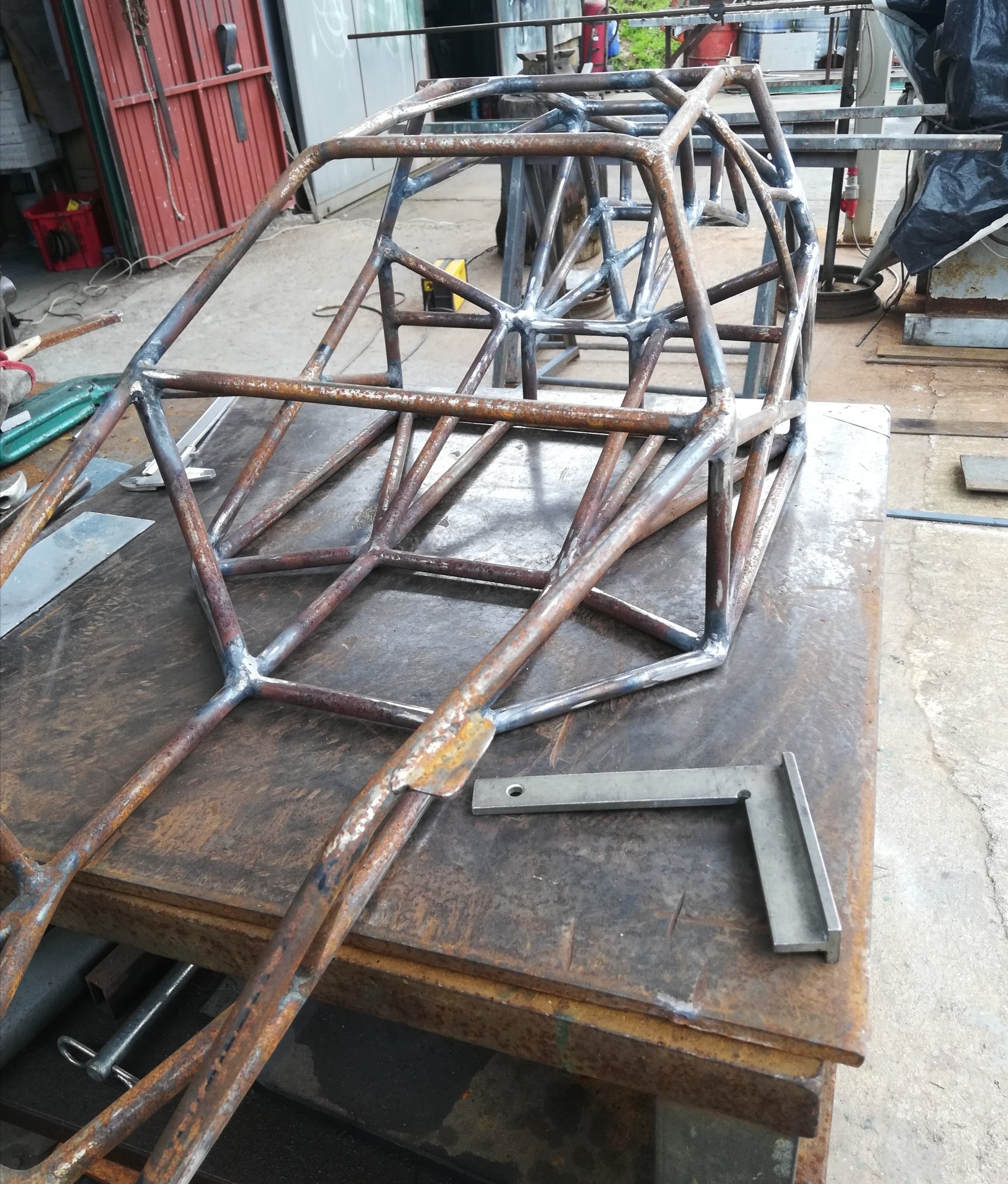

Finish rear chassis now, I think I'm near to start arms and electronics..
Thanks man, I'm really satisfied for the chassis result. Now before sandblasting and the painting I need to do electronics, mount engine plate and arms, such a painful work :/
