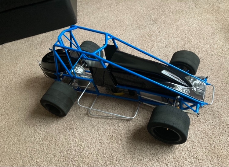

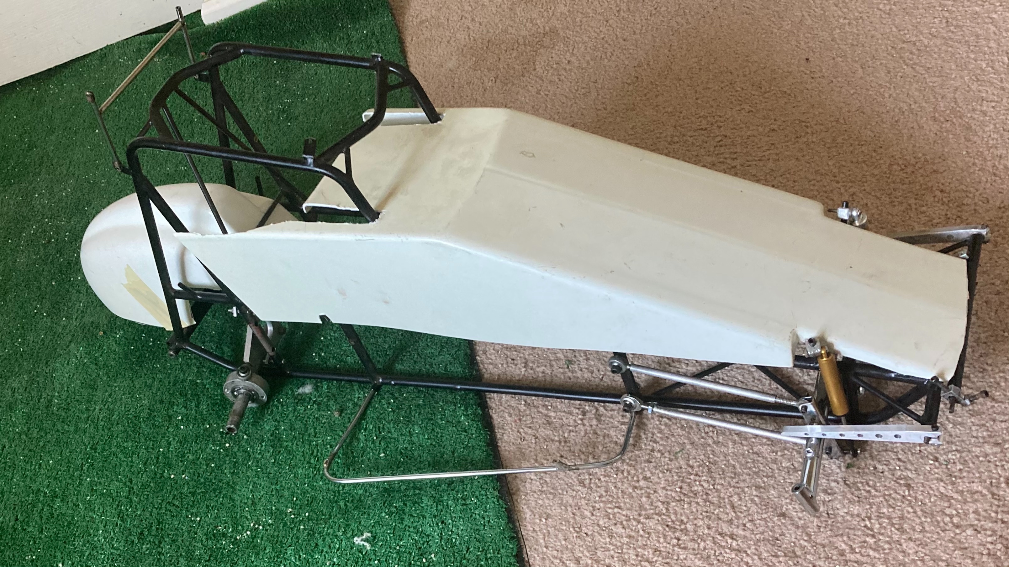

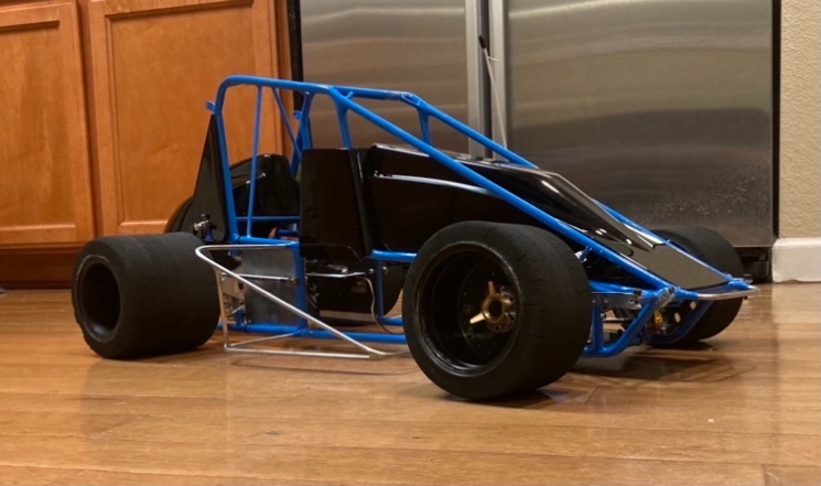

The hood is fiberglass , I simply cut the sides off and used only the center of the hood... the sides are ABS and mechanically bonded to the fiberglass... I don’t suggest using ABS ... all fiberglass is a safer way to go

Hi steve g:
What did you use to bond the ABS to the fiberglass? BTW, the painted result is extremely good!
Re: Next project.... wingless asphalt sprint
I have been doing custom fiberglass parts for show cars and race cars for years ... so what I have learned about bonding ABS to fiberglass is ..... you can’t... haha. The bond needs to be 100% mechanical and aggressive 24 grit grind or rougher is a good idea. The adhesive I have found that works best with ABS is 3M TPO 08239. It’s a tad expensive... the next best thing I found that’s a lot cheaper is JB QUICK.
Your final bodywork on the outside must be seamed and can’t be finished off smooth because fiberglass and ABS have radically different heat transfer.

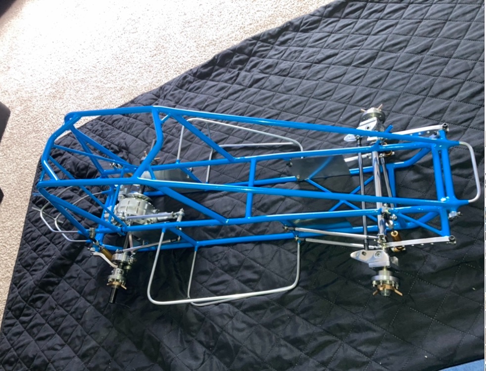

steve g: Nice picture of the frame! I love this model car!

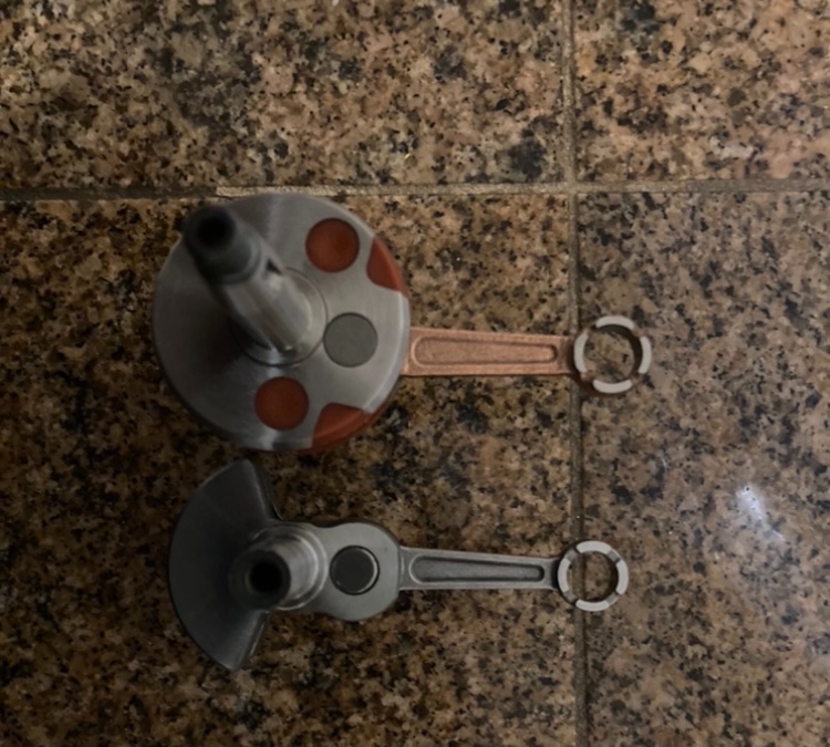

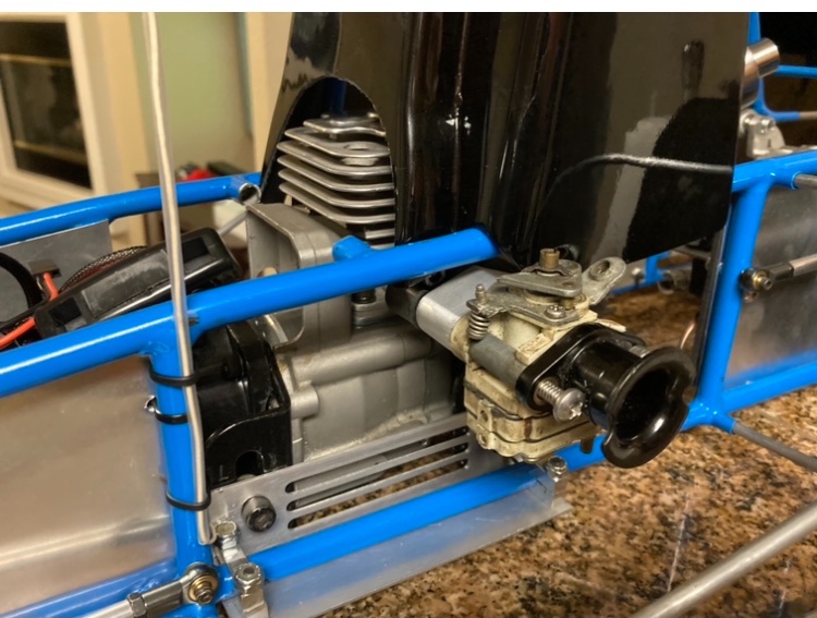

Test fitting the new motor (junk carb) zenoah G26 airplane motor with custom marine crank that allows for a pull start... custom cylinder head and port work on the case.
