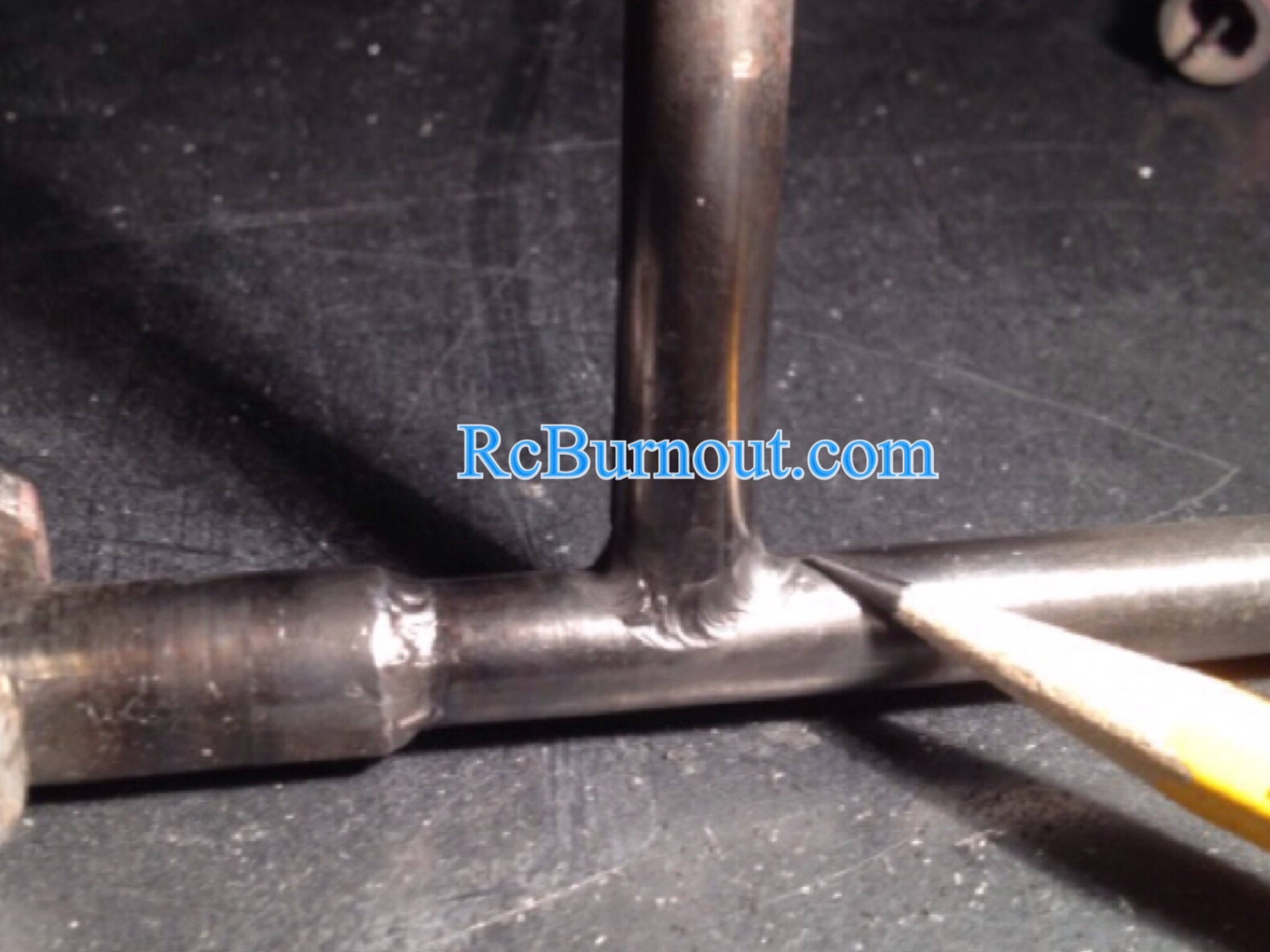

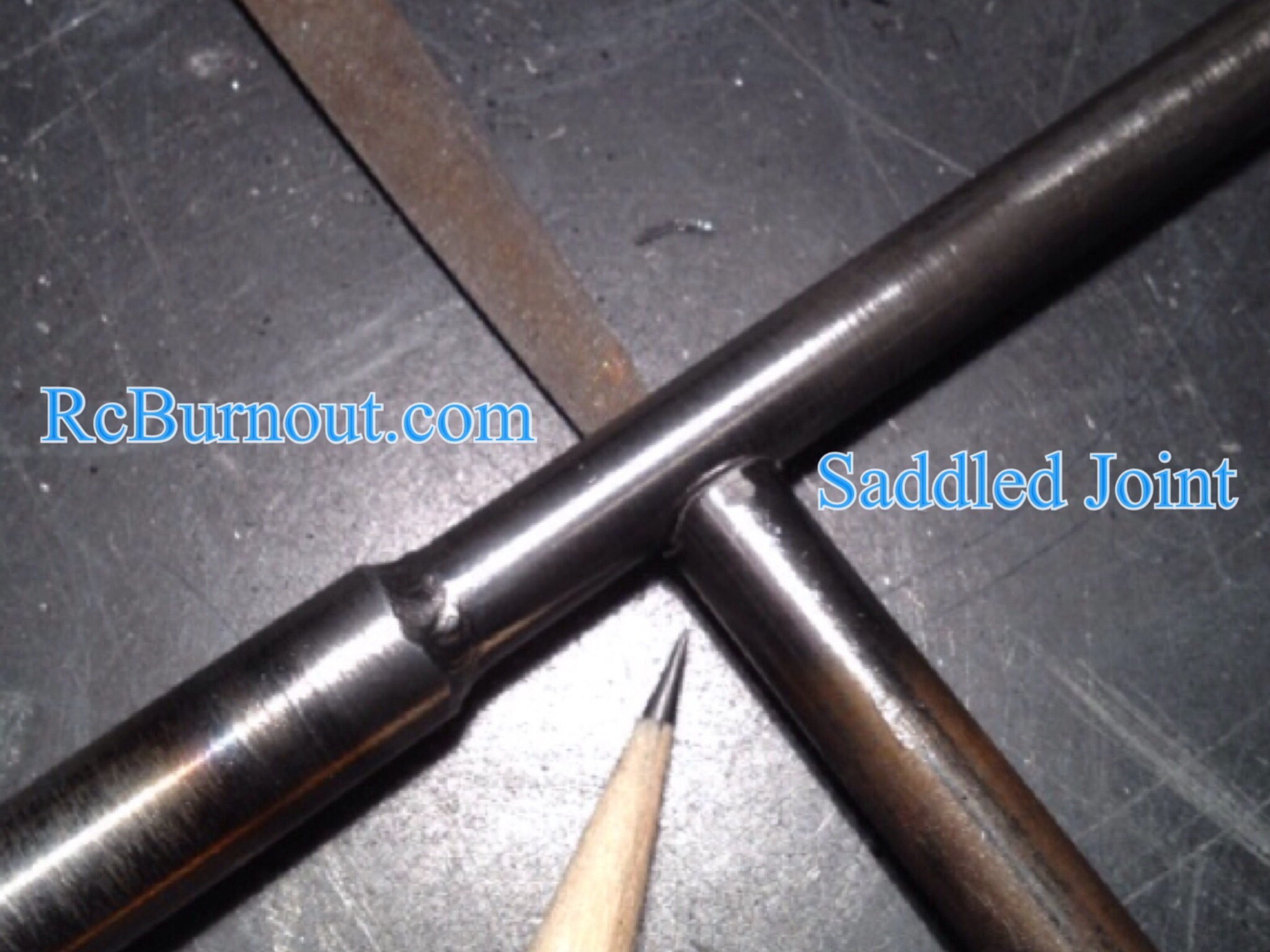

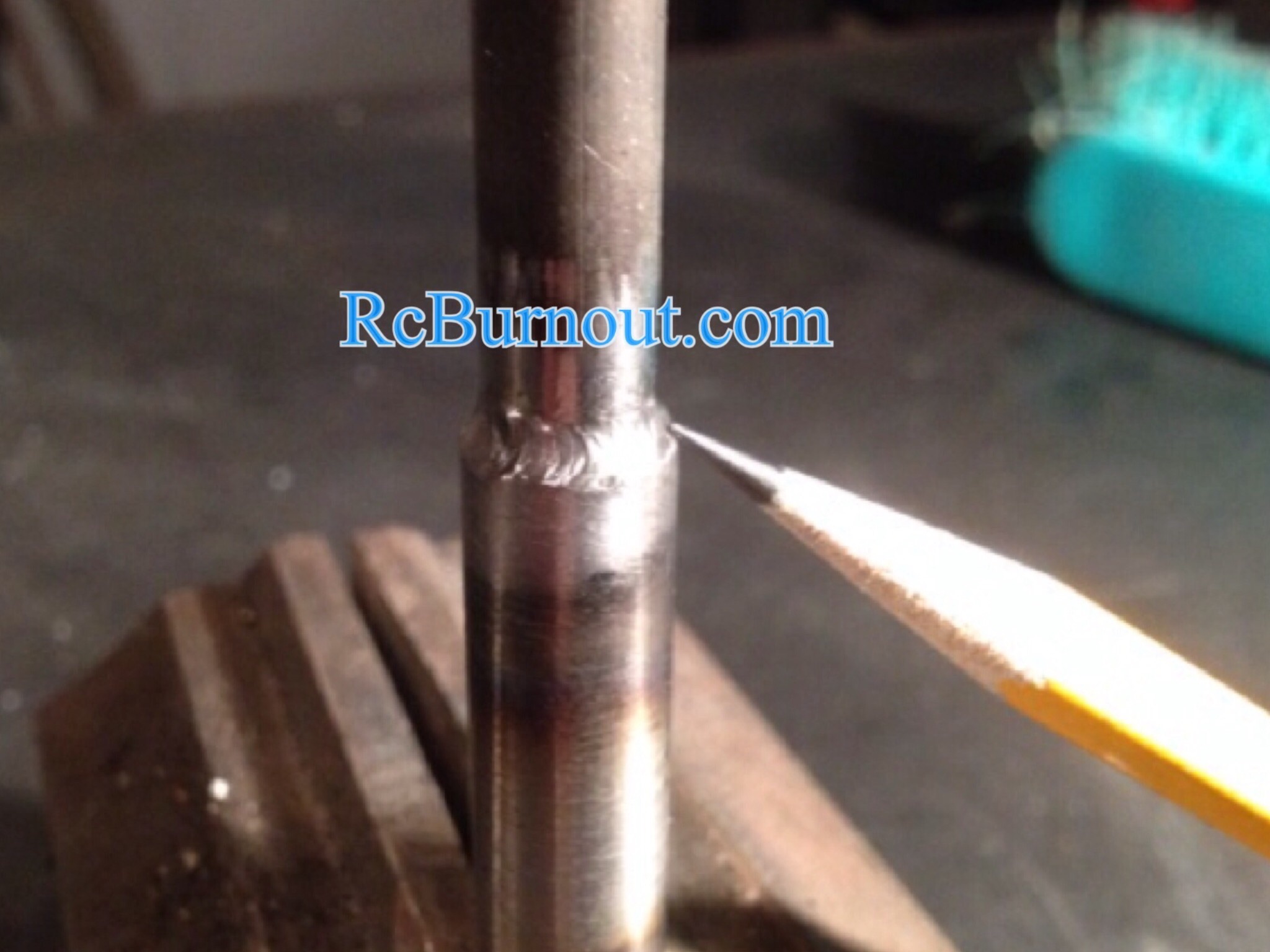

I hate to say this but tig welding small diameter chrome Molly tubing is not difficult at all. In fact it's pretty much the same as welding large diameter tube or pipe. The only difference is your weld setting. Your speed doesn't change or technique. As for these frames, yes you can mig them. And they will look like it to. But you can grind your welds in to glory. I highly recommend hard wire with a gas mix. For the weld inspector up there a couple of post ago. I wonder how you became a weld inspector as some of the requirements to become one requires at least 6000 hrs of documented welding so you should know your welding machines . Don't mess with your machine. Buy one that does the process you need it to do. And I highly recommend GTAW ON THESE FRAMES. DISCLAIMER. If your using silicon bronze as a filler metal your really not welding the 2 base metals togather. You are brazing them because the base metals are not being melted and consumed with the filler metal. If you use 70S2 as a filler metal both base metals are being melted (consumed) and the filler metal (70S2 ) is also being consumed to build strength . As for the weight of your project it will be no heavier or lighter then what..... I have no clue what that means. Just when you thought it was safe to check out QSL.
Re: RC frame welding and Repair 101
3/8 inch chrome Molly tubing using GTAW Weld process with 70S2 filler metal

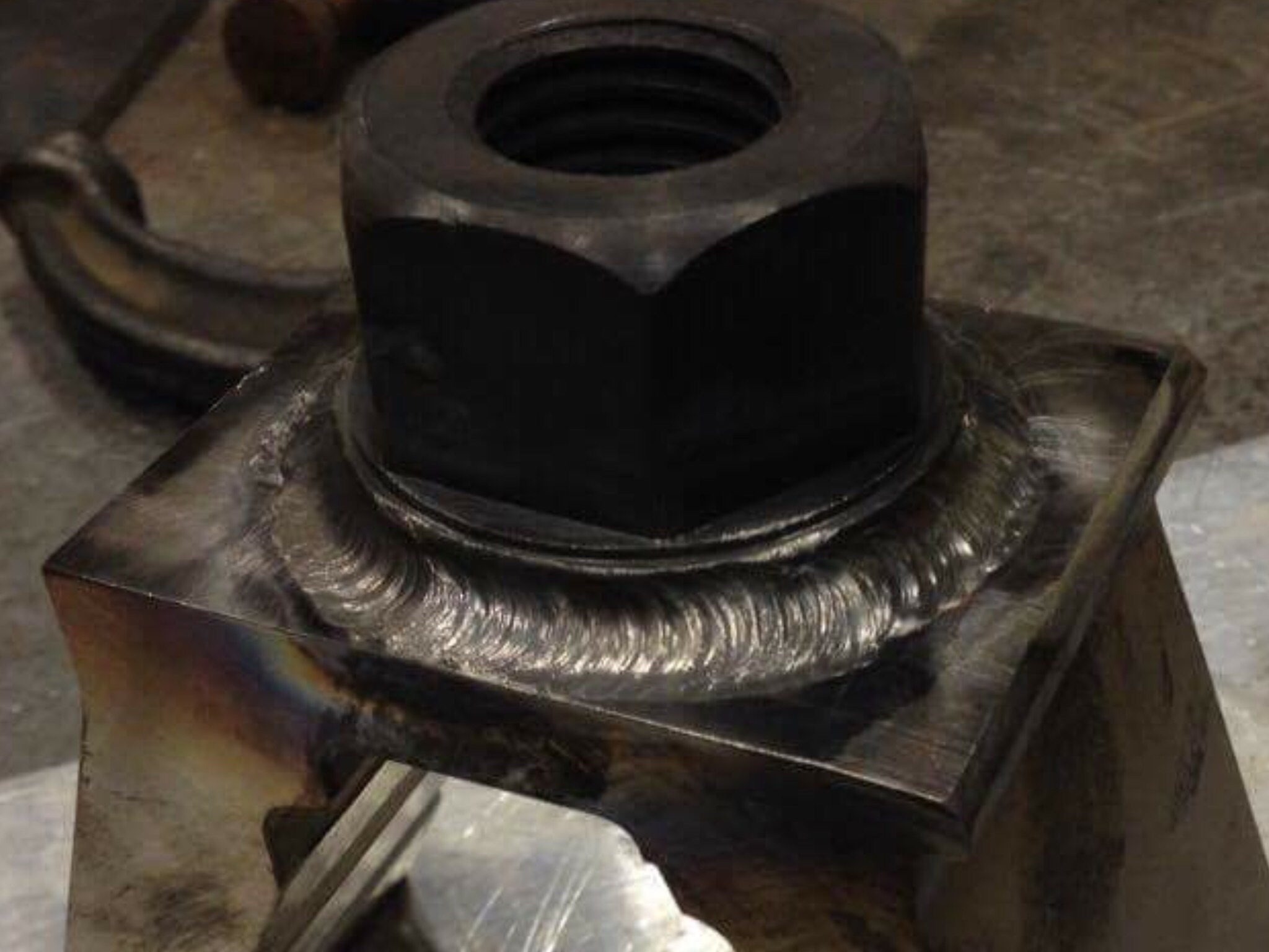

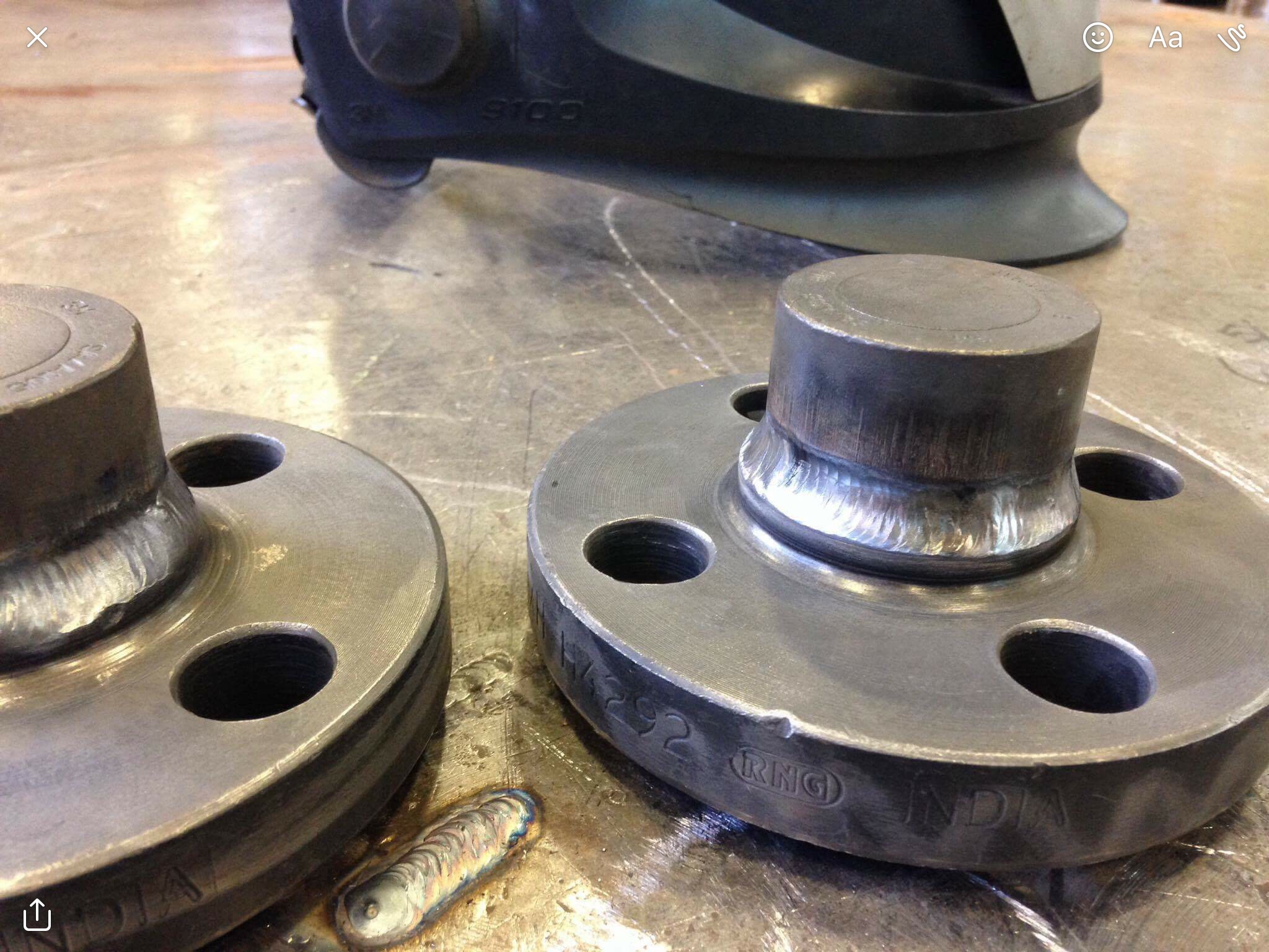

Some heavy pipe/tube. Same process. Different settings. Technique is the same
