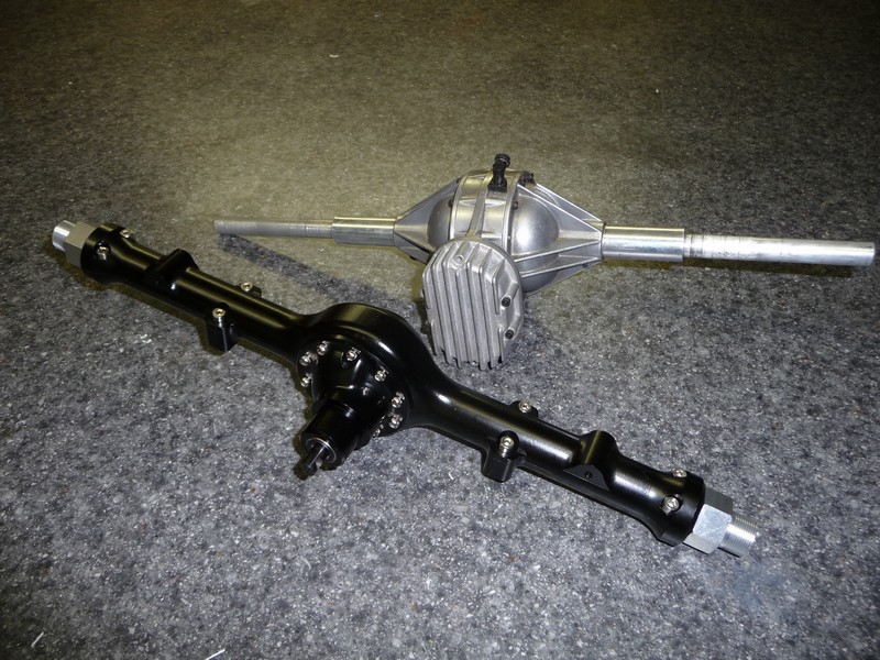

they came today and I have to say i am impressed. they will work for the project. However, they have diffs in them? I thought that was wierd, but Maybe i can make an external locker for them? Hmmmmm.

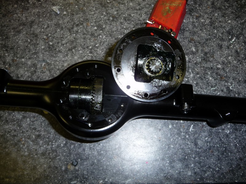

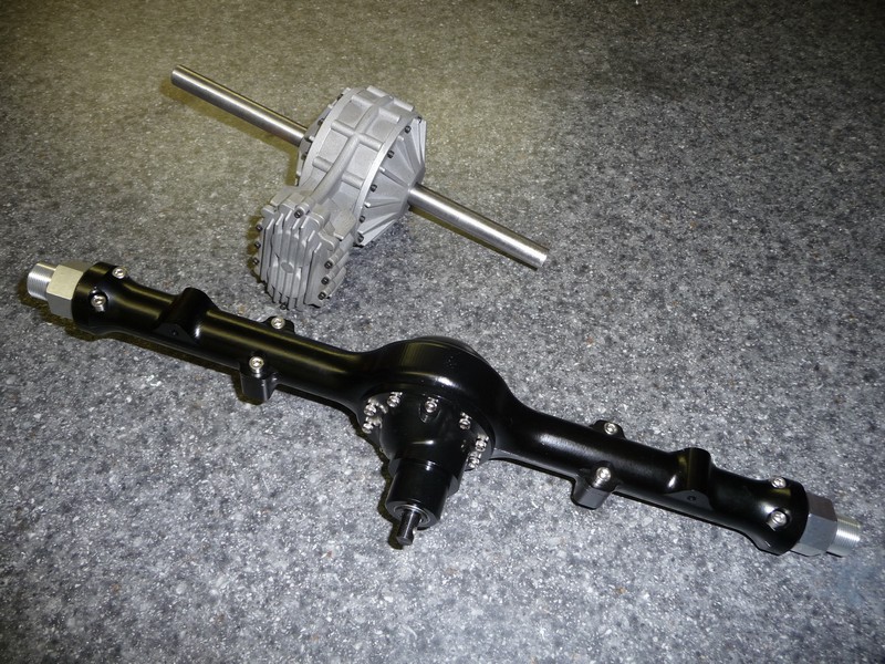

Another thing is that the axles inside seem really small. But tonight i will tear down and post pics close to a skellenger so people can see. The ring gear in this thing looks to be about 2" and the pumpkin is 2.75" The over all length is 15"

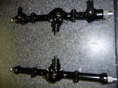

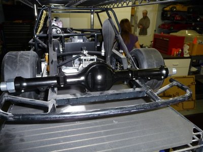

Here are some pictures for size comparison and also some of the inside. After taking a close look at these, I would say these would not hold up to hard use. The teeth on the gears are very small and there is not much contact surface. The axles inside are also very thin. I am sure however that these would work in a Onroad application or a rock crawler application which is what i am going to use them for. The size of the rear axle looks good scale wise for trucks and Grand nationals. Its actually a bit too wide for the conley cobra though.

True, BUT, RC4WD is really into Rock crawling. I think these were designed to build a 1/5 scale rock crawler. Not to be used in a trophy truck. I could be wrong. This is just my first impression from looking at them. But the gear contact is no better then a 1/8 scale car diff.

This diff is much smaller then the HPI baja. You never know though until you test. So far they are for sure worth the money. 300 bucks, you just cant go wrong. the quality seems very good!!!
