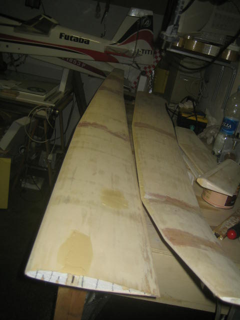

hello kennazzo:
to make a fiber body should make a mold.
could also be derived from the prototype you're doing.
I explain a little faster:
finished structure should caulk all the balsa and then sand with sandpaper, so you get to have a surface like a body.
done this, take the 80 grams of fiber glass rests on the plate and with the epoxy, it is best to do 4-5 layers so that stiffens everything.
the end of this again is stucco with metal putty and then sanded until you get to have a SUPERV polished and finished, ready to be painted.
in painting took place from there you get the mold.
I stop here for now, if you want to do after you'll be back!

to make a mold of that greatness does not come cheap!
But if you plan to do many hulls it's worth it.
a second for me to become expensive ...

At this point you can only and exclusively to the procedure that I told you before but with only 2 layers of fiber 80g.
remains robust and lightweight.
