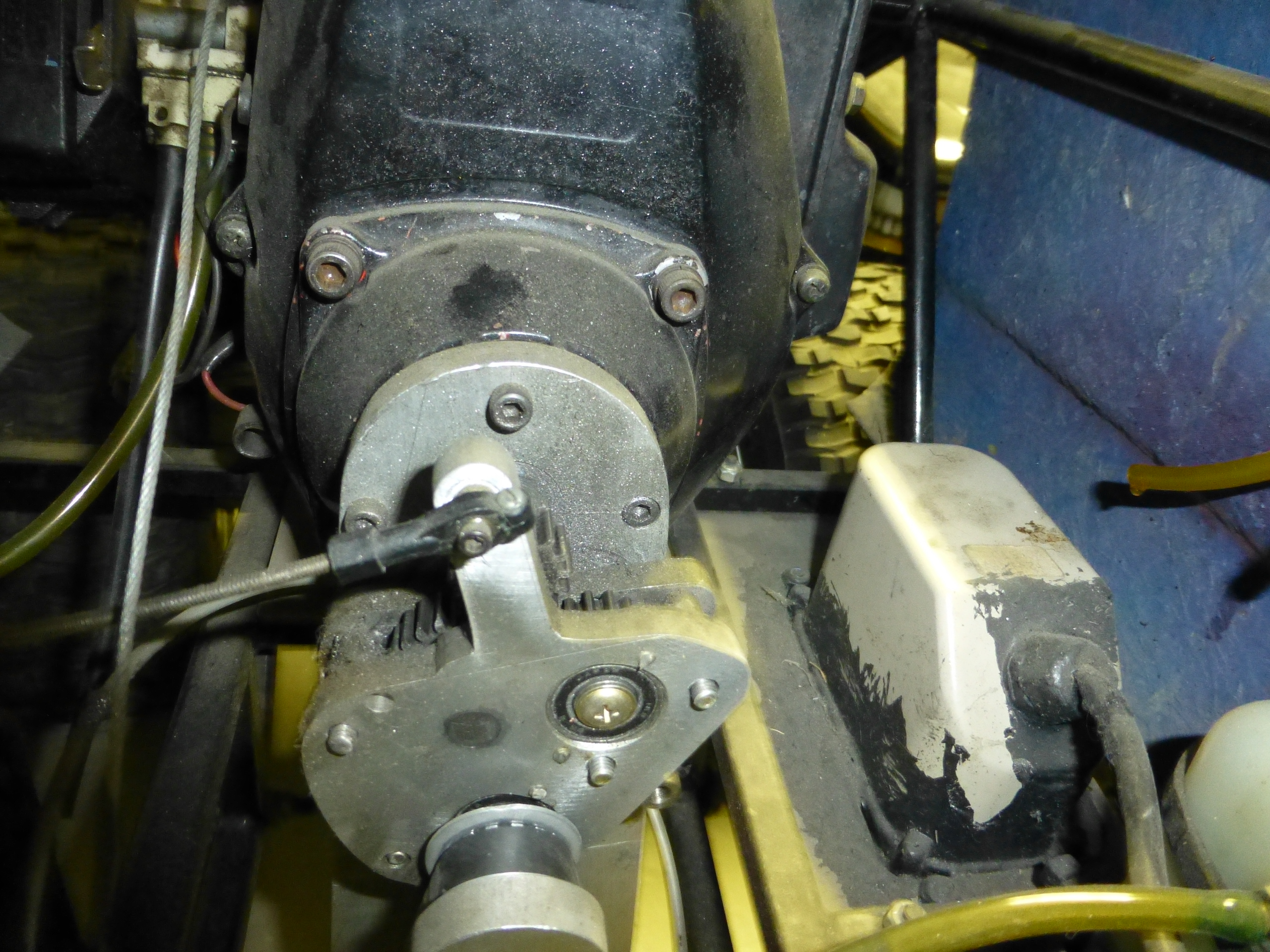

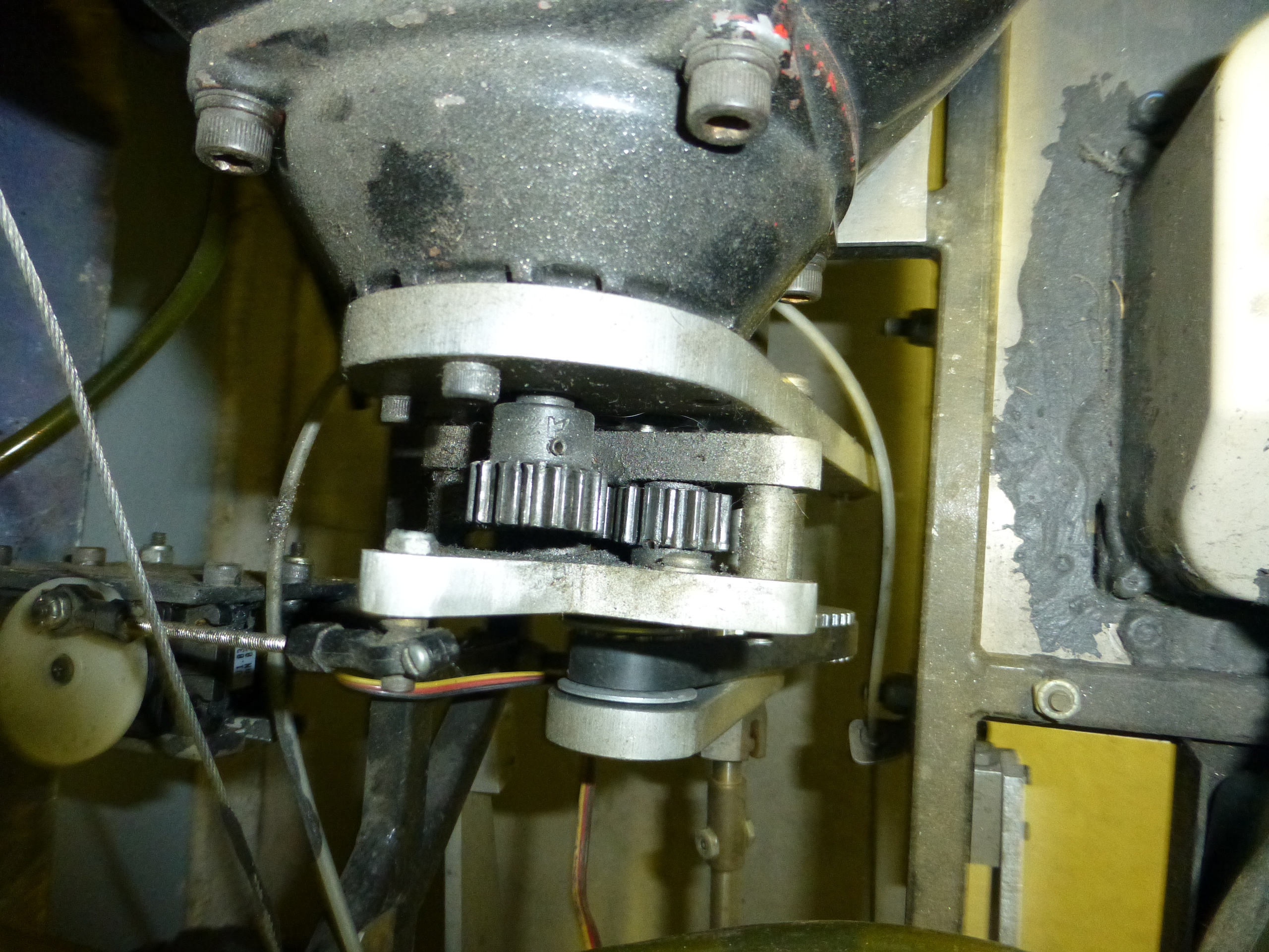

will try to remember to shoot a couple tonight. It is oem, but its the only truck Jeff built with a reverse unit. Pretty slick and easy to replicate.
Re: New Era Monster Truck
couple pics!

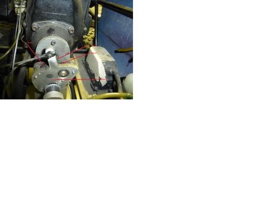

I think im missing something here, I see 4 gears from the pics. but I think one needs at least 5 gears to have reverse. please see my pic below. where is the 5th gear?
thanks
4 Gears. pinion and drive gear. Then there are two gears in the middle that are always in contact with each other. The arm simply selects which gear the pinion touches.
