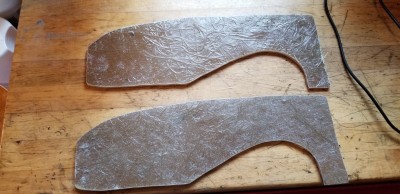

Thank you Mike, Cal and Kaye, I started the fiberglass on the wheel wells and came out very sturdy and I'm happy, I will fiberglass the back curved part of the well separately then join the pieces together. After, I will sand and shape them nicely ready for the under hood fit. I wonder where all the Daytona bodies are and what became of them ? Hope you enjoy

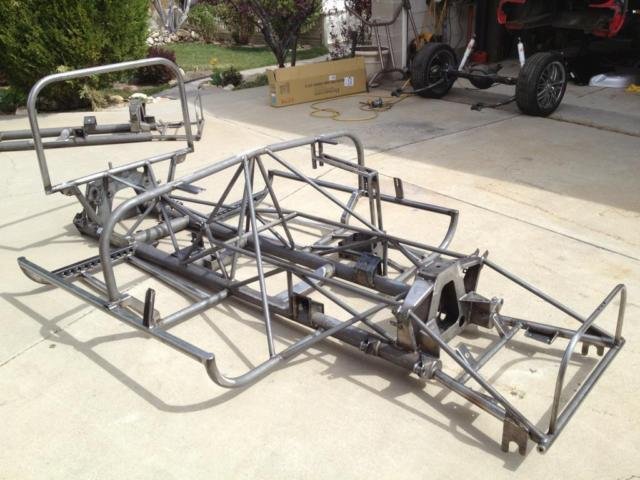

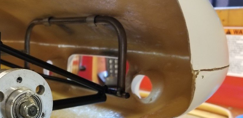

Okay, my inevitable setback. I wanted very much to do the same hood hing setup as Jeff Schmidt design but knew that with the wide tires I have will only give the car 1/4" turning radius left and right, but told myself do it anyway and down the road I could get thinner wheels and tires and lengthen the axle...so on to plane B which will be no inner wheel wells but a bar like the one in the photo of the real chassis. It will still have a hing but I wanted very much to be like Jeff Schmidt. Oh well.

Mike if no hassle can you please post a photo of the underside of the nose, it seems that a portion needs to be cut away to clear bars and tires when opening the hood? I dont want to cut and regret. Thanks Mike.

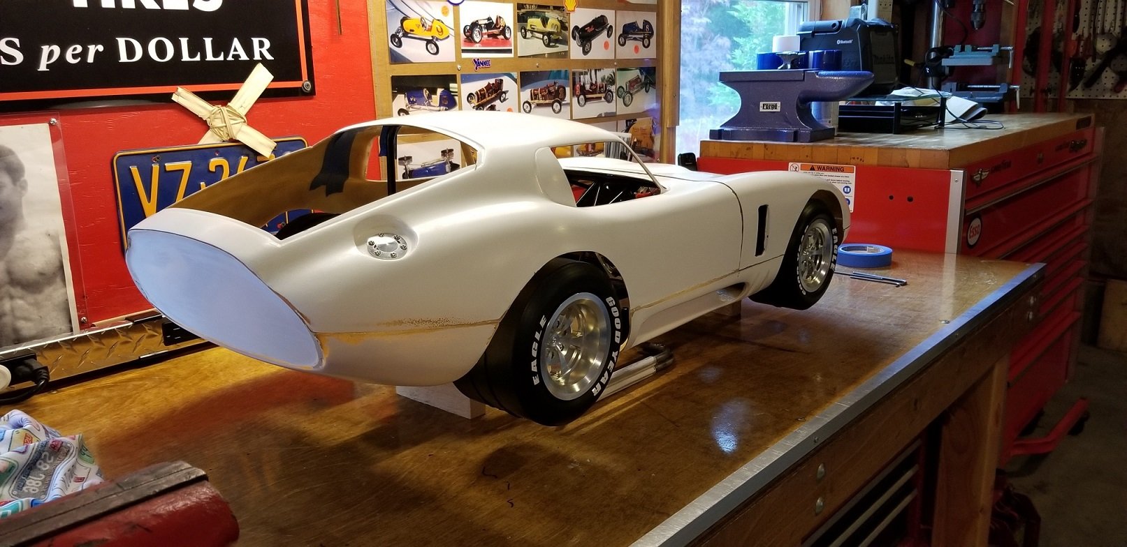

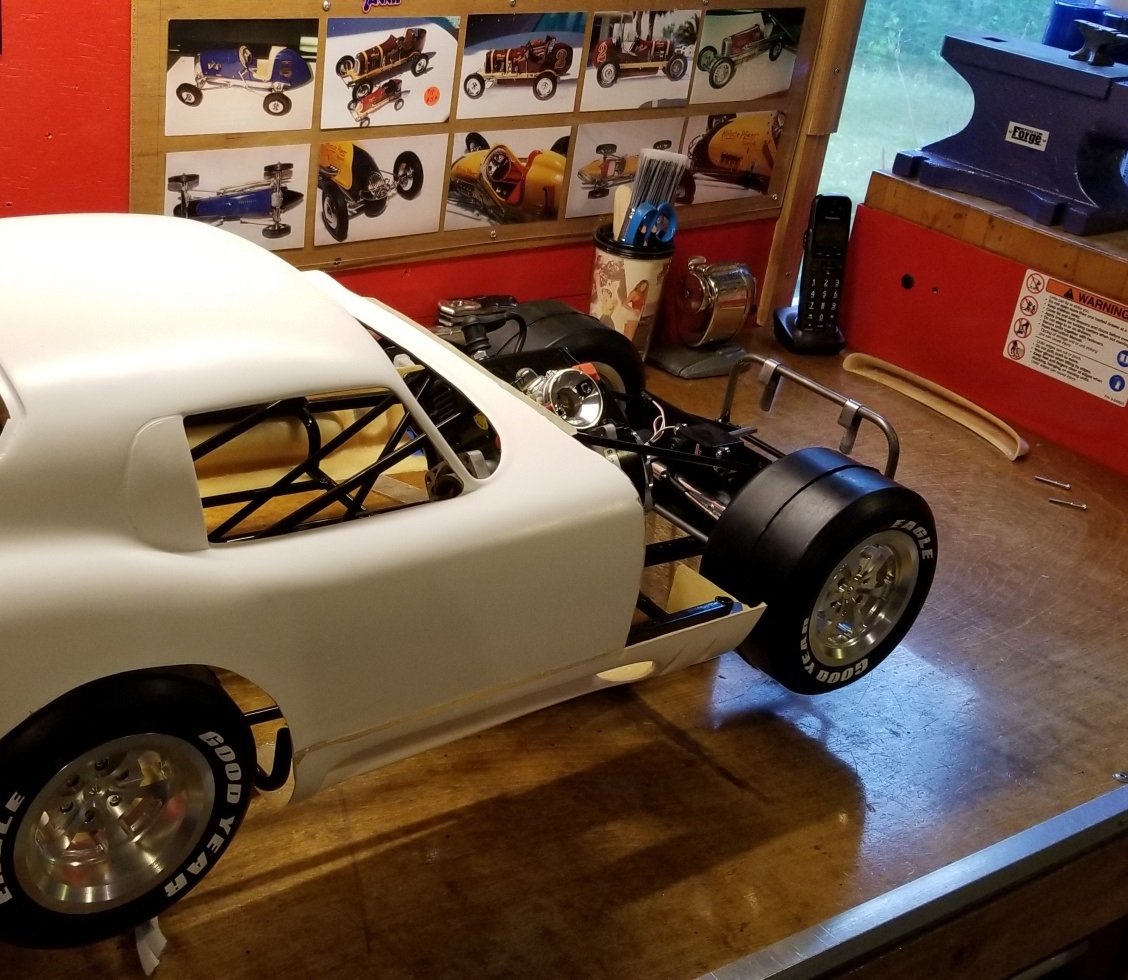

Okay, made the hood bar, made a simple hood hinge fiber glassed to the body which is very effective and will allow the hood to open anywhere between 20 and 90%. The hood aligns perfect with the rest of the body, just need to sand the rough fiber glass spots and paint a matte textured flat black under the hood then clean and paint the hood bar. At the moment need to determine if I have to trim under the nose to clear the bars and tires, no rush though. Hope you enjoy

Thanks Kaye, no matter what hinge type on this 1/4 scale, it needs a hinge to secure it to the body, unfortunately with my tires I would have to sacrifice a good chunk of the under nose altering the beauty of the nose when viewed at the profile. The hood bar and hinge I have is very solid if I were to run this car plus I'm going to have lower side fasteners. I'll keep the hood propped up in front to display the engine and keep the hood intact. Anyway, onto prepping the body for the paint theme then it's off to Daytona, Sebring, and Europe to win the FIA sports-car titles

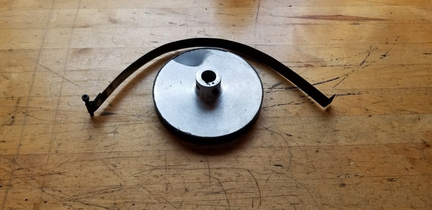

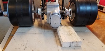

Hey folks, was going to use the original brake system that comes with the QRS rear that's used in the pacesetter sprint cars (shown in photo) and would have to fabricate brackets and linkage to make it work, so to put this much effort I chose to go hydraulic as I already have everything for the right side and missing only the caliper for the left side which will be here this week from Germany. I made the caliper adapter brackets and need to position and weld, also need to make a new QC rear mount to match the angle of the clutch bell, Going to strip the paint off the chassis and repaint. Well, hope you enjoy

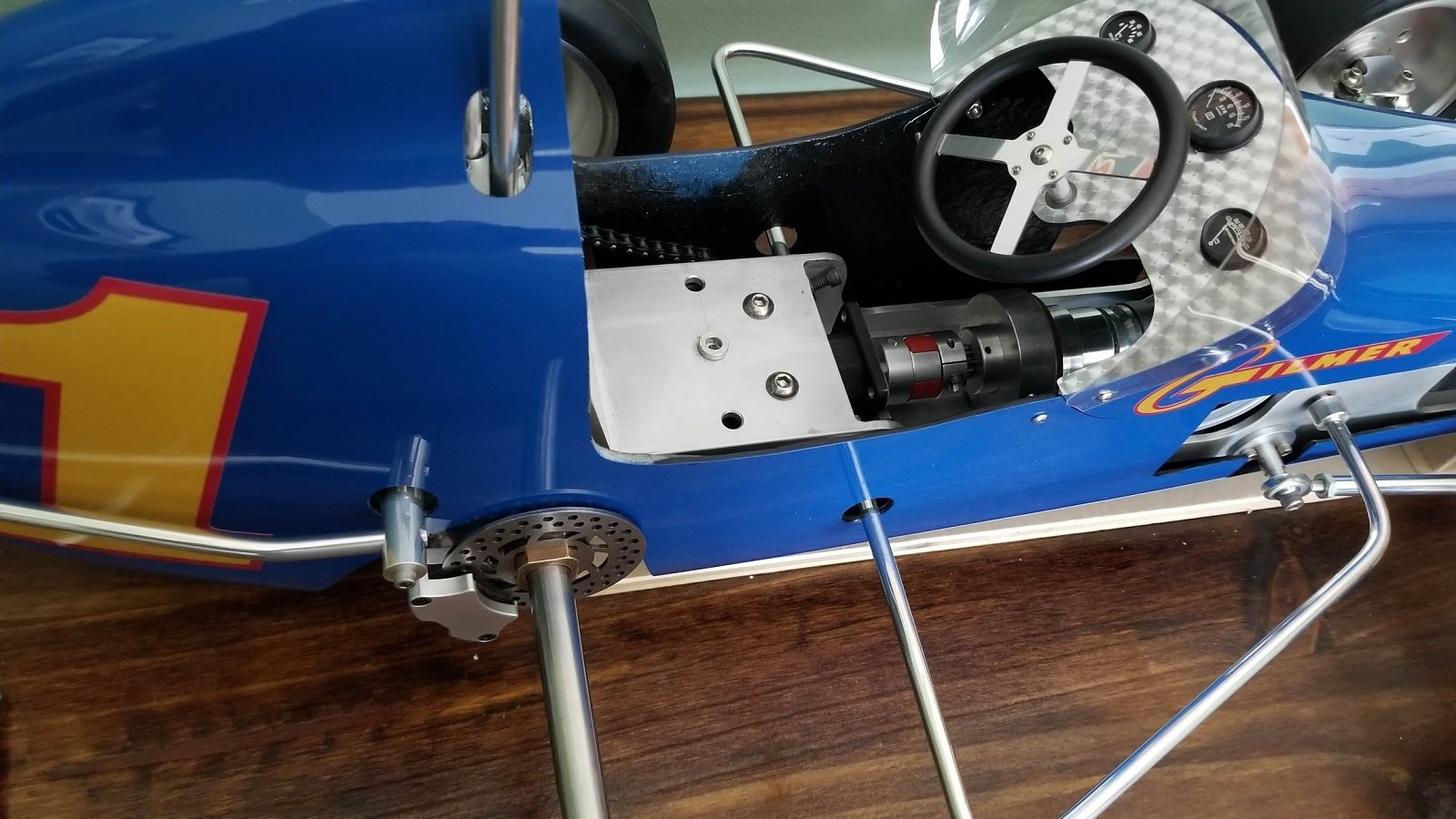

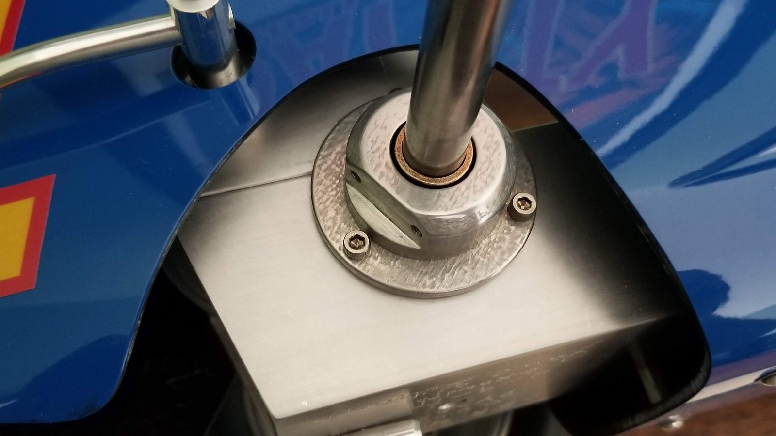

Lovedr here's the link, https://www.ebay.com/itm/Mecatech-Brems ... 2749.l2649 I'm a returning customer. fair warning, these are not cheap and 30.00 shipping to boot. You'll also need some sort of adapter to hold the caliper, bearing and rotor. As shown in the photos. I have these on my Gilmer also. One more thing, if you buy from this ebay seller, part of the caliper comes anodized red, the caliper comes apart easy and use EZoff oven cleaner to remove the red in minutes. Just let it soak a few and wash.

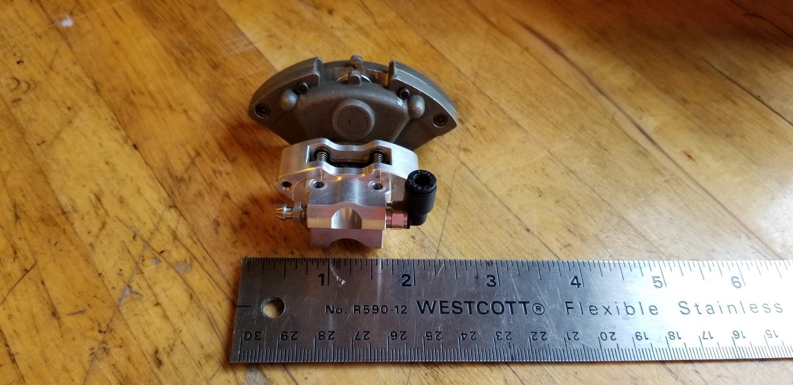

Np lovedr, It does not come with a rotor but here's a link https://rc-car-online.de/de/products/fg ... asert.html to the one I have, I don't know how it compares to 1/4 or 1/5 scale but I believe all these parts are for 1/5 scale, I think they will do just fine on 1/4 scale cars, monster trucks are a different story. John Forster's calipers and rotors are significantly bigger. Here's a comparison photo. It really comes down to what works for you.
