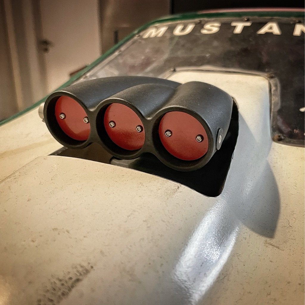

Scoop second try. 10mm lower and much better. Nearly finished the car

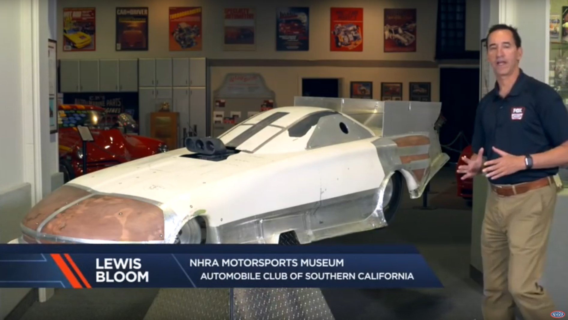

Amazing...whish I could visit the museum one day.
https://www.youtube.com/watch?v=IGkatE3zvmk

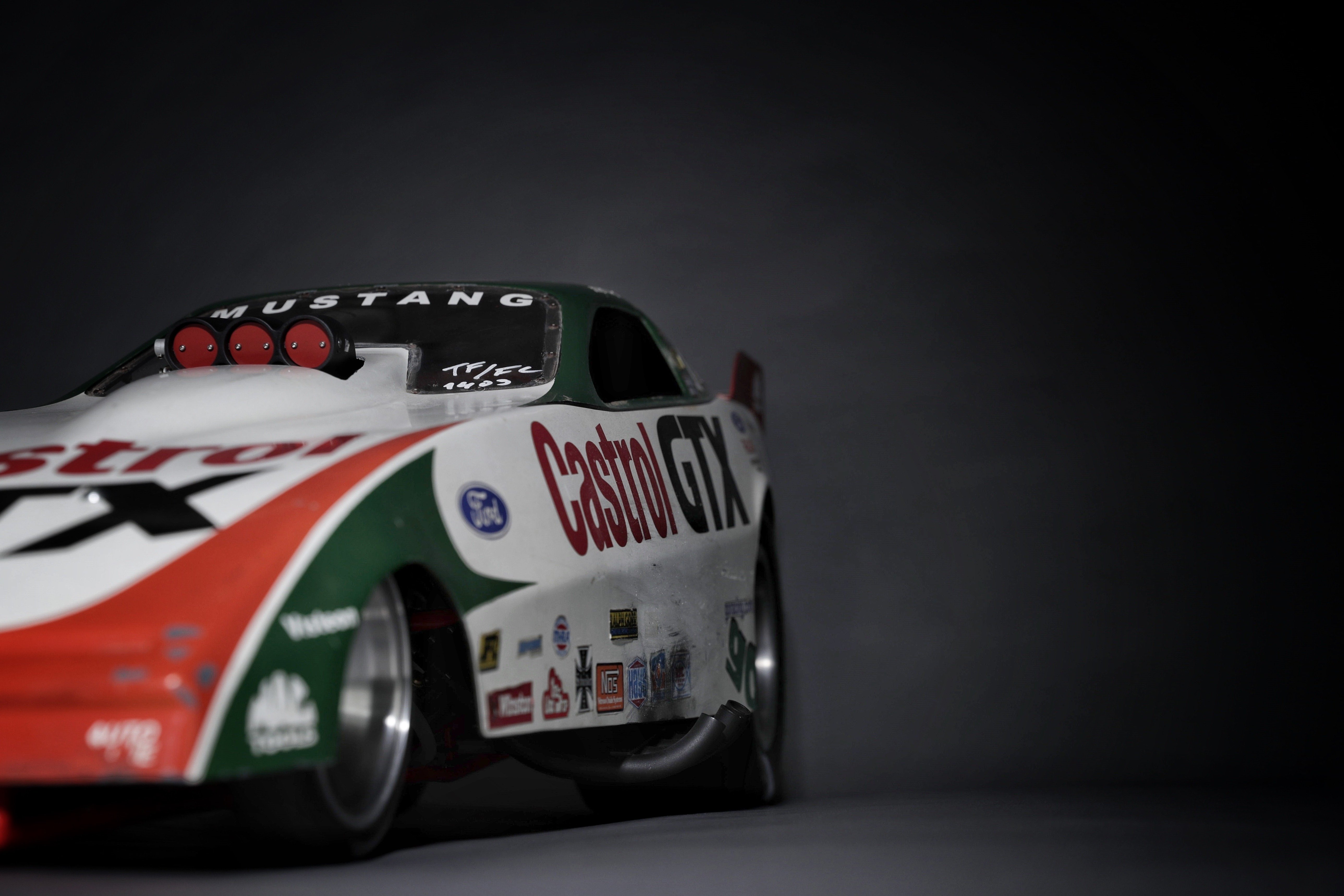

I take pictures
Photographic pictures
More soon in the legends section.

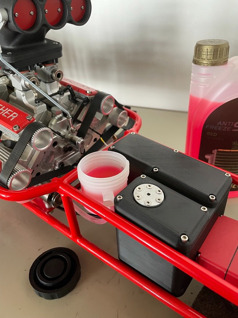

Today I filled the system with coolant. Everything is tight and the pump runs well.

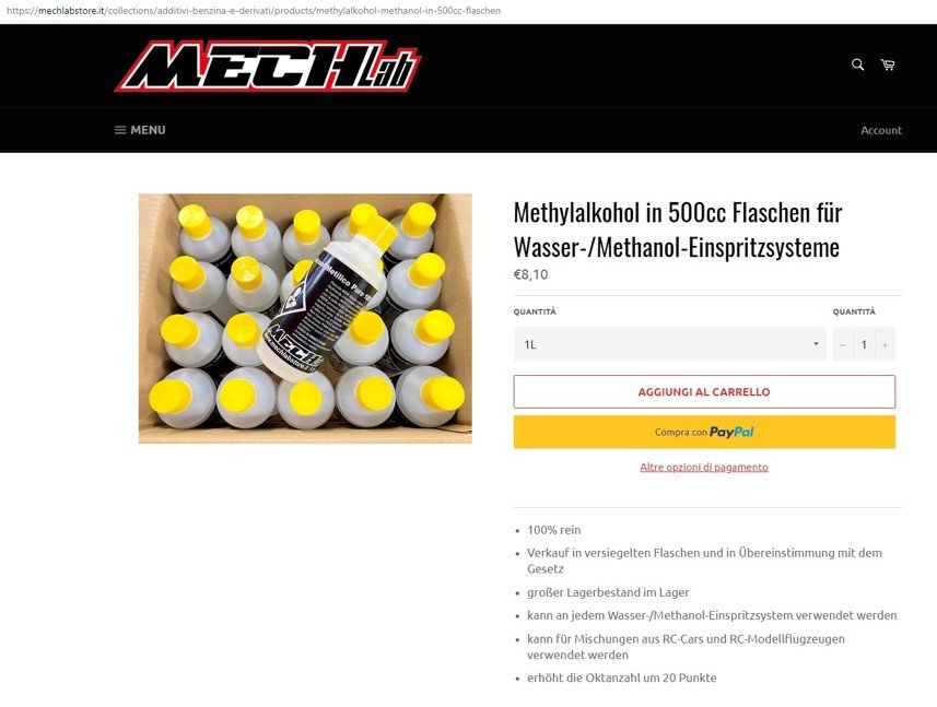

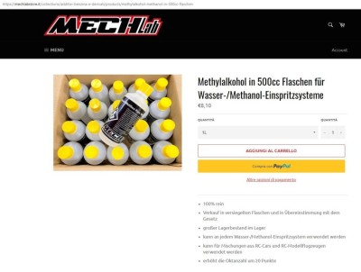

Just ordered Methanol in Italy. No way to get it in Germany anymore...
