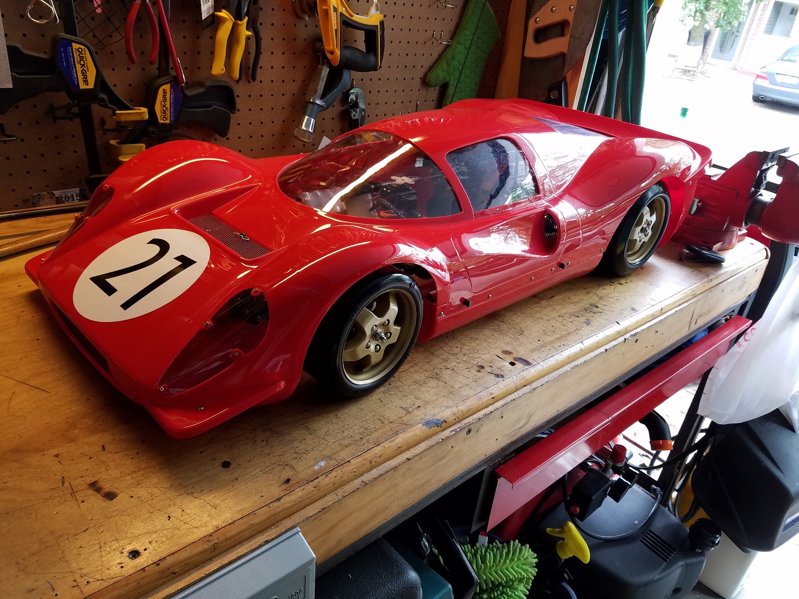

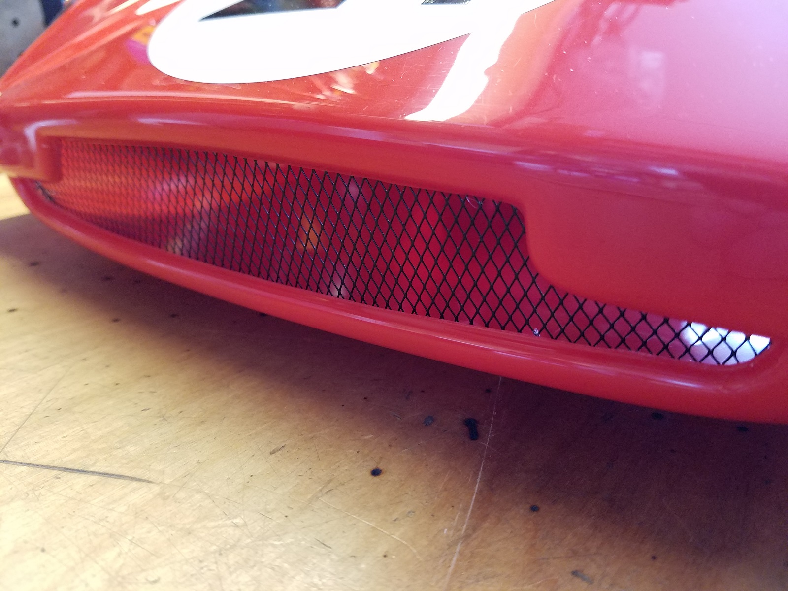

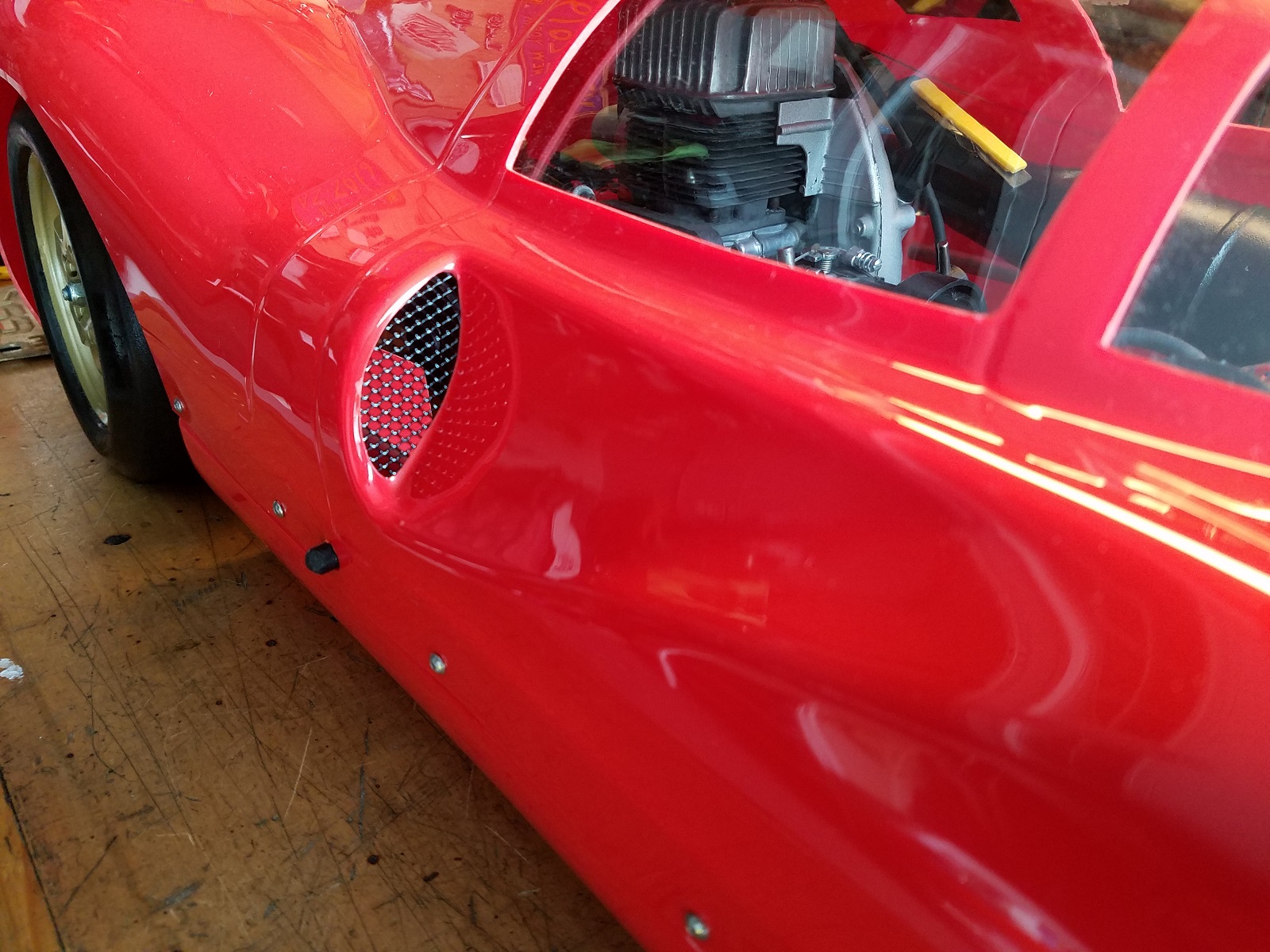

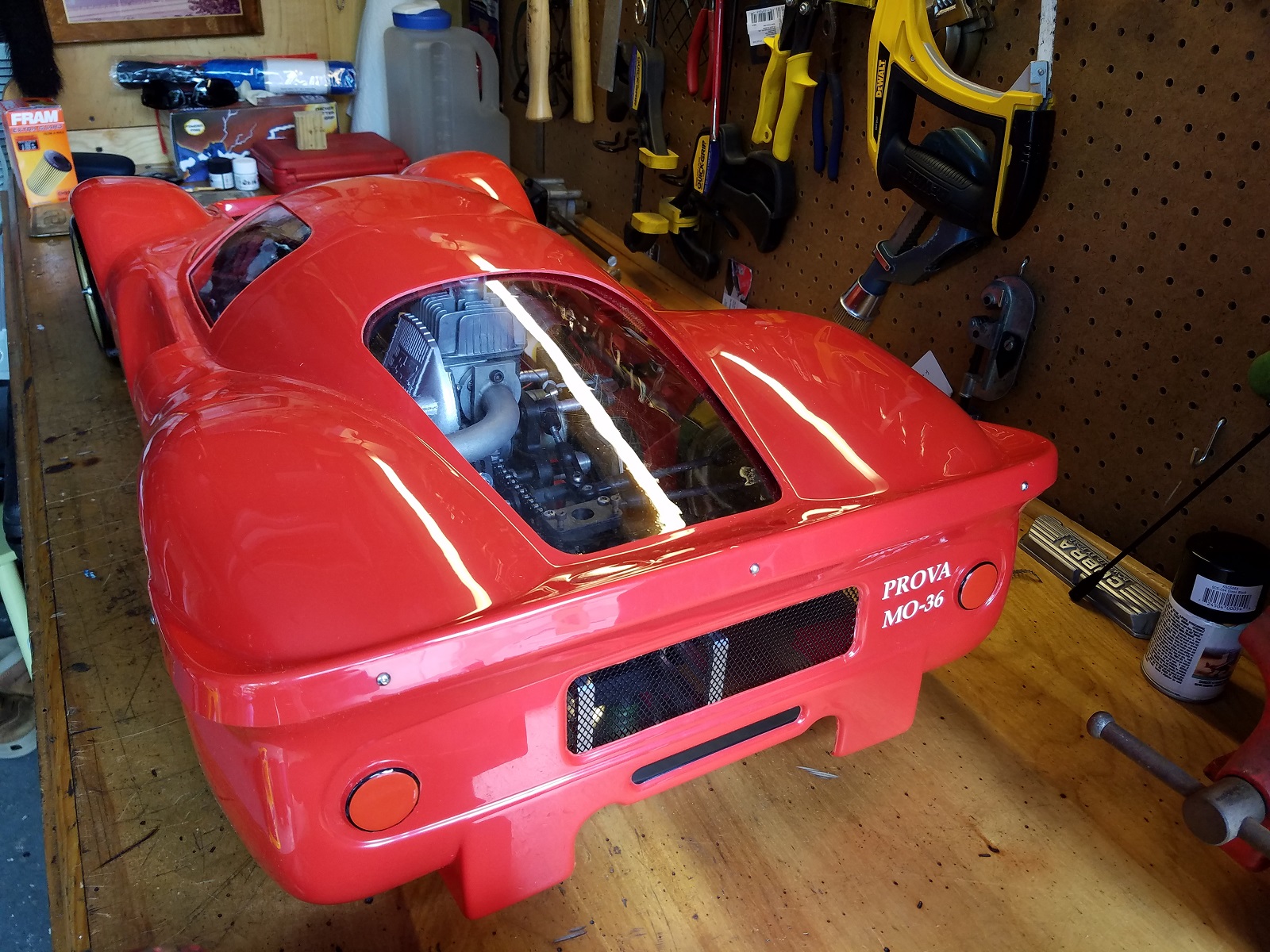

Very nice project you have. The Yankee P4 330 is an outstanding machine, I just finished up mine not long ago. These bodies are screaming for the tiny little details that make a big difference in appearance, this is purely my opinion. Here are some photos of mine and hope they can spark ideas if you need any.
Re: My very first Yankee RC Model !
Good detail work Emilio, particularly on the headlight covers.
Thank you Kaye :)

Emilio wrote:Very nice project you have. The Yankee P4 330 is an outstanding machine, I just finished up mine not long ago. These bodies are screaming for the tiny little details that make a big difference in appearance, this is purely my opinion. Here are some photos of mine and hope they can spark ideas if you need any.
Very nice one! I'm currently thinking about my new body rendering, I will add a lot of little details.
I currently have a mesh at the front air inlet, but not at other opening.
Do you own a 3304P with an ABS body: red external body and an internal transparent body for windows, mine is in Polycarbonate manufactured in one-shot: Lighter but not easy to decorate!
