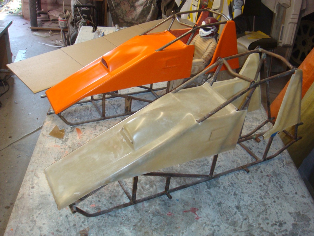

hi bentley,bentley marshall wrote:sweet mike will be keen to see pics of ya sprints ..mad62 wrote:hi guys,
mike here,just thought i would let you guys know im building two 1/4 scale sprint cars at the moment also,im down in christchurch,will get a few pics at some stage,have a few guys here interested so should get some racing happening,
cheers mike
there is a guy in rotorua has a few sprints and a guy in auckland used to have one not sure if he still has or not
bryan from rc innovations is keen to build or buy one too
i have 2 spare sprint bonnets if any one needs one or use for a mould
heres a link to my sprint http://www.quarterscalelegends.com/bb/v ... f=9&t=2290

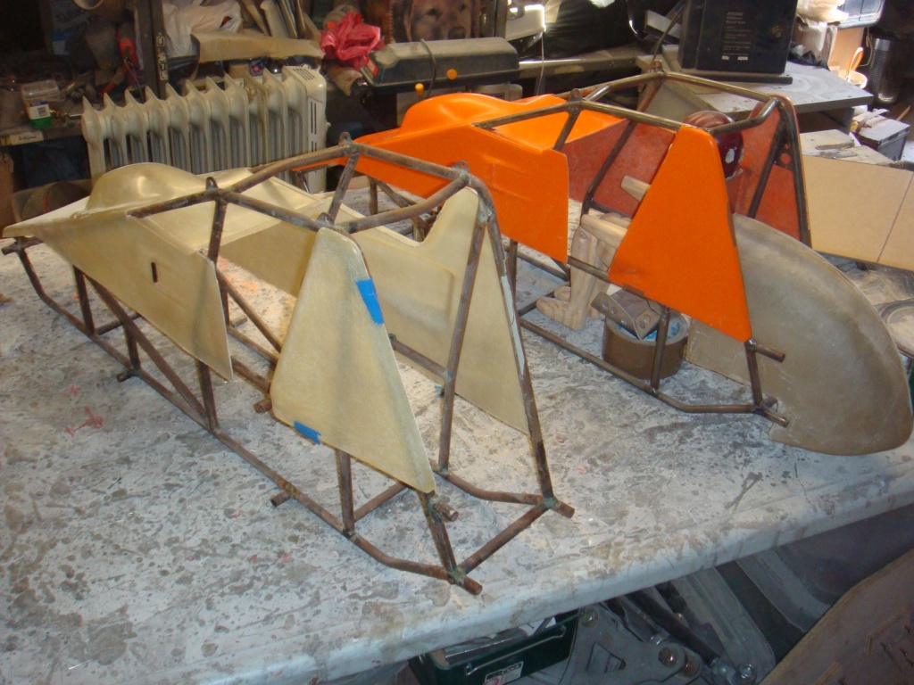

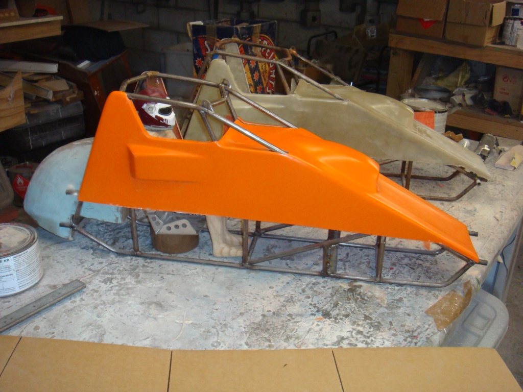

heres a few pics of the two sprint cars im building,going to run 29cc engines ,grinder head drive and chain setup,like my mates are running in aussie,looked at belt drive but not that good for on the dirt,as my mates in aussie have found,i made plugs and molds for the body cowls,just have to finish the tank mold and start my wings,etc
cheers mike

they look sweet mike

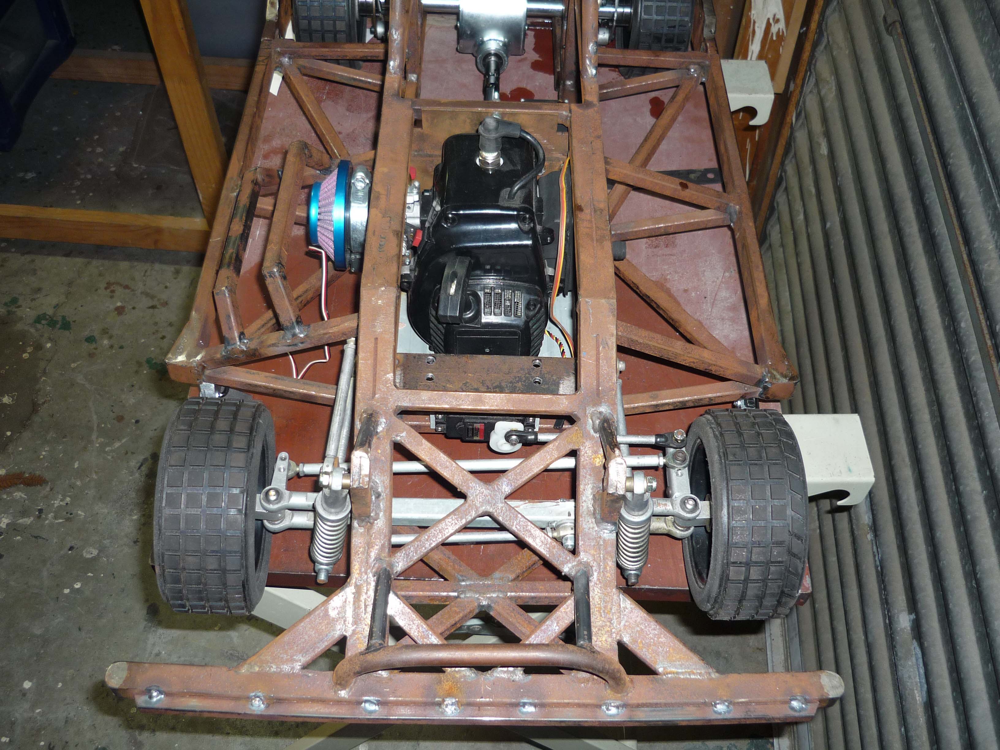

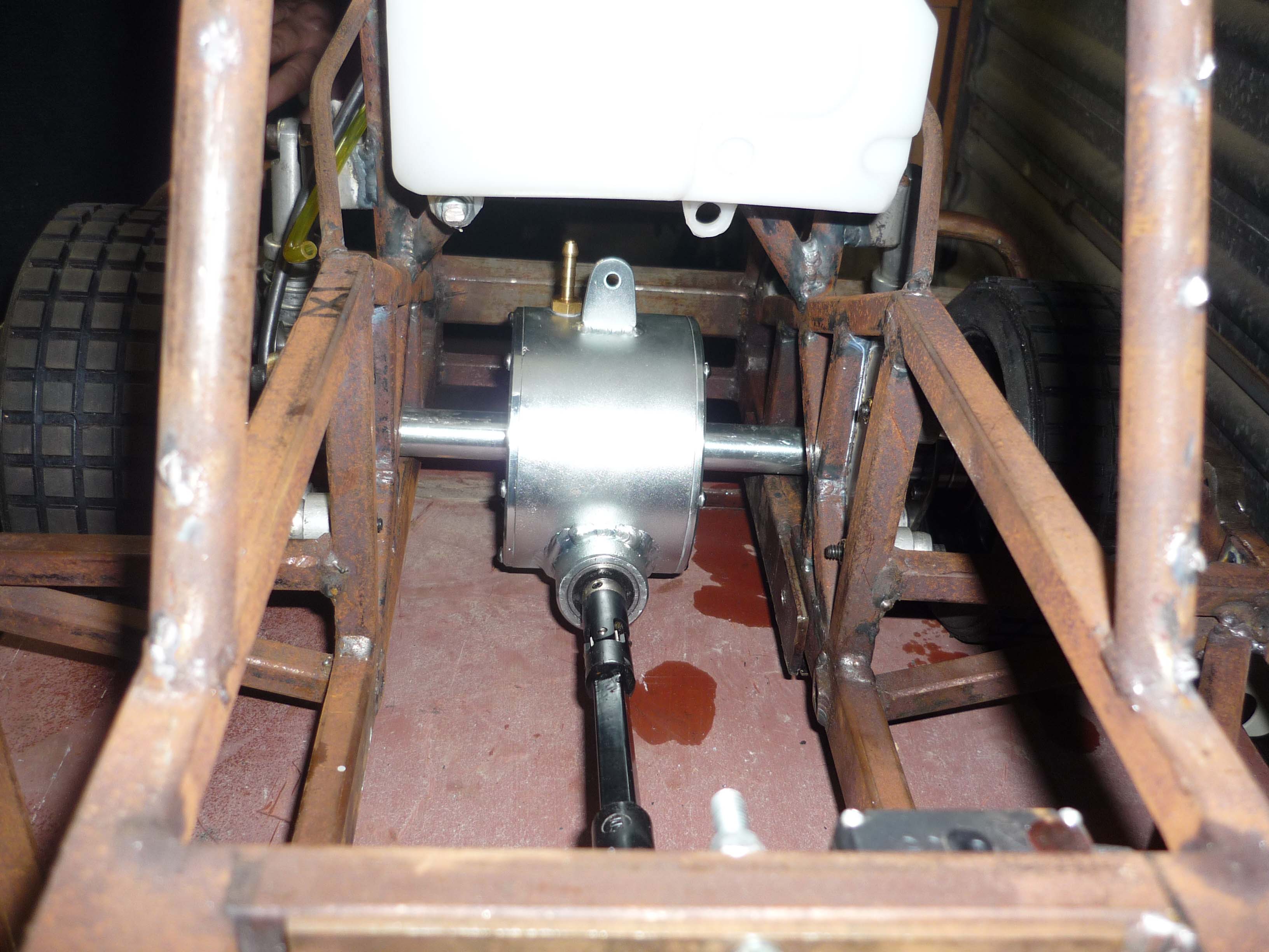

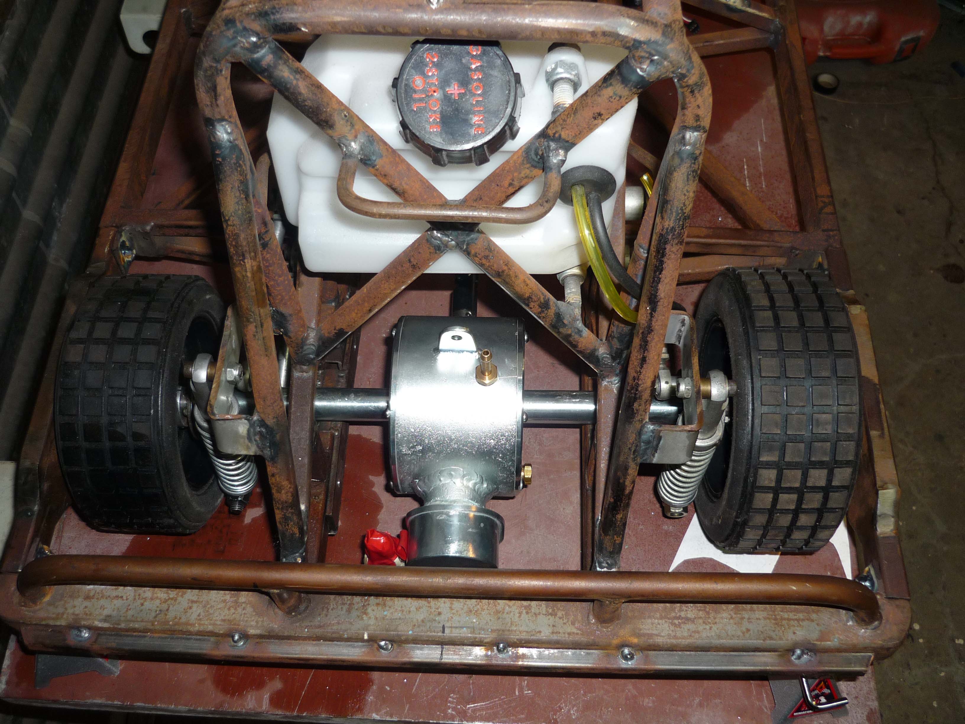

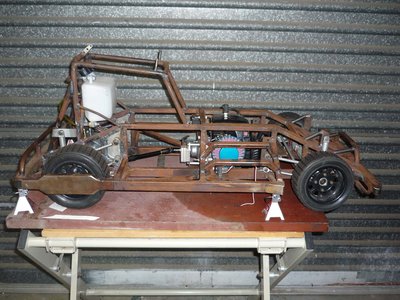

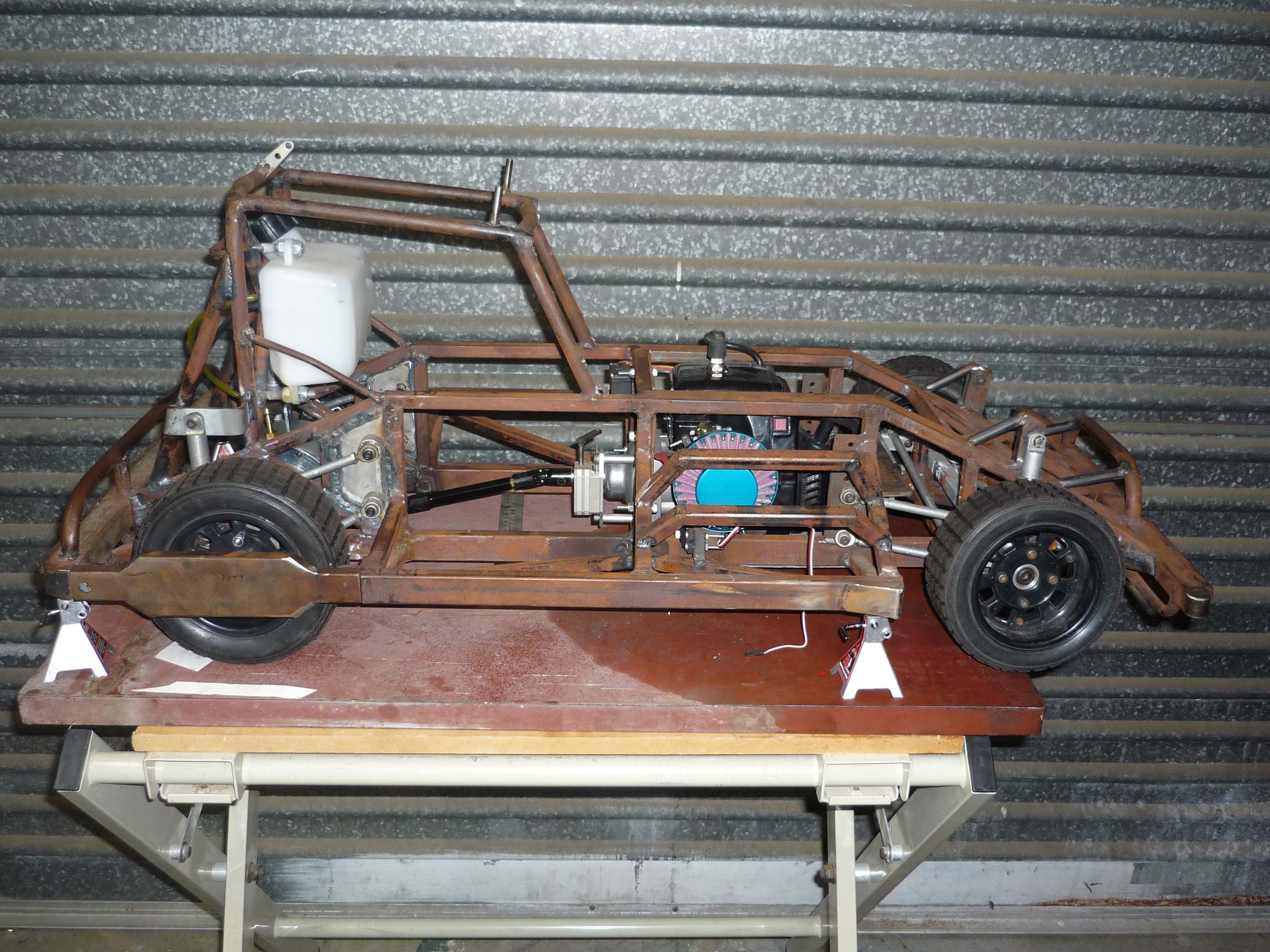

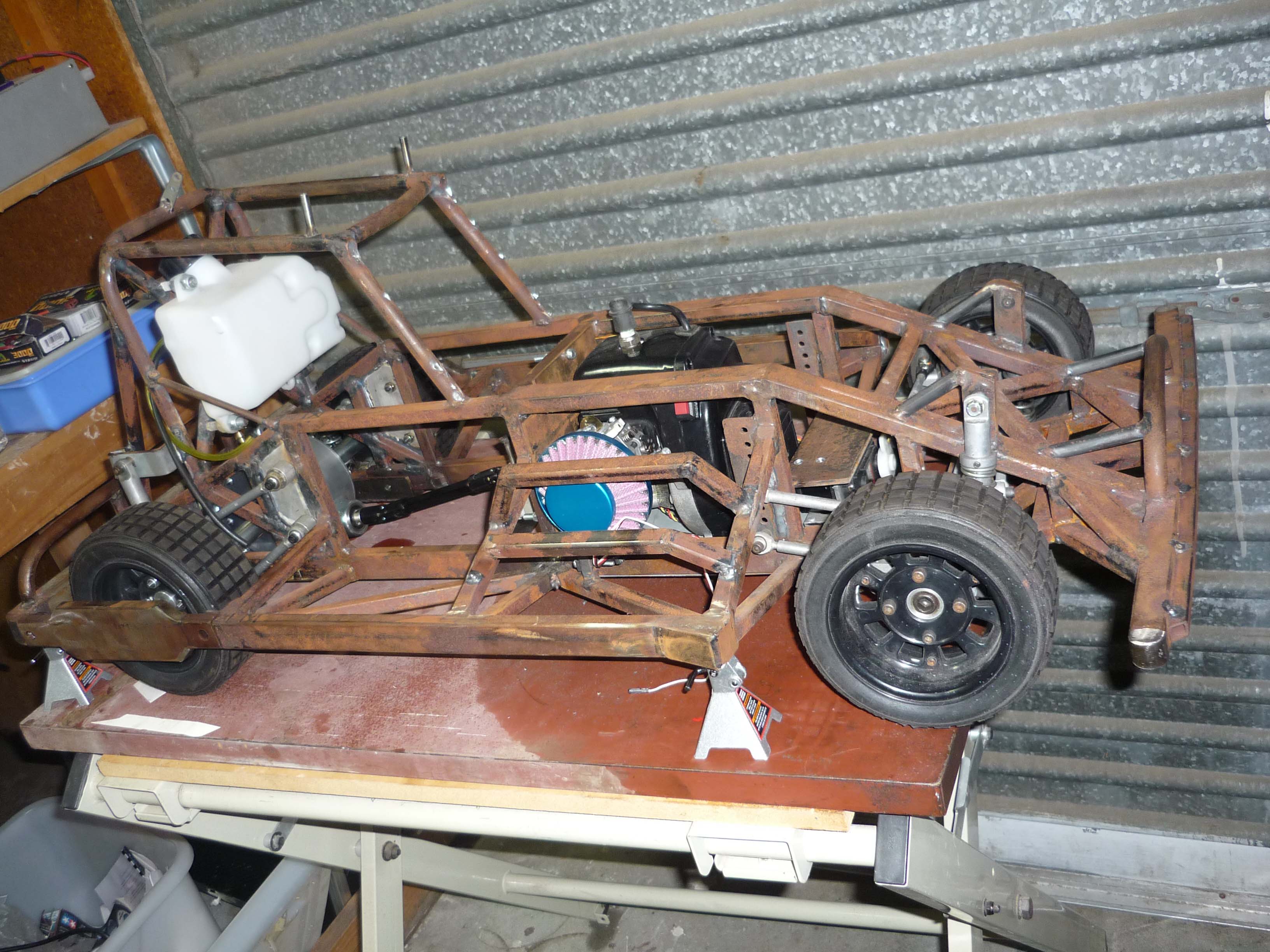

Hey Mike they look great - you are a master with the fibreglass for sure..Ive attached some pics of my project. Its taken alongtime to get to here! Getting close to finishing..Need to hook up fuel lines, sort out throttle/brake linkages and some form of fail safe device. To scared to put it on the scales but it must weigh close to 30kgs...Waiting on body to be done and then sandblast and paint....Gasman/Mike if you have a scale drawing of the sprintcar my mate Bruce Clarke has decided he now wants to build one! Can you email me something?
Cheers all..
Dwayne
Cheers all..
Dwayne

that looks sweet dwayne ...30kgs ouch what a fatty lol
for a fail safe i run this http://www.rcinnovations.co.nz/shop2-2/ ... cts_id=349
they are a must have in anything gas powered ..you will need a 3 chanel radio tho
it will kill the engine if any thing gos wrong with the radio or loss of battery power allso you can kill the engine using the 3rd chanel butten if you get a jamed servo or some thing like that

Re: 1/4 Scale Diff Build
dwayne,
Your detail work is great!! The ends of the tubes caped and the welds are nicely finished.
I like the covers you made for the rear wheels. The guard over the air filter is another nice touch.
This looks like something out of Mad Max.
Nice work!
Nice work!
