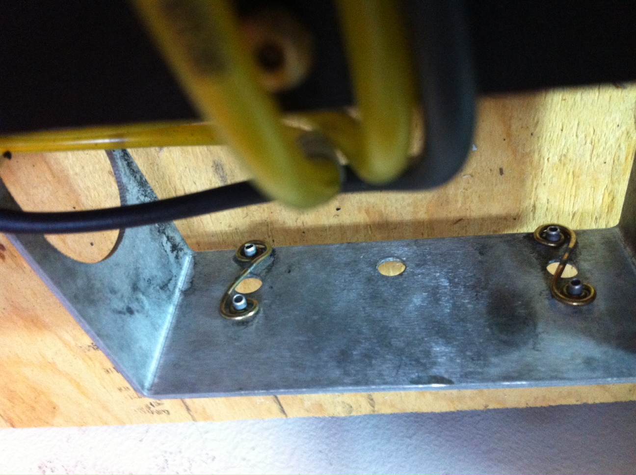

Hello:
can someone please tell me what these body mounts are called and where I can get them. any and all help will be greatly appreciated,
thanks
thanks

Yes these are Called Quarter Turn Fastners and can be purchased at S&W Racecars at there website. The buttons come in different lenghts for different reaches. Hope this Helps

or dzus fasteners. spruce aircraft has them

thank you guys for all the help! a187lbird, the way they are mounted in the hole/body is by having 2 different diameter thickness(see 2nd pic) so I don't think you can take them out without damaging the fastener and/or the body. I'm guessing there is a special way to mounting them that creates the outer thicker diameter and therefore the fastener ends up fixed to the body. if my assumption is wrong, someone please clarify.

Lovedr, The button fastner that goes in the body is usually made to be a snug fit but over time the hole dia. wears itself and the button fastner becomes loose on the hole.In most cases(ie Drag Racing) we just pull the Buttons out and relpace back when done doing any type of underbody chassis work. I hope this helps to answering your Question.

BlownDragFreak, I really appreciate your help! Im not talking about the hole in the body, I'm talking about the fastener itself. if you were to look closely on the 2nd pic, you can see that I couldn't pull out the fastener without either breaking the body or the fastener. the part of the fastener that mounts to the spring has(I guess over time) stretched and became bigger therefore holding itself in the body.

.I see what you are refering to now,from the looks the ears on the button have spread themselves open wider(sometimes due to over tightening and twisting to hard over time).You should be able to pinch the button ears closed in but you may want to get some new ones so when they are twisted in the locked position they will be a nice and tight fit.

You can also find them on ebay. They are Dzus fasteners.
