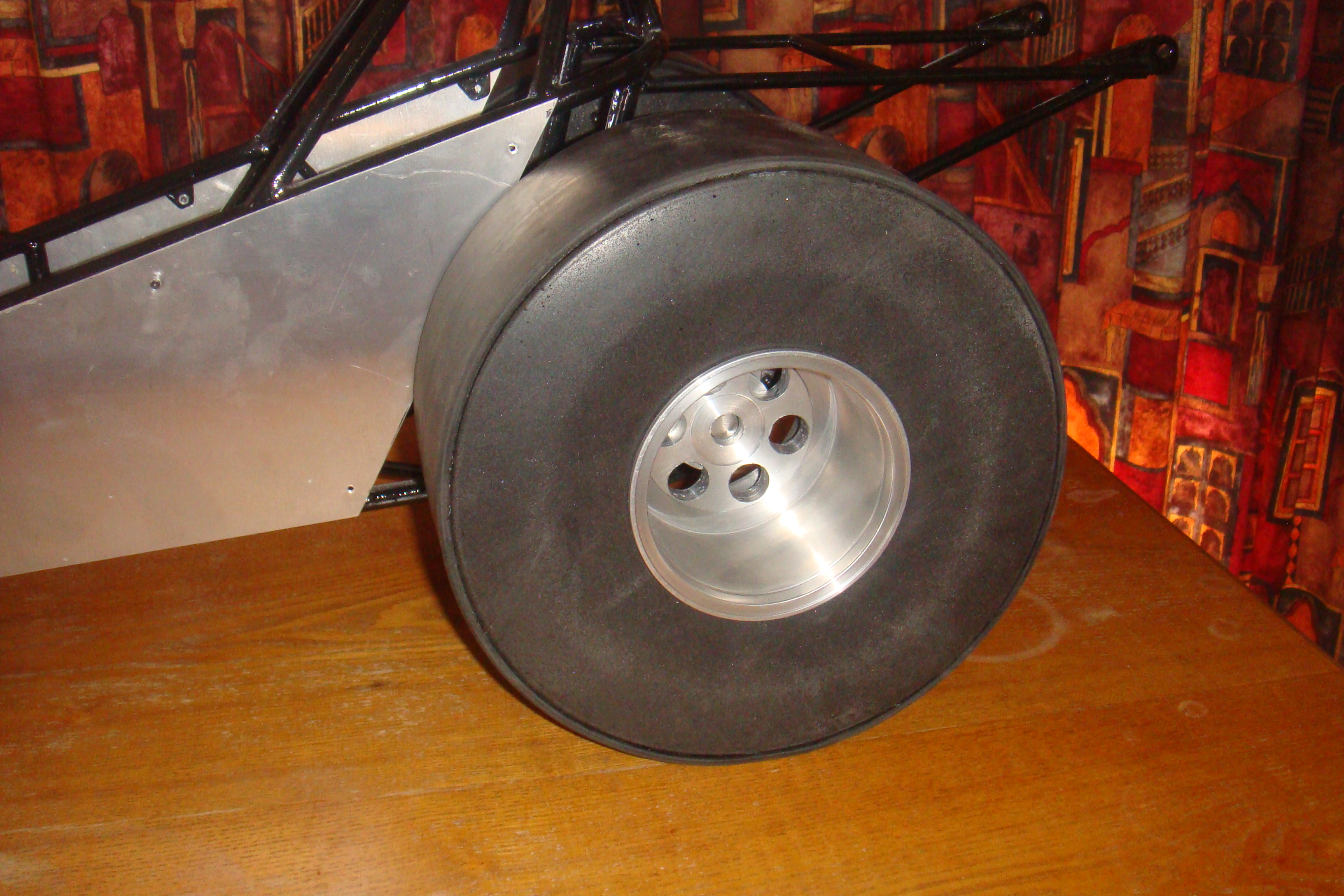

its been ages since ive been on,but have been able to do some more on the funny car,got the rear axel and rims made,the centers of the rims are quick mock ups so i could start working on the diff housing,it will be interesting to see how well it runs,im using a grinder head gear which ive machined down to create a ring gear,i still have to machine the spur gear shaft and attach the hosing for this to the diff housing,its pretty solid so it should handle the 75+ hp im going to throw at it, lol.
I still have to machine up the front rims,drive shaft and clutch cover,
heres afew pics
cheers mike

heres the axel/diff housing pic

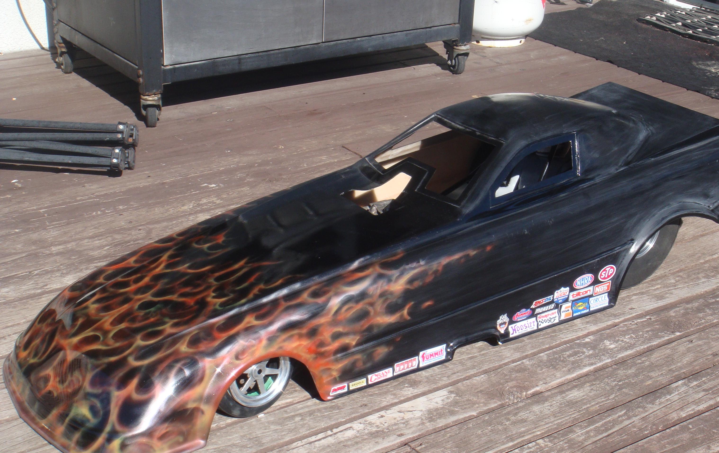

heres a pic of the chassis with my other spare body,the front rims are test rims off my rail chassis,but worked for the pic to see how the body will sit on the chassis,once cleared this body will be good for testing the car once its ready for its first run,
mike

mad62 wrote:heres a pic of the chassis with my other spare body,the front rims are test rims off my rail chassis,but worked for the pic to see how the body will sit on the chassis,once cleared this body will be good for testing the car once its ready for its first run,
mike
Mad62 where are you ?? whats the status on the progress of your project also i would like a funny car body as well..
Julian
2x IMPBA World Record Holder

hi guys.sorry been away a lot with work and havnt had a lot of time to work on my projects,i still have my molds etc for my cars,the freight might be the issue as I live in new Zealand,in the past with other kits I used to make I would get several guys together to get a order ,sending several bodies in one box works out cheaper as we get hit on the diamensions more than the weight issue,then the guys would split the freight ,
