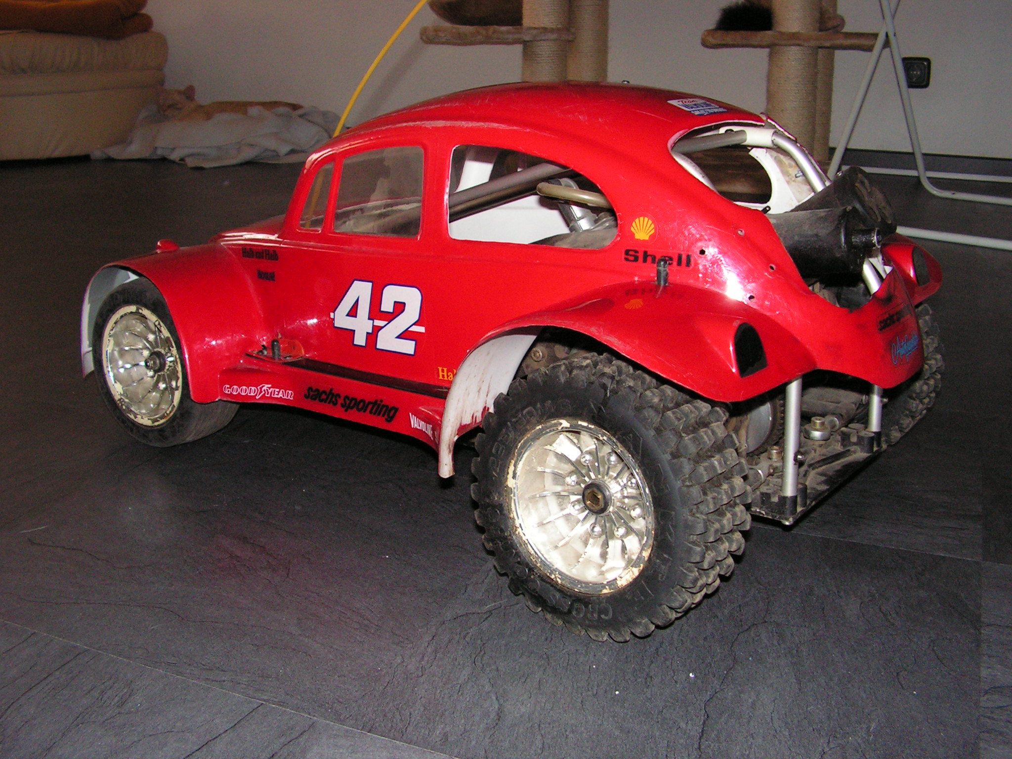

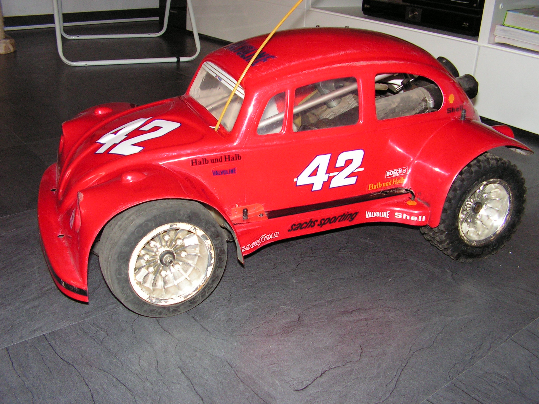

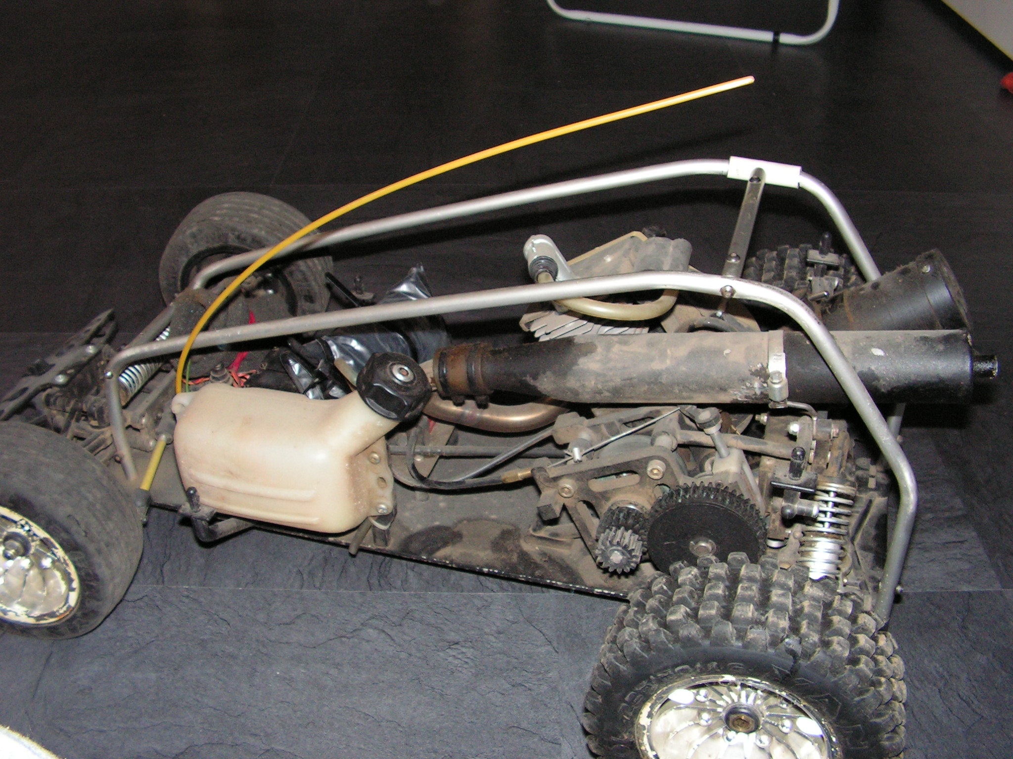

hello,
Once sorry for my bad english. I use the google translate :) I am looking for a part of the rear axle of a Yankee Cross Beetle.
Who else has one as spare and would sell me this.
Image is uploaded.
many thanks

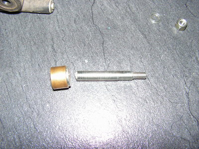

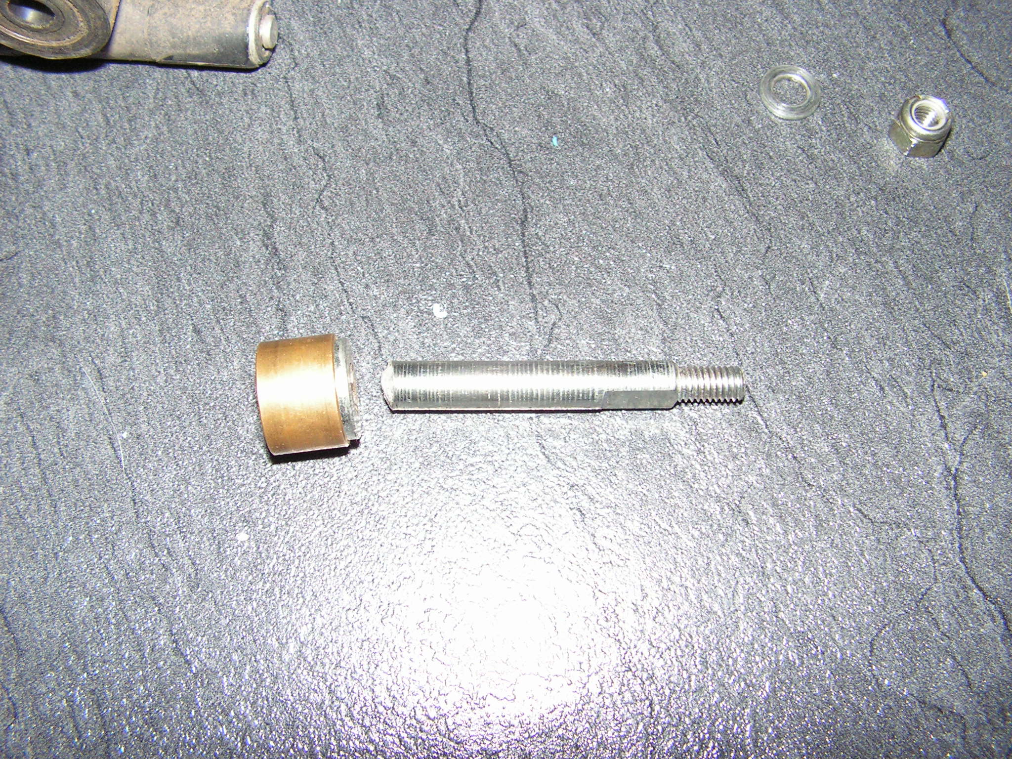

Here is a New Picture from this part
what I need

Never knew Yankee had a VW Beetle! That is very very nice I love it! Looks like tamiya sand scorcher but larger. How large is this car? If you ever want to sell it please let me know. Anyway, is that a CV axle? If it is metal all around you can mig that together with no problem, or try the Yankee F1 axle or send it to me and I'll see what I can do.

hello
have just looked on the website http://yankee-legend.com. find there but nothing.
The axis is for the rear wheel drive where the bone comes in.
the beetle I give so fast not her. so has my brother drive championships here in Germany beginning of the 90th
And this is a 1/4 model !!

In the past, I drilled a hole in the cup and on through the broken end of the axle, then with a fine screw tap, tap the hole, make thread down into the center of the axle, use red loctite and a hardened screw and your back in business until you can replace it.

Hello,
Here is your part, without the copper collar.
http://yankee-legend.com/epages/box2192 ... s/80120200
