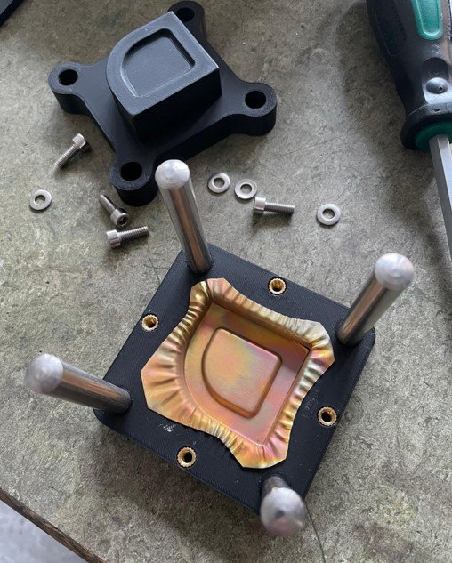

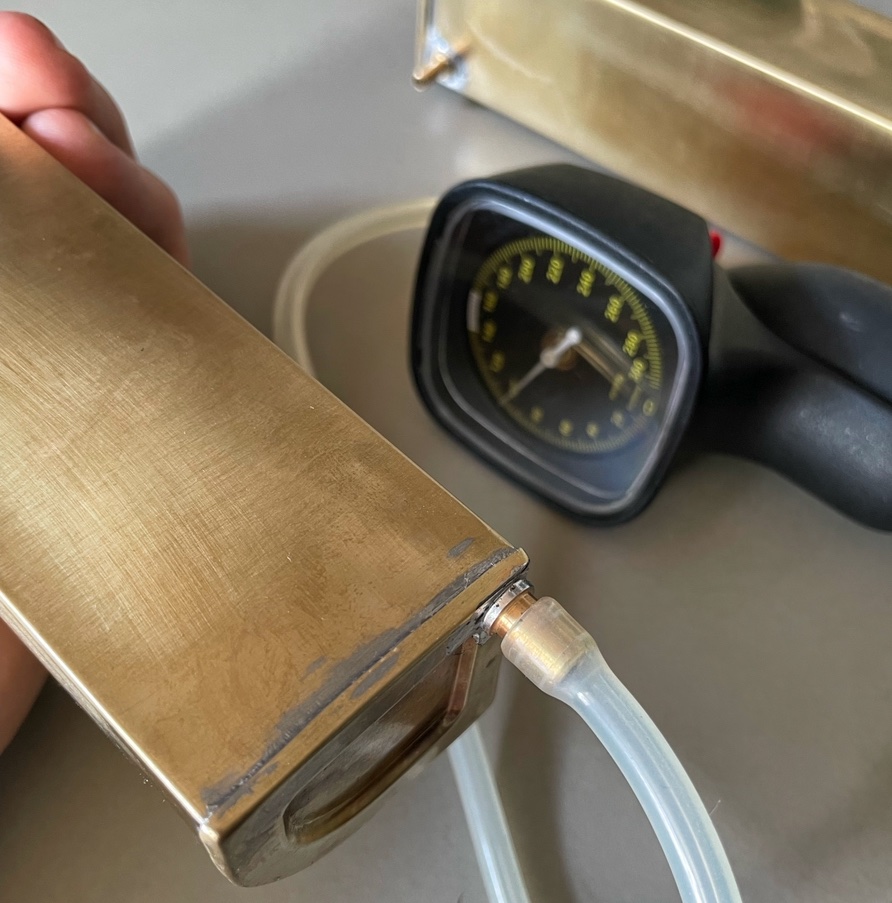

rc garage berlin wrote: ↑June 15th, 2024, 4:17 am My first selfmade Gastank from deep drawn brass…there will be one on each side
wow!
Re: Ferrari 330 P4
How did you make it? Wood plug and then solder together?

I deep-drawn the sheets and then soldered them. I use 3D-printed tools for this.
I was looking for a suitable tank for my model and found nothing.
Now I can make perfect scale fuel and oil tanks. I am really happy with this decision.

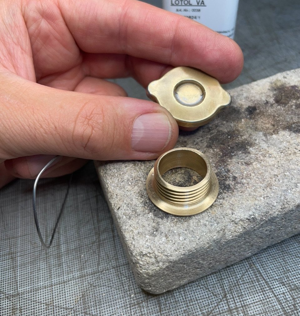

Airtight

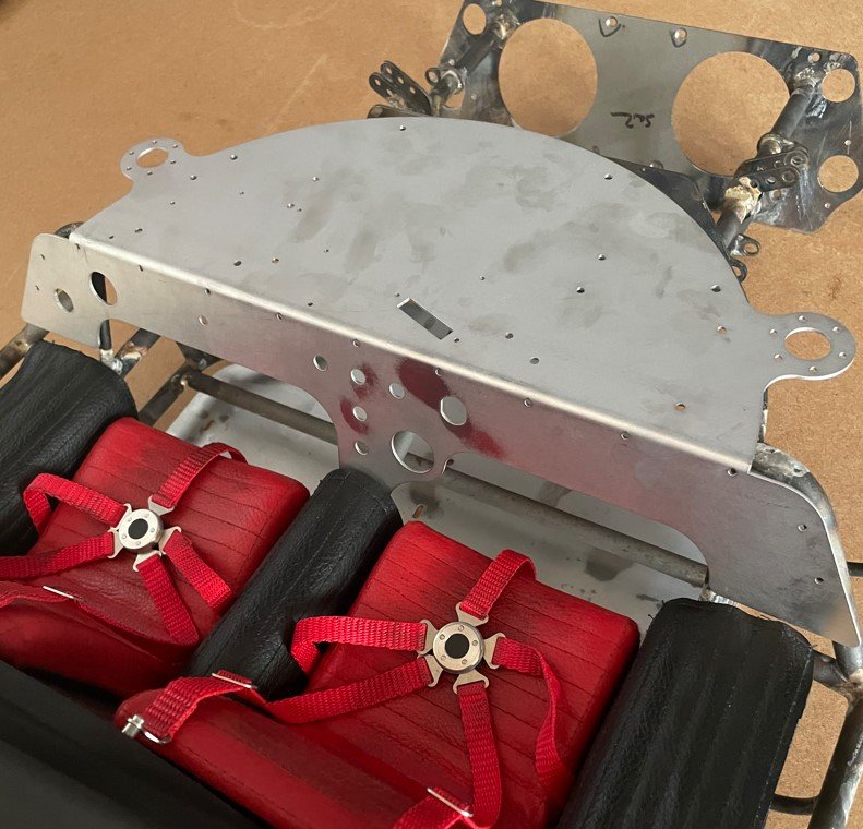

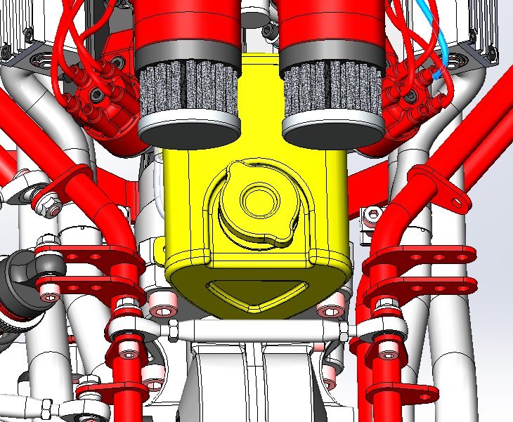

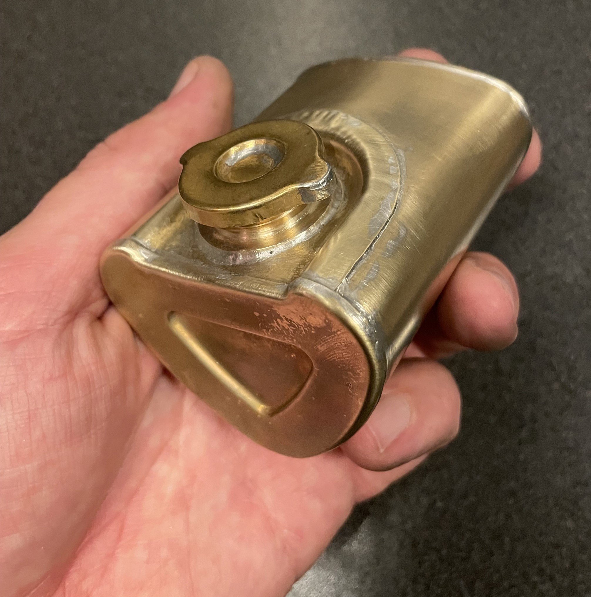

Now to something more difficult...

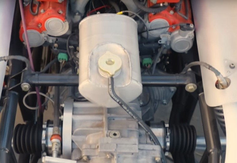

...the best moment is always when you hold the right parts in your hand.

A lot of work. I would not make a second one...

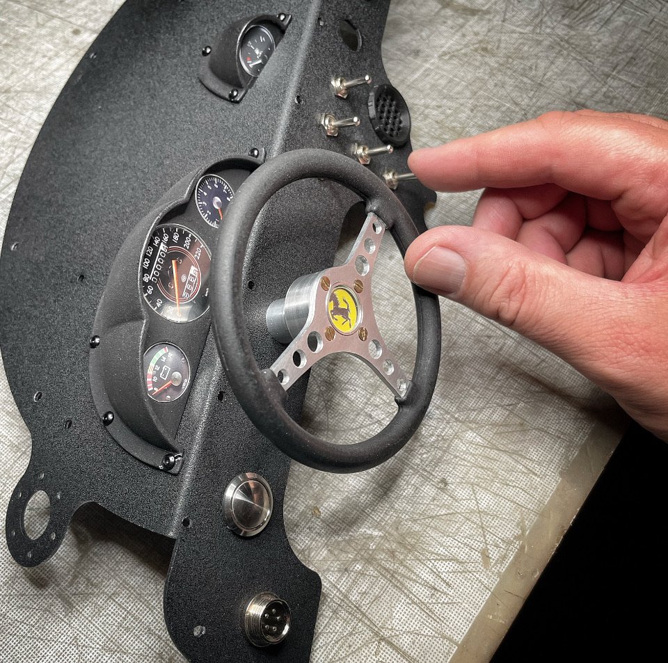

Thank you my friends. Today the laser cutted Dashboard and floor arrived...

I found a perfect spraypaint for the dashboard with a little structure like the original one. I am close to finish the project.
