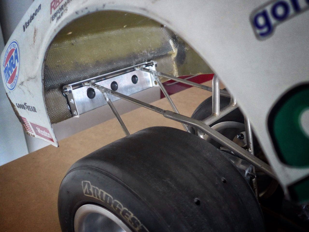

Made a new part to fix the body to the frame. You can choose three positions depending on the size of the wheels you use....

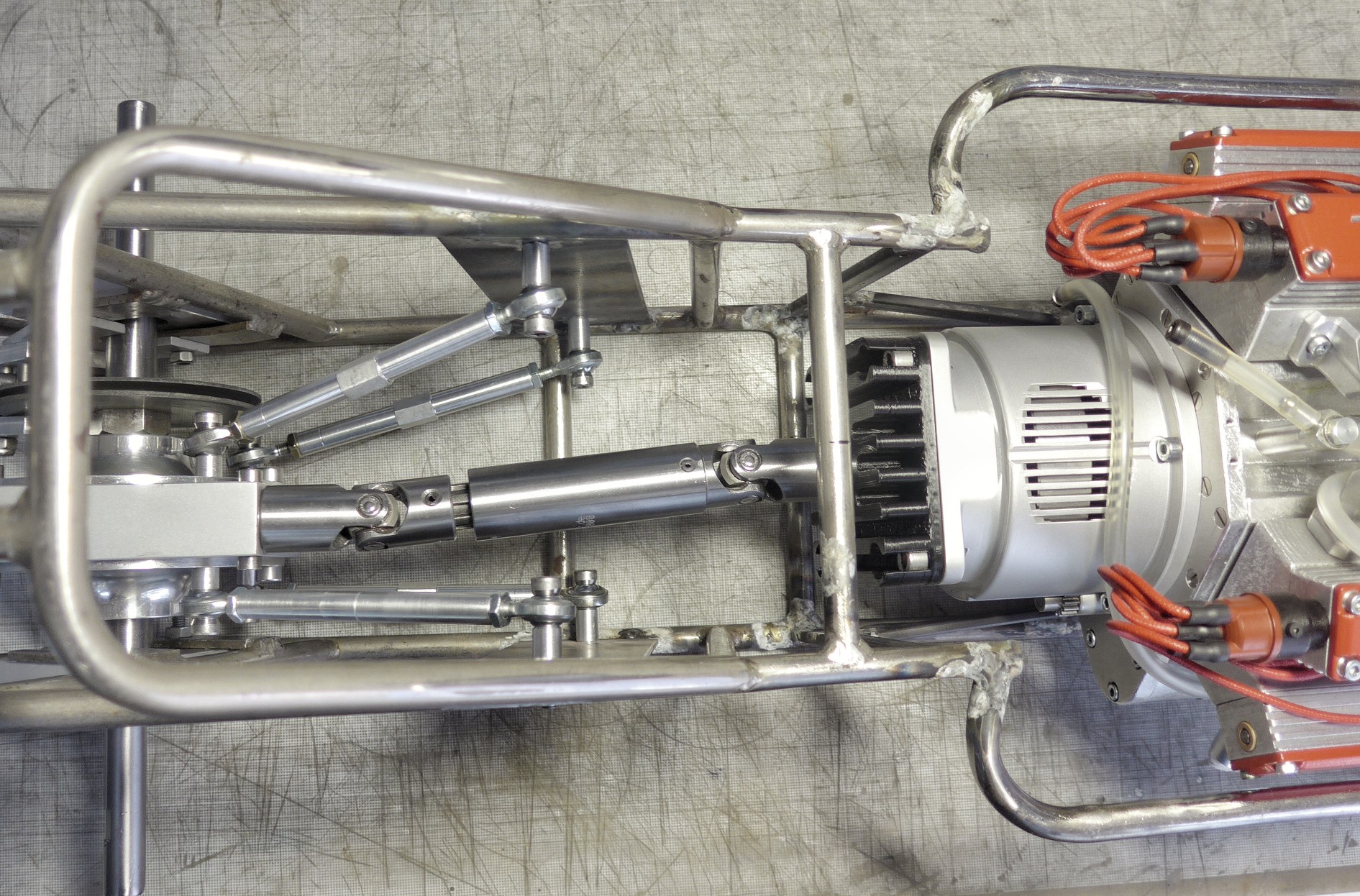

just mounted the rods and the new design prototype of the clutch housing....

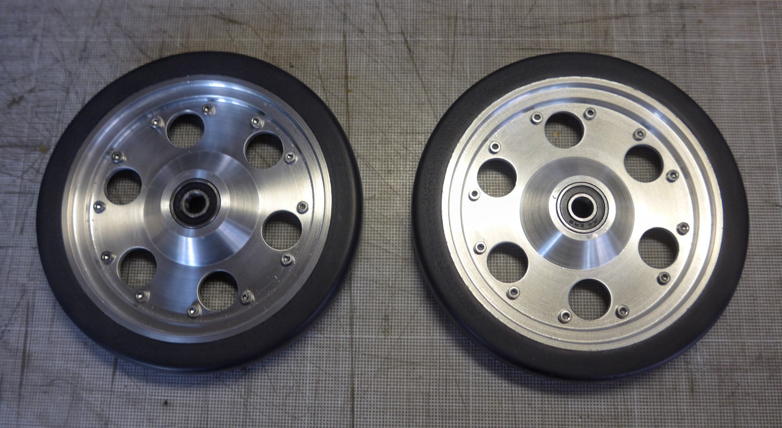

rc garage berlin
Posts: 346
Location: Berlin
Re: Another funny car project...
Post by rc garage berlin »
I like wheels with screws even if they make no sense....
They look great!

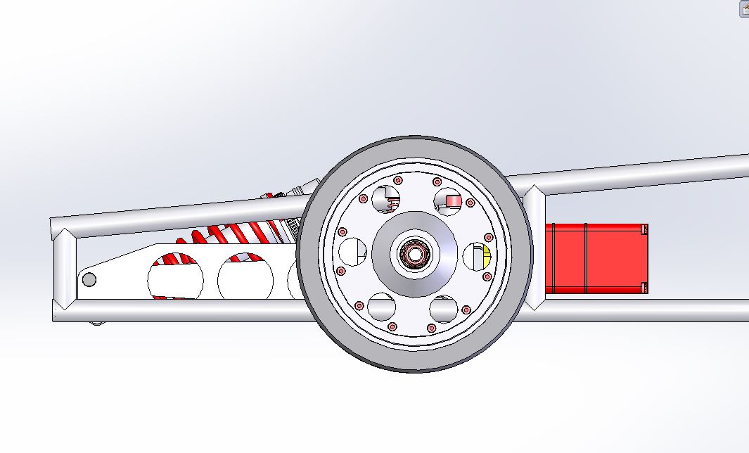

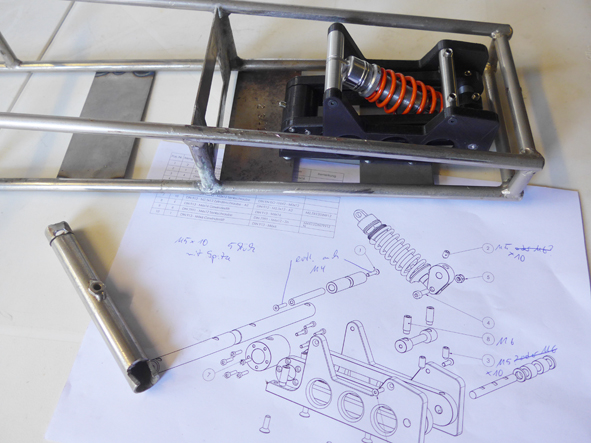

Working on an new front Suspension right now. The original Pacesetter never worked well...
It will be adjustabel to run different wheel sizes on that Frame...
Do you have the top view?

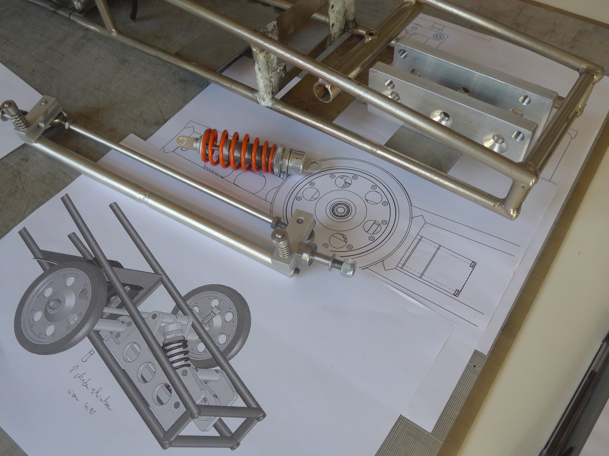

The tube for the front axle is welded too high on the pacesetter frame if you want to use small tires. Now I got an idea to make the position, the movement and the strength of the suspension adjustable. Can't wait to see the first prototype...

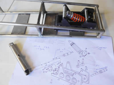

At the Weekend I removed the original Pacesetter tube and mount the front suspension prototype. Seems to work fine. I like the fact that it is very flat. Now the Frame is ready for powder coating...
Have a nice week...
