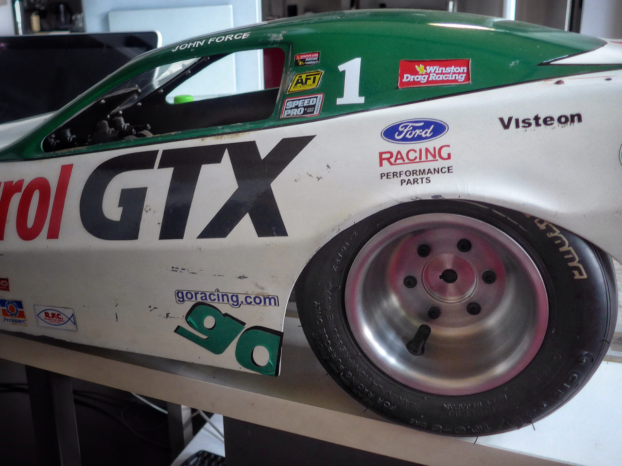

Re: Another funny car project...
First test assembling before the frame gets powder coated.
Engine and tires fit under the old body which I want to keep
unrestored...
unrestored...
I use in the rear: Bridgestone YDE 4.5/10.0-5 (front tires for karts).
In the front I use pacesetter tires and rims with a diameter of 4 inch.
For me it is important that the wheel fits the body.

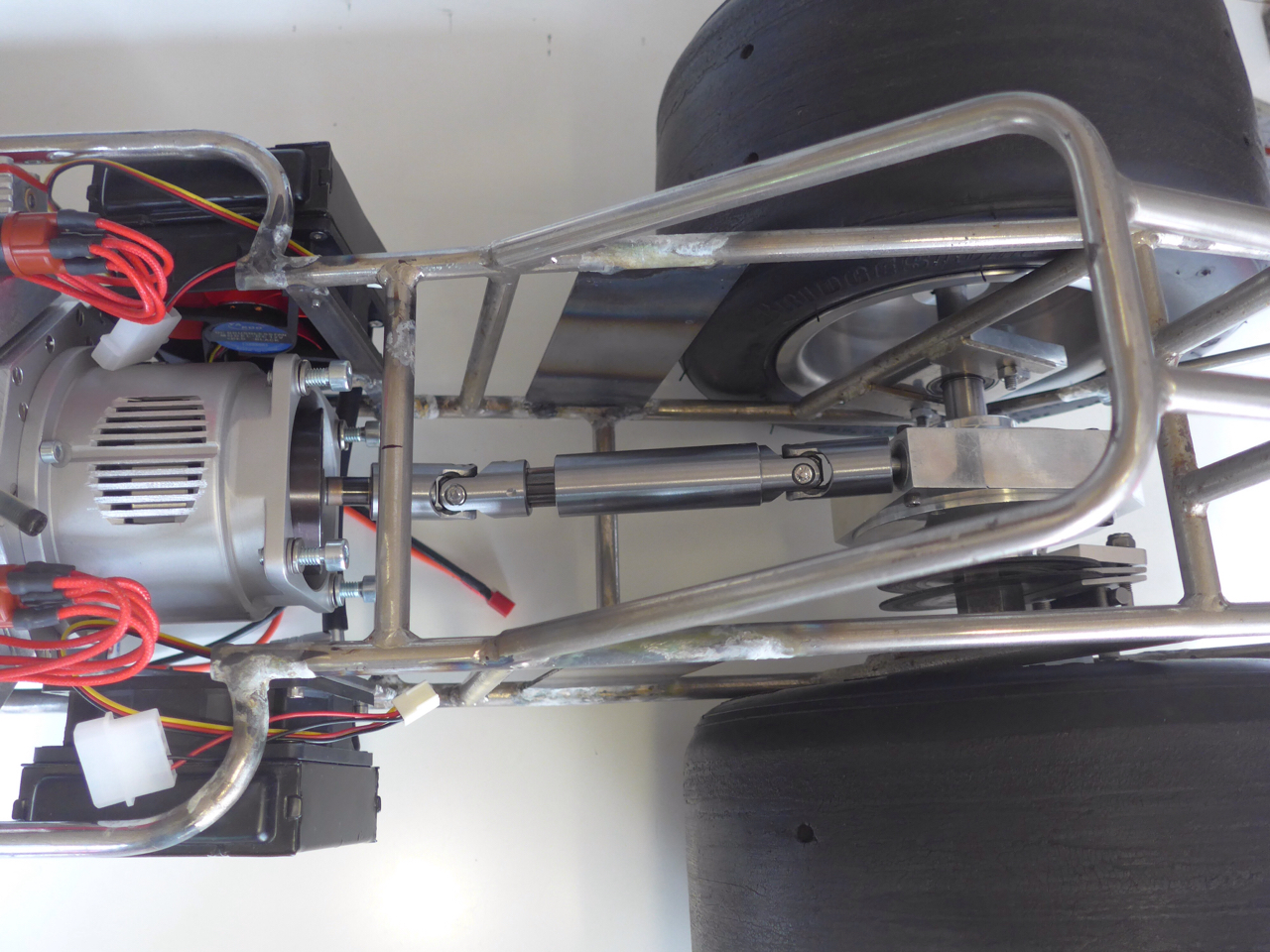

Got the drive shaft today. It is huge. Hope the silver dollar will stand the force.
