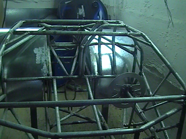

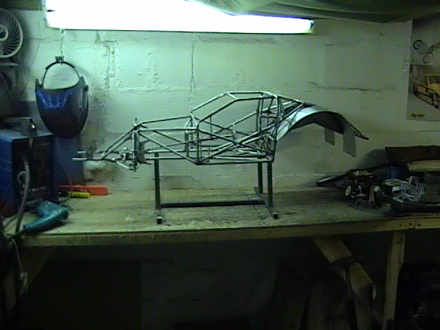

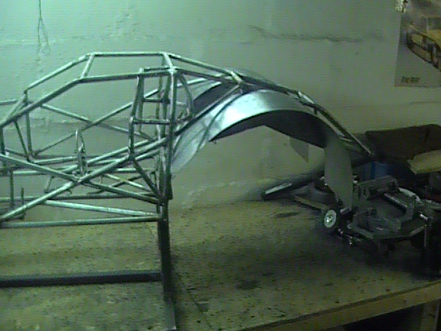

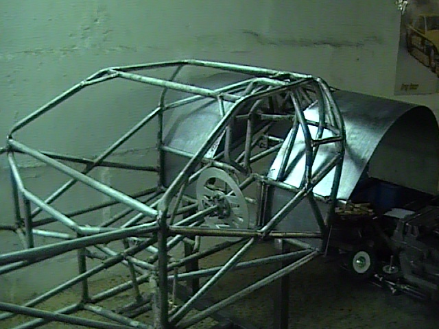

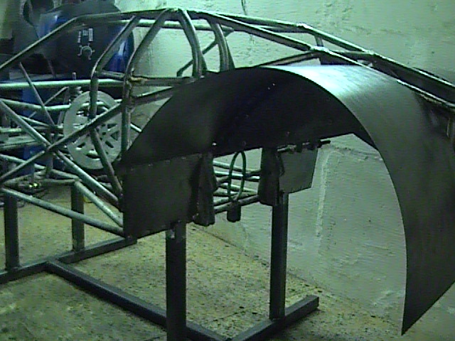

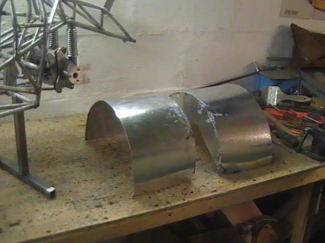

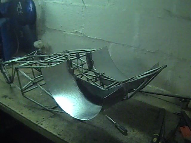

Well i now have the tubs tack welded in.. I over cut the tubs to allow them to fit the quarter panels, once i get the body built i will trim the width to fit... here are a few shots of them.. The rest are on my site!

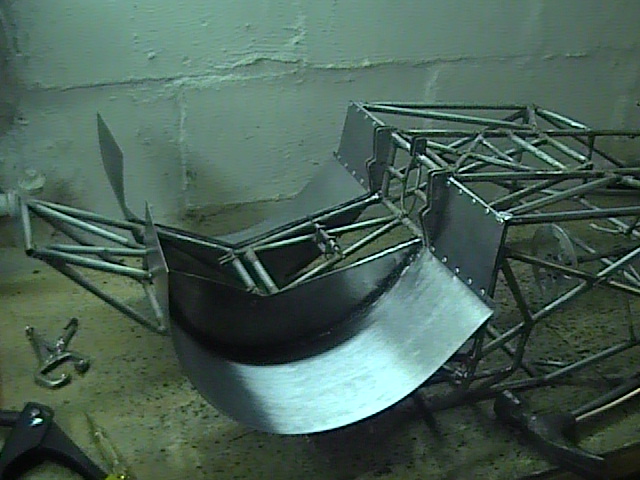

Update: I wasn't happy with the other tube design so i cut them off and cleaned up all the weld,, I then focused on my new tube design.. there constructed from 22 gauge Cold Rolled Steel, There attached via 1/8'' pop rivets.. I still need to trim the metal along the chsssis tubes and clean / seal the inner tubes but other than that there done! As you may have noticed i didn't spend alot of time cleaning up the welds along the seams.. Why! Because there will be cloth attached to the tubs that will match the interior and they won't be visible.. Now if i were going to go with a sheet metal interior look it would be a different story.. There is more shots of them on my site! http://www.quarterscaleprostreetberetta.com/Tubs.html

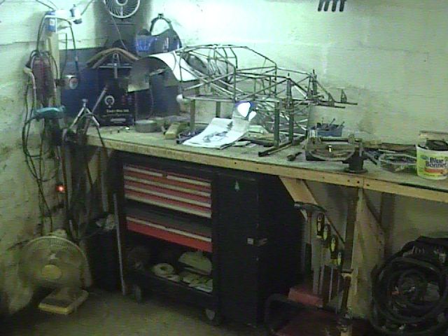

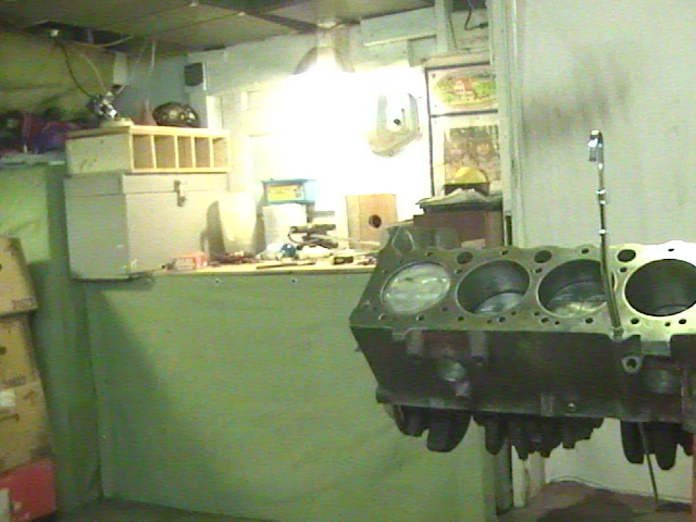

Well i managed to find the time to increase the size of my little work area.. It's currently 14'x14'x6' I am going to have a new garage/workshop built next year here at the house then i will move all my crap here.. It's currently located in the basement of our old home.. now my daughters home... I plan on re-sealing the south & west walls in the basement over the winter. but other than that it's > GOOD TO GO
Here are a few shots of the old work area. there are a few more on my site!
http://www.quarterscaleprostreetberetta ... eShop.html

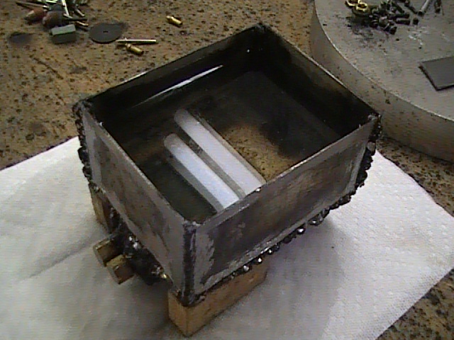

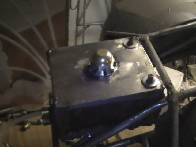

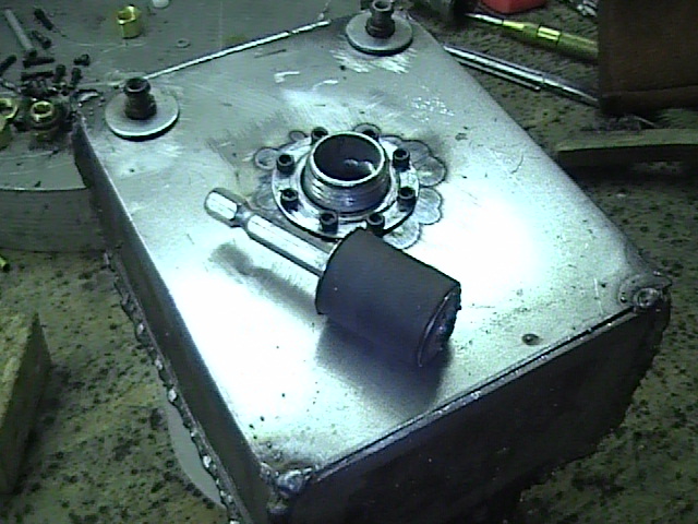

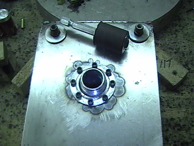

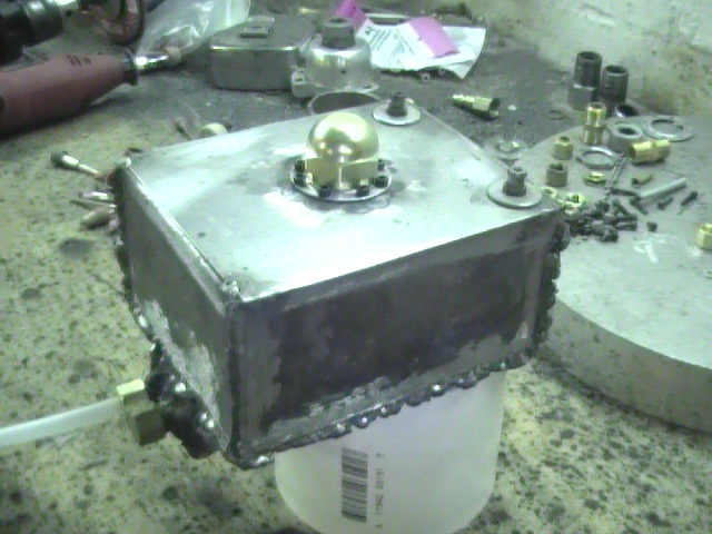

Well other than a little more welding / grinding the Fuel Cell is now built... Here are a few shots of it.. there are more pics of it on my site!
http://www.quarterscaleprostreetberetta ... -Cell.html

Re: '' PROJECT '' Pro Street Beretta
That looks bloody great mate, are you leak testing in the last picture?
- stoneyberk
- Posts: 171
- Location: Mishawaka, IN
Thanks for the complements guys..
Troppo> Yes that was one of many leak test i did on it... AS you can clearly see.. The paper towel is wet. lol.. I forgot to put the Teflon tape on the fuel ports... it's good to go now!! other than welding the top on it and cleaning up all the welds... I'm planing on taking it to the shop next week sometime and spray it..
FuNKY mOnk> That cap is just temporary, it's 5/8'' x 1/2'' I'm going to build a T handle cap for it from a 3/4'' barrel mandrel.. I've got the mandrel i just need to shave it down a tad to fit snugly in the fuel fill inlet hole... Hopefully I'll have it all done and painted within a week or so.. I'm gradually getting all these components built for this thing..
