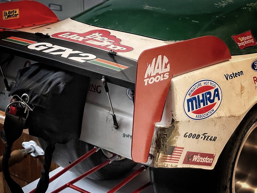

MAC Tools Stickers arrived today from england...

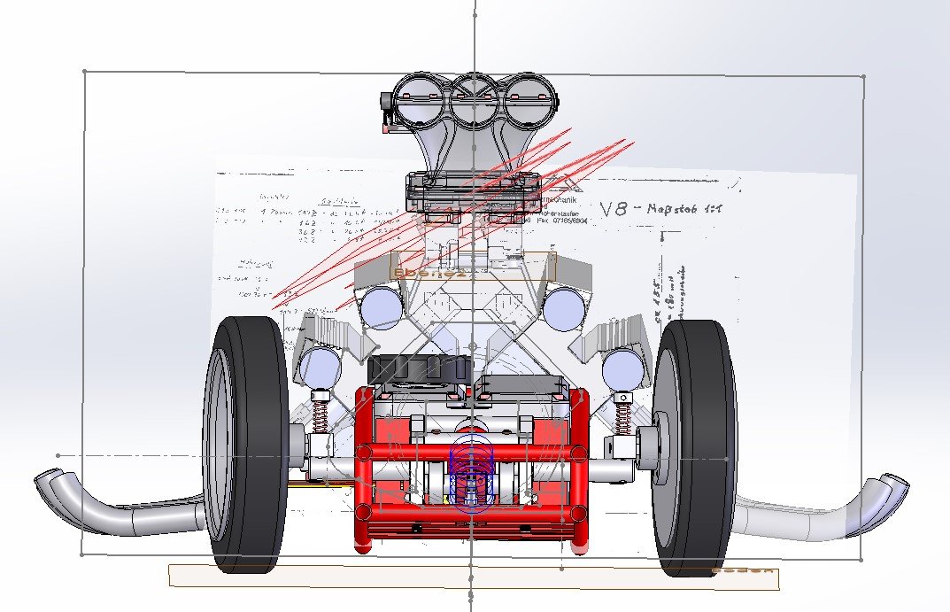

For me this is art!
Re: Another funny car project...
rc garage berlin wrote: ↑January 18th, 2022, 9:48 am For me this is art!
It is for me as well !

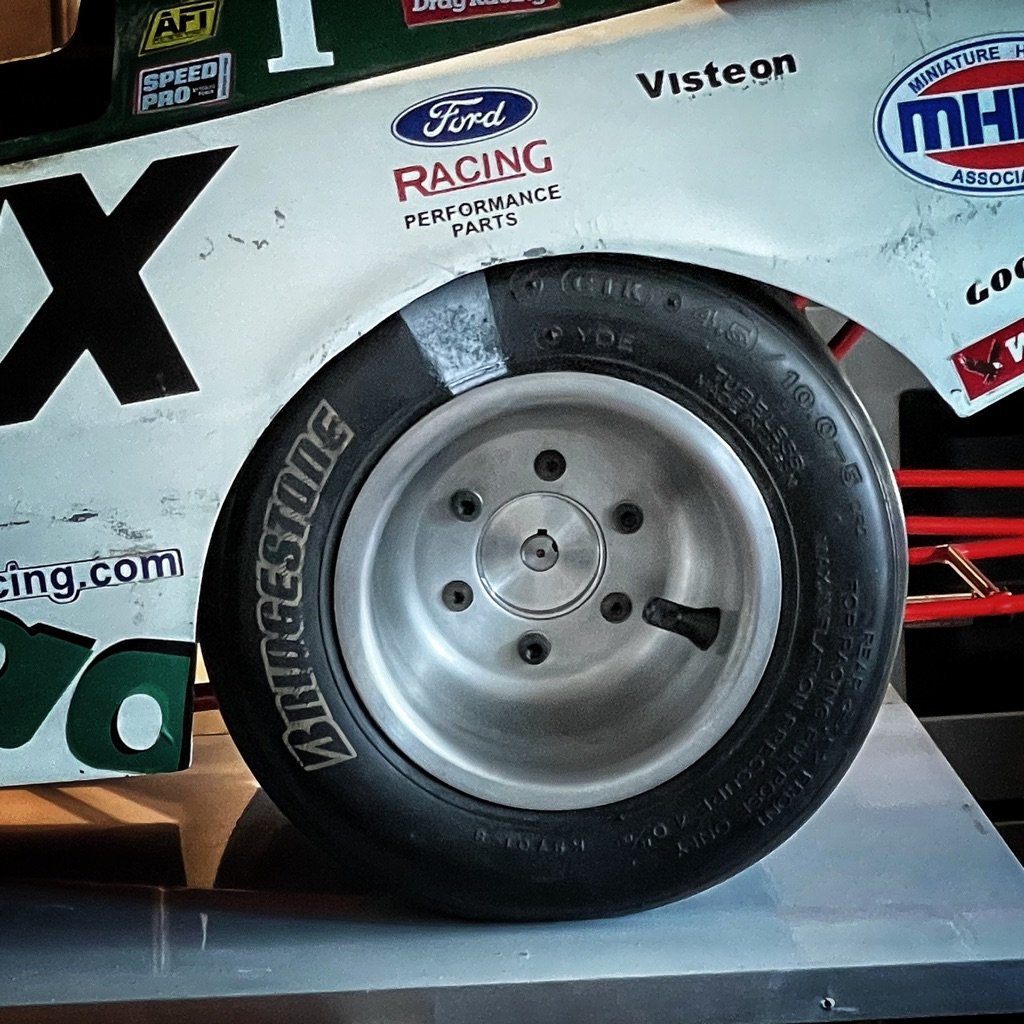

So, my tires have now this white stripe. Does anyone know what it is for?
rc garage berlin wrote: ↑January 19th, 2022, 1:55 am So, my tires have now this white stripe. Does anyone know what it is for?
I researched and found this, I hope it answers your question:
We still use it. When running a car often the driver is not aware of all the crew needs to know. His sensations on how the car performed are often vague and irrelevant because his skill is leaving on the tree (the so called 'Christmas tree lights). Some are completely ignorant when asked but since they can cut a great light you have to live with them. Many a crew chief including me puts a vertical stripe on the rear slick so he can watch "the Hook" I also often had it videoed so we could watch it later too. Every time the slick goes around spinning it costs about 1/10 of a second in lost et (elapsed time). In fact if it spun ten turns you loose a second. You learn to spend a good deal of your time playing with shocks, tire pressures, suspension bump stops and ride height trying to get this down to a minimum. The less experienced are resetting their timing, or changing jets, or something sexy, totally oblivious to the real job at hand that gives extraordinary times. Extraordinary "bite", that is what it is for and how it is used.
Typical comment from learning racers is "it didn't spin that much". Get them to add the stripe to the slick (or the old two colour painted wheel) and you will hear shortly. "Man I didn't think it spun that much!" The stripe gives your eye a point of reference in relation to the track and a poor traction is no longer a guess but is obvious. Some cars actually can pick up a second with a good crew chief, and little tricks like this, and never touch the engine to get it.

That is realy interesting. Thank you Kaye. I must say that I never been to a race and never saw a Funny car for real till now. I built everything from pictures and informations are hard to find.

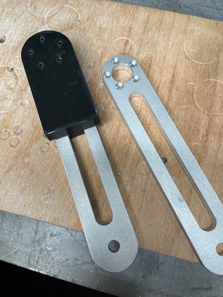

DIY-Tip : If milled parts are to expensive I use laser cut parts and drill them with a 3D-printed drill guide...

rc garage berlin wrote: ↑January 23rd, 2022, 9:07 am DIY-Tip : If milled parts are to expensive I use laser cut parts and drill them with a 3D-printed drill guide...
Thanks for sharing this good idea!

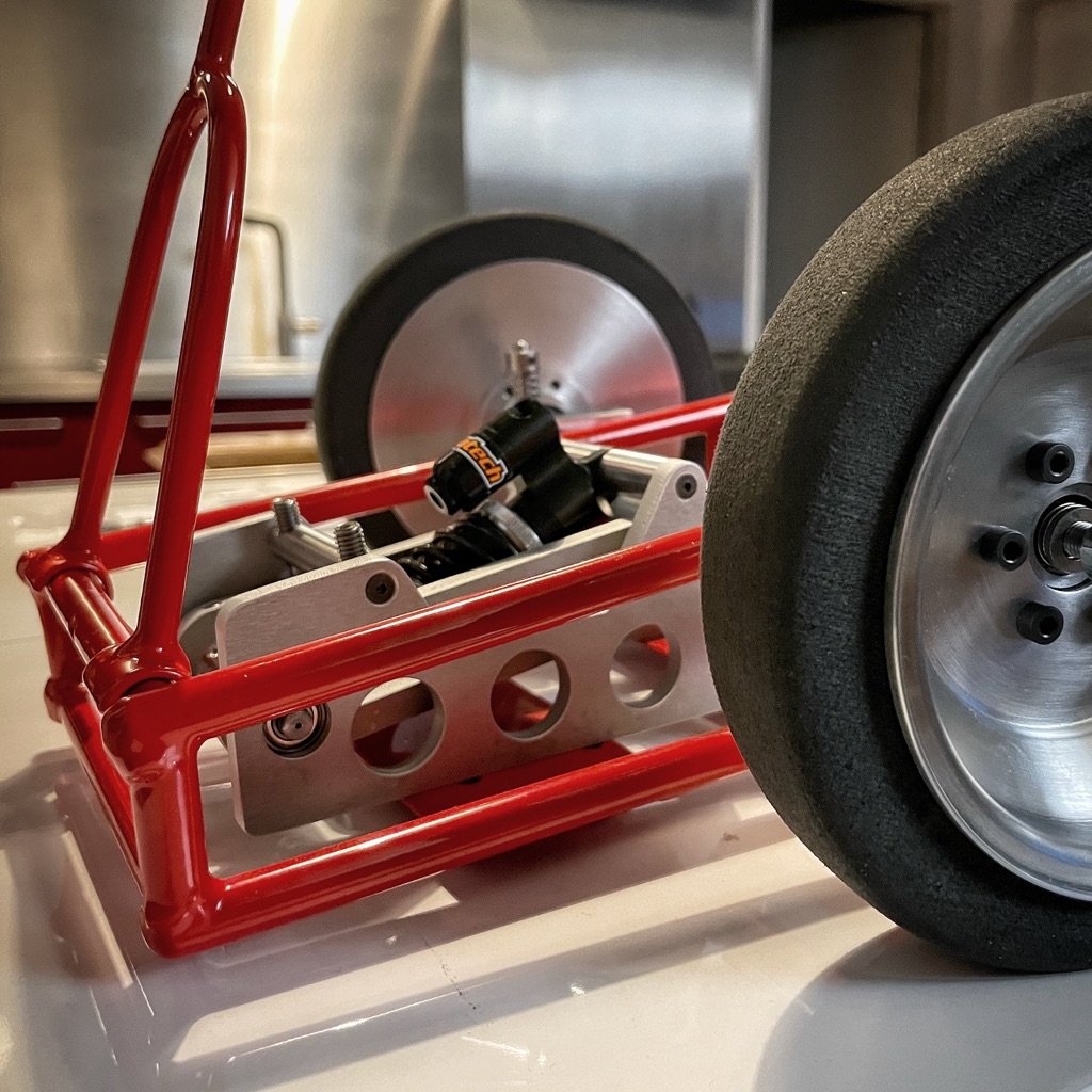

I really have to say that I am surprised by the high weight on the front axle caused by the heavy engine.
Because of the resulting friction, I had to add two bearings in the front wing and change the shock absorber to a stronger one.
rc garage berlin wrote: ↑February 1st, 2022, 9:44 am I really have to say that I am surprised by the high weight on the front axle caused by the heavy engine.
Your attention to these mechanical details is impressive!

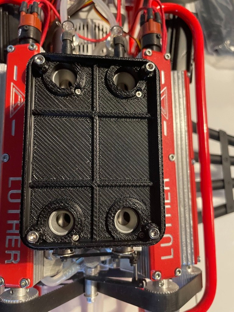

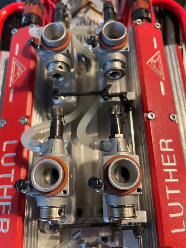

Post by rc garage berlin »

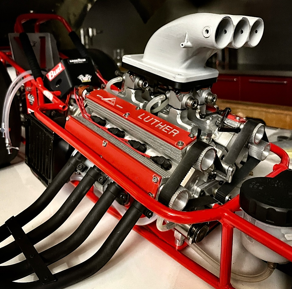

To attach the scoop to the four carburetors, Rolf Luther drilled a hole in each housing and taped four threads M2.5

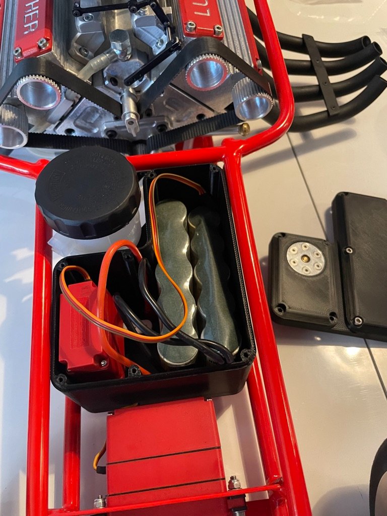

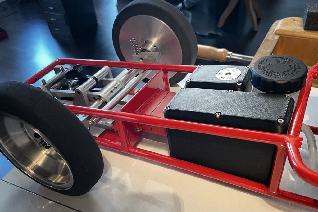

If you build a nice car it comes to the point when you have to decide where to put the RC components.Therefore I made a fake gas tank to store the batterys, the servo and the receiver. It also holds the tank for coolant.

Thinking about the colour of the scoop. Maybe red…
