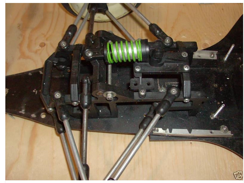

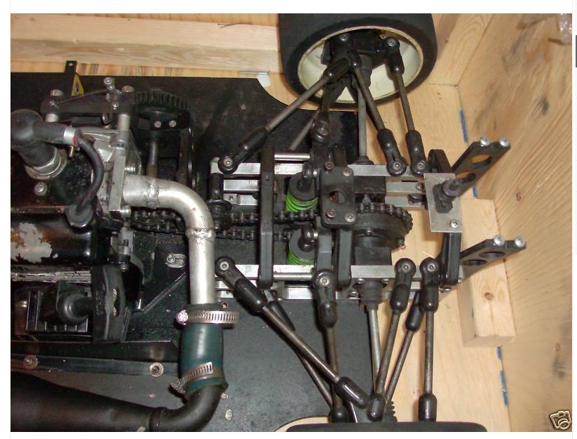

Hi,
does this car have a REAL independent suspension or is it a mock-up? Or does it have a live solid axle in the back?

hi Jari,
real independant wheels
shocks pushed by "rocker" (L part rotating)
2 behind
one in front

What are they worth? Diff in the back? Disc brakes for the rear only?

Hello Jariv,
There is an option for front brakes, rear only at the primary transmission. Diff housing aluminium in option too. 2 types of secondary tansmission by gears or by chain ( specially for the F1, but after 1996 for all the models 1/4 and 1/5).
I have one benetton under contruction and I love it.
