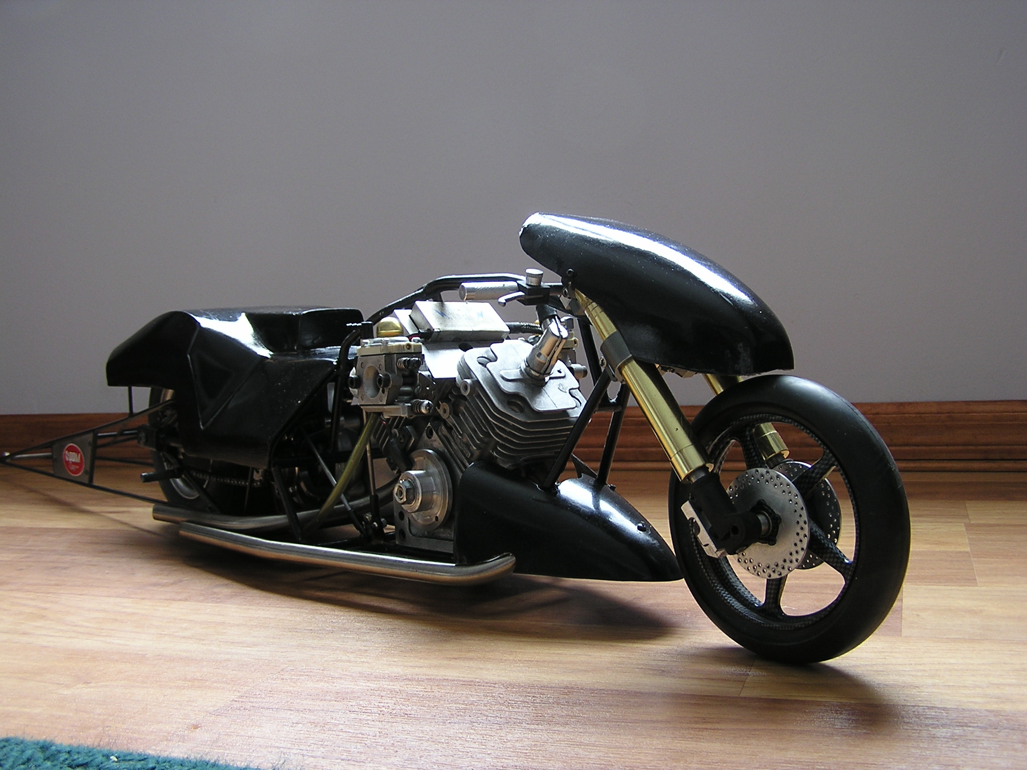

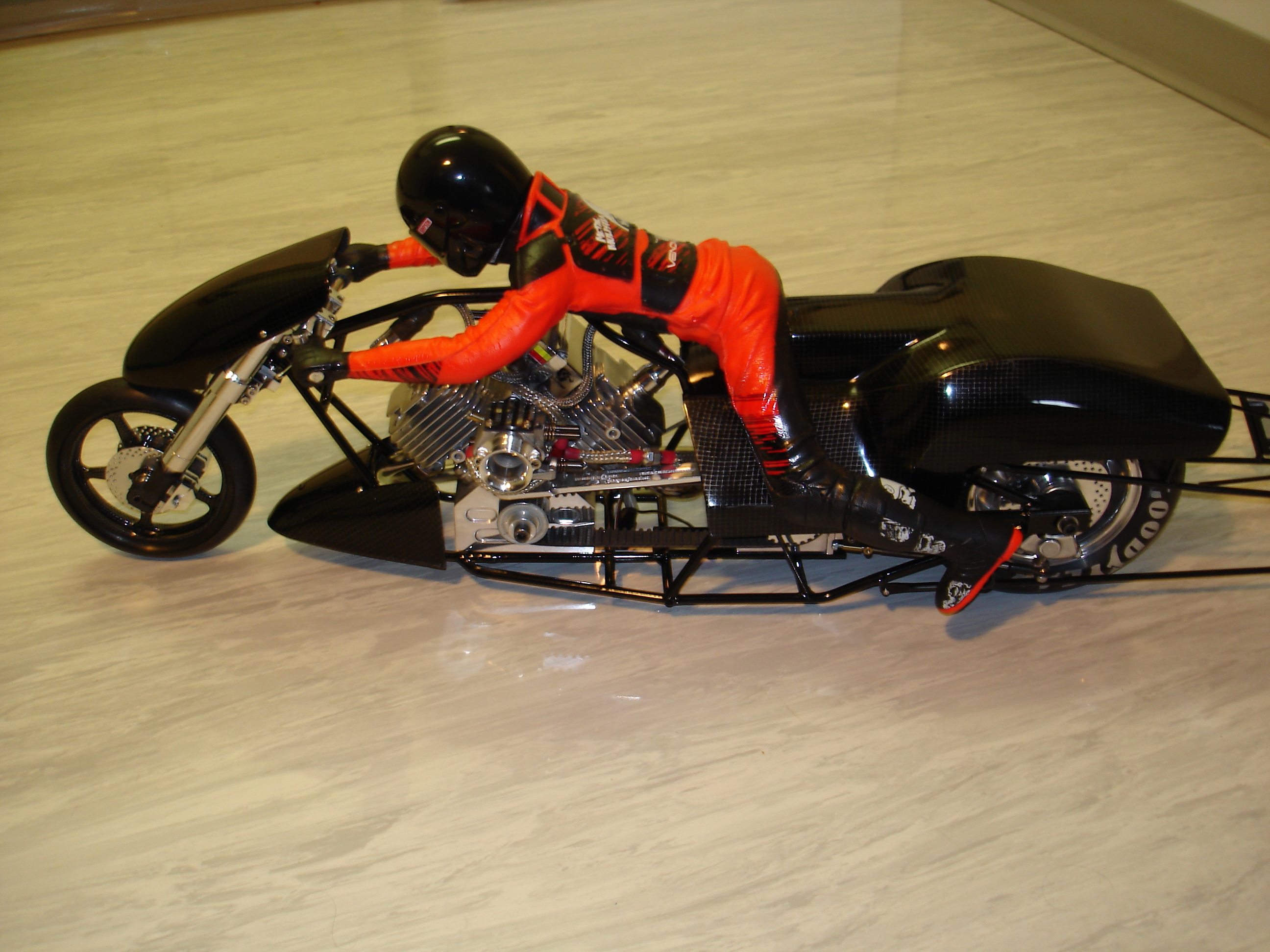

It has been a while since you last saw this project. Mike revealed this Top Fuel Drag Bike at last years RCX show. This outrageous crotch rocket is yet another creation from the depths of John Fosters mind and Area 51. This will be the first of a number of posts as I have many build/reassembly pics to share. This pic is as last seen at the RCX show.
Regards...Ron

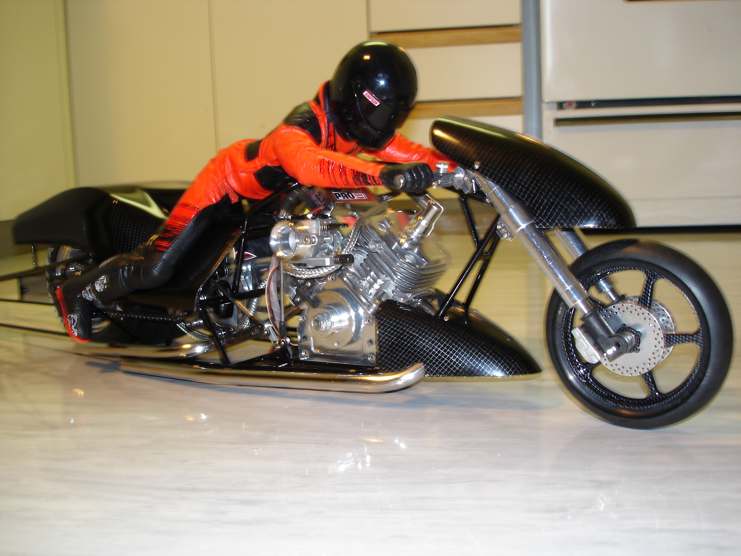

This is where the project is at today...not finished...but close :) .

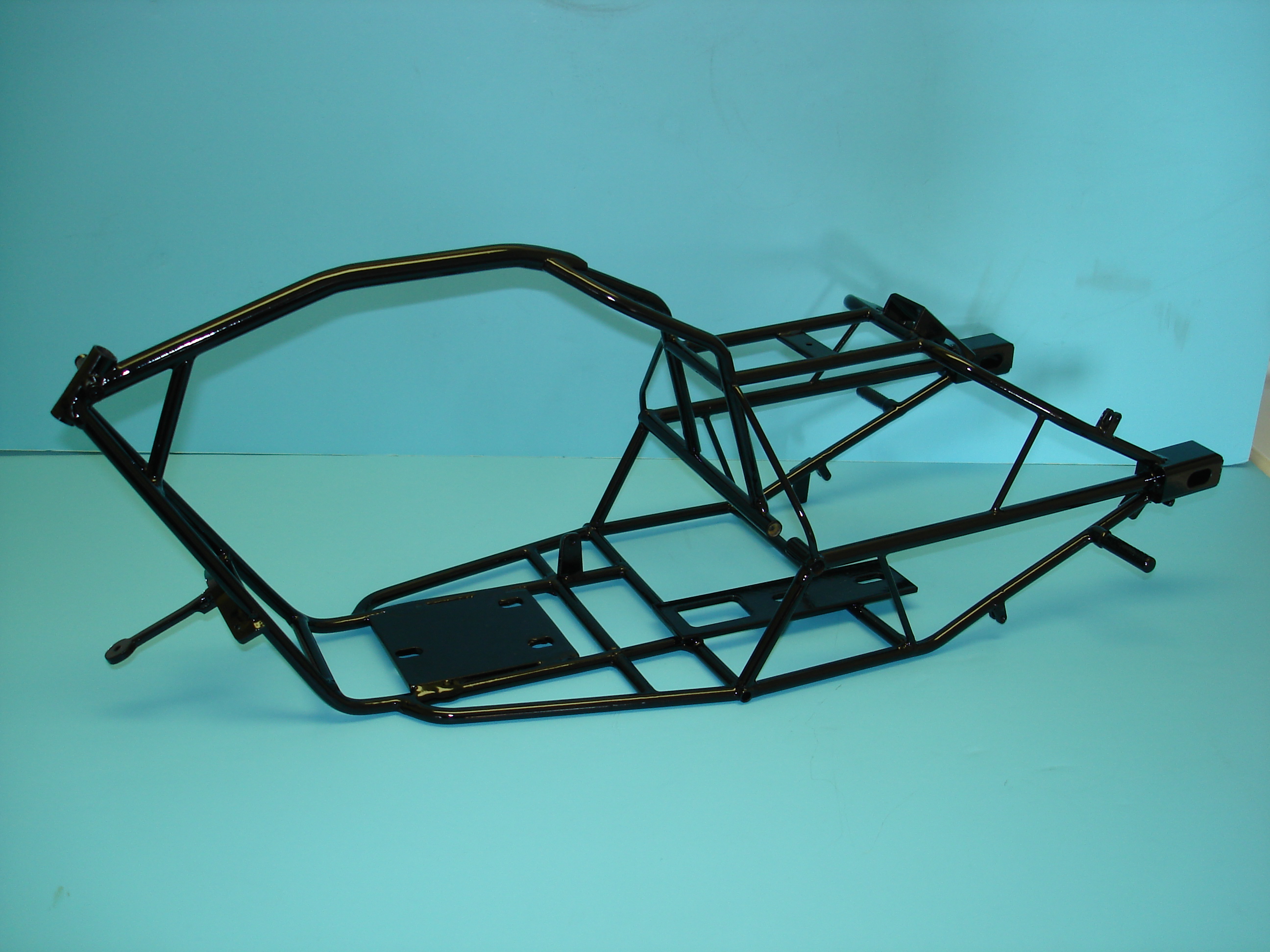

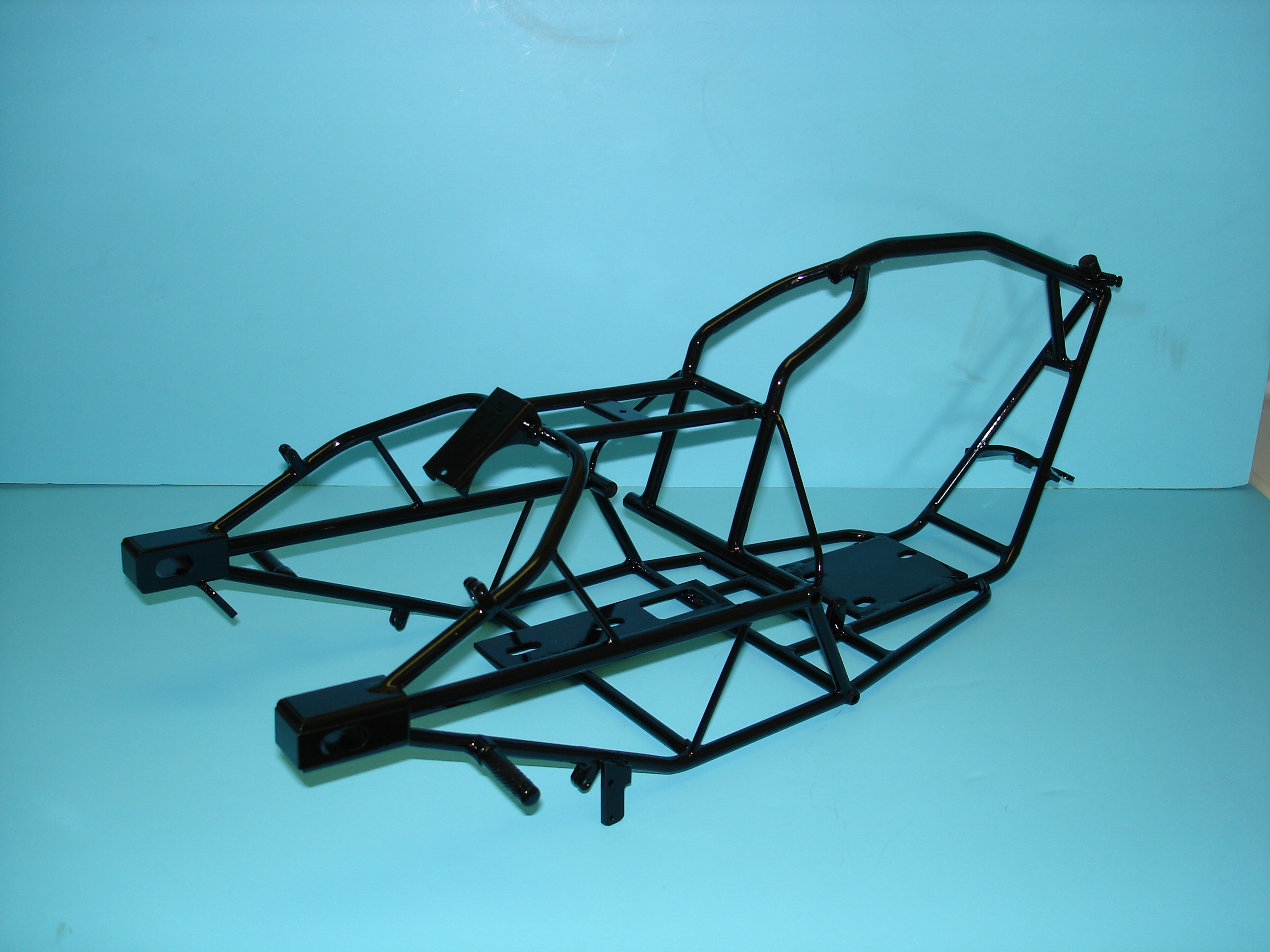

Powder coated frame...

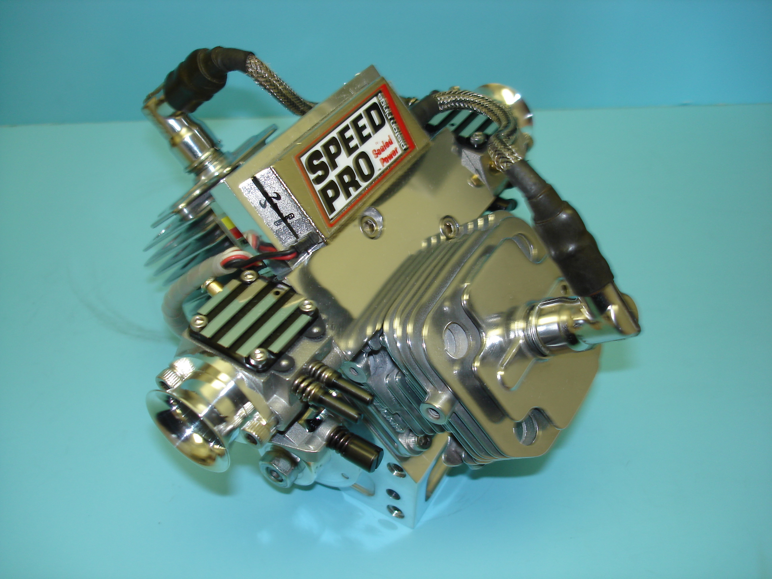

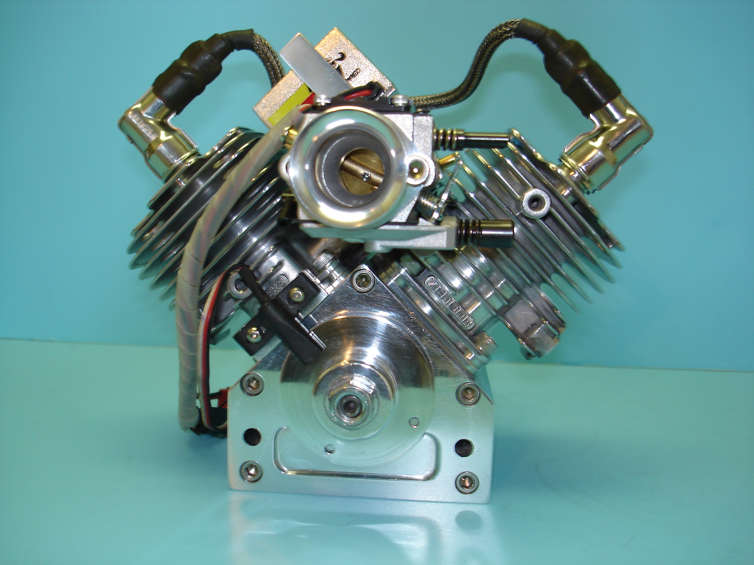

This is the 54cc. QM V-2 custom billet crankcase V-twin engine. I disassembled the engine completely and polished the crankcase halves, cylinders, intake, electronic ignition case etc. before reassembling...

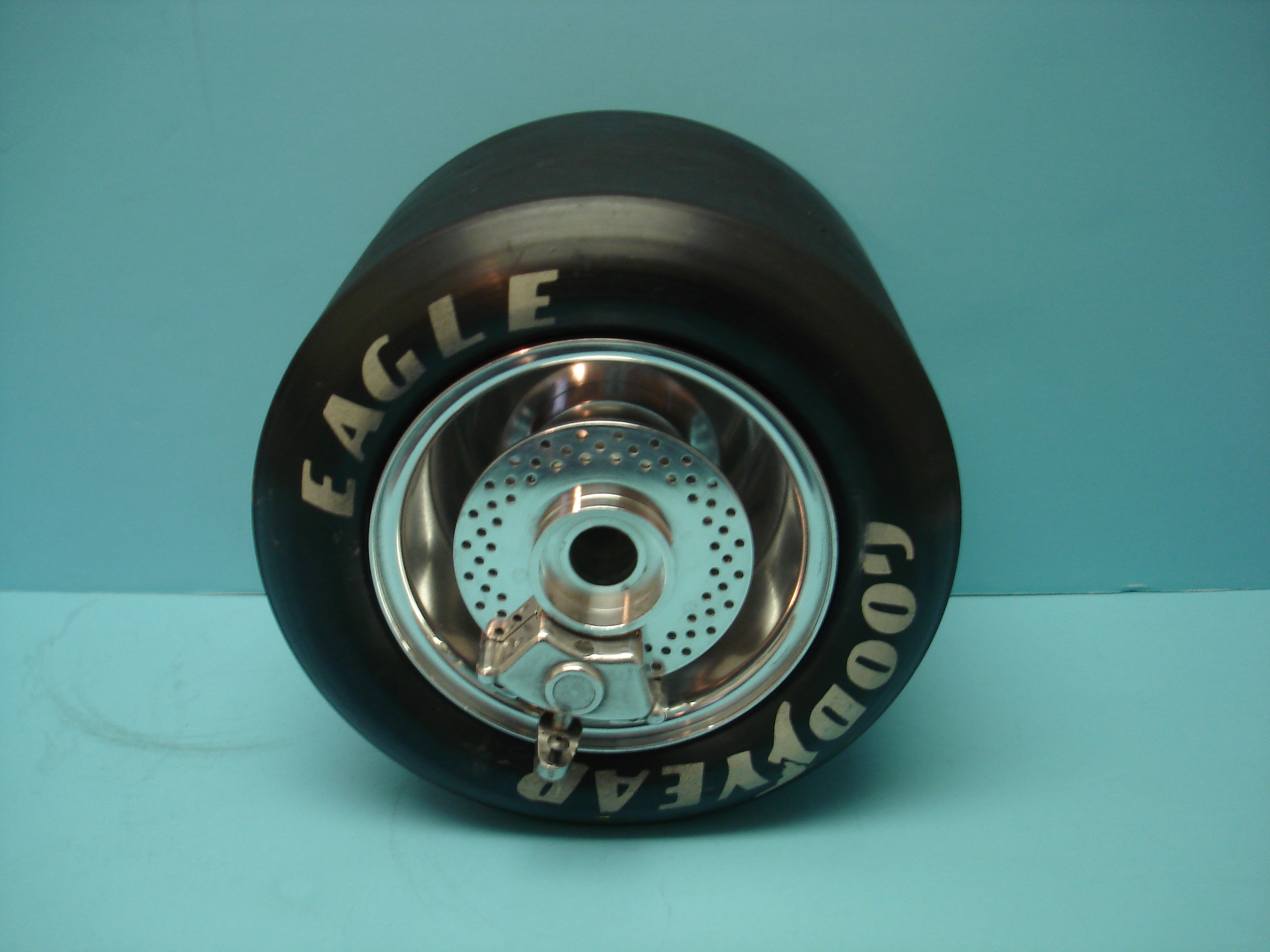

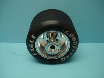

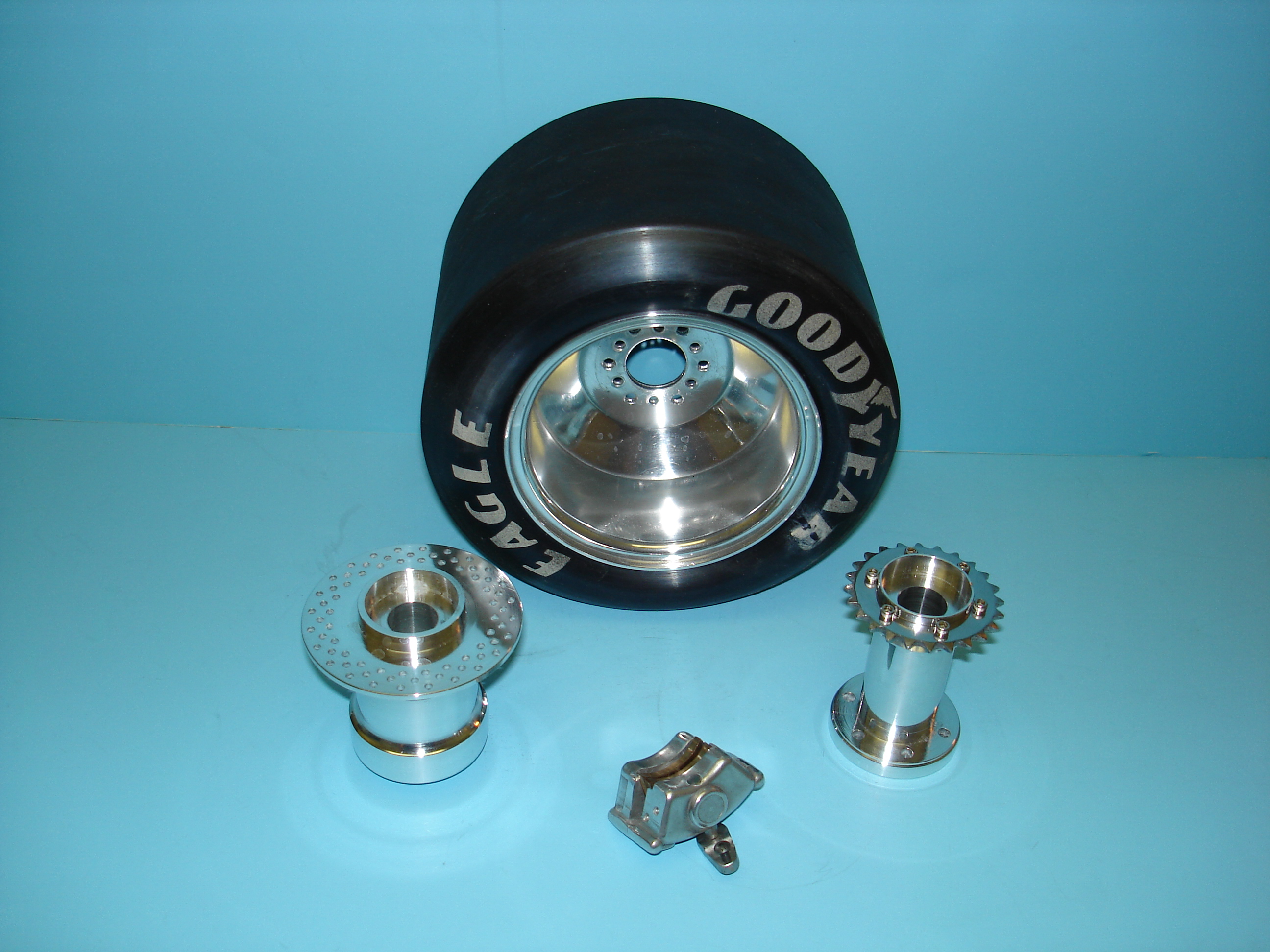

Rear wheel components...note left side hub machined with brake disc...

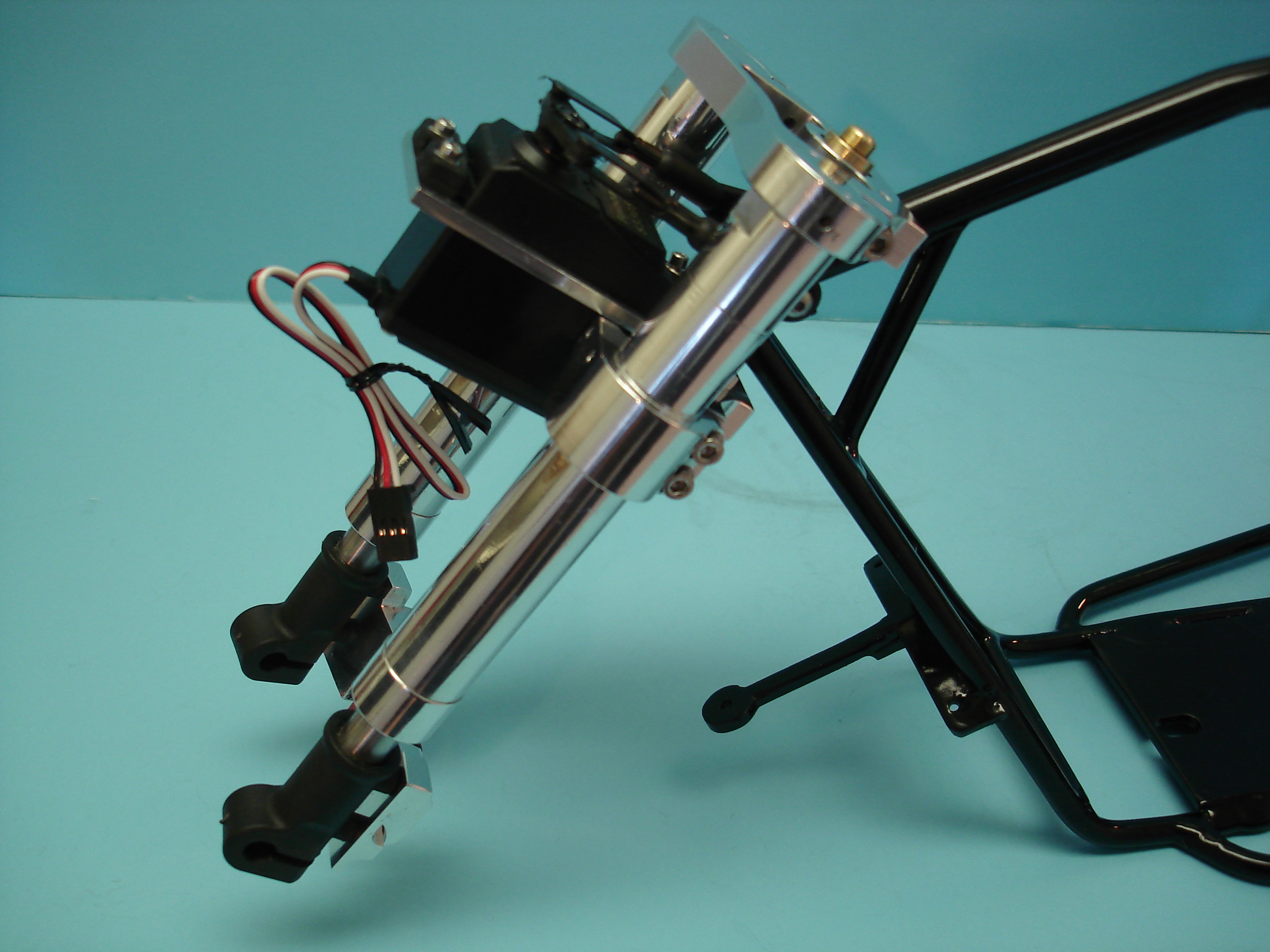

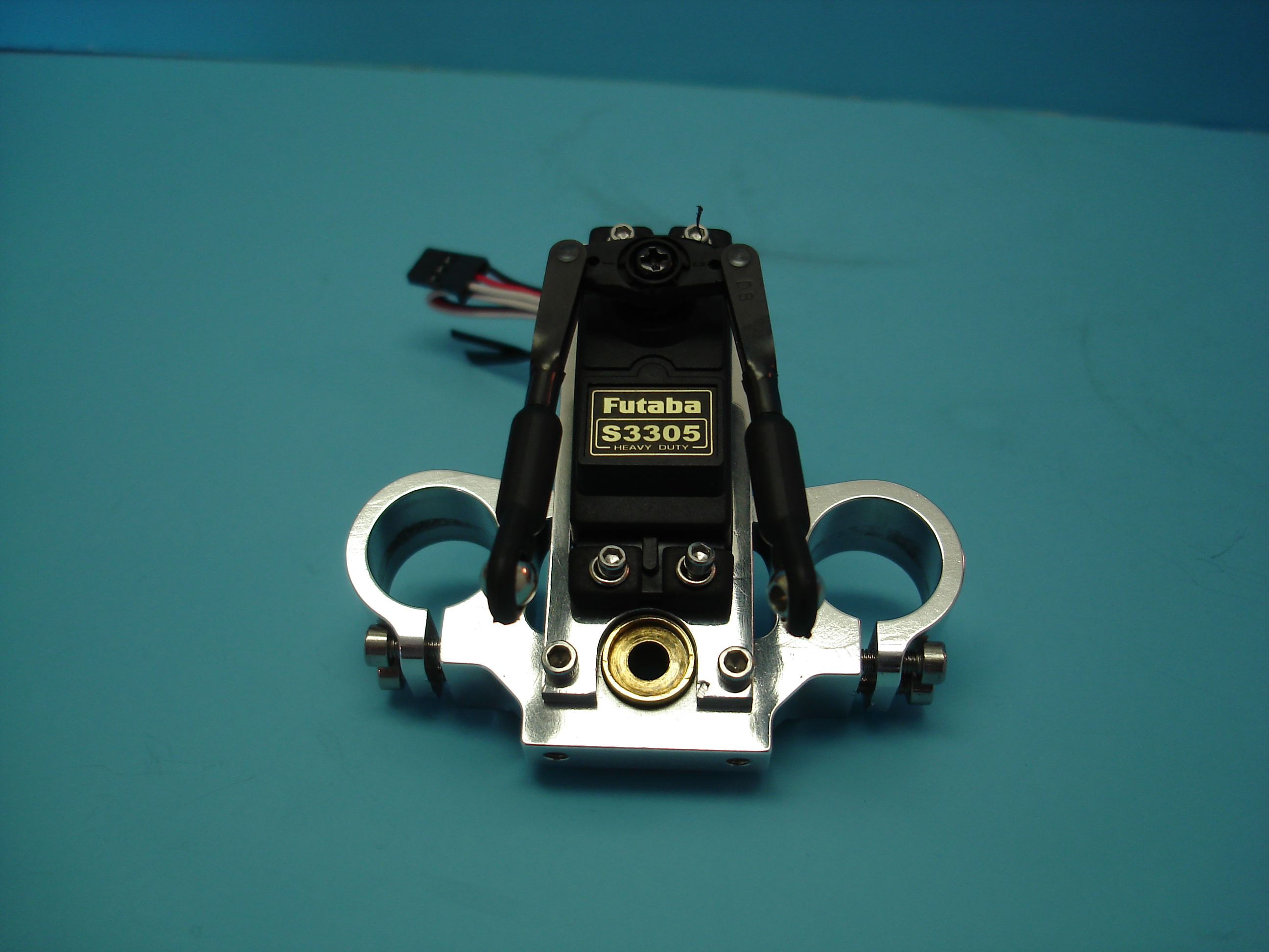

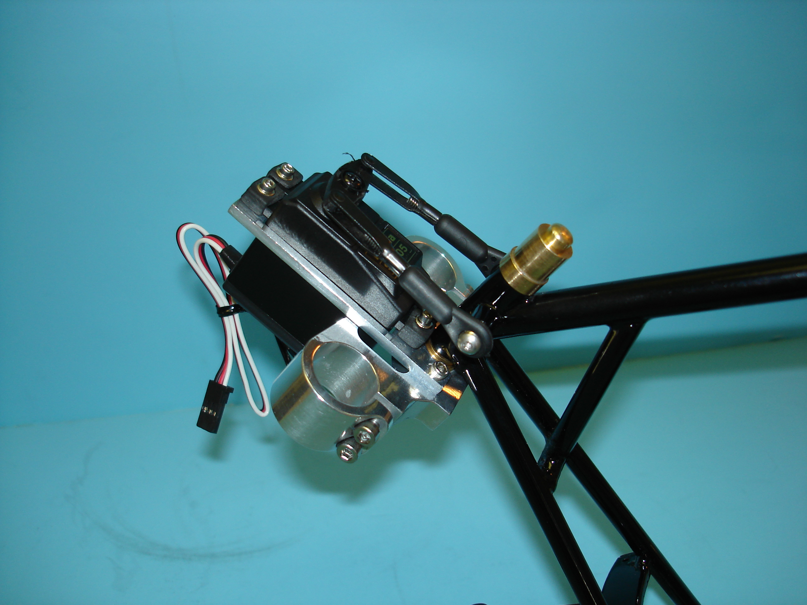

Front end set up...steering servo mounts on lower triple clamp and is completely hidden behind fairing...

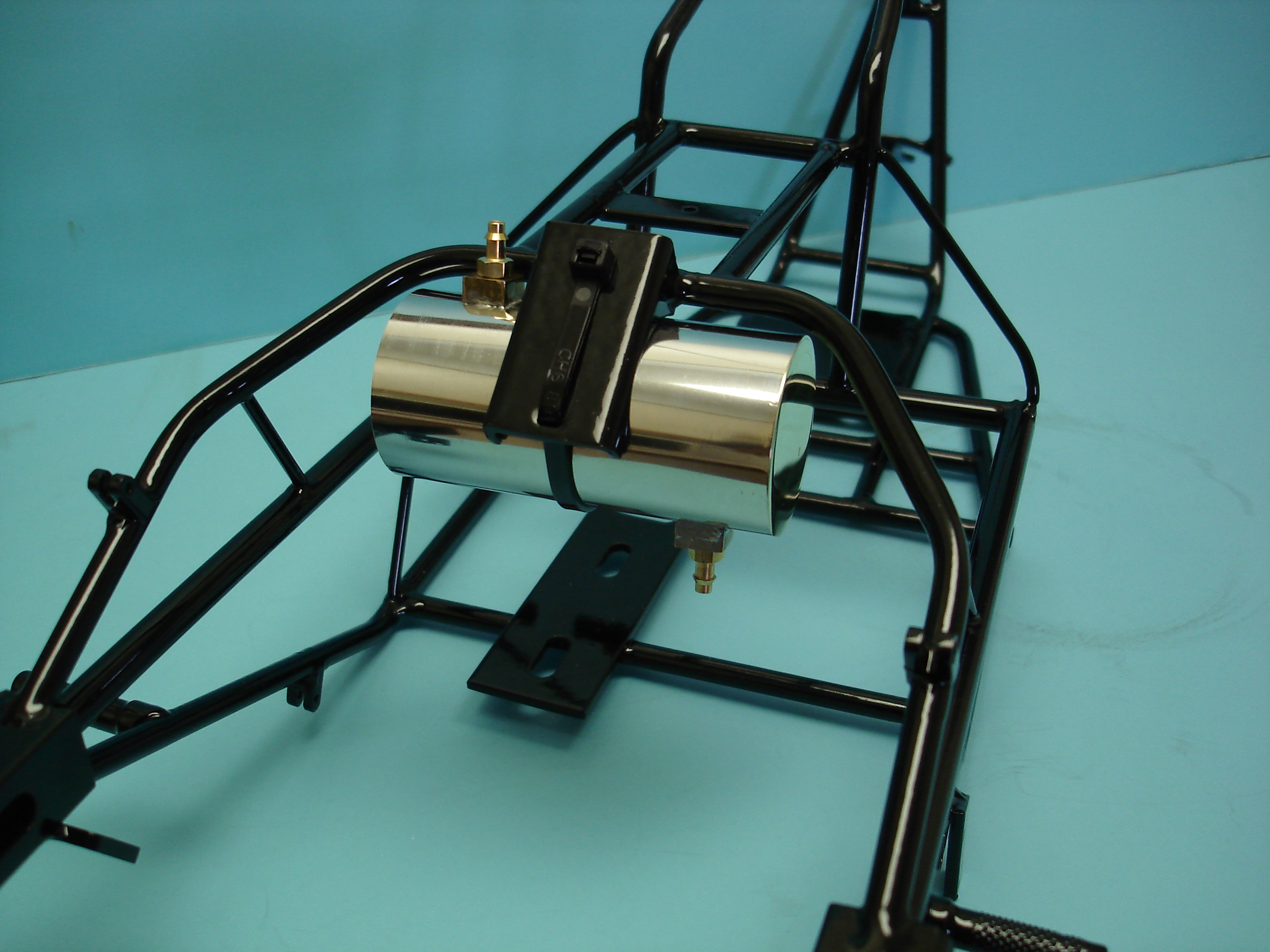

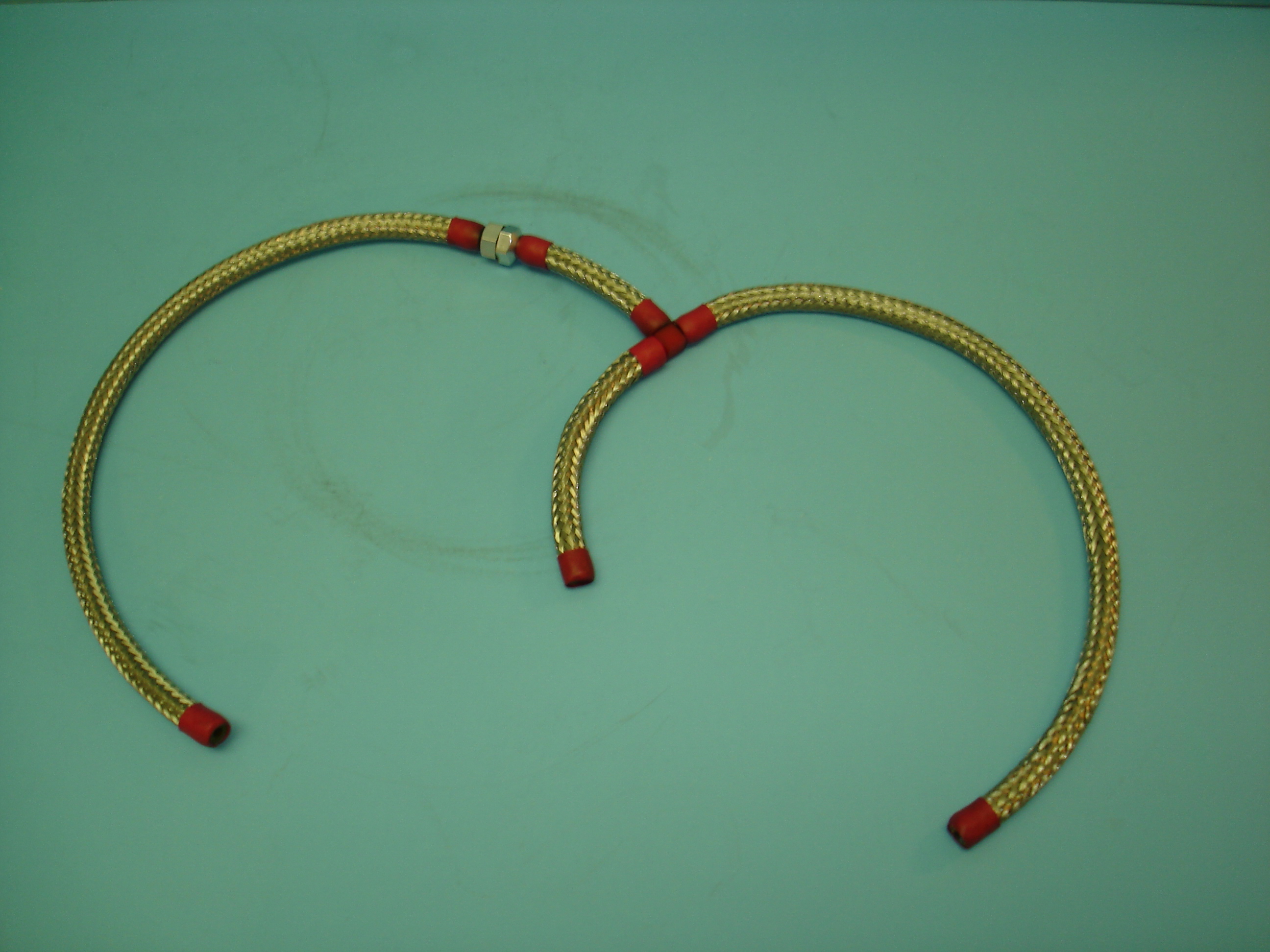

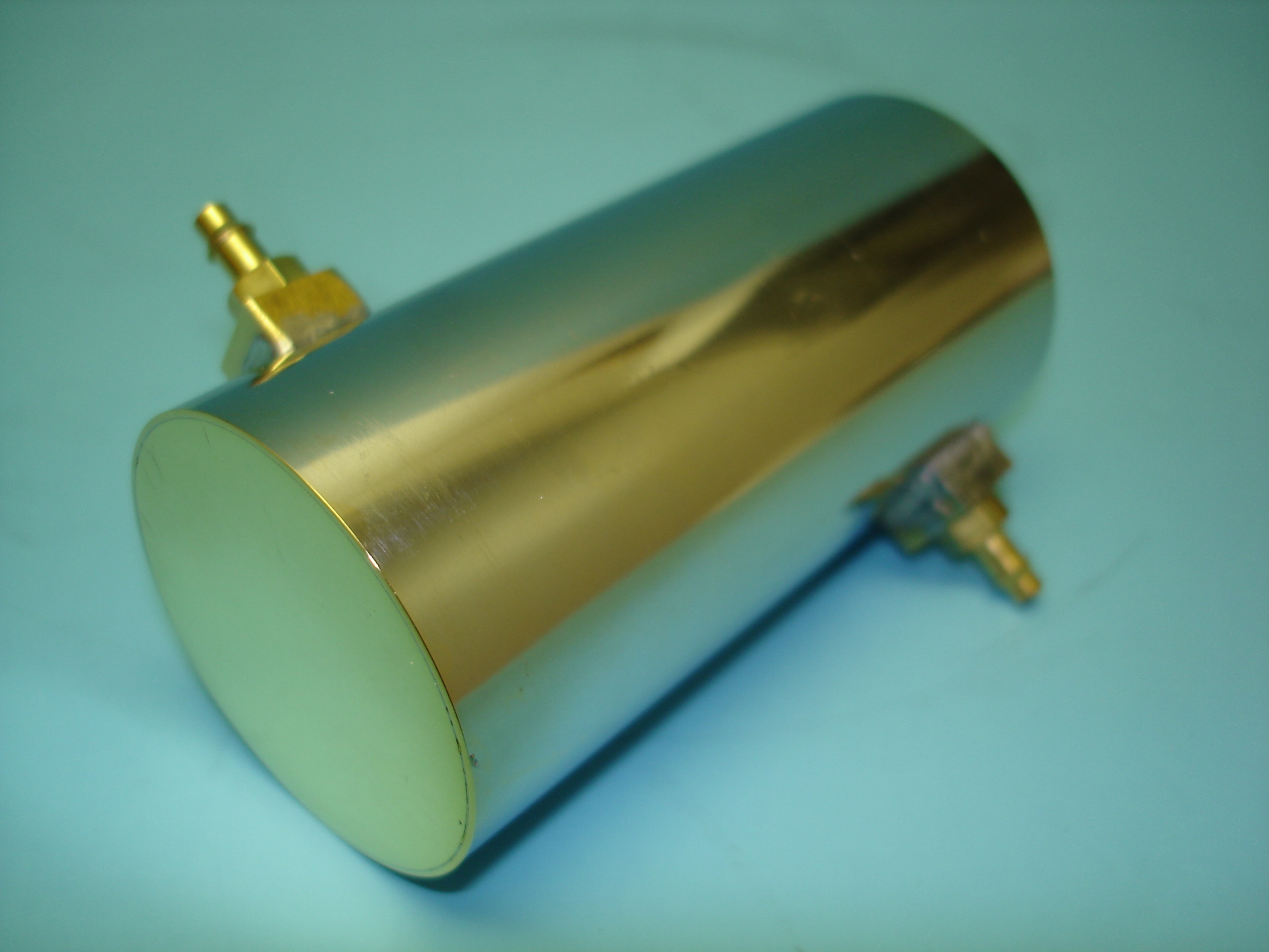

Pics of fuel cell and its placement on the frame and fuel line pics.

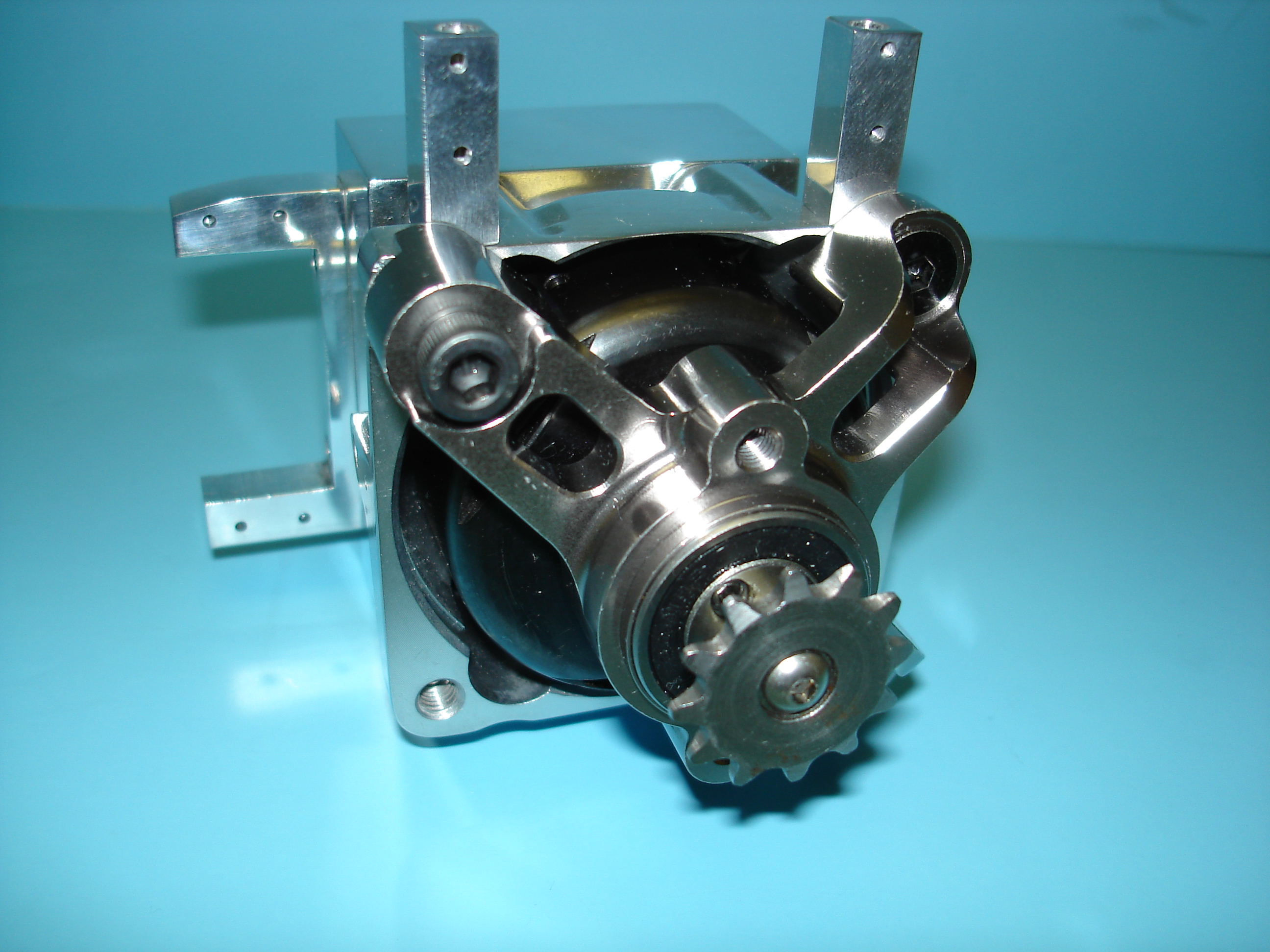

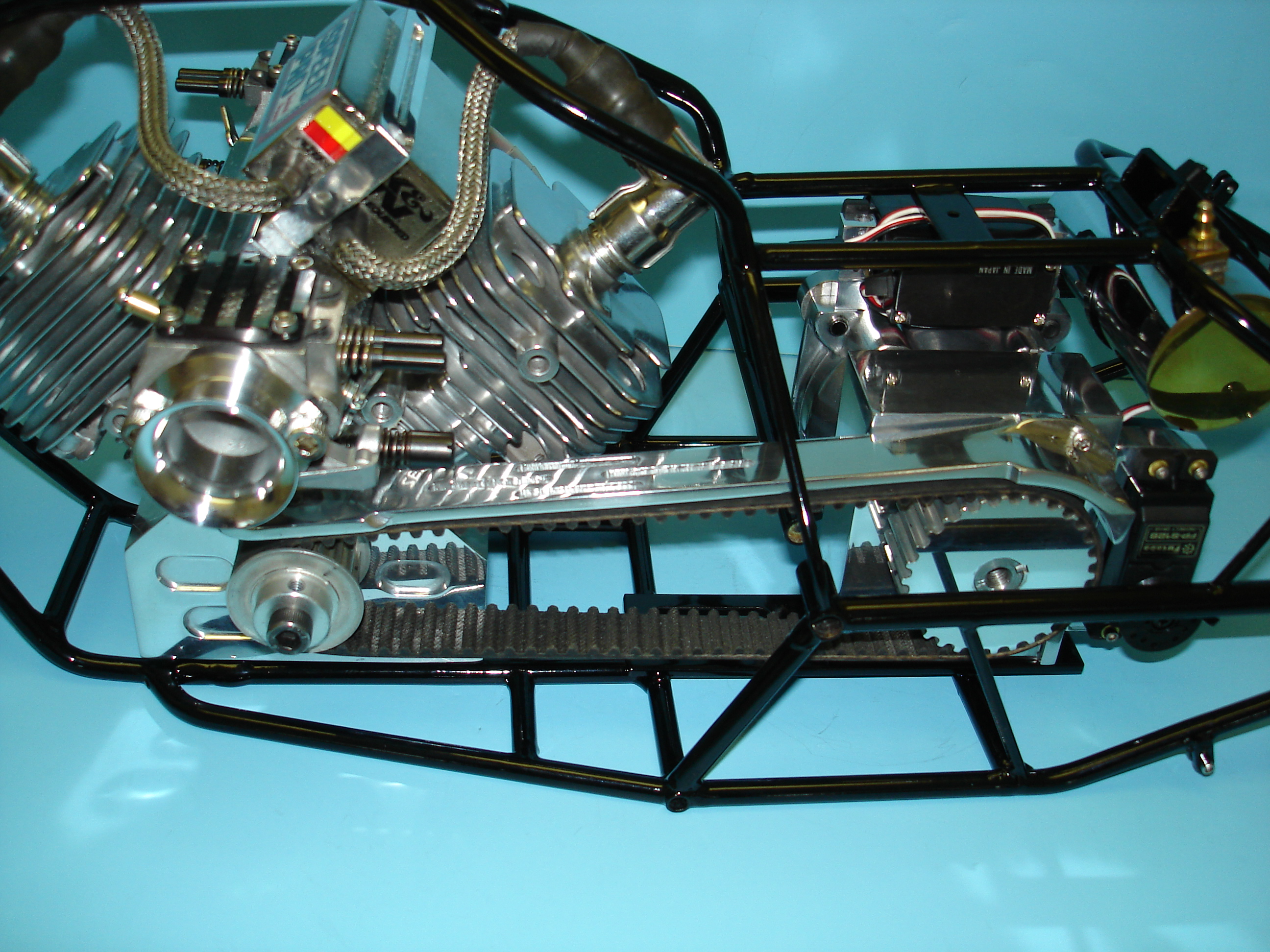

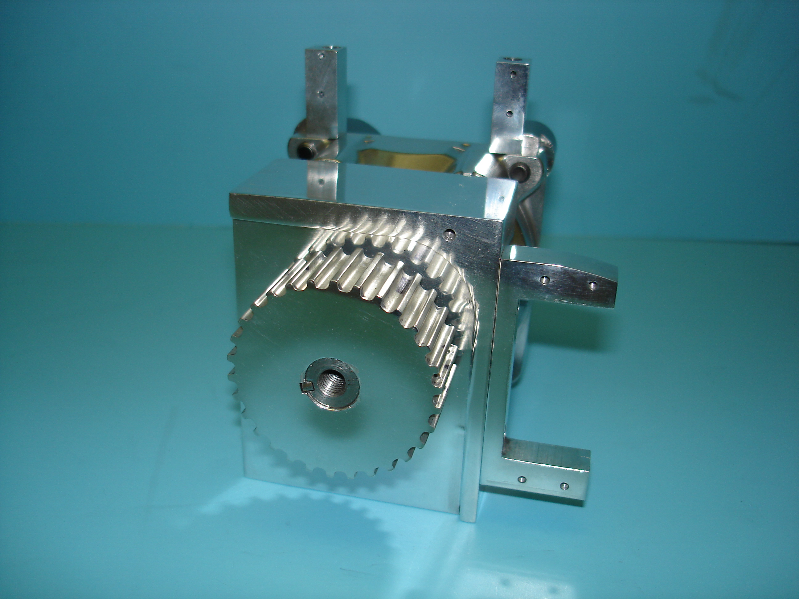

Transmission pics...belt drive primary/clutch to chain drive final...note throttle and brake servo mounts.

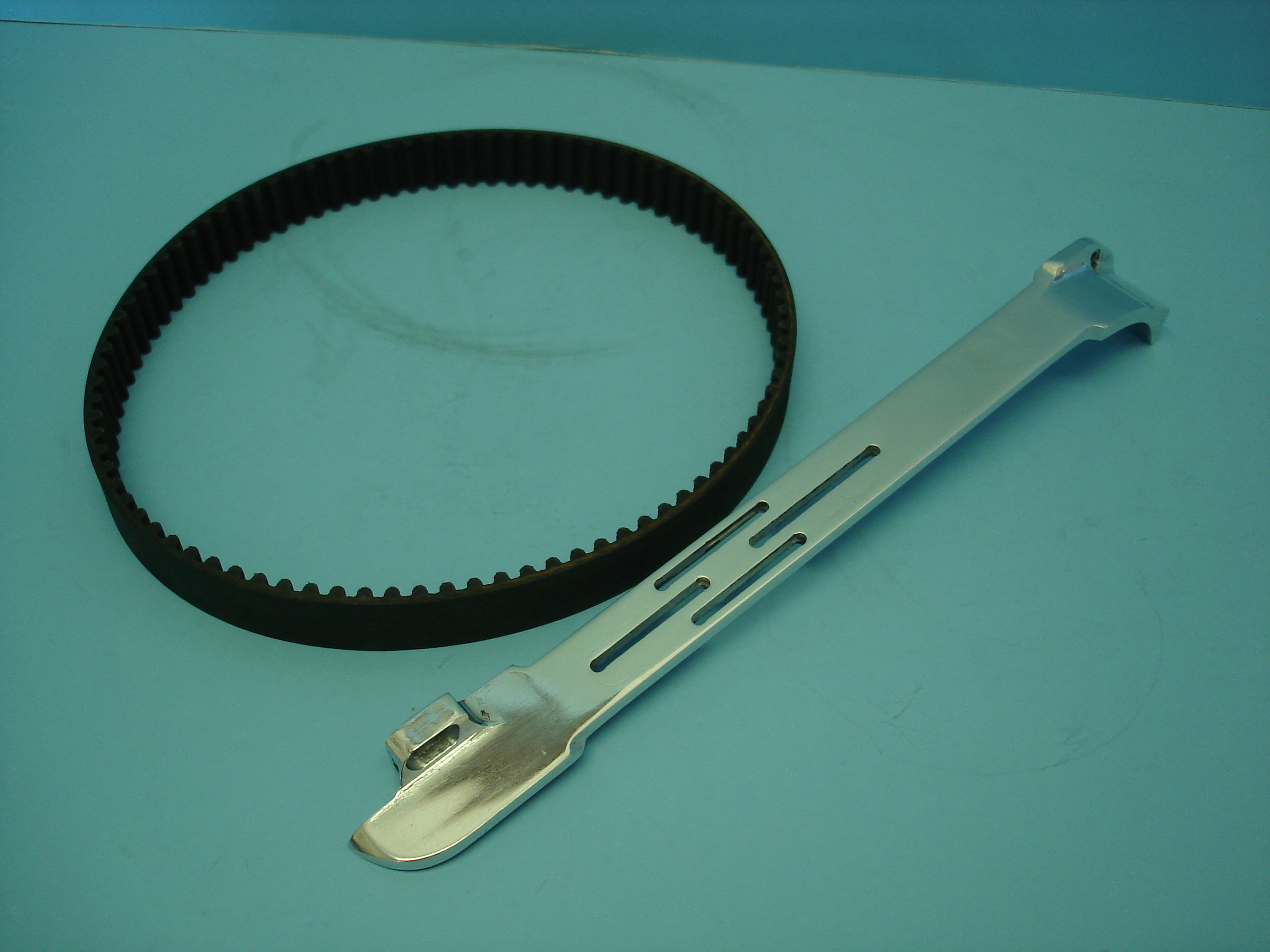

Thanks for all the great feedback fellers...here are pics of the belt guard and installation.

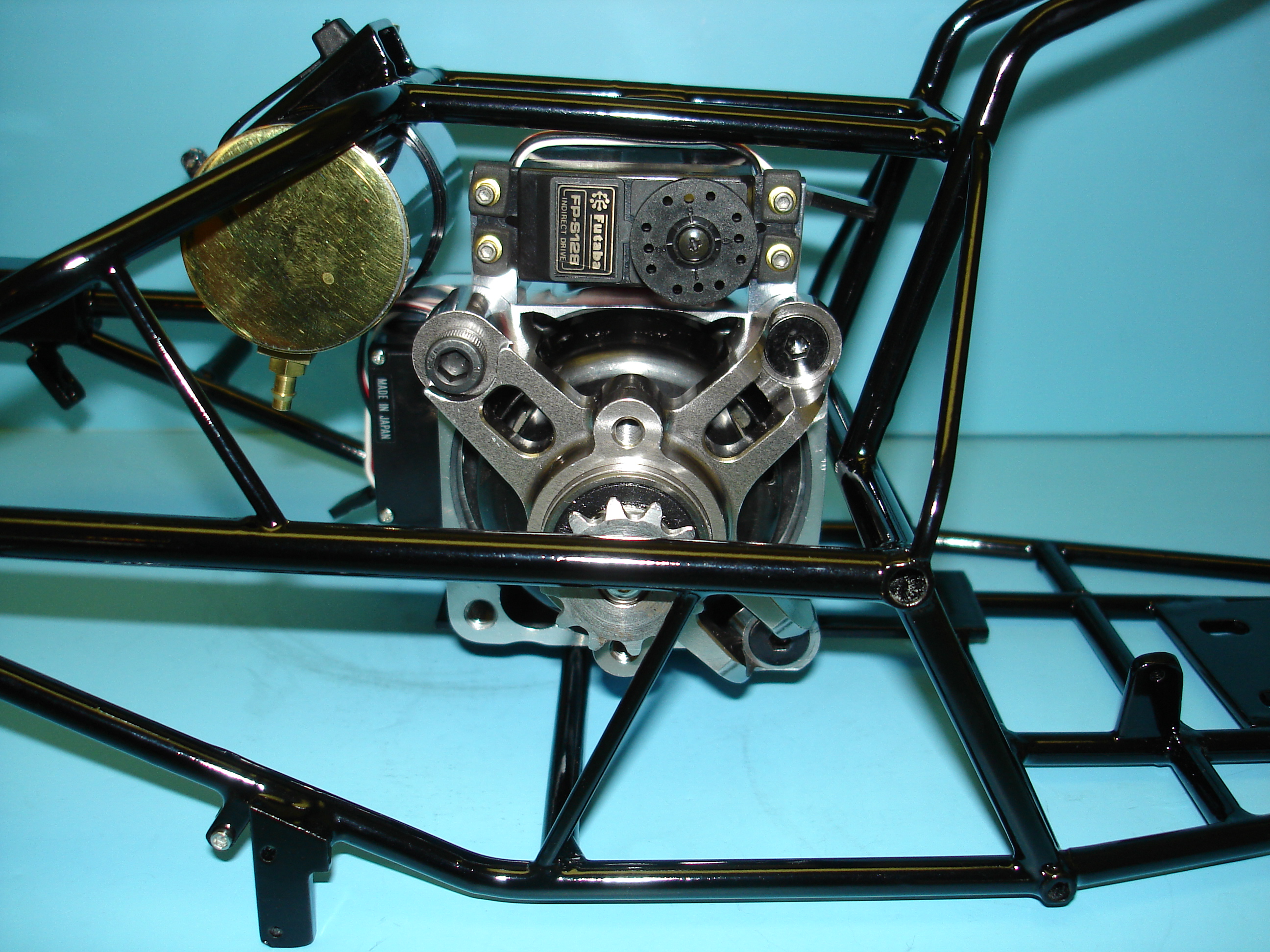

Post by hotrodz »

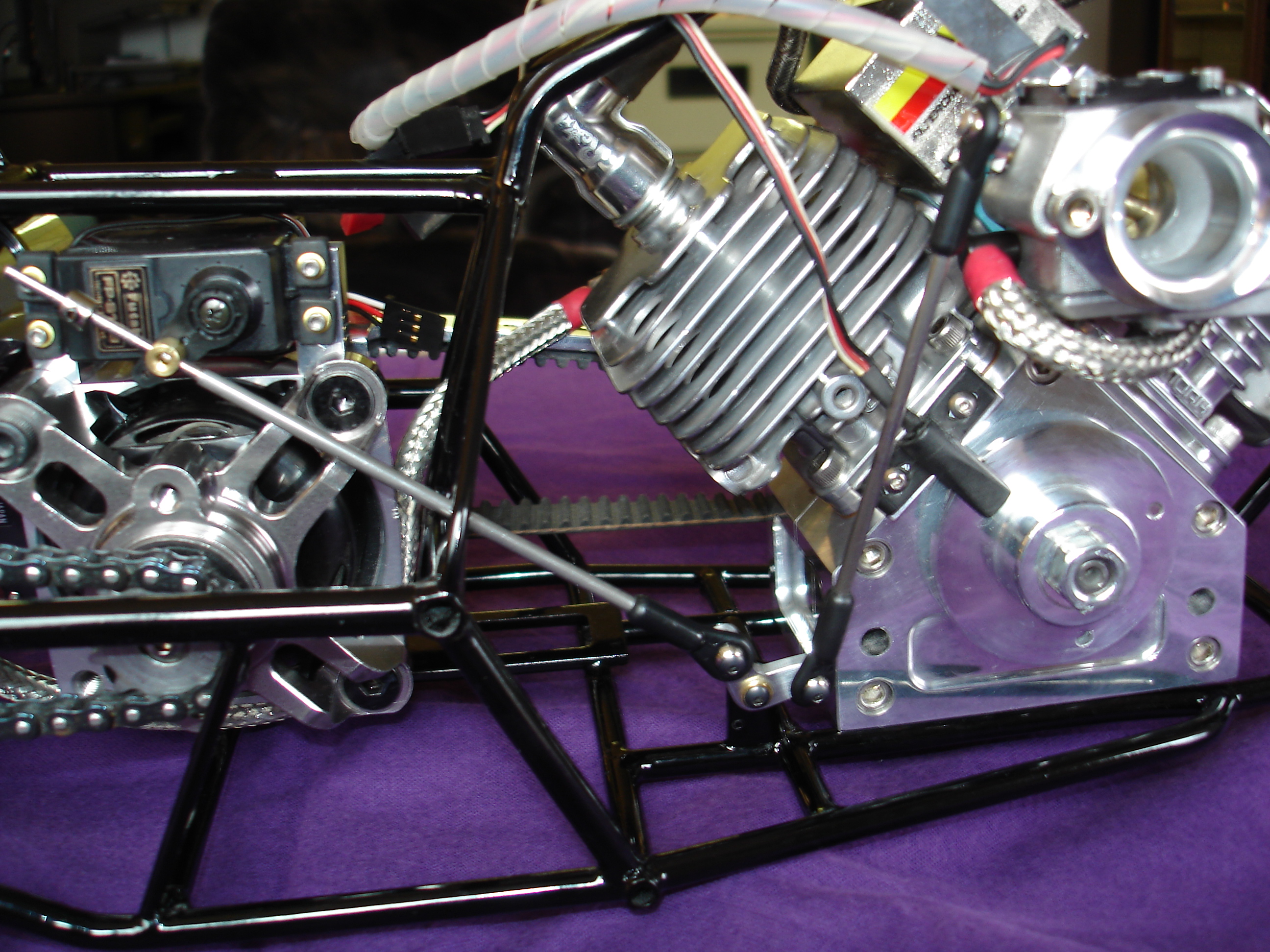

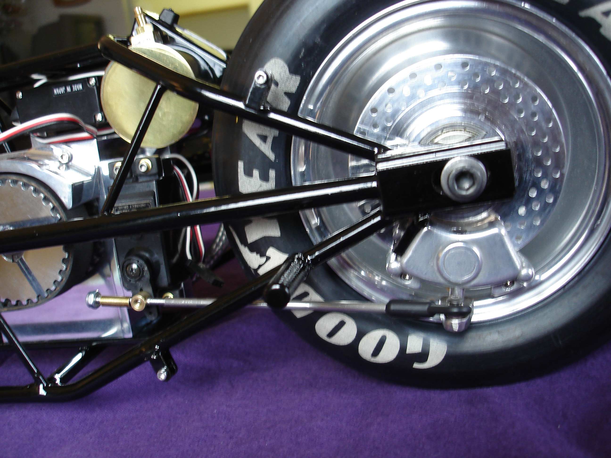

Pics of installed throttle and rear disc brake servos and linkages...
