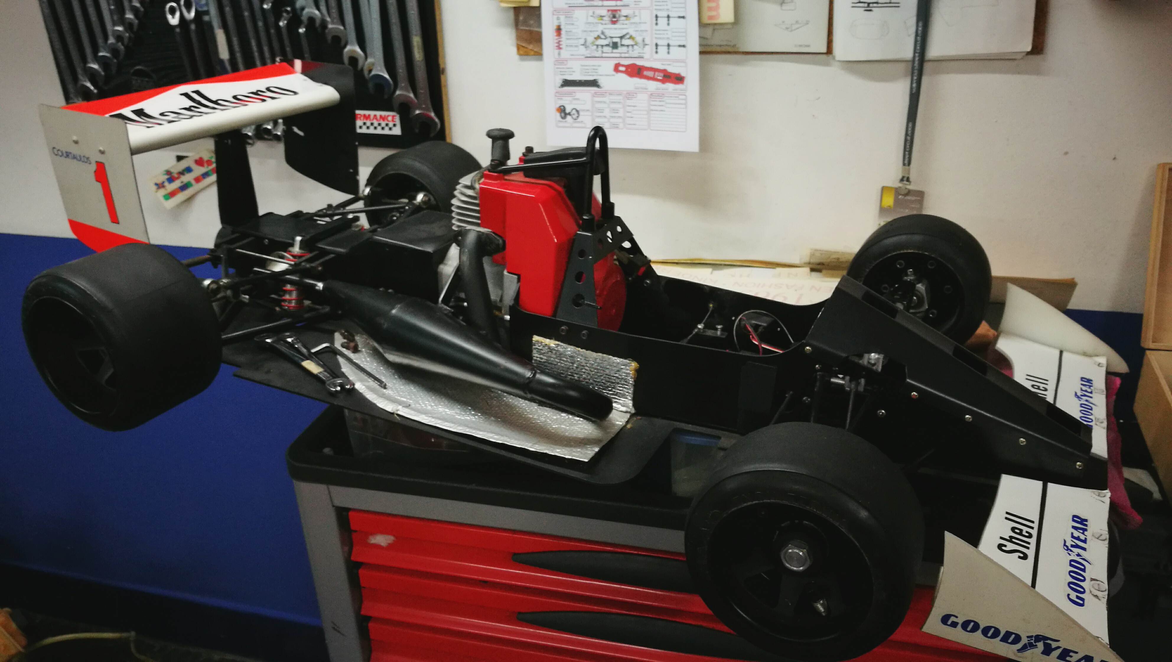

My beloved SAVO. Stored from 1999 it's time for a inspection and refreshing all parts. I thing a new colour scheme could be a good idea too.

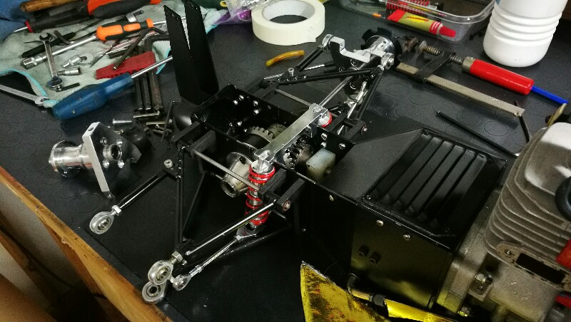

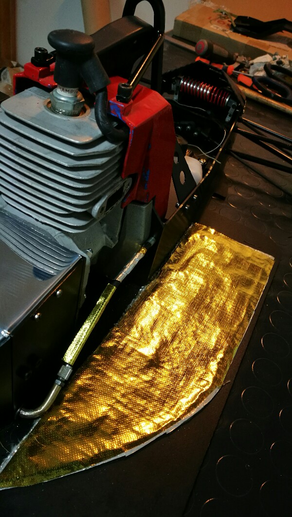

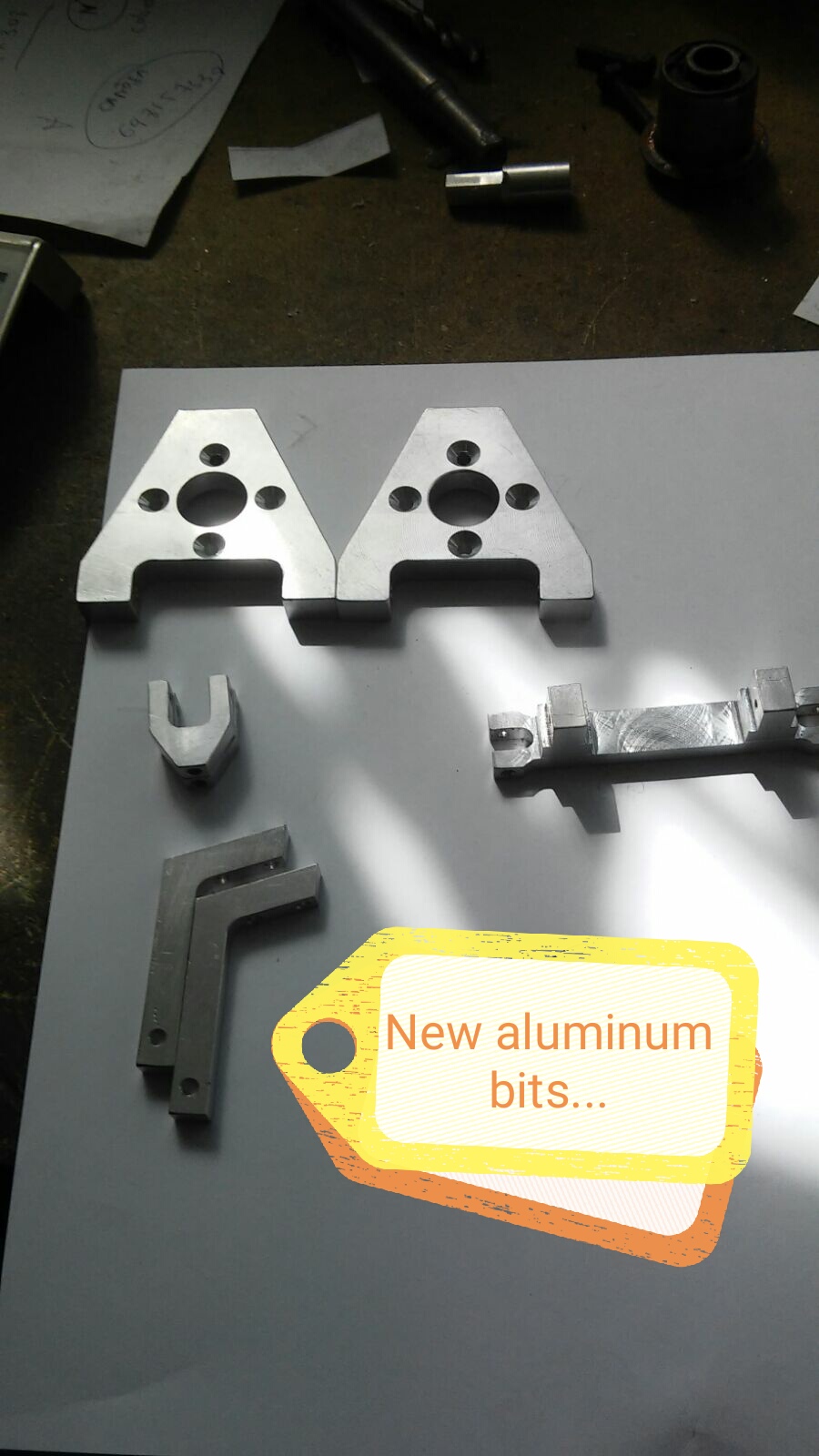

Alu diff cover. Instead the stock plastic unit which is very sensible to heat.
Re: Refreshing and new suit for my SAVO F1

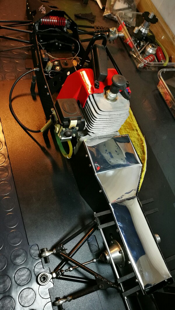

Aluminium bits ready.

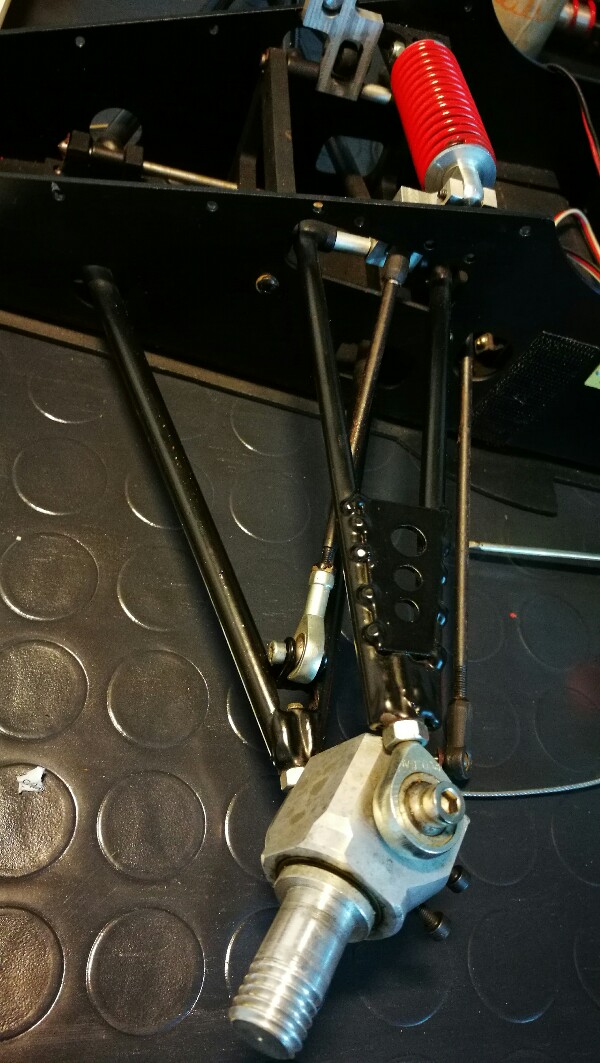

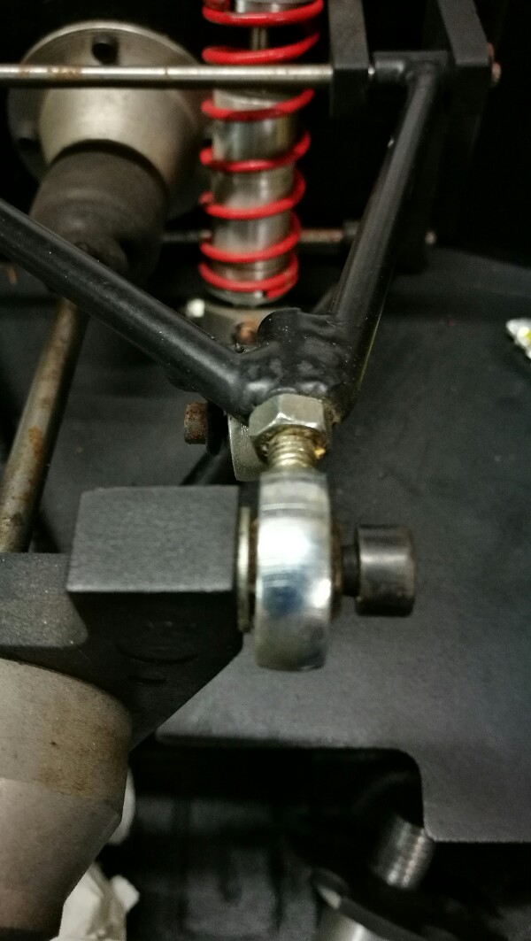

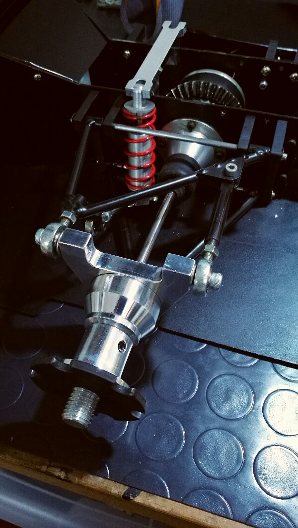

Well....Rear axle is ready. Have replaced the wishbones bar link for independient fixations which makes the access to shocks easy. Uprights bolts replaced as well for a more appropiated ballhead bolts..........To be continued.

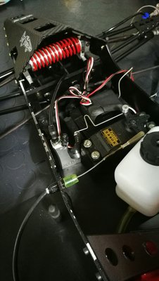

Next stop...front axle. Meanwhile shocks out for inspection.

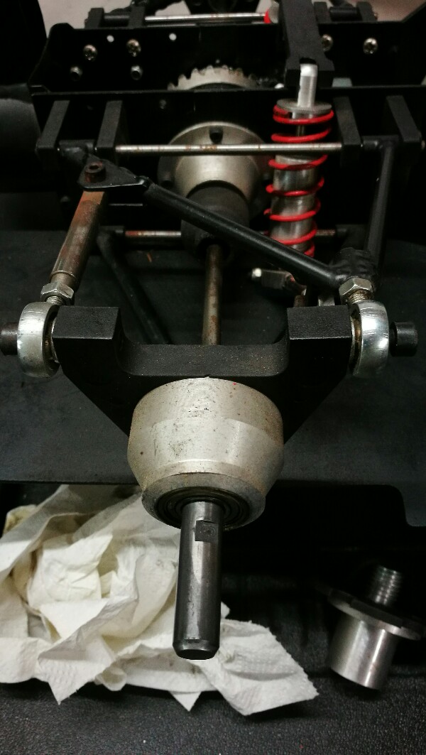

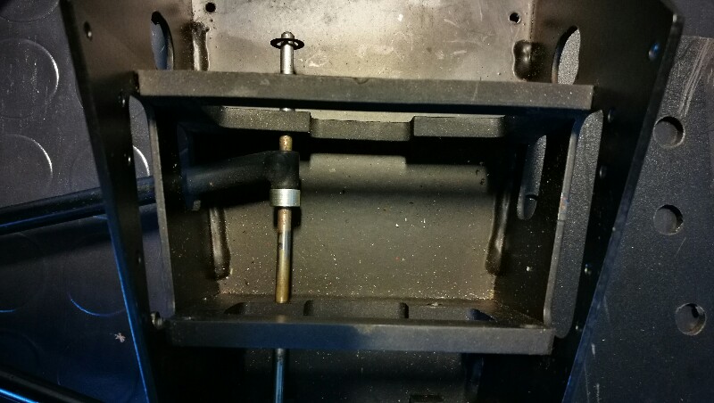

This is the front suspension box. All parts removed for cleaning some rust spots.

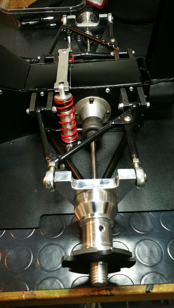

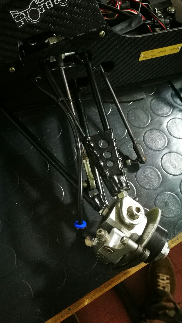

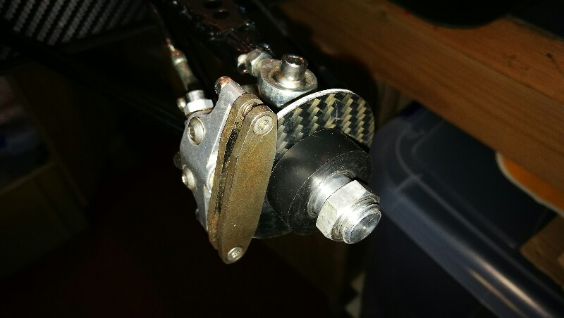

Front shocks ready and in place. New hub bearings, polishing rust off from steering arms and now first attempt with the hydro brake calipers......mmmm.....Not bad....not bad.
Caliper and disc in place. Now intalling the brake lines.
