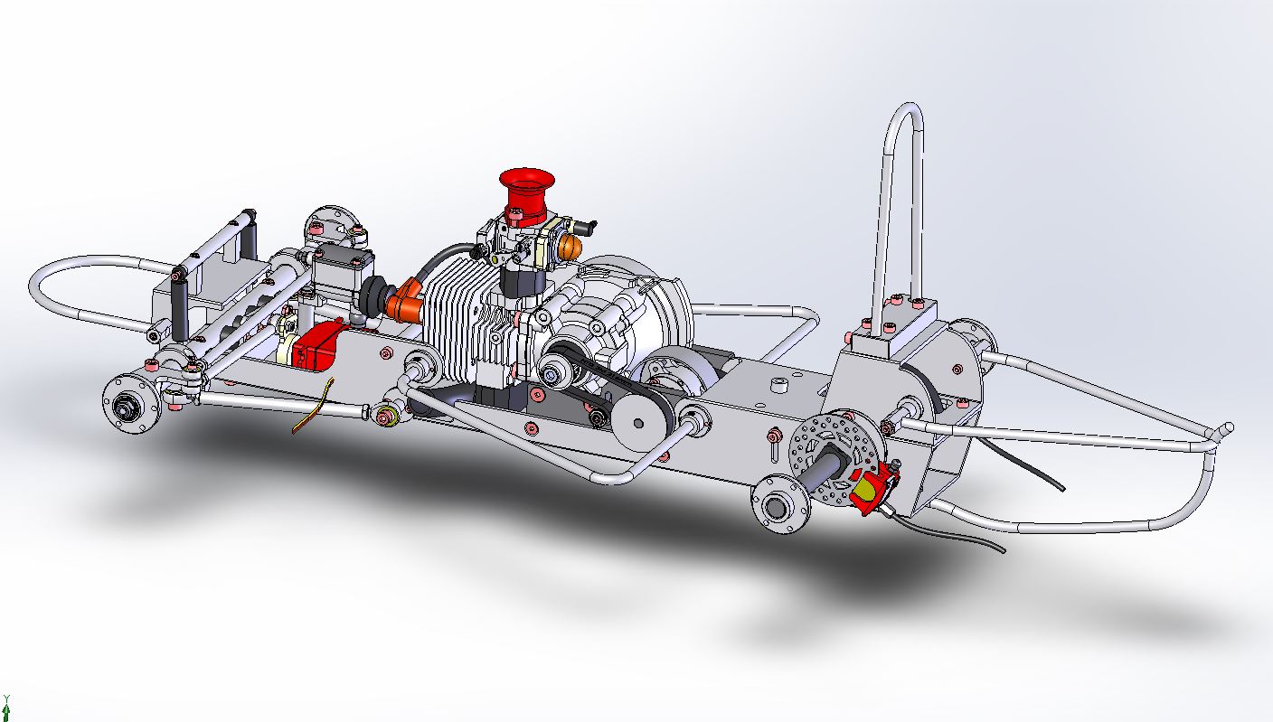

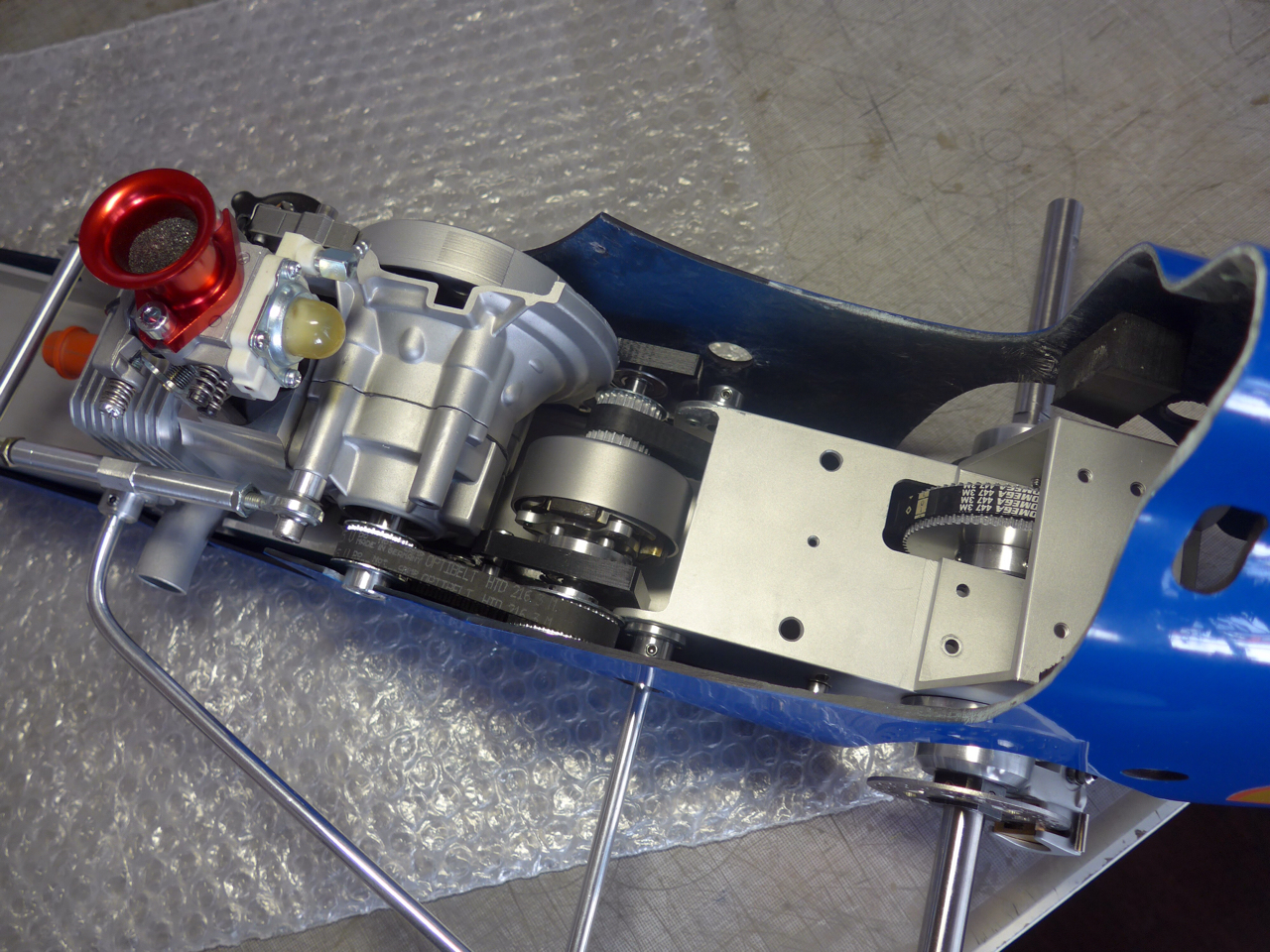

One of my new projects. First I built every Gilmer part in 3D (except the body). I want to use an old but never run ZENOAH G2D with Tuning MRZ Cylinder head, two disc brakes at the rear axle and shocks in the front...

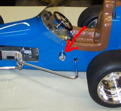

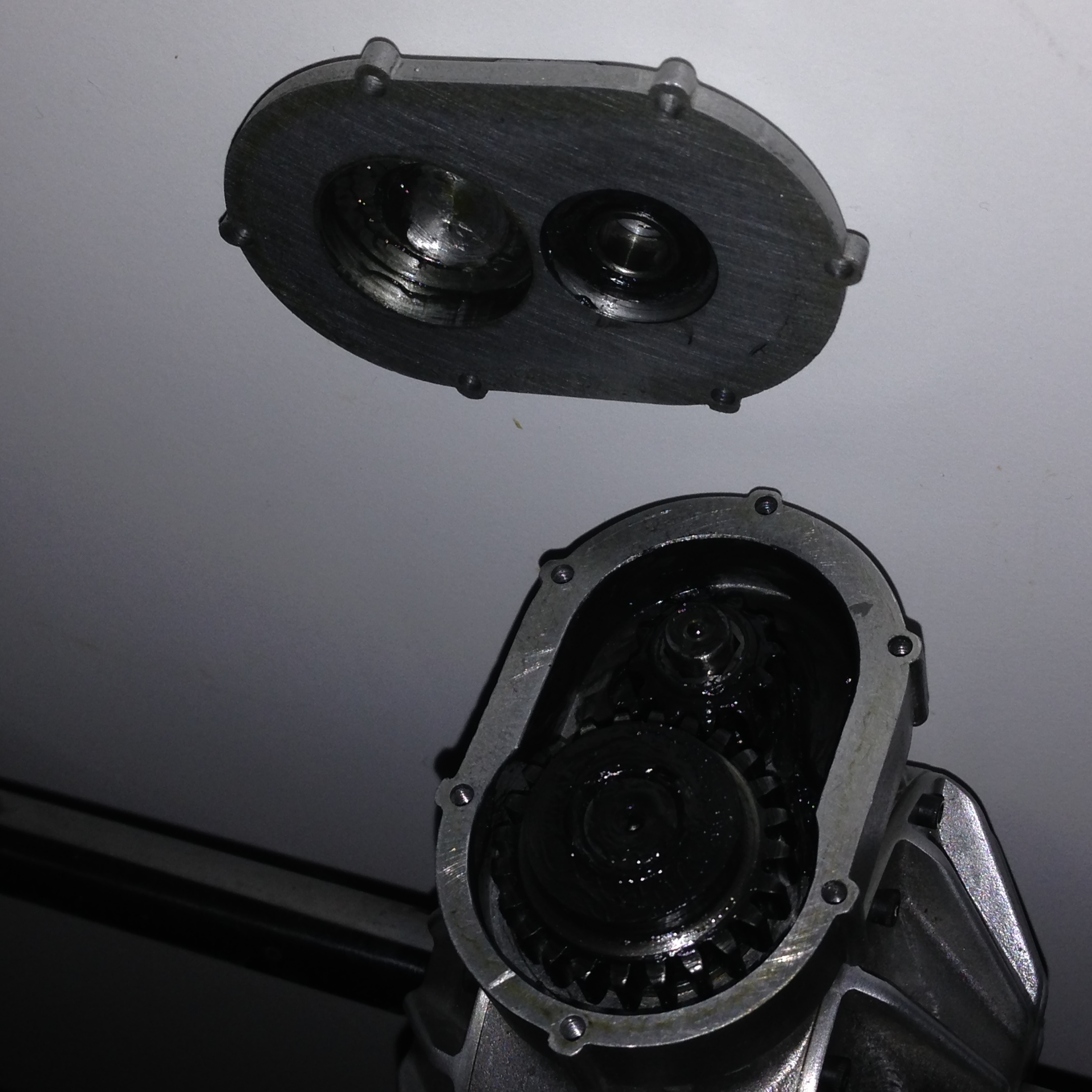

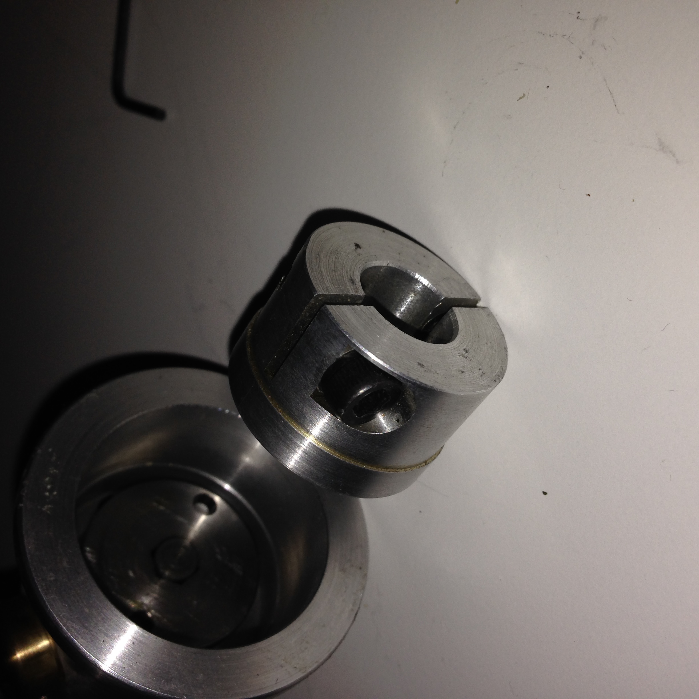

Does anyone knows what kind of starter connector this is and how to built it?

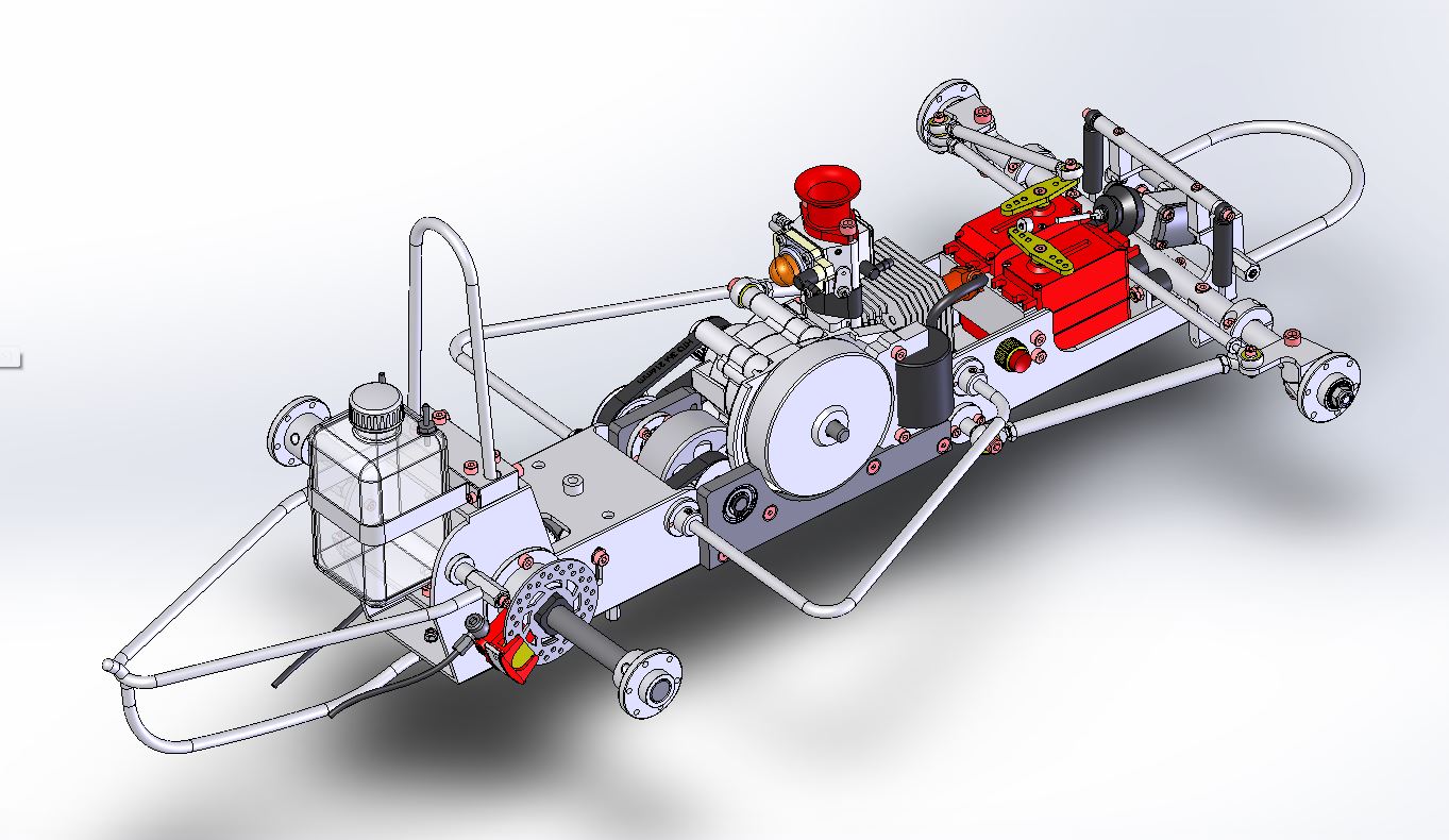

I found a position for the gas tank or it is a problem with the centre of gravity?
- Posts: 521
I think thats jans custom stuff but looks like you can put a rotostart on it, or make a custom hub there that adapts to the starer wand of the roto start ya done

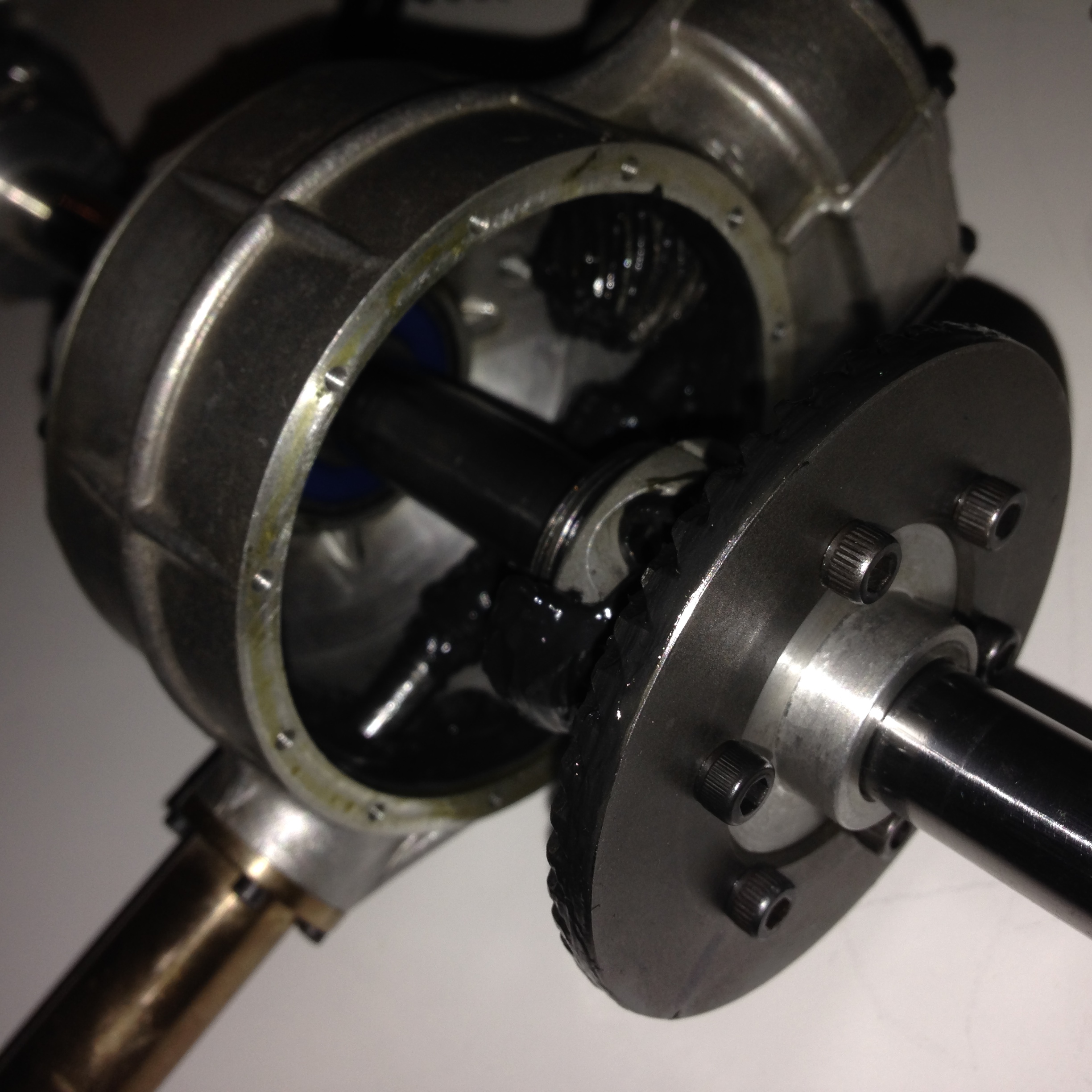

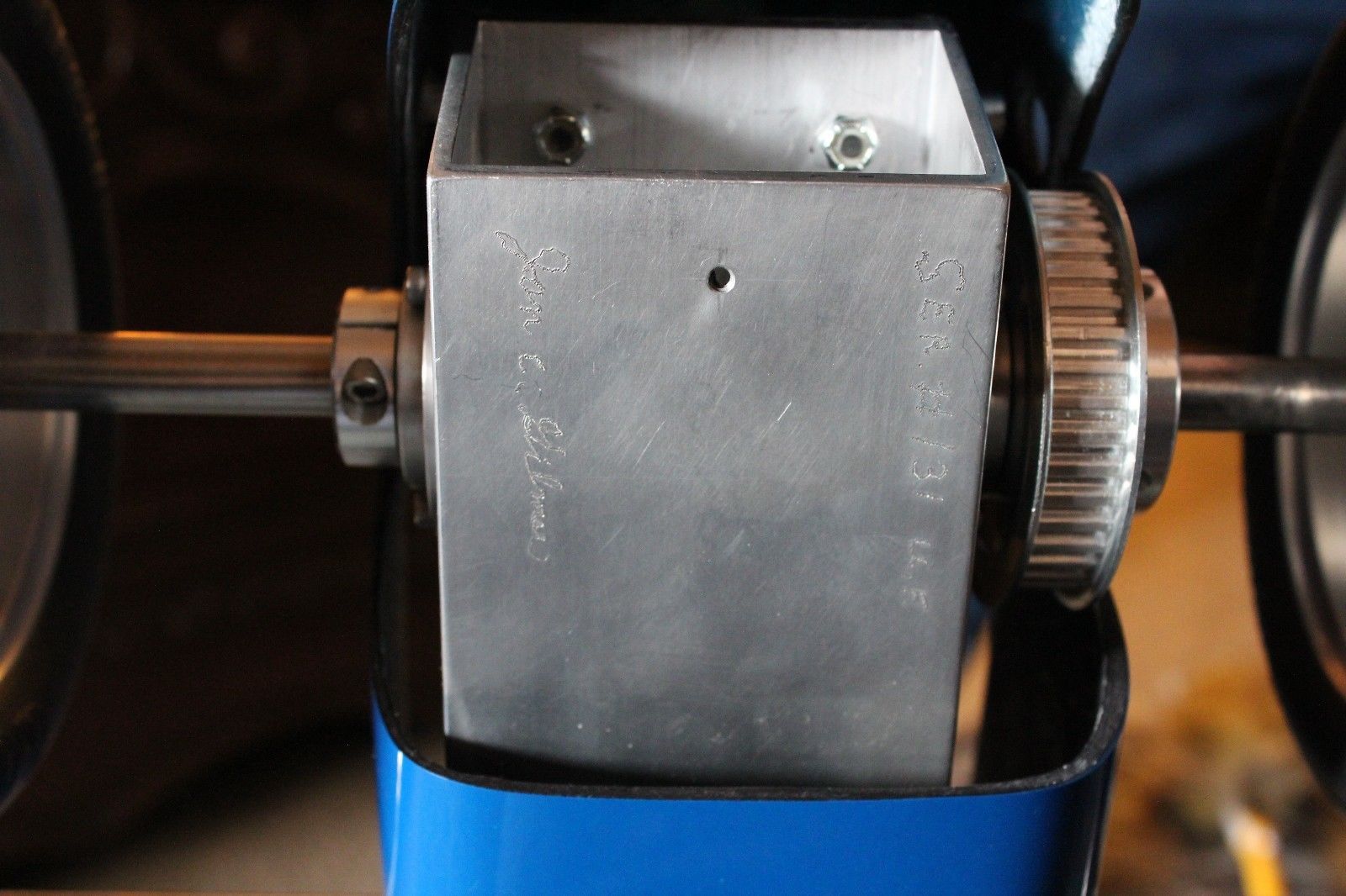

- Posts: 521
This is a rear jan made for his gilmers , was supposed to go behind a maloney100 or something suitable. It has a in out box with working lever. Its smaller than a skellenger but uses same gears and all

Thank you for the helpful ideas and the pictures of the amazing rear.

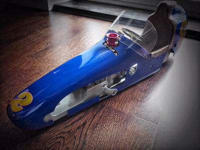

- rc garage berlin
- Posts: 346
- Location: Berlin

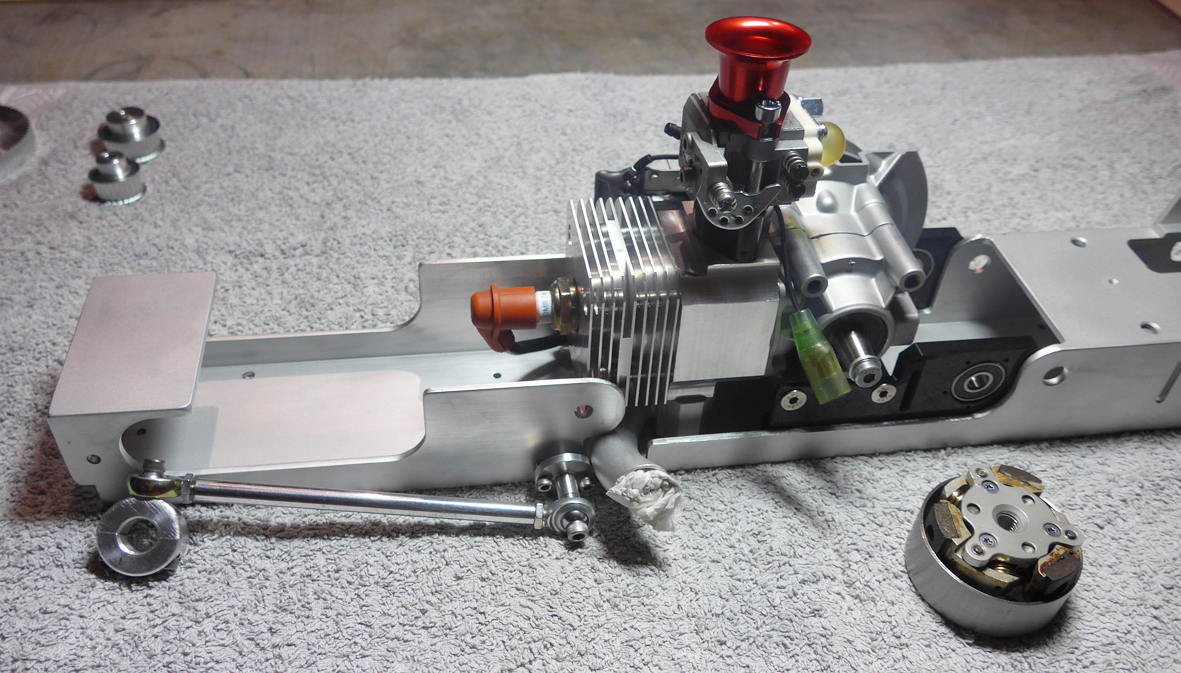

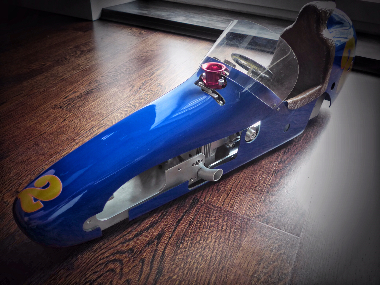

I am so happy. The zenoah fits the body perfectly without large cutouts.

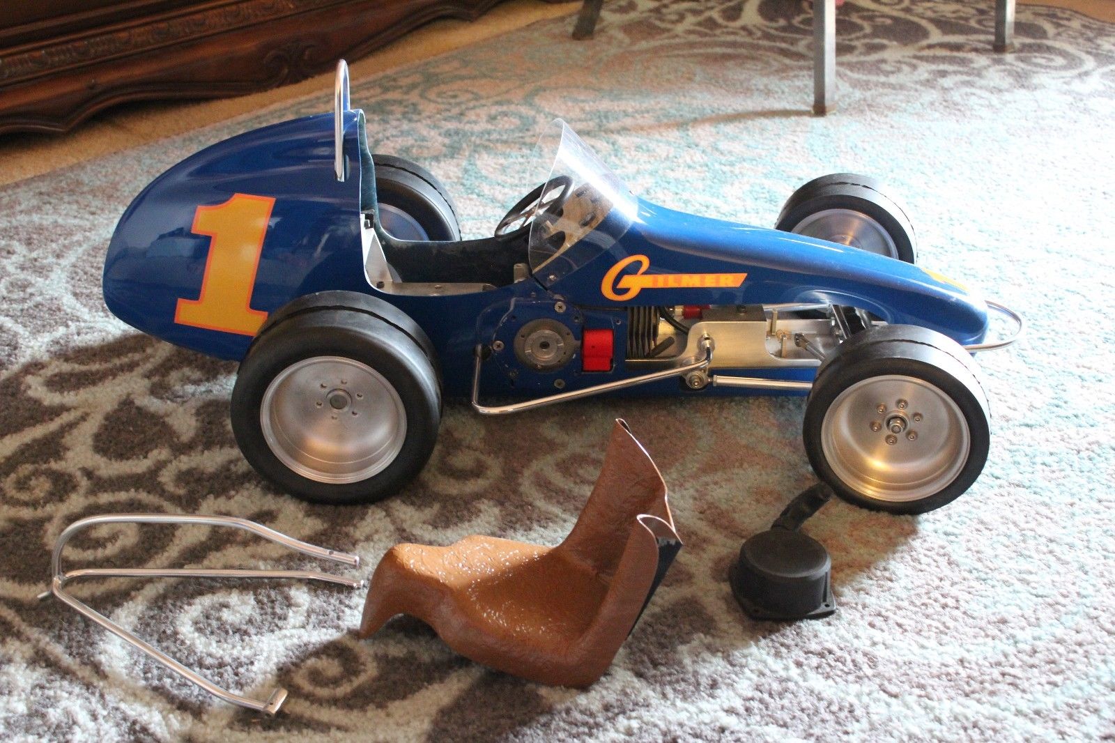

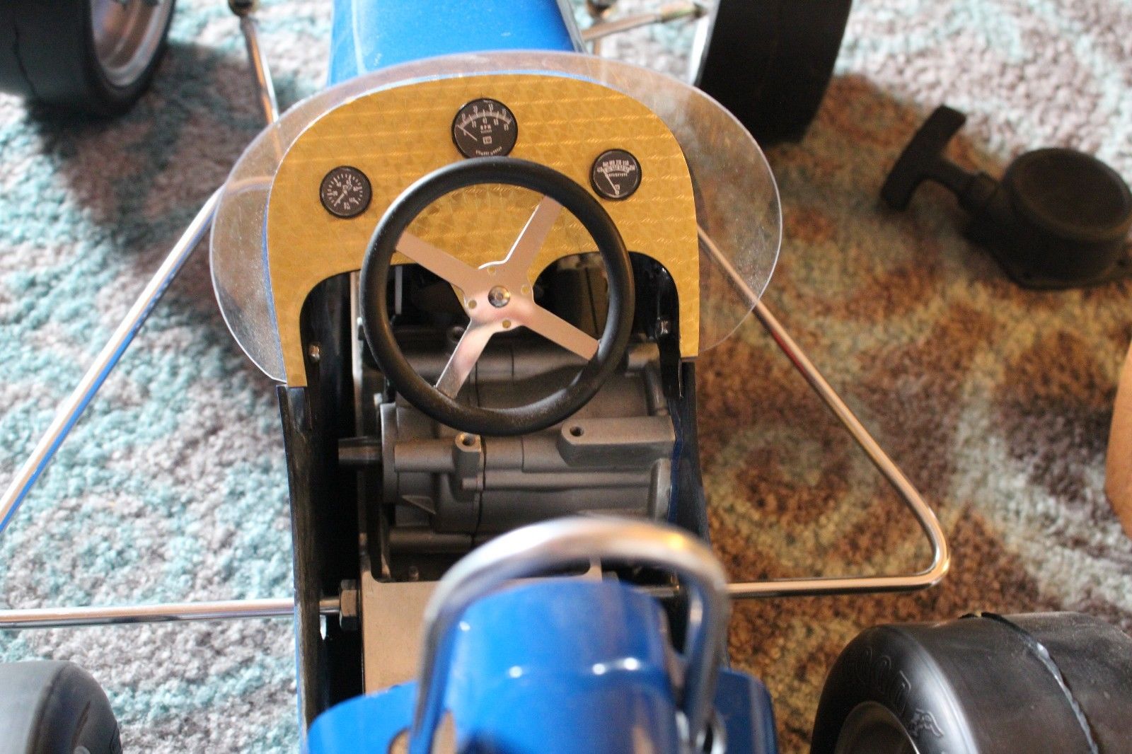

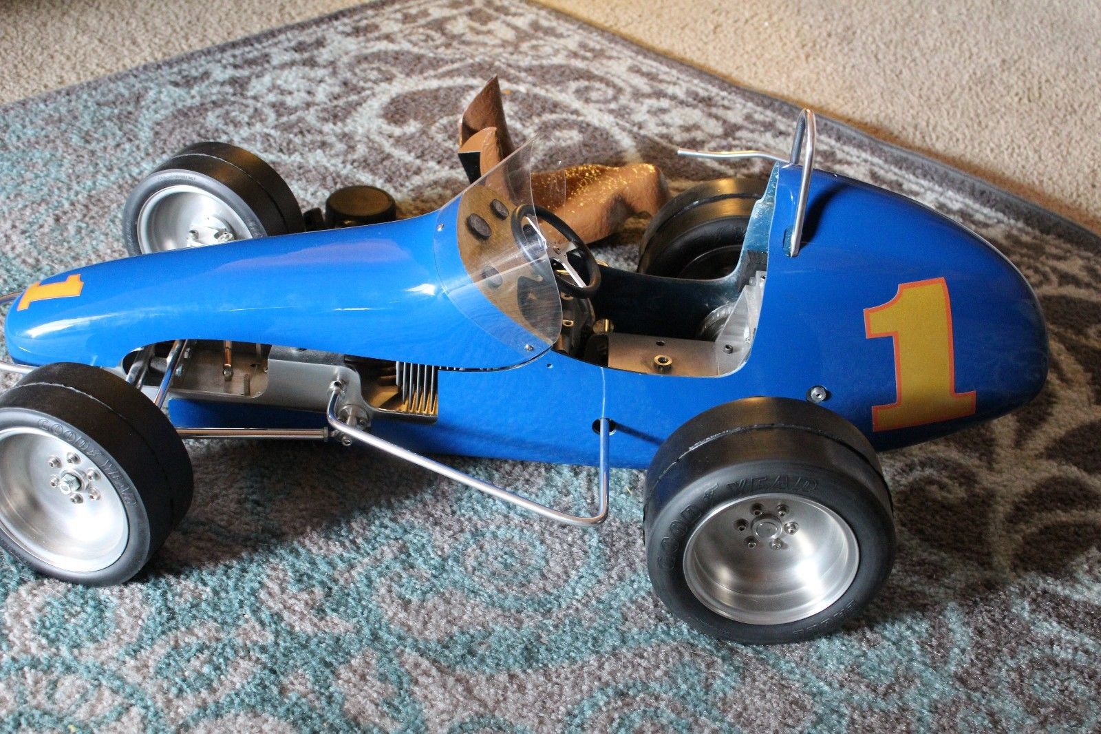

Hi Rc, hope you don't mind me posting my Gilmer here? I just got this Gilmer on ebay but haven't received it yet, should be Friday. My question is, looking at the photos from the auction, what are my options for a drivetrain?
Engine has been installed by the previous owner, it is a Zenoah g23. Or should I start over? Thanks.
