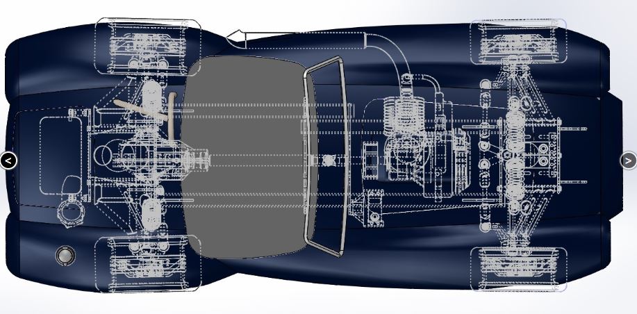

...and here some pictures of the rolling chassis and the body. Thank you Laurent.

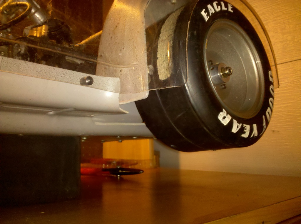

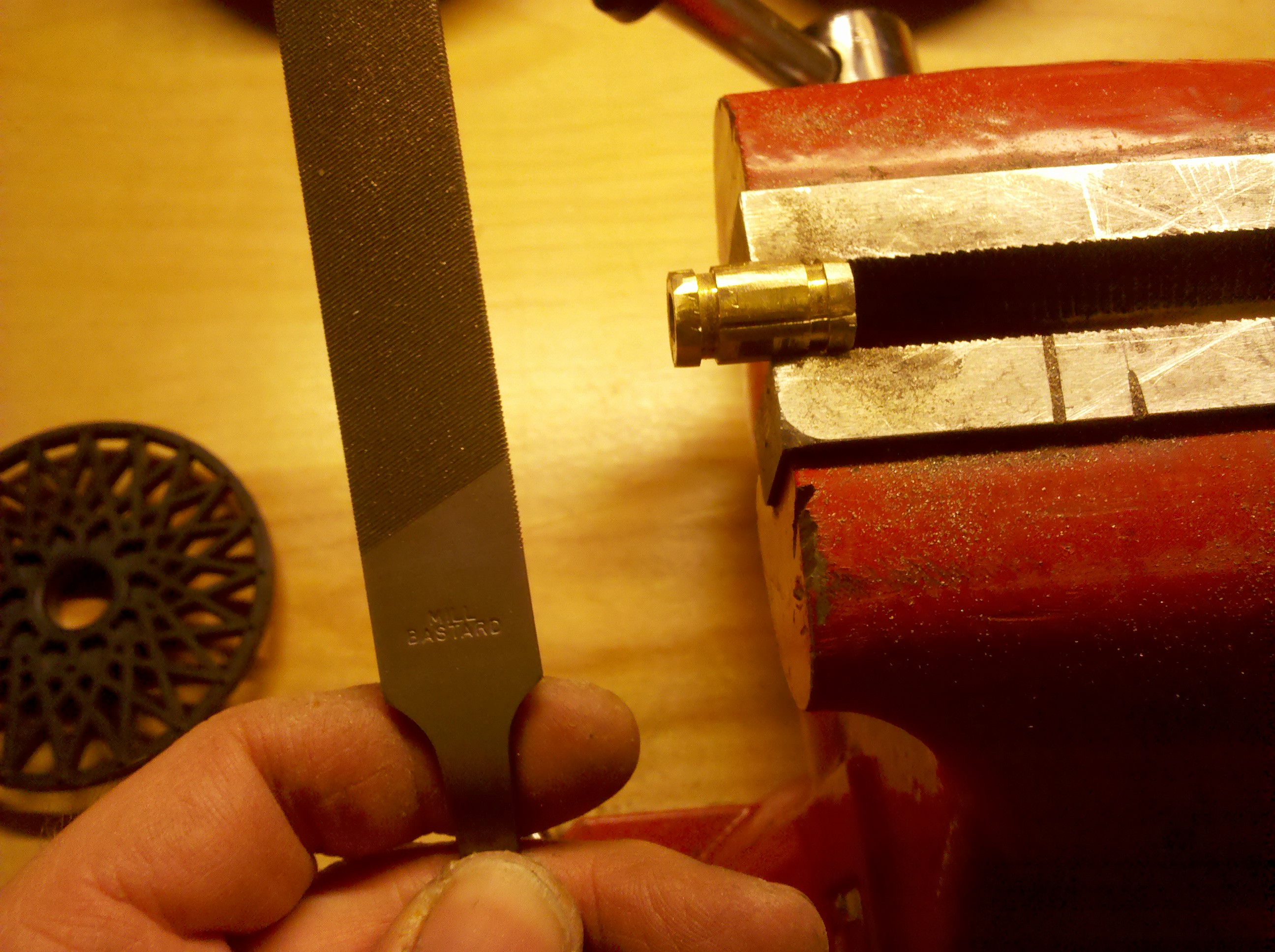

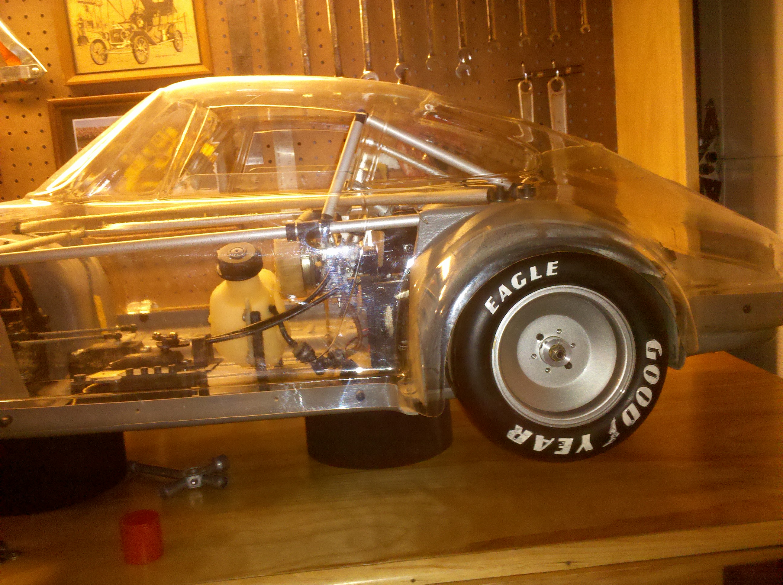

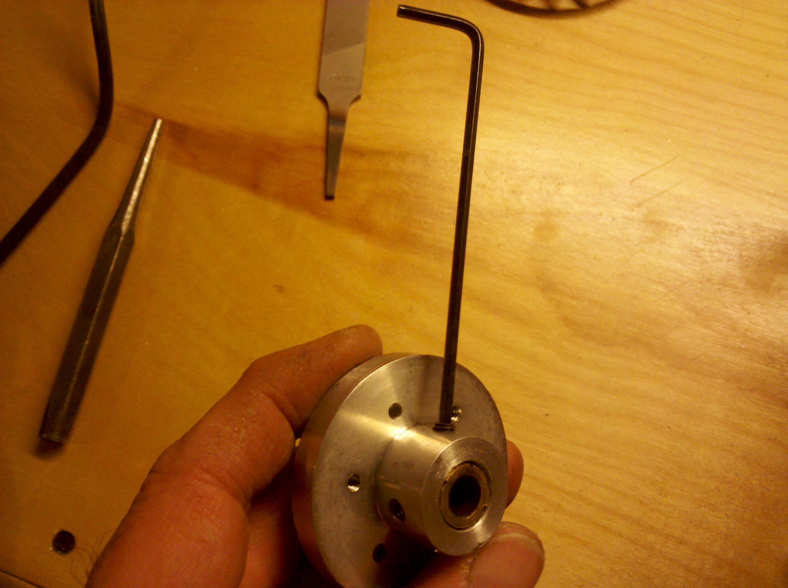

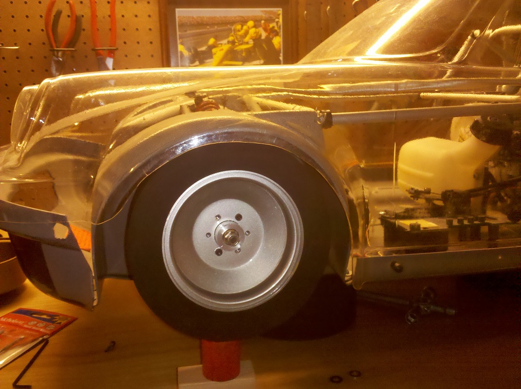

Let me share a humble project I did about 8 years ago, This might work on other Yankee cars but I did this for my Turbo porsche with the impax chassis. I took the original wheel and removed the brass center adapter, filed it down to fit the standard hub with set screw (no key way type) Photos explain it better. Once the brass adapter is fit, the factor would be the depth of the inner rim to clear the control arms and fit under the lip of the fender. Aluminum rims will take any car from ordinary to extraordinary.

We are working on 3 final version chassis
pics are the 1st prototype
available without the fiber body in 3 - 5 week (body are handmade one after another ..) final legendKit will be with ABS body
is this hub radaptator Raco have the good sizes for Aluminium rims ? thank you Emilio for this drawing and pics of your Porsche
